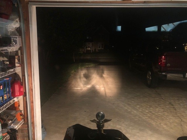

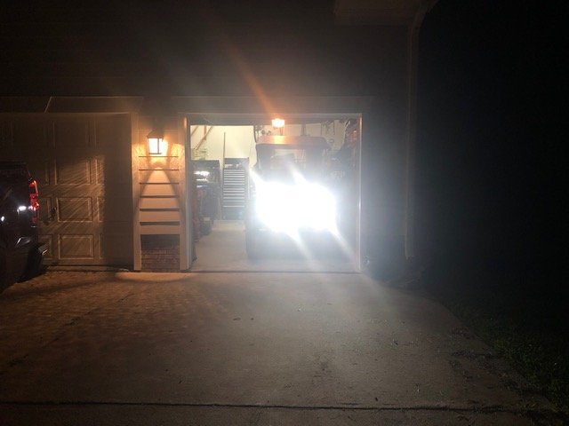

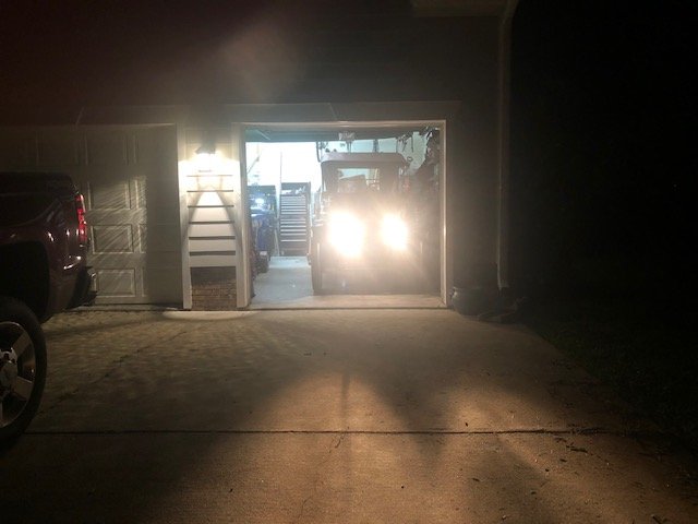

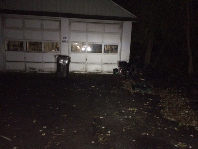

I have a 1915 car with two contact headlight bulbs that are wired for high beam and low beam. The car is set up for 12 volts. The incandescent bulbs are 27 watts each on high beam and 8.3 watts each on low beam which works out to 2.25 amps each on high beam and 0.69 amps each on low beams at 12 volts. They are rated for 12.8 to 14.0 volts. The pins are diametrically opposed so I have to test their position when I put the bulbs in the lamps. The bulbs cost about $2 each on the internet.
I replaced the incandescent bulbs with LED bulbs, part number 1157-WHP28-T from https://www.superbrightleds.com/. They cost about $8 each but are supposed to last 13 times as long, probably longer. 6 volt LED bulbs are also available from Super Bright LED's. They produce 550 Lumens each on high beam and 75 Lumens each on low beam. The current is 0.03 amps each on low beam and 0.42 amps each on high beam. They are rated at from 9 volts to 14.8 volts. The pins are not diametrically opposed but offset so I had to file off the pin that is furthest from the contacts. I had to test the bulbs to make sure they were on high beam when my switch was on high beam. It was easy to tell the difference. The LED bulbs do not have the point source like the incandescent bulbs so the light is spread out horizontally and vertically.
The LED bulbs are definitely brighter. My phone camera compensates for the increased brightness by reducing the exposure time. Below are some photos. If I have the order correct, the first one is a picture of the LED and incandescent bulbs from the Super Bright LED's web site. The second one is a view of the incandescent bulbs on high beam from the driver's seat. The diffusing lenses are not installed in the head lamps. The third photo is a head on photo of the incandescent bulbs. The fourth photo is a view of the LED bulbs on high beam from the drivers seat with the lenses installed. The fifth photo is a head on shot of the LED bulbs on high beam. I am going to have to remember to dim my headlights with the new LED bulbs whereas this was not necessary with the incandescent bulbs.

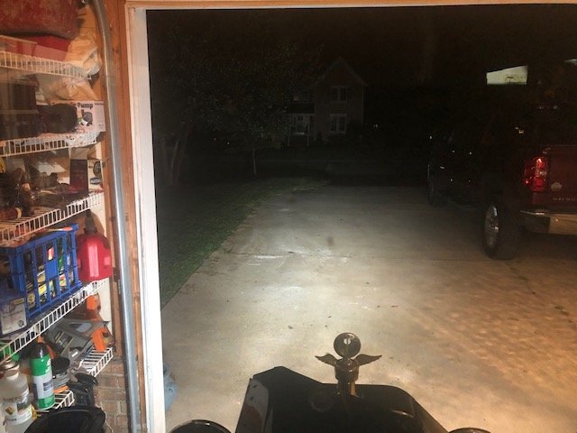

Re: LED headlight bulbs
Here is the correct fourth photo, which is a view from the driver's seat with the LED bulbs installed.
The comparison would be better if the headlights were properly aimed. Both photo's show the rear of the truck but neither show the front wheels. One photo seems to show the house across the street, the other not - better for driving I would think. Bright lights make you more visible to other drivers but not necessarily illuminate the road any better if not properly aimed
The target parameters for adjusting Model T lights is the same for Today's headlights.
https://raybuck.com/how-to-adjust-align-headlights/

Hi Frank,
Thanks for the reply.
The LED's are brighter than the picture shows. My phone camera compensates for the added brightness by reducing the exposure time so the lights seem not as bright in the photo as in real life. The house across the street was more visible with the LED's. You are right that headlights should be properly aimed.
Neil

The less sure are brighter! So much so that you are likely to upset oncoming drivers. I have yet to hear of an led conversion which can satisfactorily be focussed. Aiming is just part of the deal. You can aim a focussed beam, but not a bib blob.

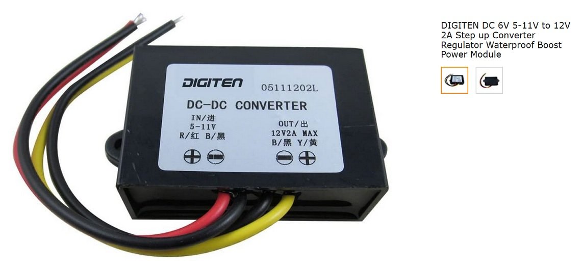

Has anyone considered using a step-up voltage converter similar to the photo. search on (6v step up voltage converter) to solve the 12v needs. https://www.amazon.com/DIGITEN-Converte ... 7476086225
It has a wide input range 5-11 volts DC and outputs 12volts DC with a max of 2 amps. This should allow using the 12volt BA15D base headlight bulbs. Not sure if wiring between it and the headlights needs to change. Some even have a USB connection.
There are many similar devices - some I believe could be adapted to a voltage regulator as well.
