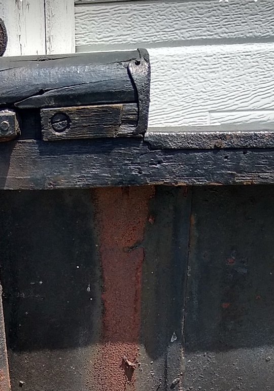

I just picked up a low cowl roadster body. Is there any way to figure out what the year is? I can post lots of pics, but I'd just be guessing. Tell me what I should be looking for or you want to see to help me ID it. Thank You forum for your help.

Did the upper cowl appear to have a metal dash? If so 1920-23? And did the front of the seat riser (driver side) have a hole for a starter button?

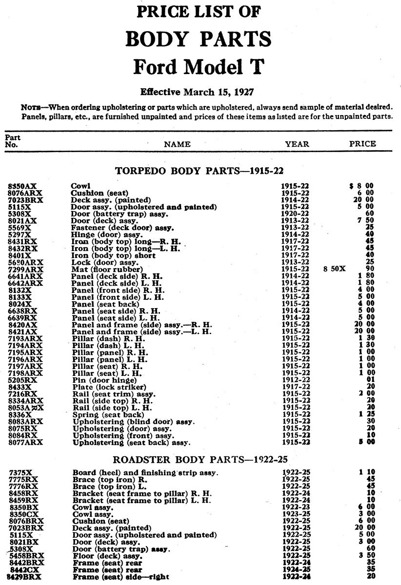

Above the door at the end of the arm rest is a metal end cap. The large one is for 17-22. The small is 23-25. From your photo it looks like it may be the large one.
Photo from Snyder catalog.

Yes, It has the large caps, but that makes sense being its a low cowl body.

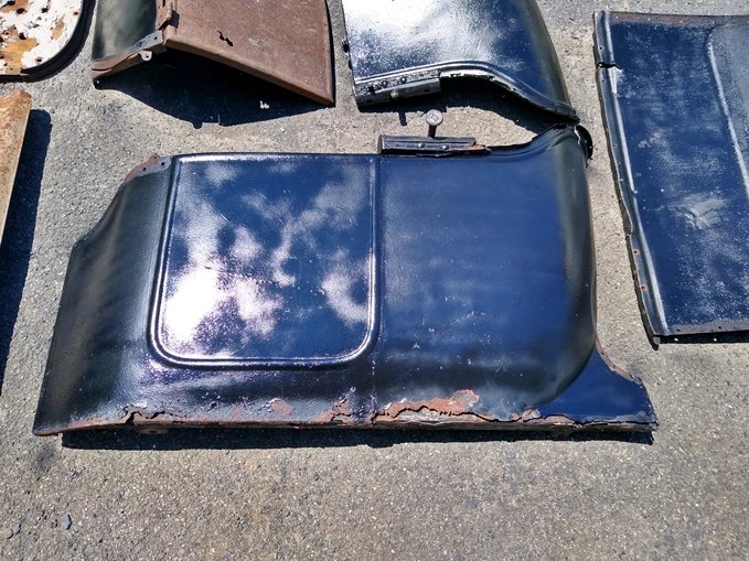

Post by Chad_Marcheese » Sun Jul 12, 2020 8:57 am
Found a little more info. This is a pic of the seat riser from the car (not in my possession yet). It is meta and has a hole for a starter switch. So according to the sites encyclopedia it should be the earliest of 1920 (as 1918-1919 cars had wooden seat frames, and starters were first introduced 1919)

It's interesting this calls 15-22 a Torpedo rather that a Runabout. According to this, except for the Battery trap door, everything from 1917 or earlier is the same thru 1922 or replacements will fit. We know the cowl changed several times so this may not cover subtle changes. I hope others will mention any other differences. Otherwise they are all pretty much the same.
I should have realized the large caps weren't a logical clue.

I have a 1919 Runabout, Roadster , Torpedo or whatever you want to call it just like what’s pictured. I restored mine to as close as I thought I could get to what I thought it was.
In saying all that I decided it was at least a 1919 because of the seat riser which had the hole for the starter switch.
Going by what you have it appears this car, parts is a 1919 because of the electrical equipment. (Starter) maybe actually a 20 depending on when it was built. Hard to pin that down for sure.
