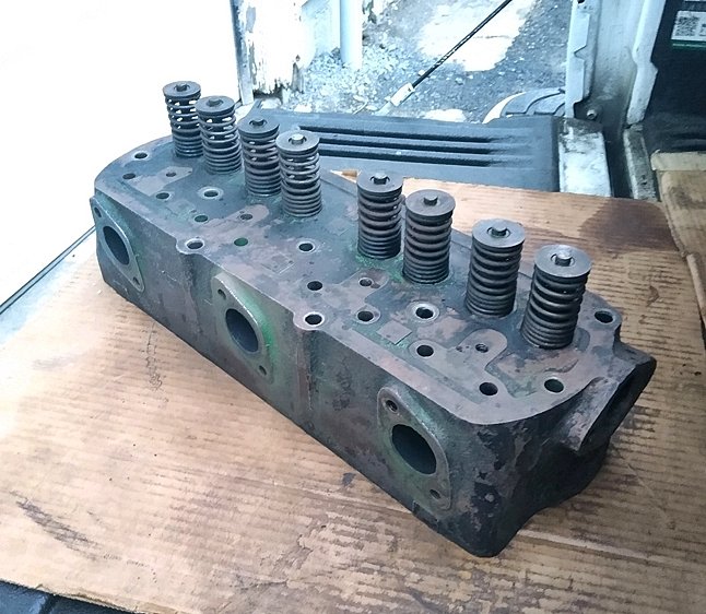

The black might make sense, under the layers of paint on mine was indeed much remnants of black paint that was on there like it was welded. Took the bake and blast machine at the machine shop to get the head spotless.

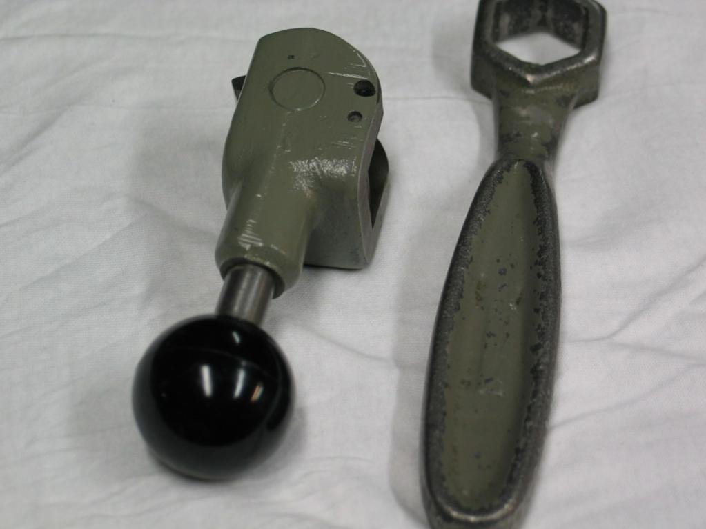

Duey, the "machine grey" I have seen over the years is just your typical grey, but has a slight olive drabe tint to it.
Remnants of black after the initial parts washer cleaning on my "T" Fronty head:

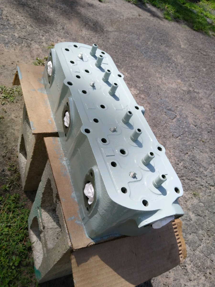

Just for future reference, The paint was mixed and while the color is hard to pickup with a camera and on screen, it is what I call "machine grey", or a very light mossy green. it is a grey green color, popularly seen on large shop machine equipment.
This is to my best research over several weeks, the correct approximate color for all the single port Frontenacs.
