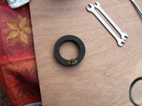

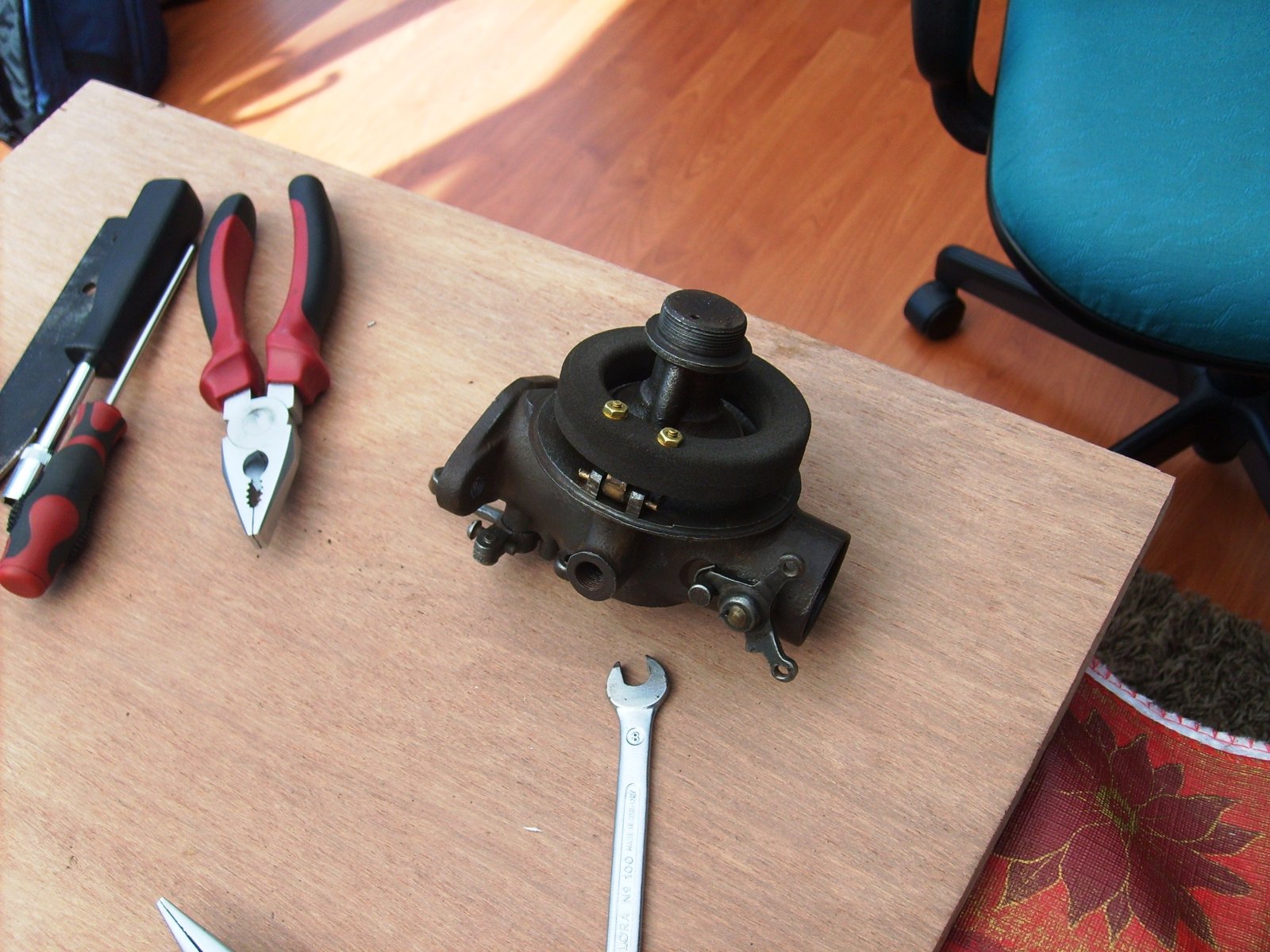

Post by AndreFordT » Sat Jul 18, 2020 1:01 pm
I think it is this one you are talking about.
I not only use it in the holley G carburetor. I take it as base to build other floats as I can't find the right one. It is an easy material that gives good results but while grinding and sculpting it to fit you need to wear a mask.
Last time I used it was for the rebuild of the float for a four balls kingston
Andre
Belgium
