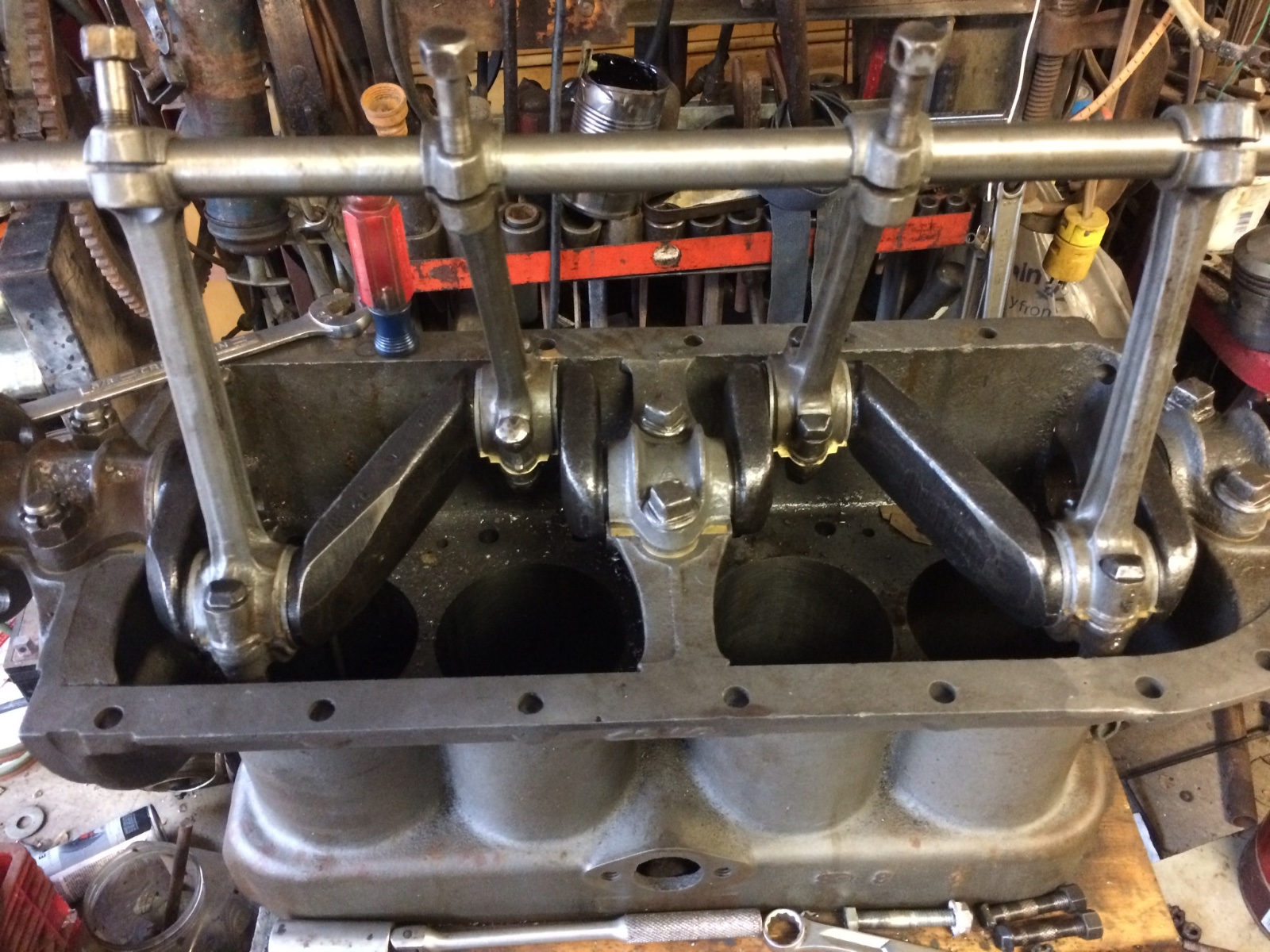

A steel rod turned to .740 and long enough to go through the four rods is an easy check for rod straightness once the rods are fitted to the crank.
