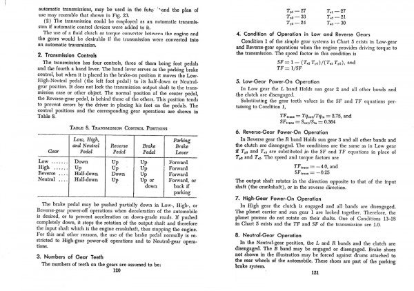

Technical description of the Model T Ford transmssion
Post by John E. Guitar » Thu Jul 23, 2020 9:28 pm
I came across this going through some old papers. Unfortunately I don't have details on the book title. My best guess is that it was a book on automotive transmission design from the 40s or 50s.

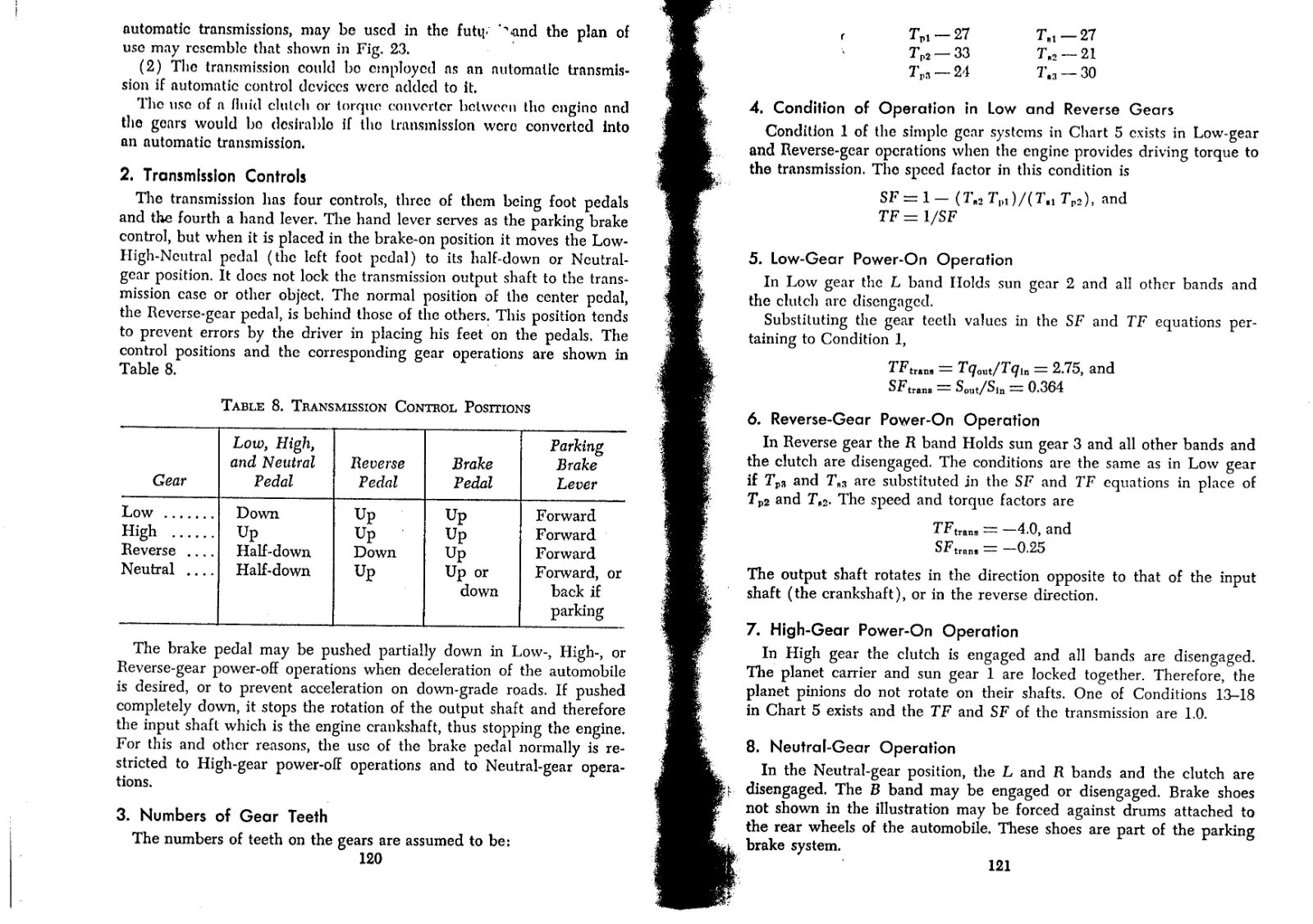

Interesting read.
Here is a 'tidied up' version:
