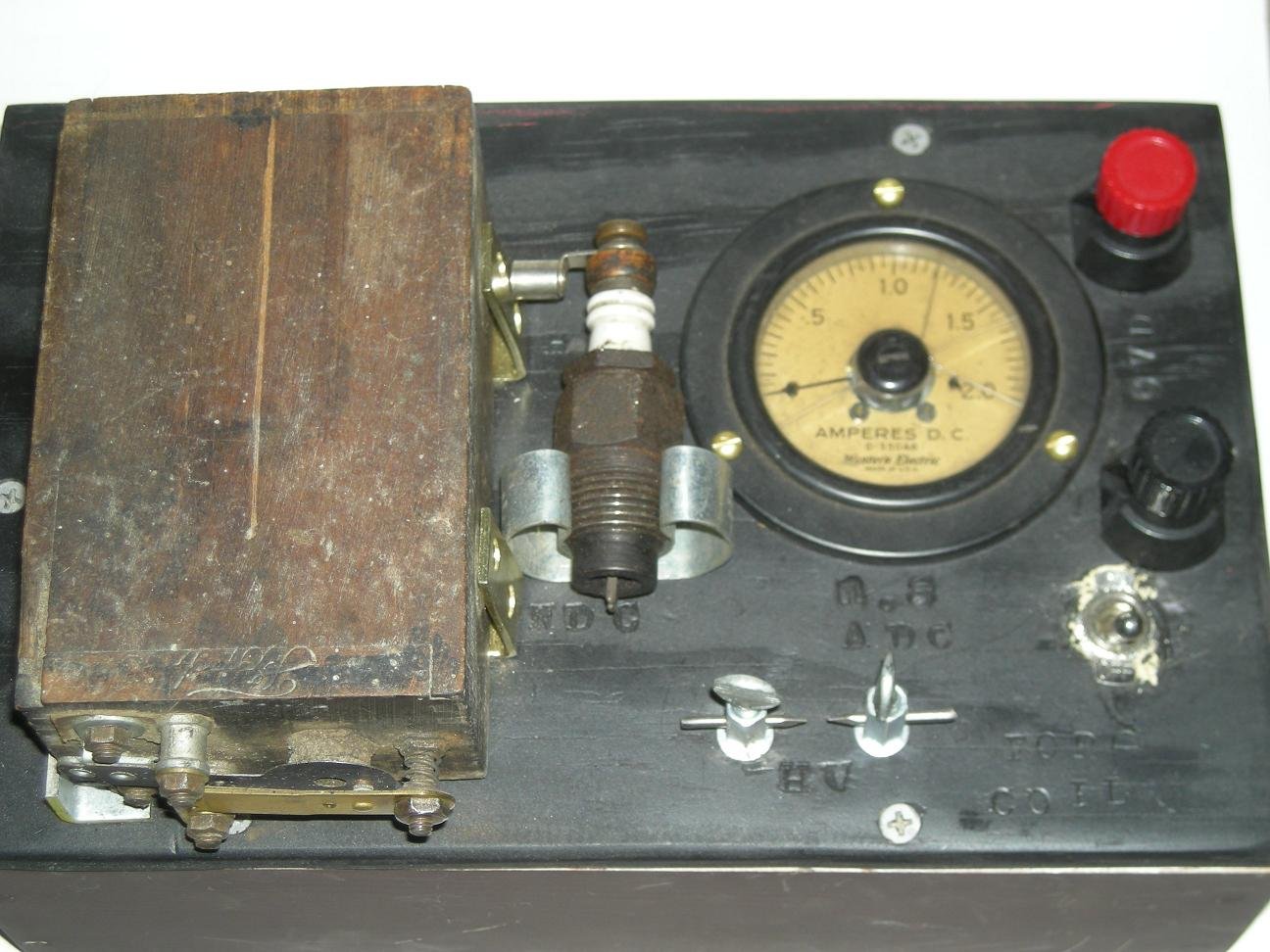

Coils, when dialed in well, typically stay dialed in for quite a while. One might presume
original owners had easy access to garages with the tools and used them as needed. I set
up my coils 5 years ago and have not messed with them since. I bought a HCCT tester a
couple years ago and have yet to use it.

Took them to a dealer. They had the HCCT.

Also, it probably only cost them 25 cents to get it done. Ford Universal Service.

Also because of the number of Ford on the road, there were many general repair shops that had the HCCT after they were introduced to the market. The HCCT was not just a Ford shop tool.

Nearly every auto repair shop (Ford and otherwise) had a HCCT.
It was a money maker.
A HCCT cost s little as $40.
It didn't take long to pay for it self.

Of course if you lived a few miles from a dealer what would you do. No HCCT, no electronic device, no telephone or even internet. Just your owners manual. Maybe a copy of the Ford Owner. Well you buy or make a coil tester and set your coils to draw 2.5 amps.

Adjusting by ear was how it was done before the 1914 style coils came out and seems the practice was carried on later. Unless the 2 nuts were replace by a knurled nut, not an easy task to do.
A friend of mine who is in his 80's keeps wanting to do that, adjust by ear, I keep telling him not too. After he messes with them, he brings them to me to reset on the HCCT (which is his anyway).

Actually, if you really know what you’re doing and know what a correctly set coil sounds like, then you could have very good success getting them real close If you set them by ear while running on magneto at a very low idle. There is a distinctive “clack” right around the sweet spot on most coils.
