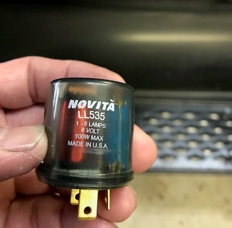

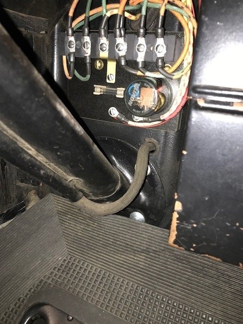

Post by BrianE63 » Thu Sep 03, 2020 10:02 pm
Mark,
I have been running this LL535 electromechanical 6 volt flasher for my turn signals and it has a nice steady flash rate even though it lives right next to the coil box. It has been working fine for over 5 years with 6CP front and 21CP rear incandescent bulbs, and flashes the same whether the engine is running or not.
Best regards.
