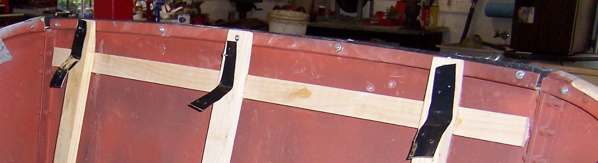

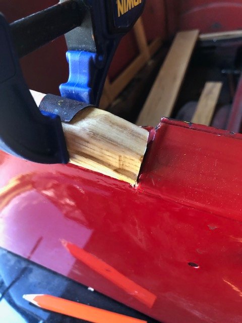

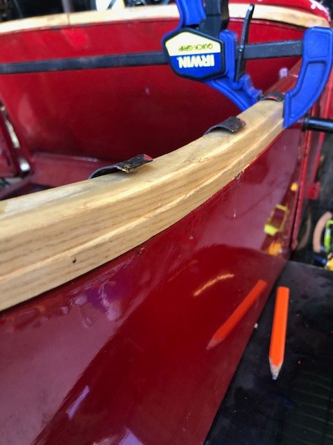

Here are the pics of the first piece of the rear tack strip.
Does this fit ok? The end point just does not seem right.
I will post the other parts as I get to them.

How is the best way to attach the tack strip to the sheet metal?

Your tack strip is looking great. :) The terminal end seems fine, you want a bit of taper as the upholstery material will be folded over it, I like to fold under about 3/4" to 1" of material for a rolled-under look, hidem welt will cover.
The wood was mounted originally with stove bolts, drill and countersink holes on the outside, through the wood tack strip, place the stove bolt ( flat head taper type) single slot, and then lock washers and hex nuts on the metal inside. You should find holes around the perimeter of the body edge for them.
