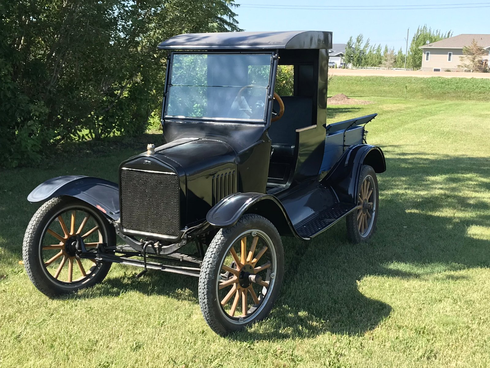

So I got my truck together for the first time ever and I've been driving it around the yard. I can't get plates for it until I get the lights working and find a horn for it. It seem to run smoother on battery (6V) than on mag. When I switch over it changes the sound of the motor, and it seems to be running on all cylinders on both but just seems better on battery. I know the coils need to be rebuilt, I put new points on them years ago but I don't have a coil tester to set them properly. will poorly adjusted coils or coils with bad capacitors run better on battery than mag, or is my mag the issue? At any rate, I need to find someone to do my coils. Does anyone in Manitoba do coils? I live right near the US border, and I used to go across to ship things in the US, but now with Covid and the border being closed, shipping to the US costs a fortune and I'm cheap!
