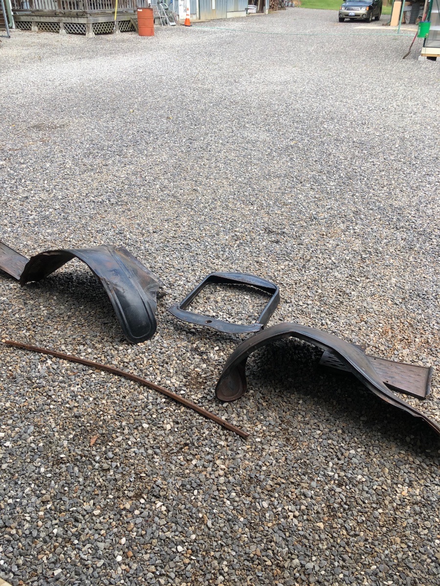

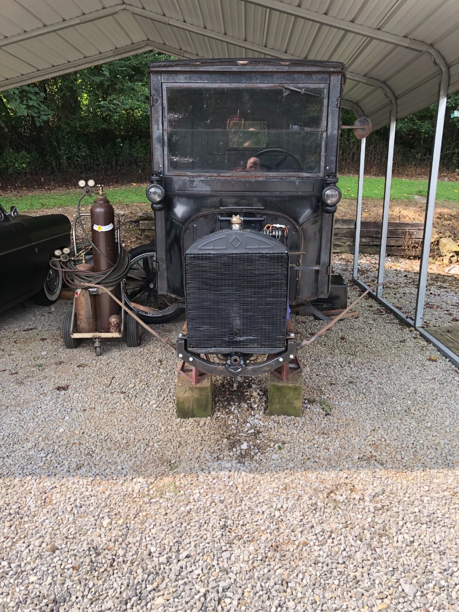

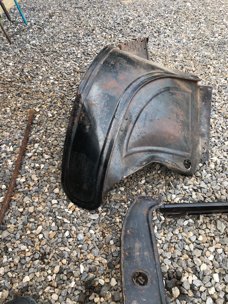

So this does not happen to others. Everyone is just fine, just a little pride dented.

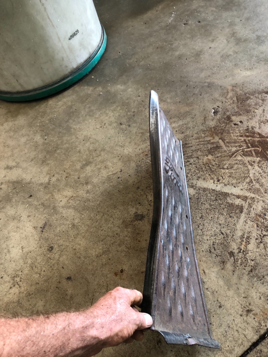

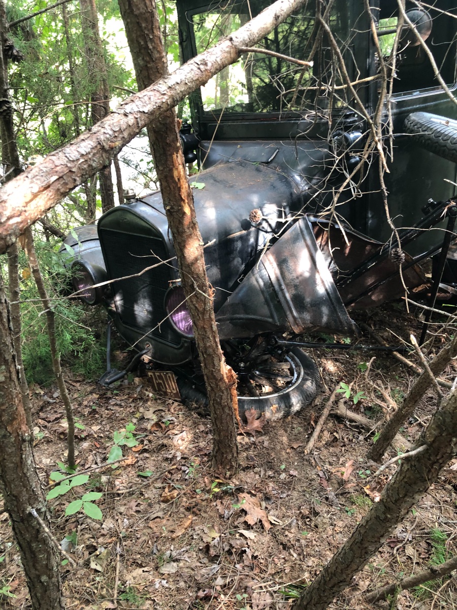

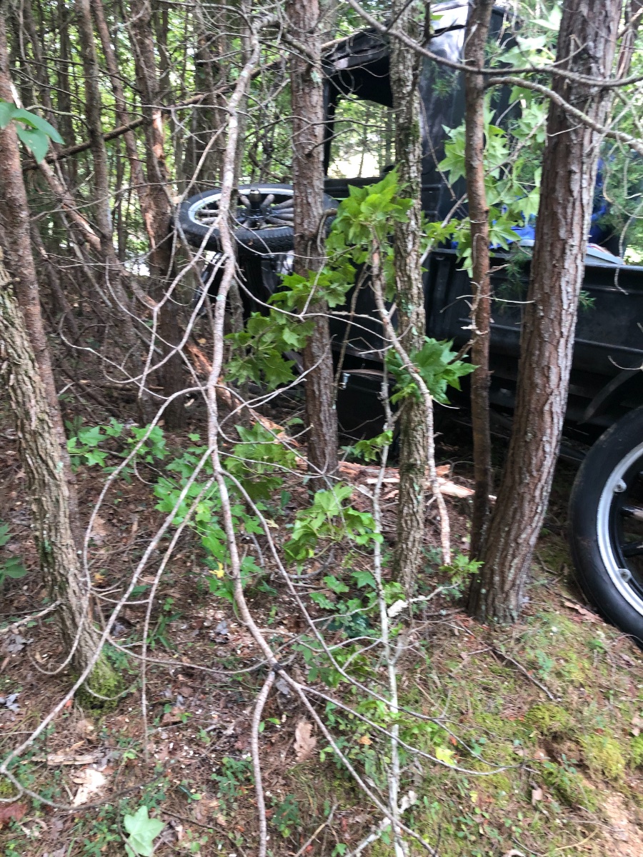

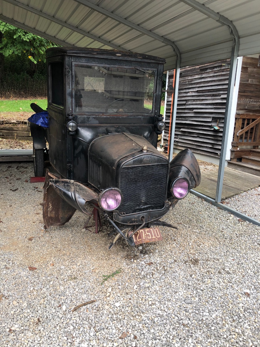

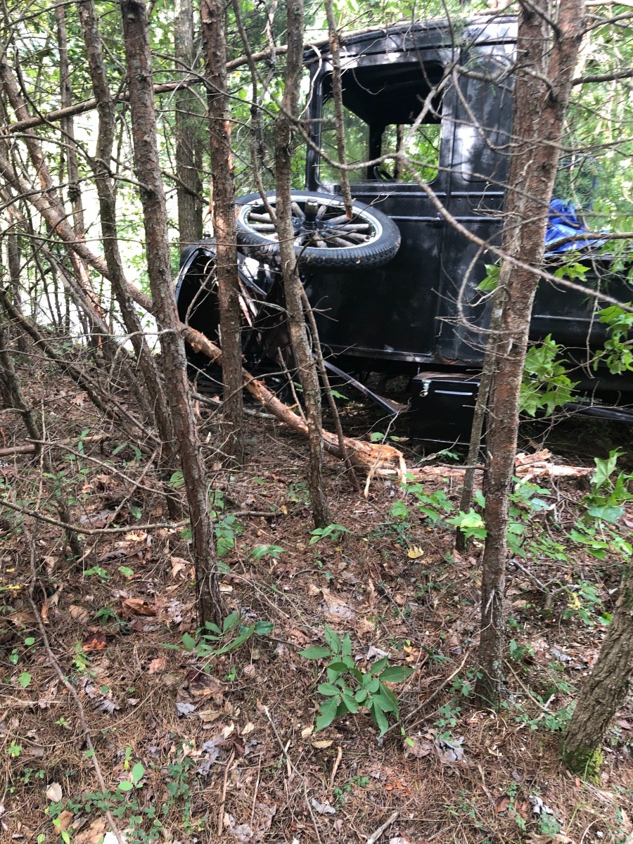

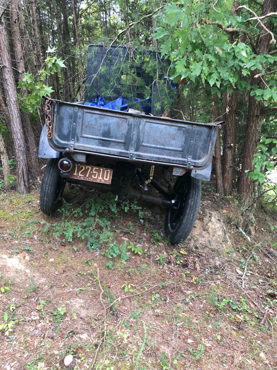

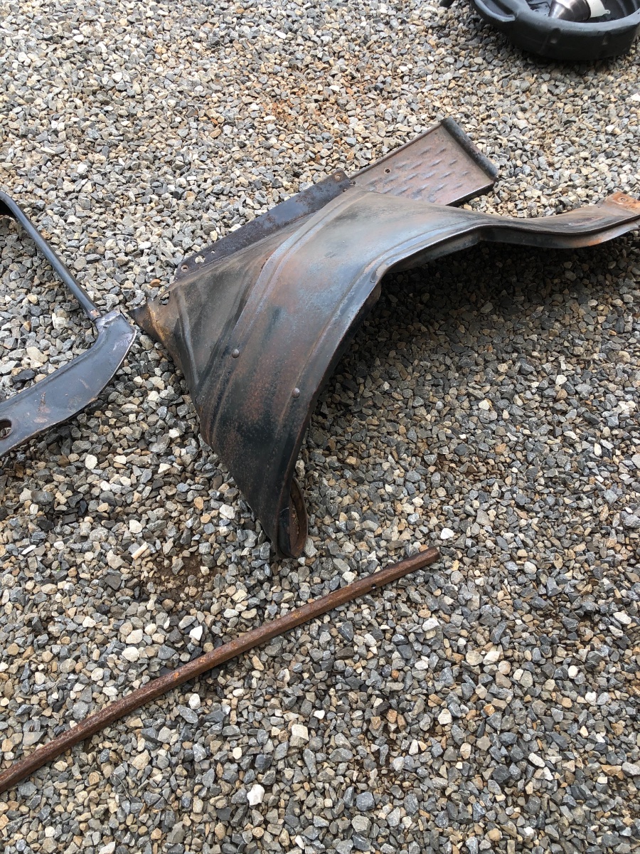

Was showing Rick how well his new TT runs and operates and coming down a hill the accessory Rocky Mountain 6 Speed Transmission jumped out of gear and would not go back in. New emergency brakes with linings would not hold back as they were not seated in fully. A Real Run Away! Rick in the driver seat, me in the passenger, Rick yelling.., "What Should I Do"!.., me.., "Hang on and let me steer"! Aimed dead on to a pine tree thicket. Looks bad but really is not. Was able to steer it right into the trees and knock out the energy with a couple of three inch trees. Already have all the parts in the works so it will be back up and going in no time.
PLEASE FOLKS, NEVER UNDER ESTIMATE ANY T WITH AN ACCESSORY TRANSMISSION AND A NEUTRAL! ACCESSORY BRAKES ARE A MUST!!!!!!
I AM POSTING THIS AS A REMINDER AND MY MISJUDGMENT! No one was hurt.., Thank God!

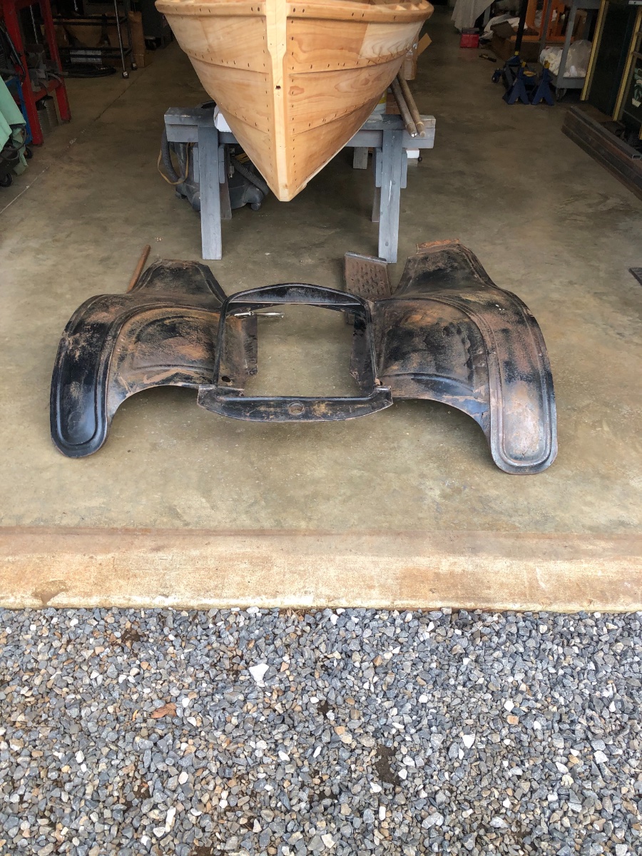

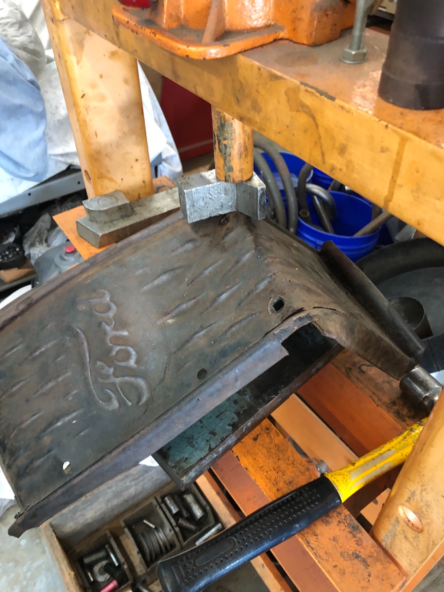

Only the fenders, running boards and mounts, a little hole in the radiator, drag link and wish bone damaged. Not bad for a 35 mph impact.
Humble Hank with soiled under pants in Tin-A-See

This was good thinking. It CAN happen.
That T will live again!
Main reason I won't run my TT down this hill until he has brakes, just in case the Warford comes out of gear.
No brakes what so ever on the axle, sooo....
The others have and are tested every time down.
Sure isn't the end of the world tho.

What part of my emergency procedures did you not understand? Very simple.., do not panic, have a plan prior to the event. 20 plus years in the military and being raised by stern parents got me through this! It is nothing more than metal that is repairable or replaceable. The human body is not so well as we age. Have a triple back up plan..., period! I am using my misjudgment as an example, as I was prepared but my driver was not, took control of a bad situation and we are here to tell the tale for others. Really to late to talk 20/20 hind sight.

I just tuned in here. Wow! Glad you guys are fine.
My dad always used to say that if things went bad, and you had to hit something? Hit something cheap! (And preferably soft?) It may sound flippant? But it really is good advice.
Almost any time I drive, from when I was driving my grandfather's tractors on the ranch? To this very day? I consider my surroundings, and ask myself "what should I do if XX happened now?" I consider things falling off of trucks ahead of me. I think about a tree falling over. Consider some other car shooting across the lanes out of control. I ask myself "what if?" That has saved me several times. Because I have had most of those things happen a few times over the years. I did have to dodge a bicycle that fell off the back of a van that had just passed me (ever wonder how a bicycle would bounce at 70 mph? Like a football, this way that way another way and back again!). I did need to swerve around a load of lumber that slid off a truck. I have managed to avoid several out of control cars from odd directions. I always look for my "out" in case it may become needed. And when the brakes on my modern pickup blew out as a light turned red? I knew my out. No harm. No foul.
Can situations arise where there is no true out? Yes. And Hank and my dad have given good advice. Hit something soft and cheap. Cars can be fixed.
Now go out there and plan ahead!

I feel like I need to jump in here. I, my wife Tammi and our dog Ella were blessed to arrive back home a bit ago from a very pleasant and relaxing day. We dropped by Hank's house today to drop off some piece-parts to aide in the repairs of my TT. We both had a very nice visit with Hank and Pat and we again thank you for all of your hospitality and for the awesome green peppers you cut fresh for Tammi right out of the garden. Times like we had today with good friends are what is important.
Regarding Jim's comments and questions, I must respond in order:
DAMAGED VEHICLE:
Yes, it is always disappointing to anyone to have one of your toys get torn up, but Jim, you just don't get it. We freaking walked away and nobody got hurt! In short and to keep things real, it's just rusty old metal. That said, it will certainly live again soon and going forward I will have a bit more appreciation and respect for the old slammer.
20-20 HINDSIGHT, WHAT WOULD YOU HAVE DONE DIFFERENTLY:
The answer is a resounding NOTHING! Jim, there was only one option and Hank took it. When you're driving slowly and carefully down a steep grade and the auxiliary transmission jumps out of gear, the vehicle instantly starts picking up speed and you very quickly discover (maybe 2 seconds?) you have ZERO stopping ability. Believe me brother when I say it, you are on a high speed roller coaster that is out of control and it won't stop. I was in unfamiliar territory, free wheeling down a steep grade, trying to stay on a narrow country road, all the while pushing the brake pedal through the floor-board and not understanding why we were going faster and faster. Thank God Hank remained quietly-calm and literally grabbed the wheel and steered the truck off of the road and directly into a grove of young white pine trees. Next time you're going down a grade, you picture yourself calmly steering your vehicle off of the road and intentionally crashing into the trees. I reflected much about it last night and re-played the whole experience in head many times. The man has BALLS!
PLANNING OUT EMERGENCY PROCEDURES TO ENACT IN CASE OF SITUATIONS LIKE THIS:
The word is very simple. Prevention. Jim, Hank's purpose for posting our experience was not so he could run his lips publicly about this mishap. He humbled himself publicly out of his sense of service to the other folks in our T-Community. It was in an
effort to share several decades of training and experience to help educate folks to hopefully help someone else from getting injured or killed. If you didn't catch it the first time, I will repeat Hank's statement. If you are utilizing an accessory (auxiliary) transmission in a T, ACCESSORY BRAKES ARE A MUST!!!!!! I must say, I am now a believer.
Finally and on a very positive note, I want to publically thank Hank for all that he has taught, done and continues to do for me. It is difficult to put into words Hanks' incredibly high level of "old school" personal integrity and sincere service to community. I am proud to call Hank Lee my friend!

Topic author - Posts: 5618
- First Name: Henry
- Last Name: Lee
Re: Even the Experienced Make Bad Decisions
Most can't believe metal being twisted so bad can be brought back like new and even stronger by an air hammer. Here is a days work with two bad teeth (crowns going bad), OUCH!
- First Name: Henry
- Last Name: Lee
- First Name: Henry
- Last Name: Lee
- First Name: Henry
- Last Name: Lee
I always use an APCO radius ball cap! Beautiful breakaway system and keeps perfect tension as needed. Also use them on the center link.
No damage at all to the oil pan, the front broken leaf spring did the skidding. No damage either to the front cross member.
The key to straightening bent/twisted metal is to reverse the damage as it happened. That book will explain it.
Hank
Hank

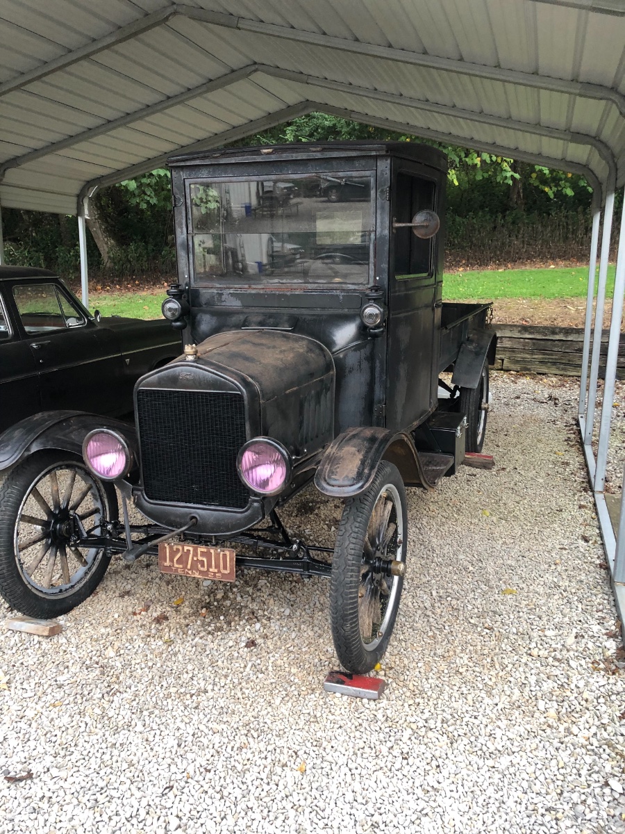

- First Name: Henry
- Last Name: Lee
And six days later..., Ready to go home.., again!
Locked the AUX transmission in low. I think Earl Shribes, Maaco, and Peach Auto Painting would be proud of that 95 year old paint match!
Hank
Hank

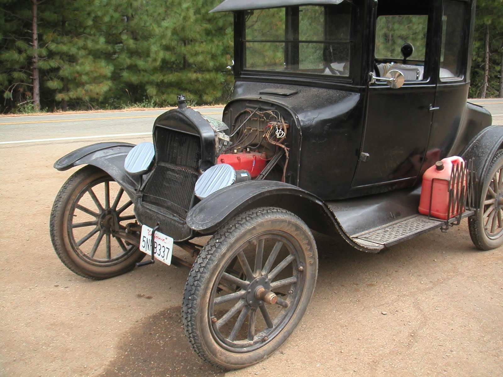

Ten Years ago I put together a Stag Tour and so I was the leader. Lee had his Coupe which he used to drive to high school (a few years ago). It has a Ruckstell.
On the way home I was doing about 40 mph down hill when Wham! In my mirror it looked like Lee was trying to get me to go faster. I started pumping my brakes which consisted of the service brake, Rocky Mountains and lined large drum parking brakes. In to the mix I used low then reverse when I got slow enough. Finally I got both cars slowed down enough that I was able to go across the road onto a gravelly patch on the opposite side.
Immediately after that patch the road got really steep down and twisty turney as it ran down a ridge in the forest.
Lee had broken off his shifter casting on the Ruckstell and was the second car in line on the tour. He had stock transmission brake and I think, unlined parking brake, no auxilliary brakes. He planted his T dead center on my pickup bed... so perfectly that he lost the radiator and headlights but NOT A SCRATCH on either fender and the hood popped off. Here we are ten years later and Lee Still thinks I saved his life (I didn't, it was all Rusty!).
Lee still hasn't repaired the Coupe, in fact he hasn't driven a T again! I agree with the sentiment that auxilliary brakes are essential. Without mine Lee and I would not have been able to stop before hitting the treacherous downhill stretch.
TH

BIG WOW Terry!!!!!
Could have been very bad too!
Hank

Daaaang, Hank! Fantastic work...and in only a few days! No wonder you weren’t as upset as I would have been. You are a magician. LOL! Jim Patrick

Thanks Jim.., I really hate to admit but it is a specialty in panel restoration and too boot, the two young men just finished an assignment I did for them on reversing damage on panels. They were comprehending every step perfectly. Talk about an opportunity..., accidents happen sometimes for a reasons beyond our understanding.

Is that the same radiator?
Amazing job!
Amazing job!
- First Name: Henry
- Last Name: Lee
Yes Mack it is.., believe it or not.
