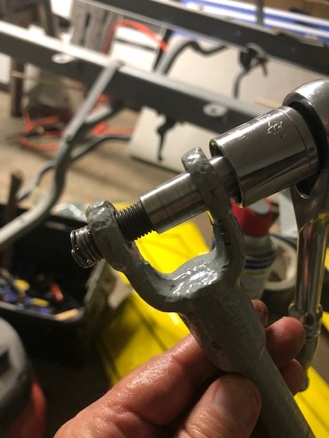

Hi my tie rod end is stuck. I've heated, I've penetrated oiled, I have twisted with a drift on the other side, I've stuck a chisel into the split, it won't budge. My vise is currently non-functional.

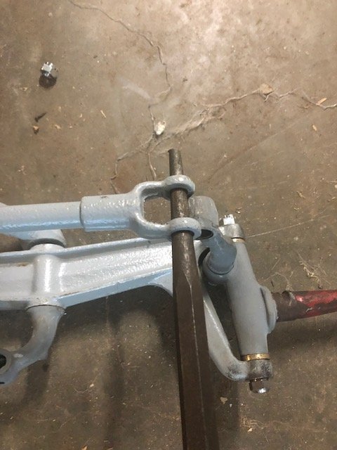

I would suggest you put the spindle bolt back in place and then use a long bar through the loop between the bolt and the end of the rod and try again. You might even do this with both ends and have a friend hold one end while you turn the other.

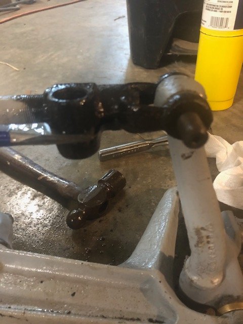

Mark the tie rod end that has the drift in it is already pre-boogered, the threads are long gone. I wonder if a tap would have enough metal for threads?
Mark Gregush wrote: ↑Sun Sep 20, 2020 4:27 pmCareful with the punch, don't booger up the thread in the bottom, then you will be looking for a tap.

I see no threads showing beyond the shoulder of the end. Are you sure it is made to screw off? Perhaps the adjustment must be done from the other end of the tie rod. Jim Patrick

The picture you posted, is not the side that comes off!
