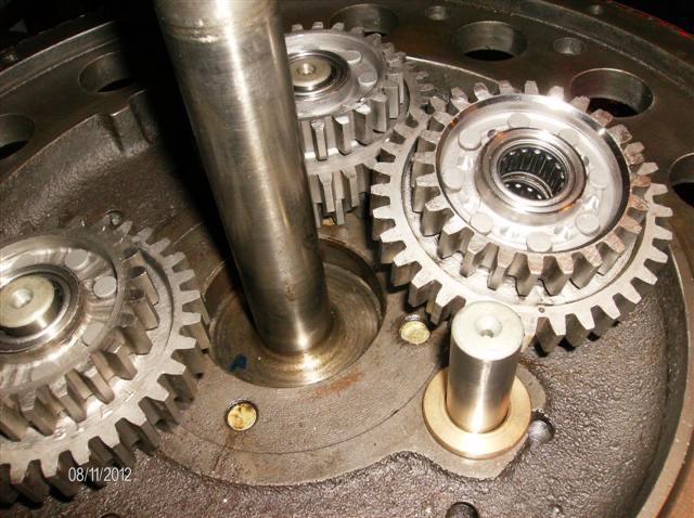

Just an FYI to all. I'm going to start production of the triple gear pins in the next few months. We have the steel on order for the 1st batch now. The pins will be made from a chrome-nickel alloy steel, properly heat treated and ground to size. This project is an outgrowth of making the special pins that are used with my needle bearing triple gear conversion. I've had multiple requests from experienced shops and individuals for a higher quality part, so I plan to make the 1st batch and see what the demand is. These will be available in various press fit diameters to accommodate different flywheel sizes. Thanks all.

I received some sets from Dan and can say.., “WOW” very nice and quiet! Super work Dan!

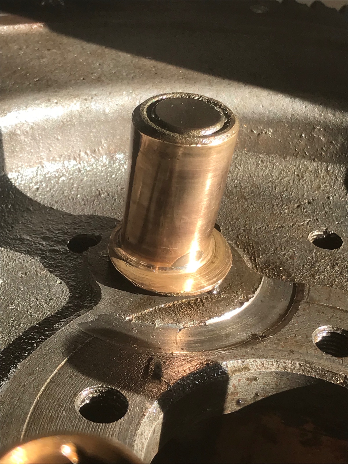

I can say the triple gear pin bearing upgrade from Dan is rock solid and worth a look. Just a really, really happy customer. The pic on the bottom is what it prevents, especially when you climb as many massive hills as I do.
Jeff
