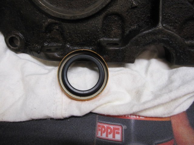

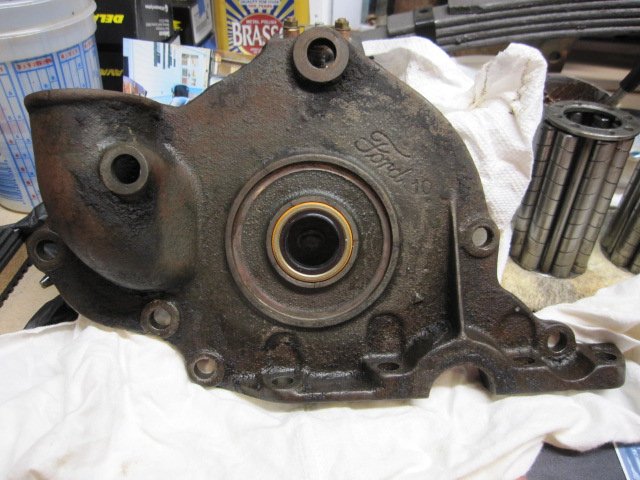

I have just recently done this and hope these pictures help. I also got the centering tool from Gene, perfect. The first picture is the seal side that faces the Cam or "inboard" the second pictures is how it should look installed, Kinda like the front wheel bearing seal.

PERfect! Thanks! I have another short thread on replacing the felt SE al for the crankshaft, but after reading, I also got the white rope. The last couple pictures shows it installed with a timing cover loosely installed, as I hadn't received Gene's indexing tool, yet.

Well, it's kind of weird, I did have to to squeeze the seal a bit all the way around to get it to somewhat stay in, but when I put it in with the front facing front it wanted to ooze out. And I didn't have that much our TV behind it, so I thought it was just the rubber seal itself hitting on something or some strange thing. I took it out cleaned it up and rtved it and put it in backwards and it stays without a problem. So I don't know if it will leak in that position or if it works fine, as well. If it's if it can't work that way, I guess I'll need to pull it out!

Dennis the seal lip is designed such that the open side goes to the fluid that is to be stopped. So in the camshaft application, the open side goes into the housing to hold the oil in the motor. Most T timing covers are a tad too big for the modern seal to be a press fit. Some distort the outer diameter to make it tighter. I prefer to fit it with a thin strip of brass shim stock and Loctite. Either way, it can be difficult to get the lip of the seal started on the shoulder of the camshaft nut. If it snags, it may hold up and invert in its carrier. That may be why your wants to pop out. It helps sometimes if you can crank the motor over so the shaft is rotating in the seal.
