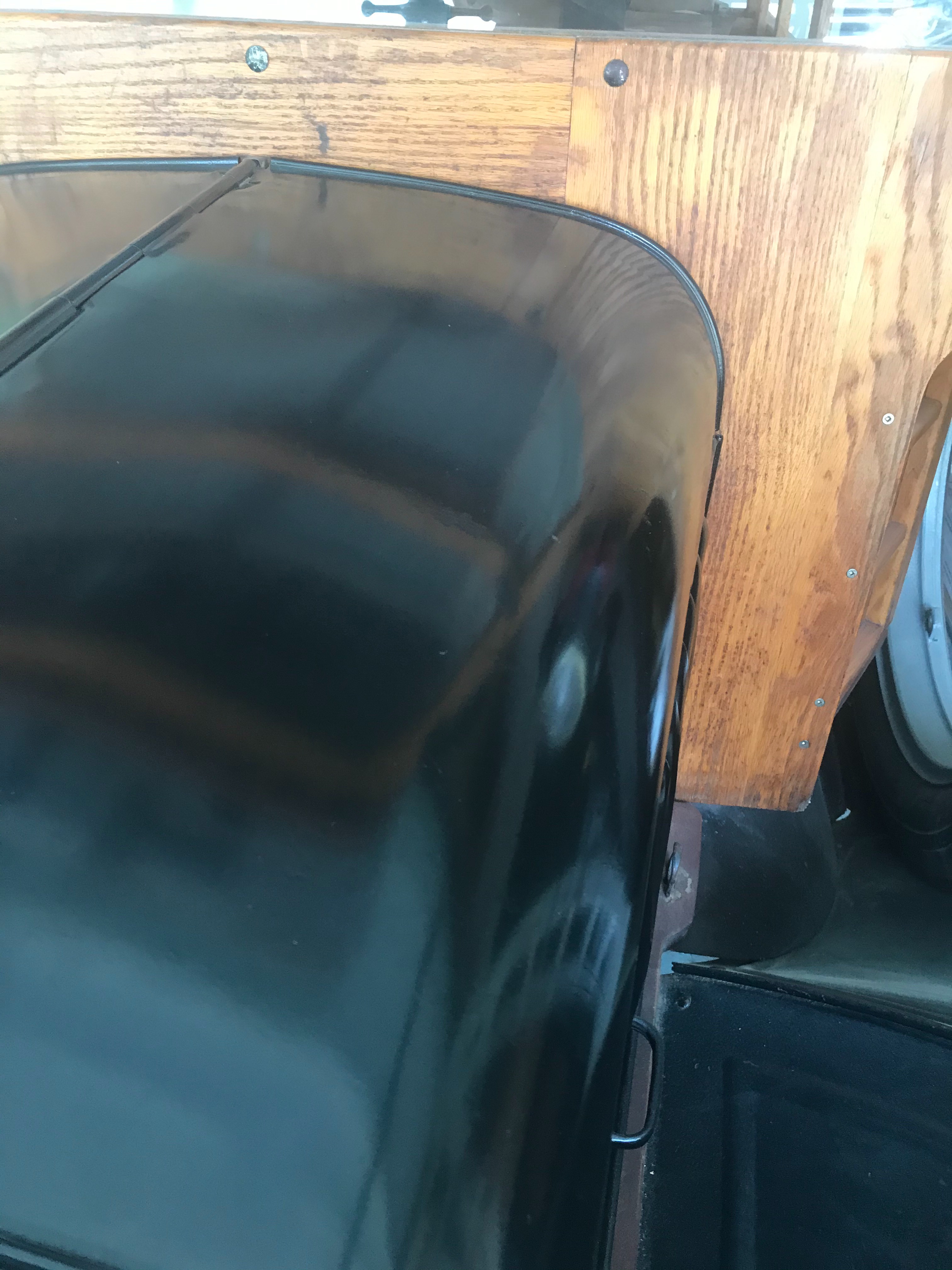

In 2012, I painted the below 1926 fender with one coat of Rustoleum Professional red oxide rattle can primer and two coats of Rustoleum gloss black Appliance Epoxy. I took these pictures shortly after painting without any followup work. I was very pleased and have used nothing but Rustoleum Appliance Epoxy, ever since. Jim Patrick
PS. Let each coat thoroughly dry and sand between coats. If you do not let each coat dry thoroughly, the following coat may soften the underlying coat and cause it to alligator which means you’ll have to start over.

Jim, Thanks. Did you use rattle can paint for the top coats on the fenders or just for the primer.

Yes. Rattle can “Rustoleum Appliance Epoxy”, available at Home Depot. Wet sand with 400 grit sandpaper to rough up the gloss and to remove any grit, runs, bugs or dust that may have gotten into the first coat. If you do a good job on the second coat, neither sanding nor compounding will be necessary. If there are flaws, carefully sand flaws out with 600 grit sandpaper. Take care not to sand through to the first coat. If you have to sand the second coat, compound with Meguire’s rubbing compound. Unlike most rattle can paints, Rustoleum Appliance Epoxy can be worked like professional auto paint. Jim Patrick
