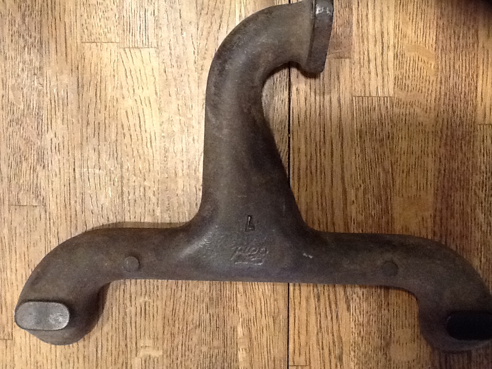

Any help is appreciated ford script with number 1. Any guess to what year.

At min. 1919 to 1926, regular cast iron intake, Ford began putting script on parts in 1919. The April 1924 listing in the Service Bulletins shows that #3062 Inlet Manifold factory no. T-512BR as being marked with Ford script. Many have letters and numerals added to i.d. the cast mold tooling.

What made me wonder is it has no other part numbers or casting numbers at all.
