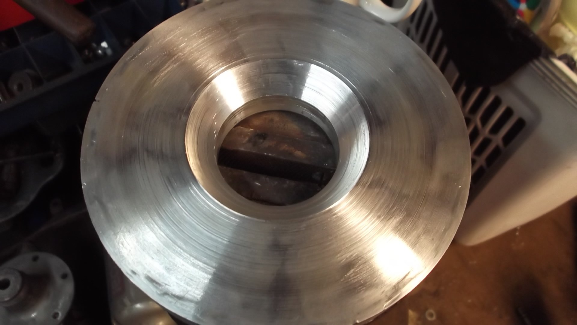

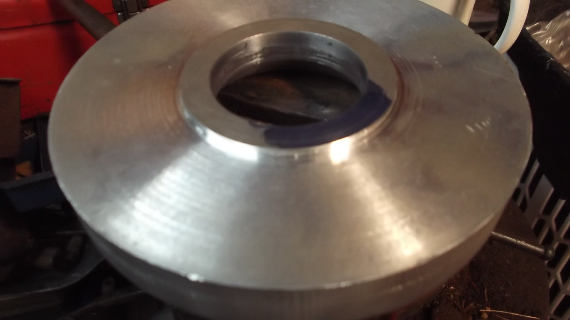

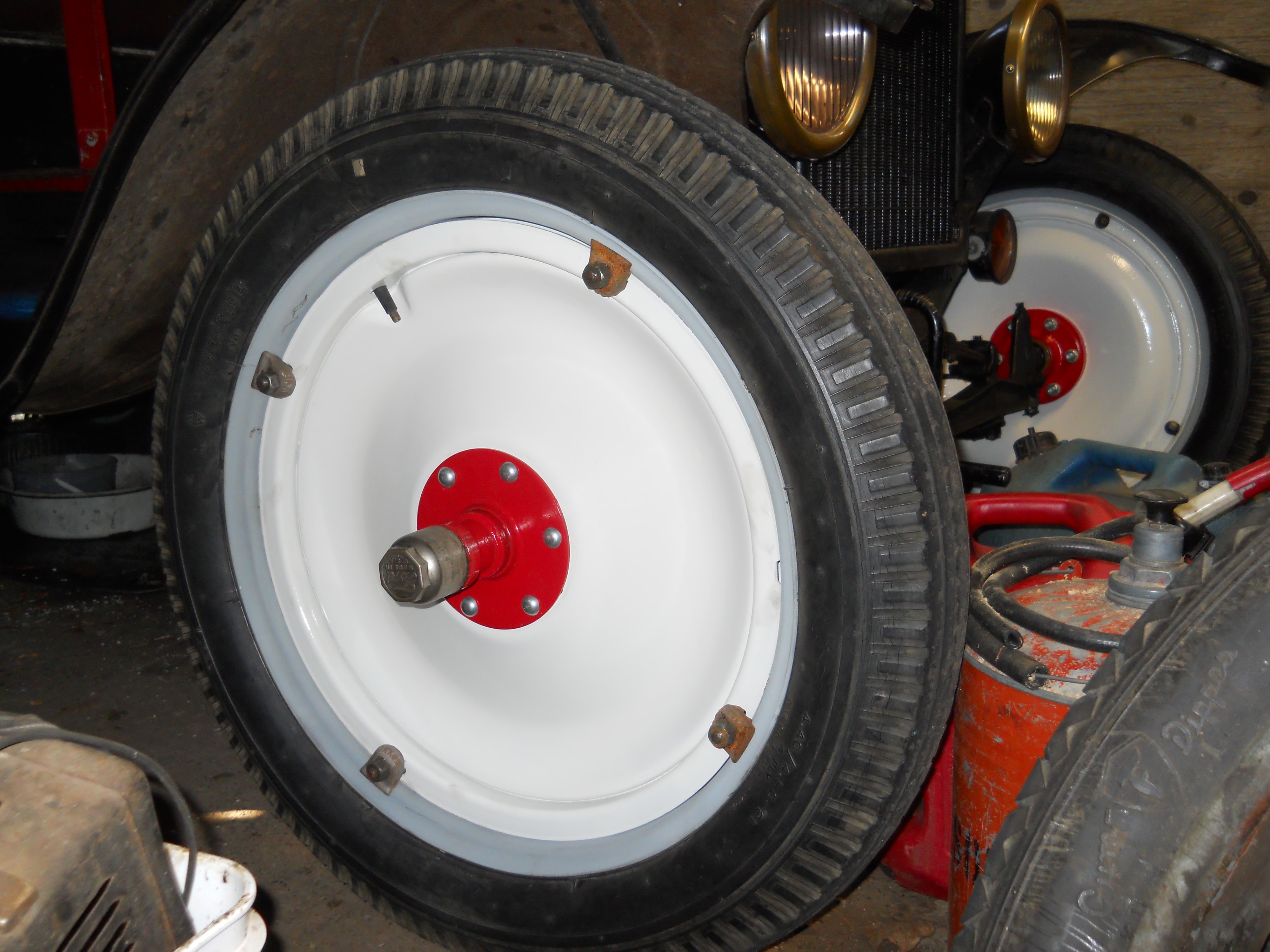

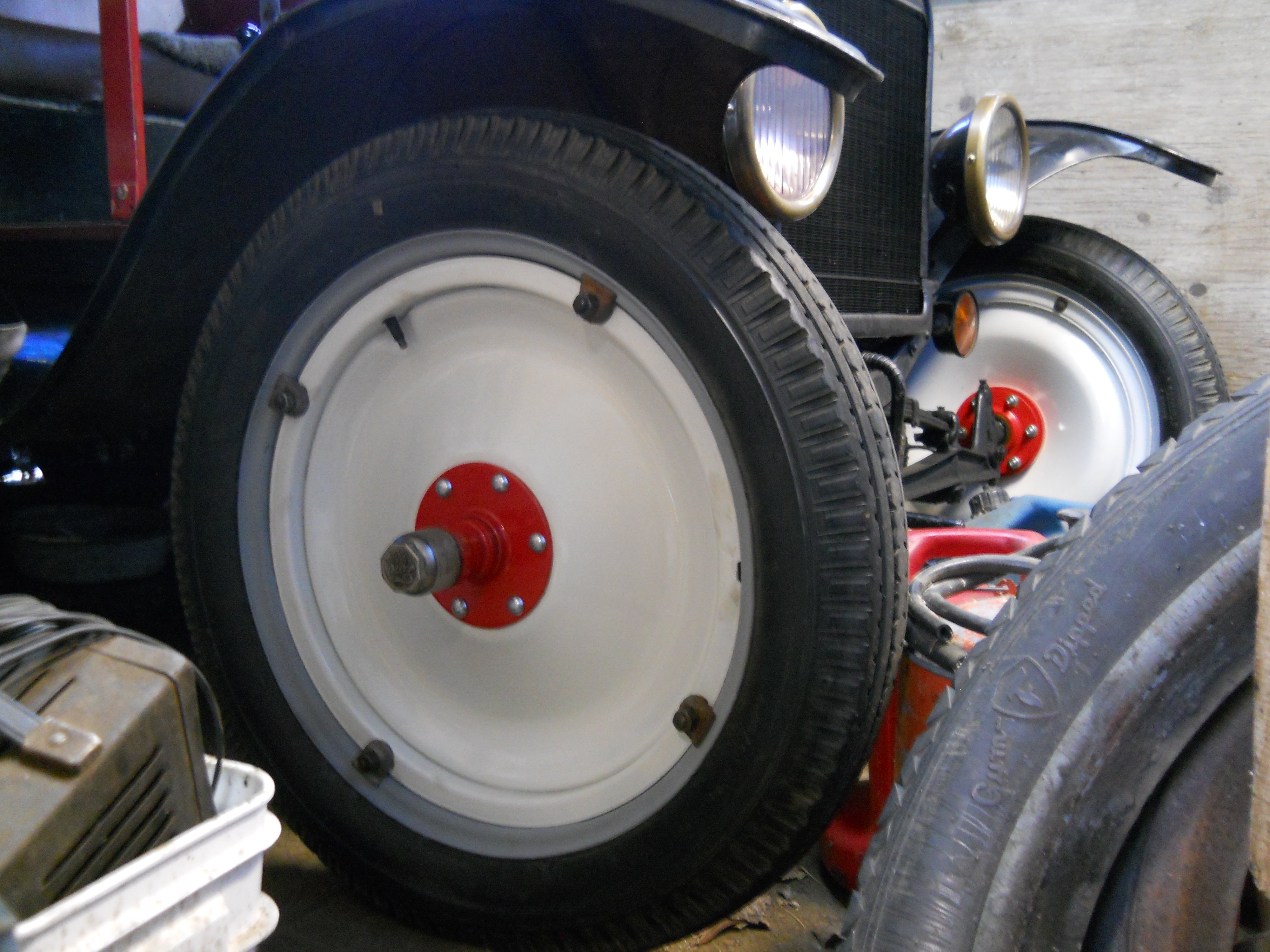

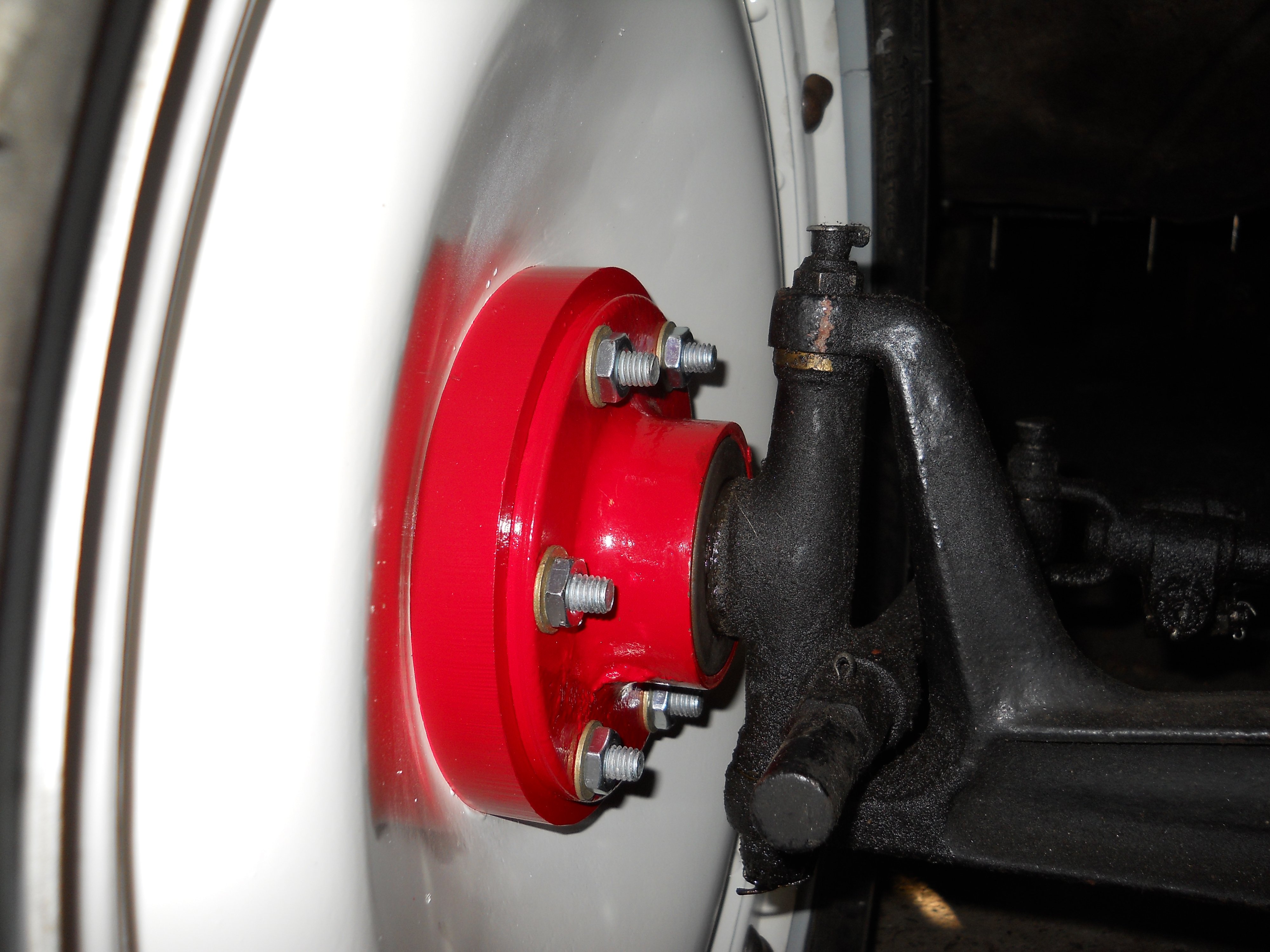

You will need to drill holes to match the Ford wood wheel hub and use the flange plate. I mounted mine with 1" thick 6061 aluminum spacers between the hub and wheel. I think 1925 was the first year for the disk wheels, but they are not the ones you want to use, not a lot of them anyway. The 1926/27 or 1928 would be the best bet. What ever year you use, make sure the rims are correct to the years. In 1928 the rims got wider as well as the felloe on the wheel. The wheels are somewhat easy to find, the rims not so much. it took me a while to find a set of the Jaxon lugs, bolts and correct rims. The inside dimeter of the hole that goes over the hub is larger so when I made my spacers I added a lip for the wheel to sit on when installed. When I bored the hole to install the on the hub, I picked an average for press fit, some being a bit tighter then others.

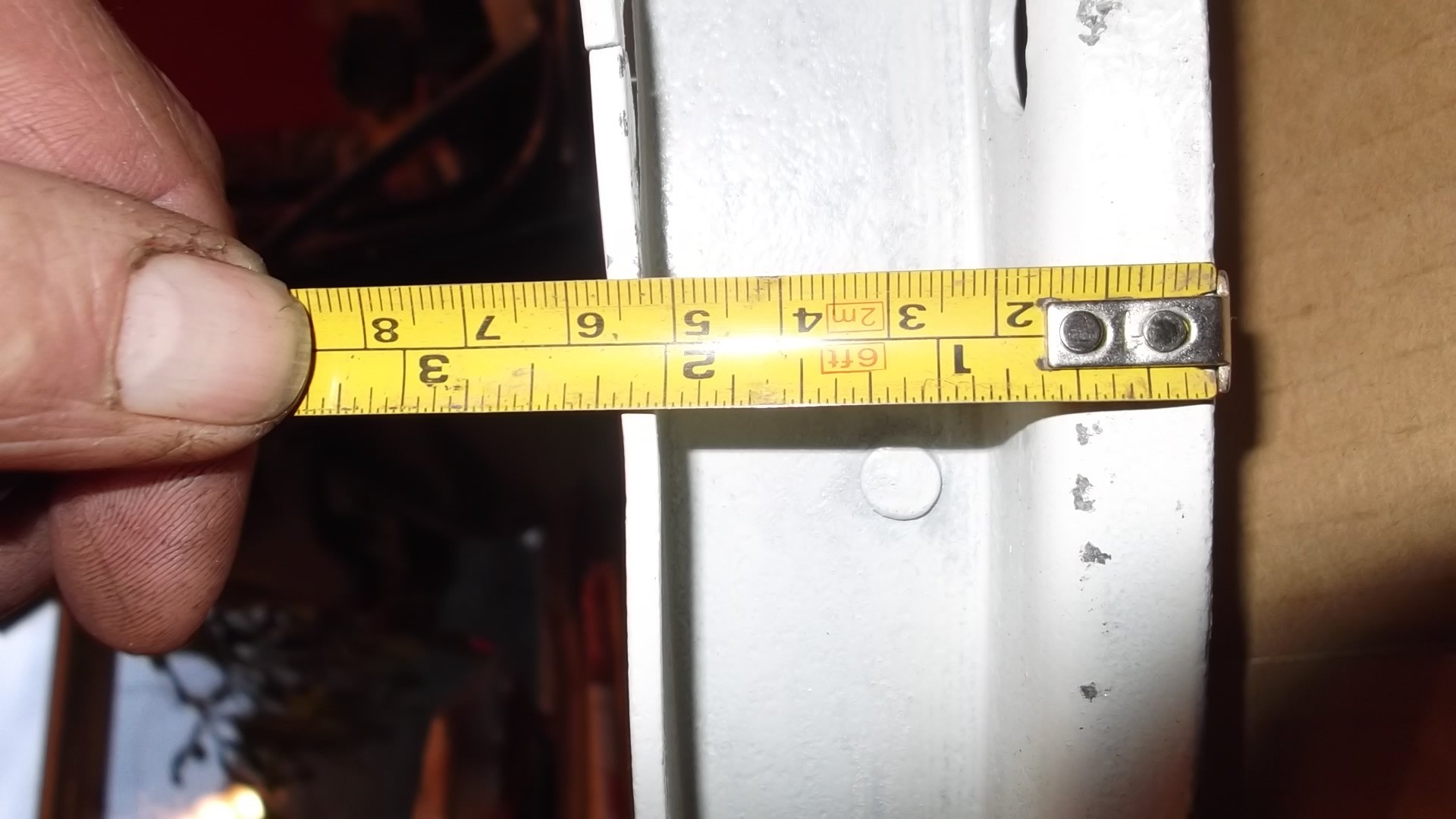

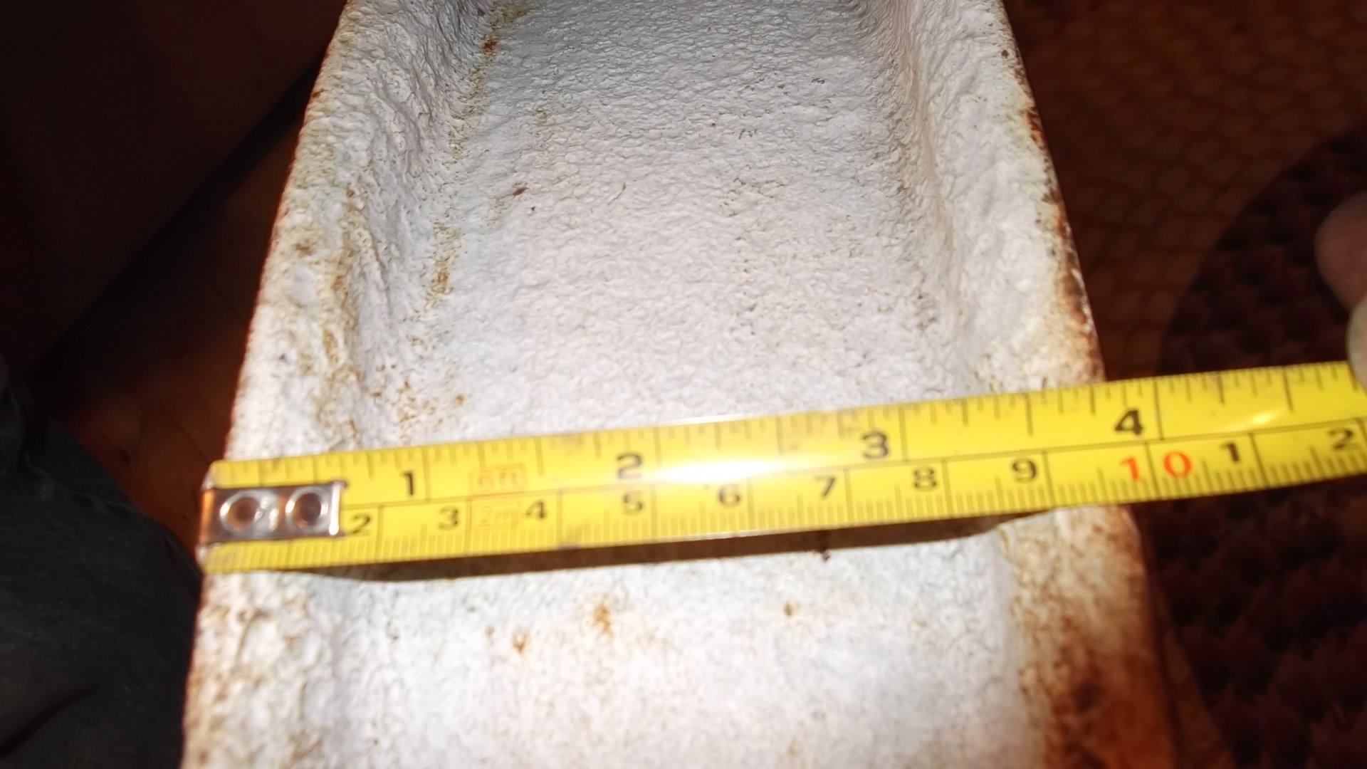

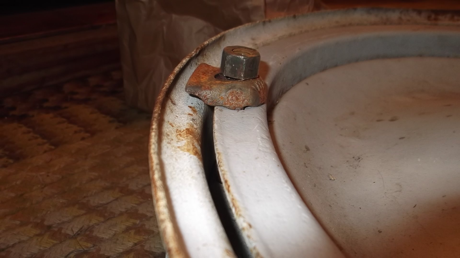

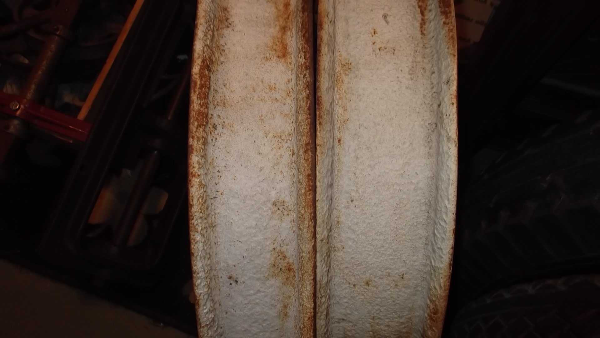

Post by Mark Gregush » Wed Sep 30, 2020 11:42 am

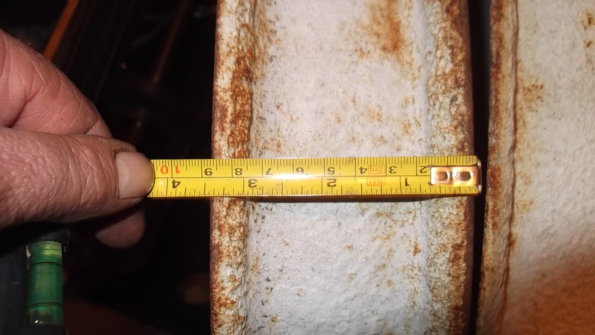

A few more photos of mine showing rim and felloe sizes and what happens when miss matched. To add, the 1926 to 1928 are 21", before that not sure but might have been 30".

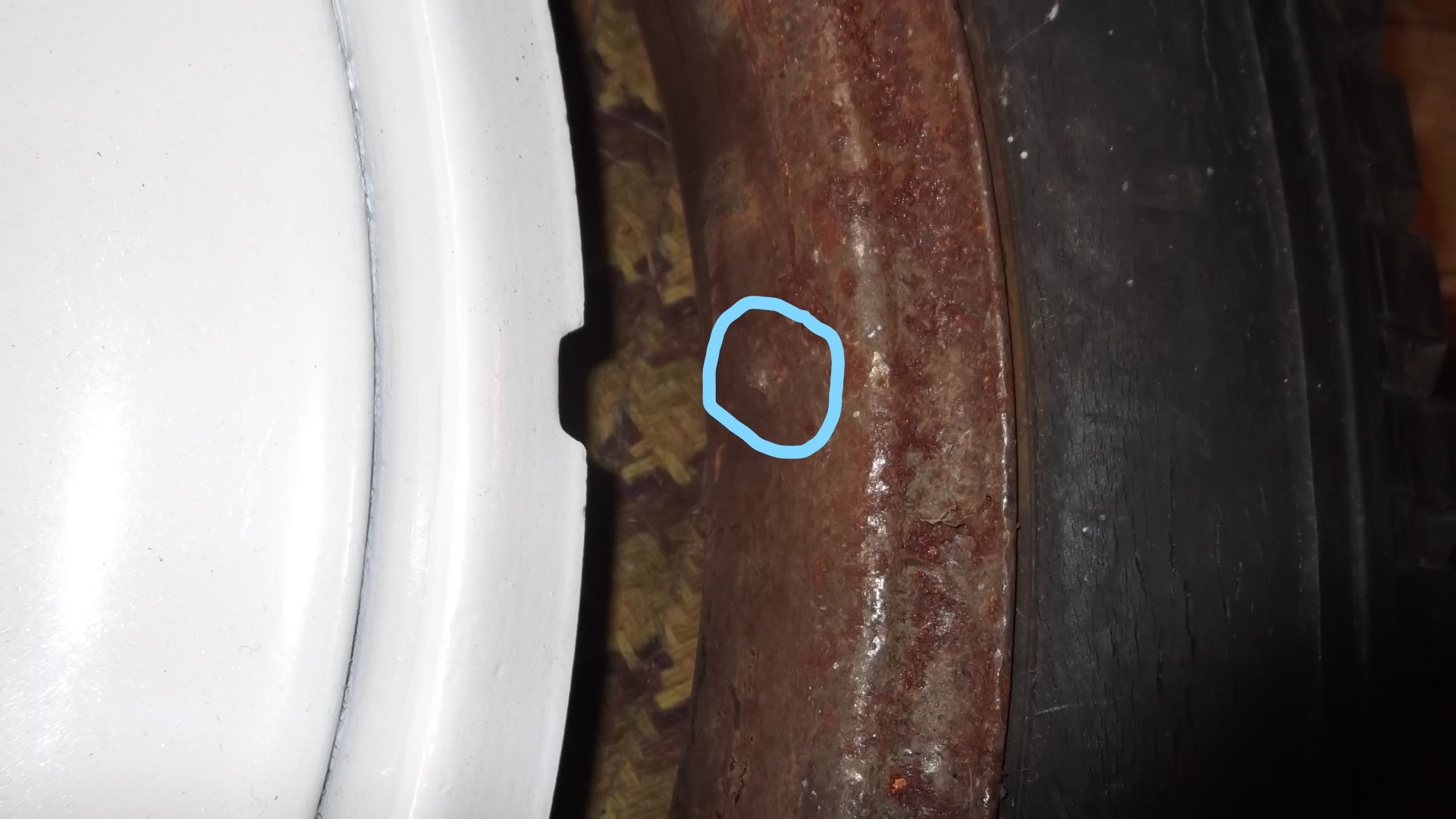

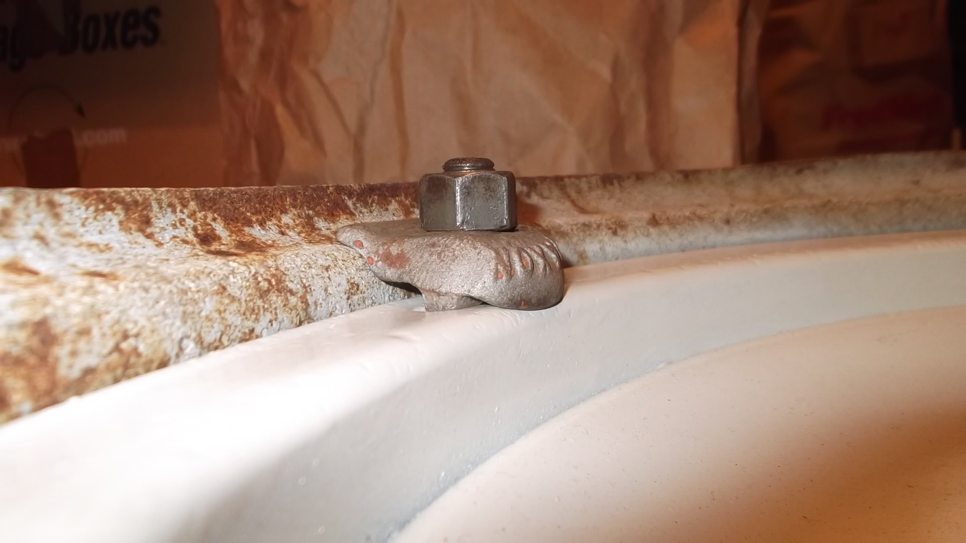

The set Henry listed, I think I know how they were made. If I had been able to find a set of the Chevrolet plates (some things I can make, some not so much), I would have maybe done it that way. Using the Chevrolet plates would have meant pressing a sleeve on the hub to support them. ;)
1926-27 have a line up notch and bump on rim that the 1928 doesn't
This is how the rim should fit on the wheel;
I don't have a picture, but the rim clamp bolts for 1928 are longer. They should work the 26-27 but the shorter 1926-27 will not work on the 1928.
