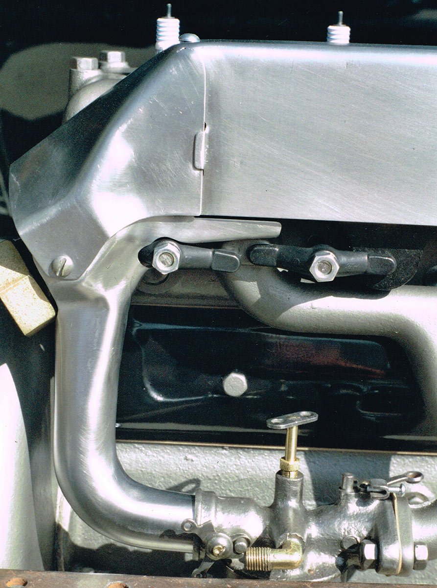

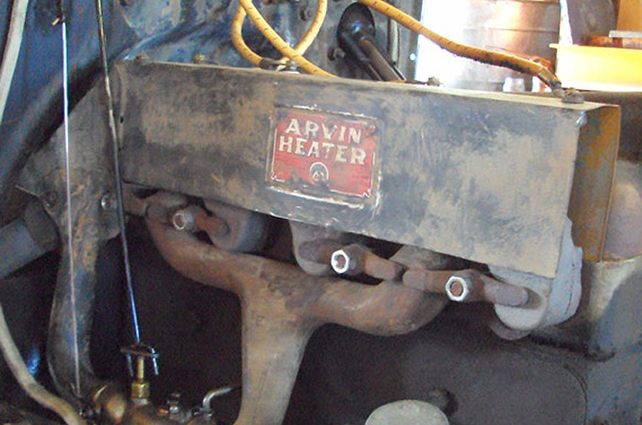

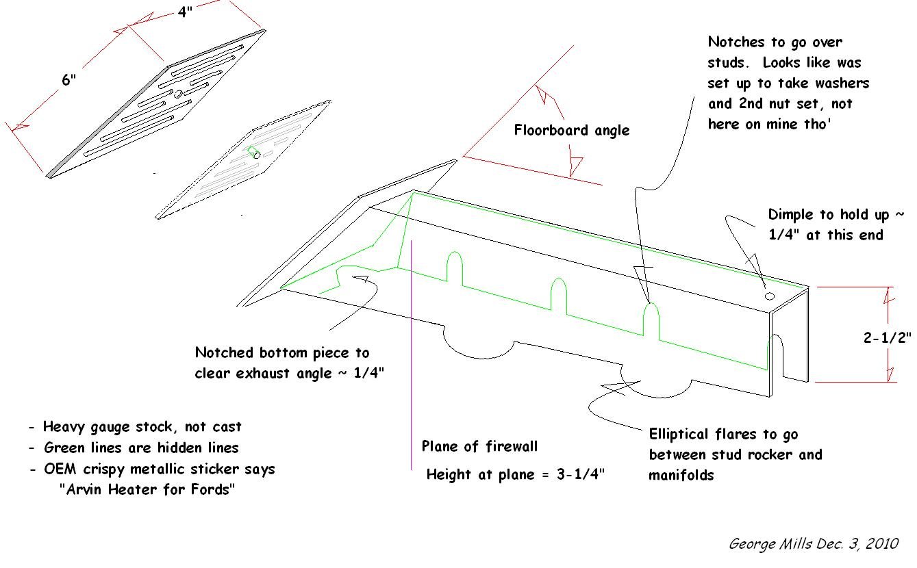

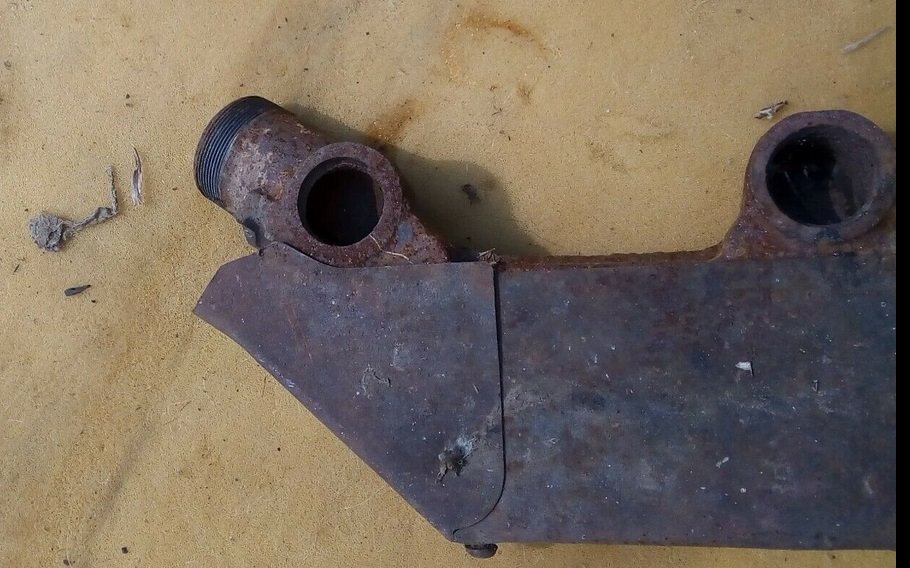

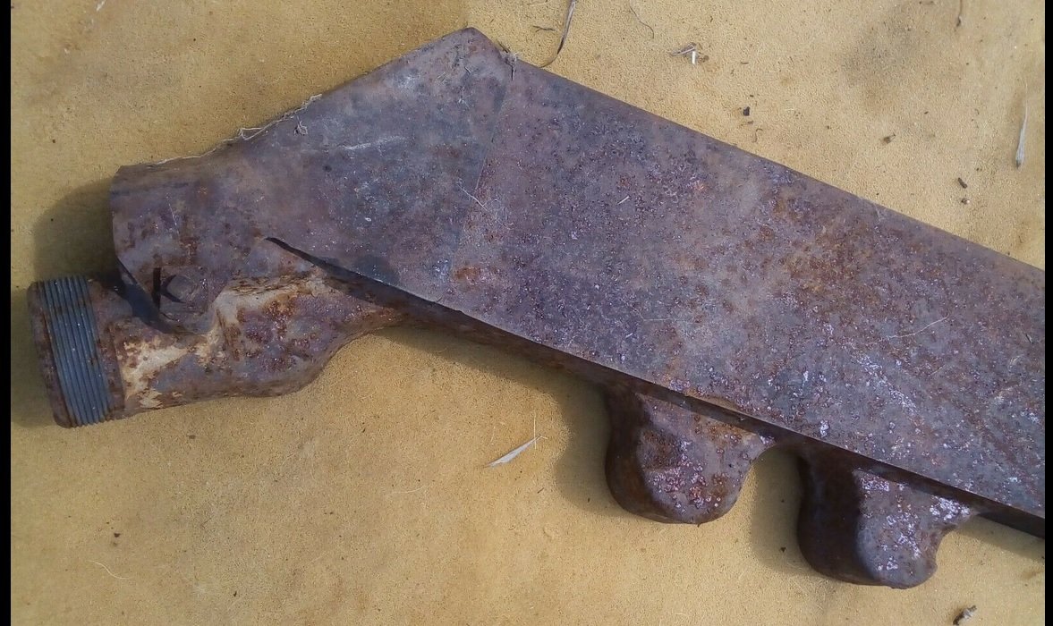

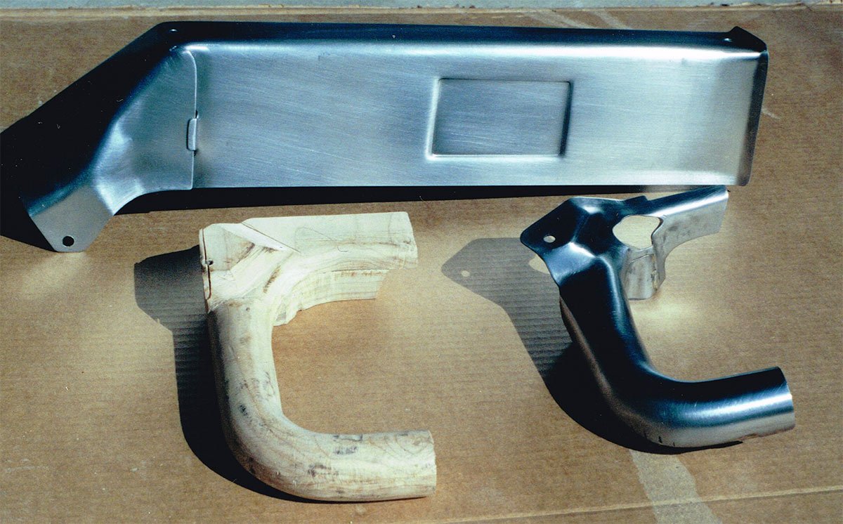

These were from an earlier post this or last year
Re: Installing a arvin heater
Post by Rich Eagle » Wed Oct 07, 2020 1:05 pm
I may have added confusion and false impressions of the Arvin Manifold. The third photo is my cover made for a manifold I had and painted my version of the Arvin logo on it. While satisfying my needs for a manifold that looked somewhat correct I see I have mislead future impressions of the item.
I hope all will take note and not assume it has any validity.
Perhaps someone can identify the true manufacture of the other "waffle" manifold shown.
While the identity is important - the need for a shroud, cover, design is the primary interest. Did you make yours?

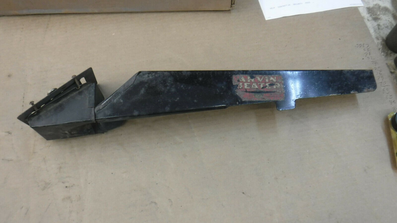

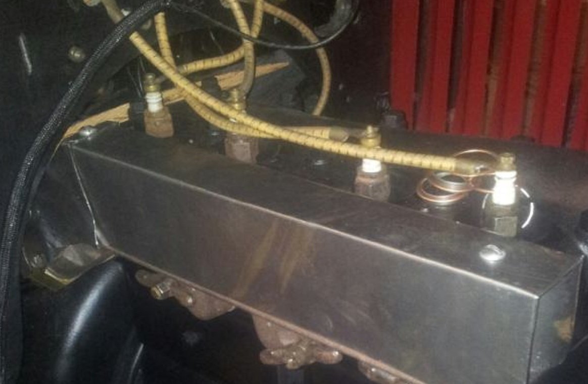

Found another picture of the end cap - looks like the cover over the manifold is a simple rectangular cover, the end cap converting a the rectangle to a round pipe from there a flex hose could be added to a register(s) inside the T as desired
Post by Rich Eagle » Wed Oct 07, 2020 2:41 pm
Yes, I made two covers, for two different cars. I had a fair one for a pattern. The bends are simple to make but the rear portion I made over a maple form.
I also made the heat pipe as the originals don't fit the arrangement very well. There was recessed rectangle where I assume the logo went. I flared the front on one and not the other. The one in your first photo would be easier to fabricate I think.
