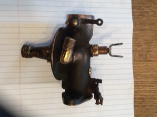

This model L has steel choke and throttle arms so would it be mid or late prod ?
Thanks for any help.

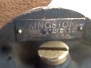

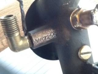

It is a Kingston L4. If it is iron body, used from 1921 to 1926. Can't tell from photos if bronze or iron body. If bronze would be a little earlier.

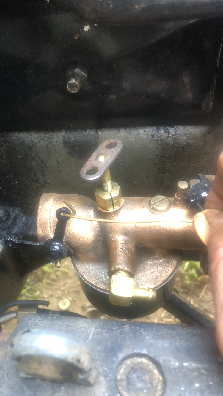

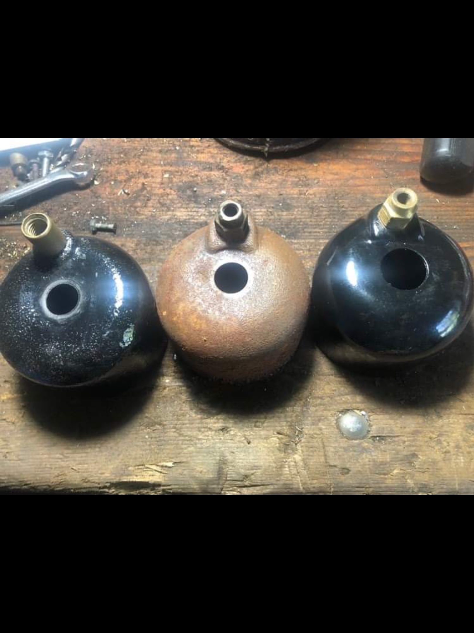

Looks like a brass body L4. Those had a smaller bowl nut than the cast iron version. It’s also missing one of the arms for the choke, and it has a late model spray needle. Those bowls will interchange with the early NH bowls (to the left) but have a different drain.
