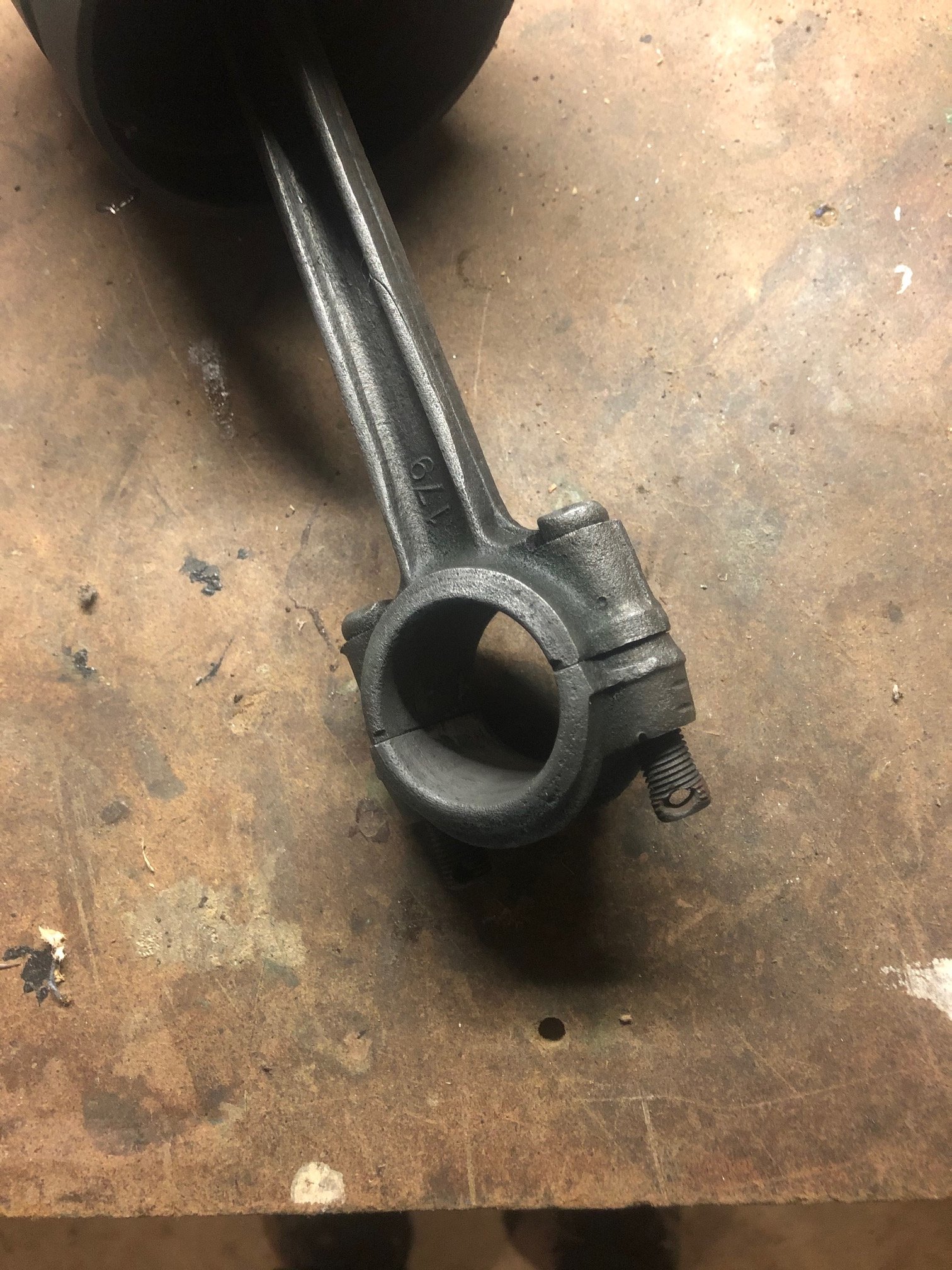

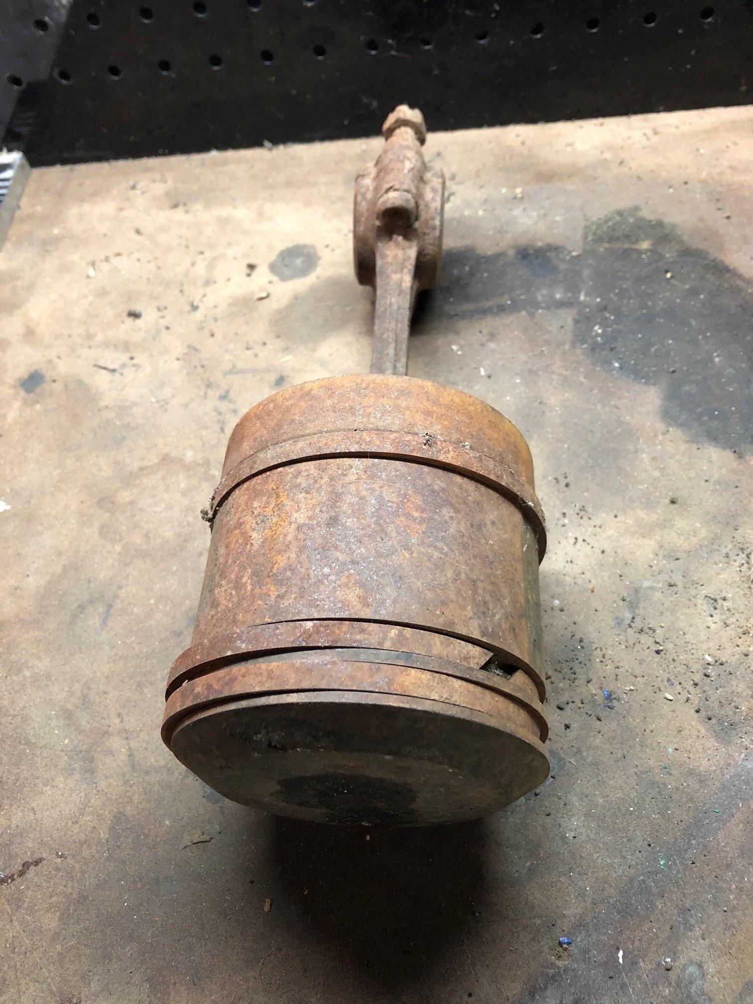

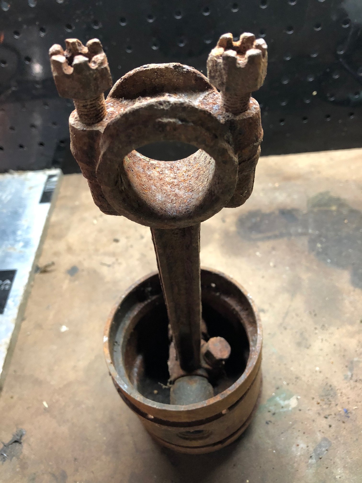

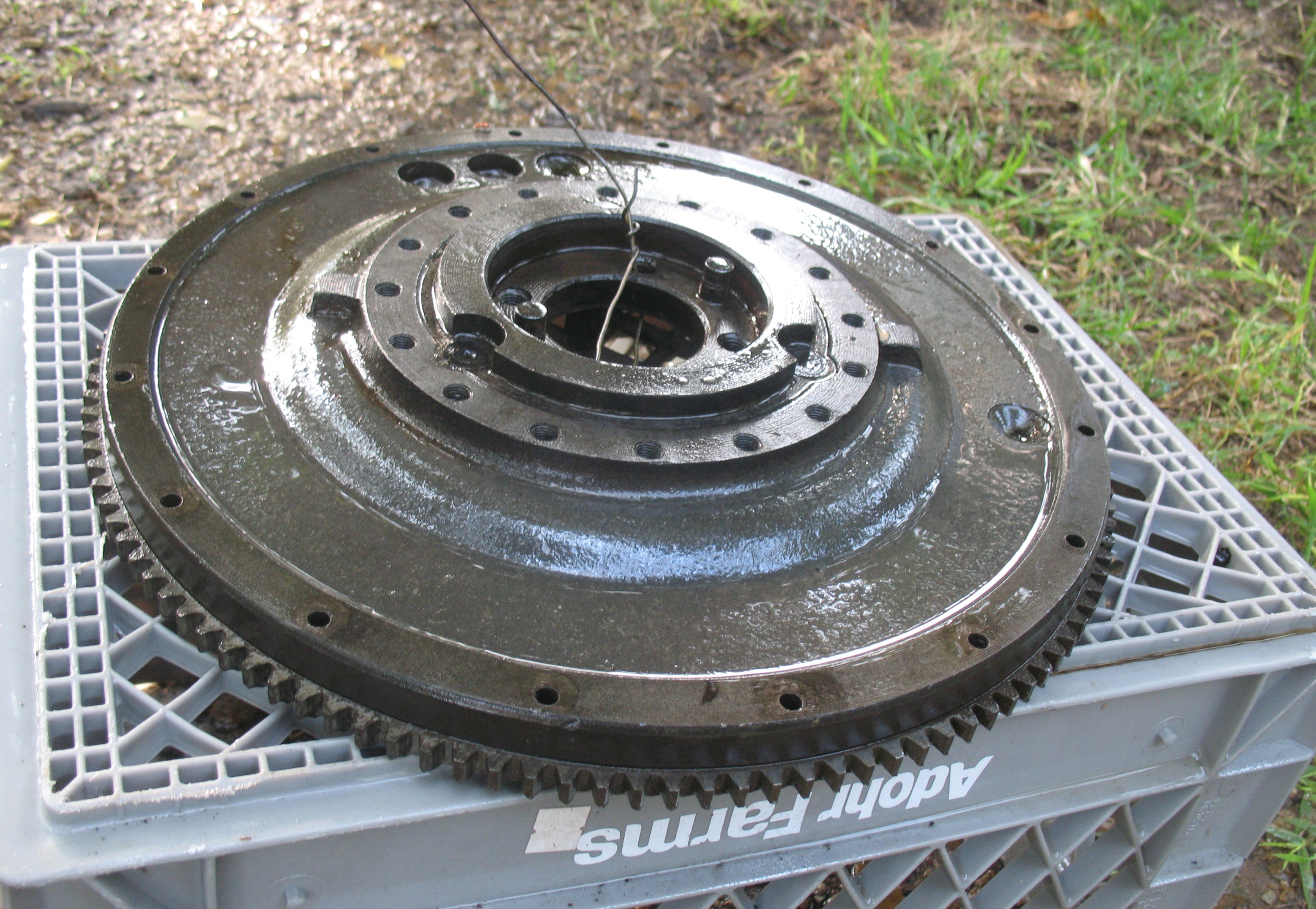

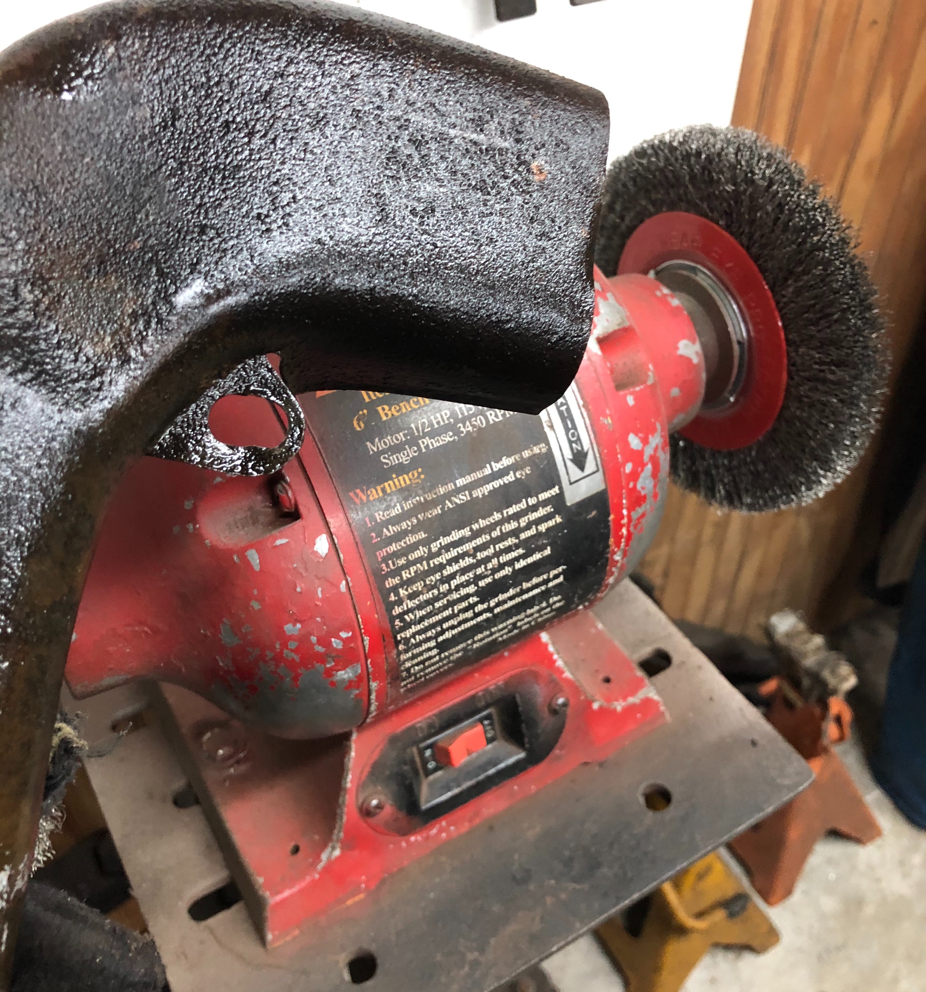

Rust removal Evapo-Rust

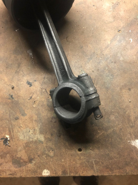

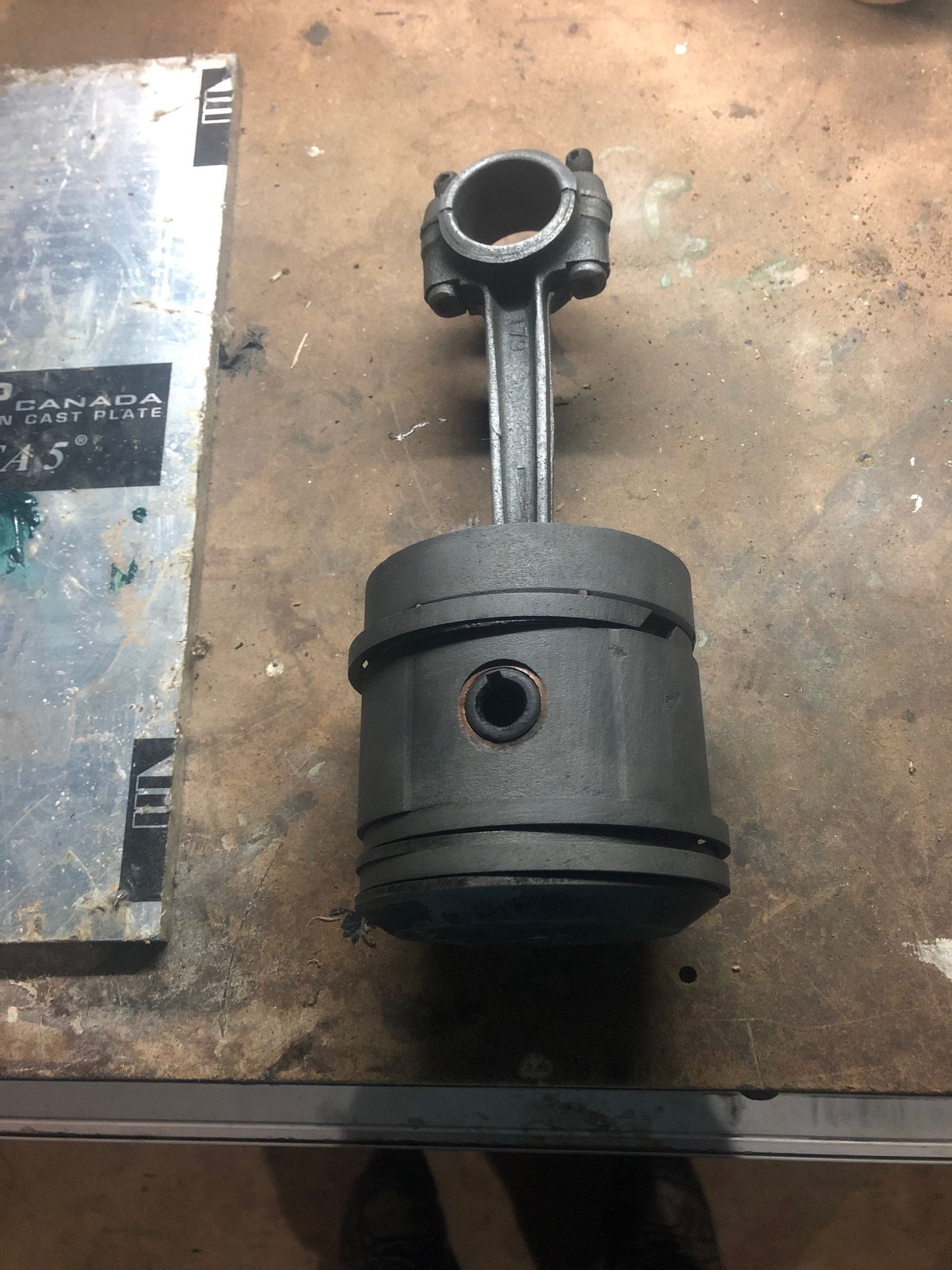

This piston came out of an engine that was sitting in a salt shed for salting meat. The whole engine is frozen solid. Before soaking for 4 days the wrist pin would not turn and the rings were frozen in their grooves. After treatment the wrist pin can move and the rings are free. The treatment leaves a fine black powder deposit on everything that can be removed with soap and water and some scrubbing. The black deposit is on the babbitt too so it is hard to tell if the babbitt was eroded but it looks like it has not been greatly effected. It was in very bad shape before the treatment. I tried to take the cap off by beating on the bolts but it is not moving. I will have to drill out the bolts. I have no intention of using these parts, it was an experiment to see if the Evapo-rust could treat these parts.

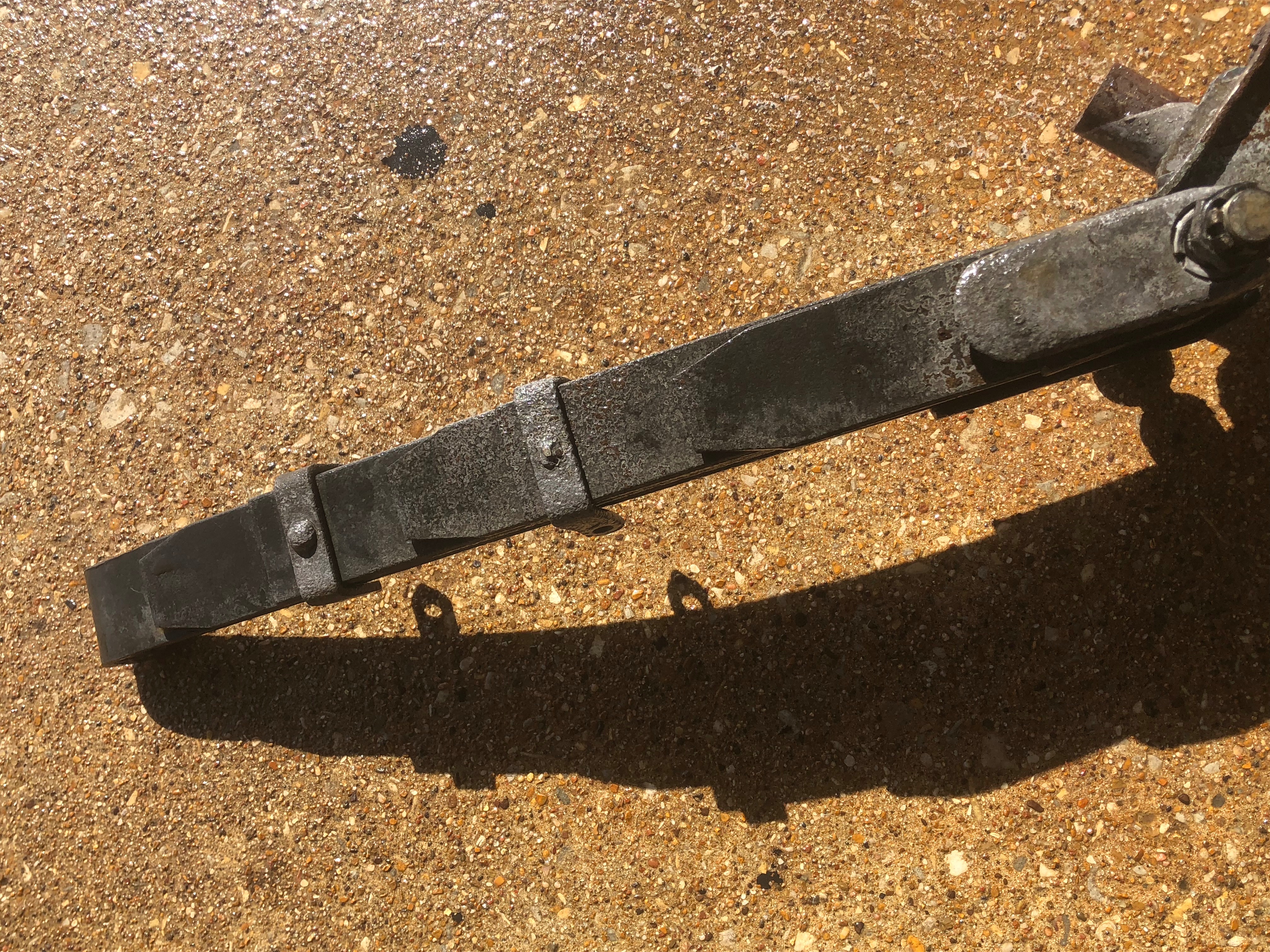

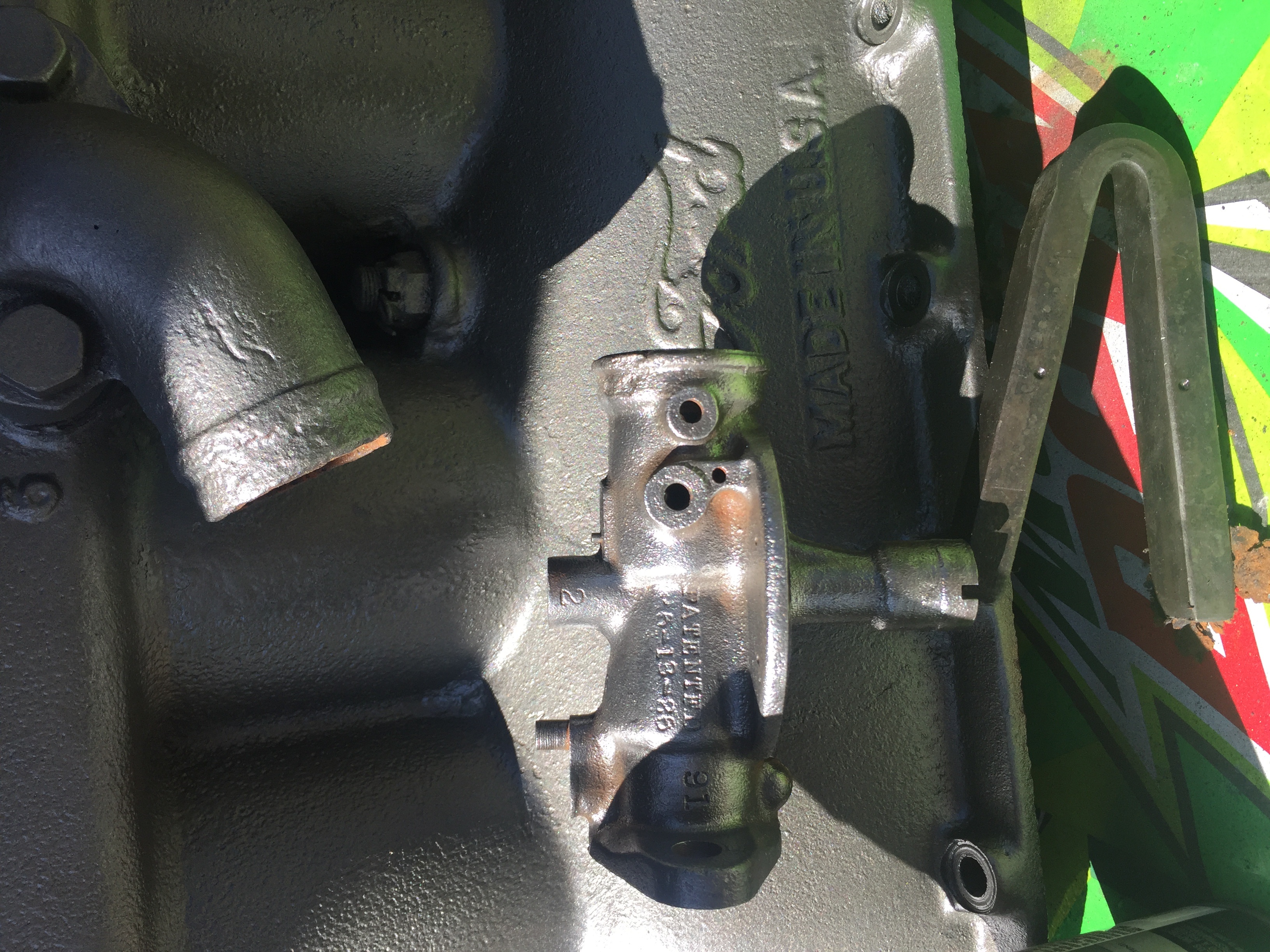

The company also makes a product called Themocure to dissolve through chelation, the rust in a cast iron block. I can give you first hand experience with this product. I have a 1915 touring car. I live in Mississippi and it get HOT here in the summertime. The car would overheat in traffic when in town. I had to be real careful. If it was sitting still very long it would start spitting water out the overflow and rapidly get worse.

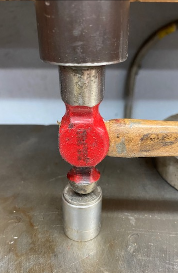

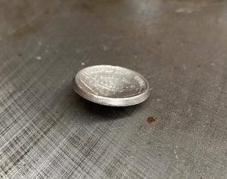

I bought myself 6 bottles of this stuff. I pulled the water inlet on the head, just to see how bad it was, and was appalled at how thick the rust was in the inlet! I could dig some of it out with a screwdriver! So I put it back together, and being male, I ignored the instructions, and filled the car with tap water and put TWO bottles of the stuff in the radiator. I ran it 20 miles on the back roads, brought it back, let it cool, and drained the water. I had to poke a wire up through the petcock from all the rust chunks to get the water to flow. It came out JET BLACK. I repeated the process again. Same result, but I noticed all the freeze plugs had begun seeping. They were no longer freeze plugs, they were dissolving rust plugs. After I replaced all of them, I did he process a 3rd time. This time, I noticed that the temp showing on the Boyce thermometer was running a LOT cooler. While driving in 95 degree weather, the Boyce meter was coming up only 2/3 of the way up to the viewing window! When I got back to my garage, I let the car idle, with the advance about 1/2 down, and turned the stopwatch on in my cell phone, and sat behind the wheel and watched. The car idled a full 14 minutes, and the red line came up only 1/3 of the way into the viewing circle. I drained it all out again, pulled the inlet again, and was amazed to see silver bare cast iron! After I put it back together, put distilled water with a mix of antifreeze and a bottle of "water wetter" and the car still runs cool when driving and never overheats in traffic.
We trailered the car to the Mississippi gulf coast last week, and drove it during the "Crusin the Coast" hot rod event. The traffic was bumper to bumper from Biloxi MS to Gulfport MS, stop light to stop light on the gulf coast highway 90. It was like a 20 mile Christmas parade! The car never got hot. I thought my left leg was gonna die, from going from neutral to low gear and back at least 1000 times over 4 days, but the car performed perfectly! And this is how I made freeze plugs out of nickels:

Awesome!
And thanks for the pics of producing freeze plugs from nickels! Very handy!

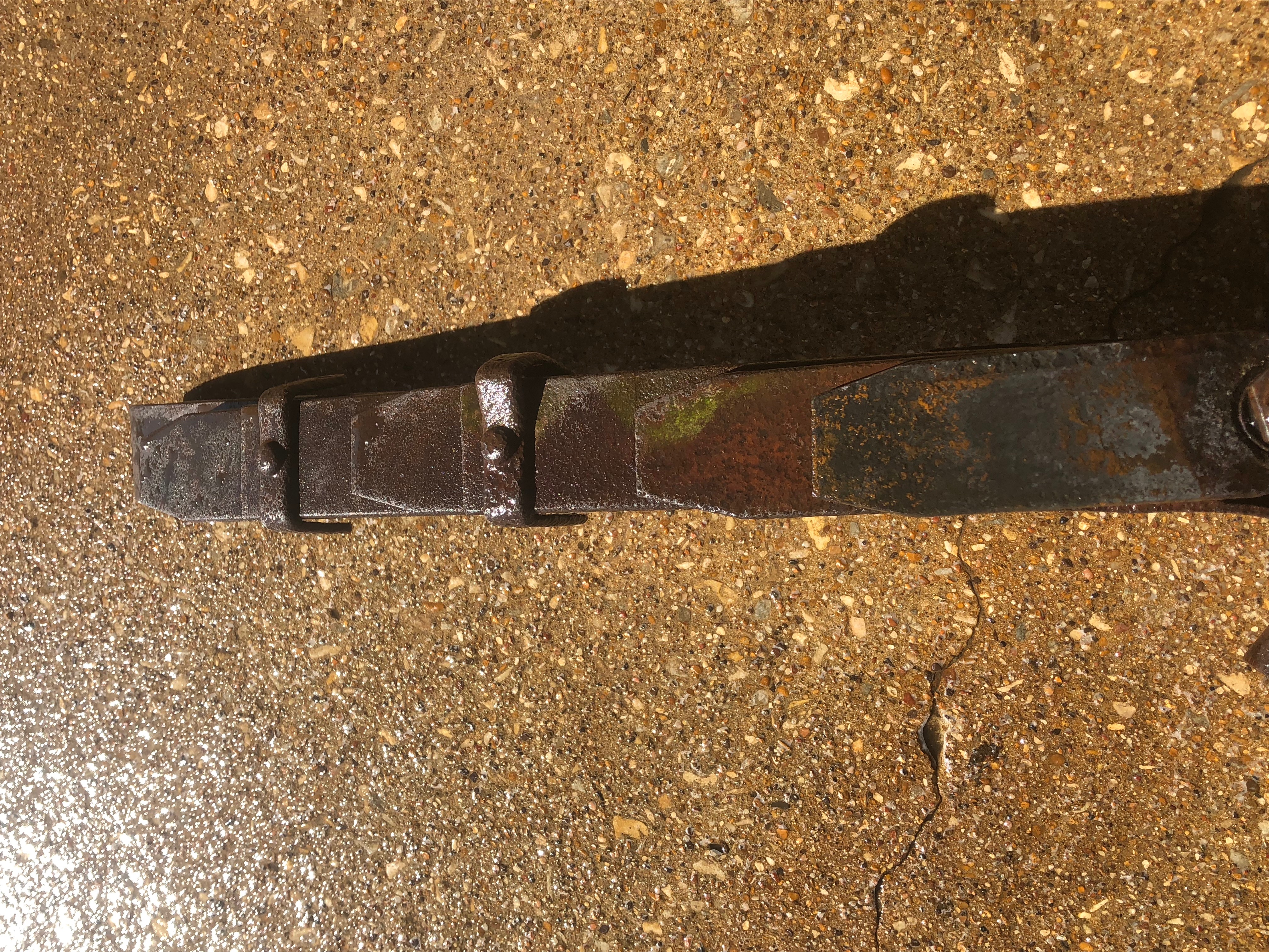

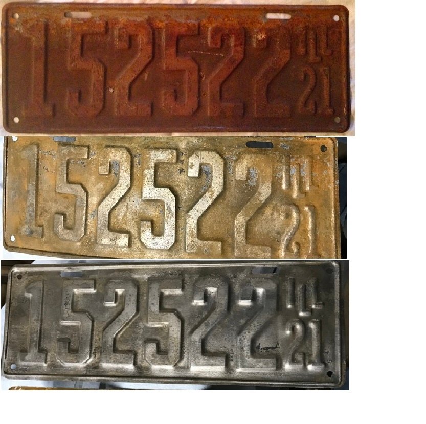

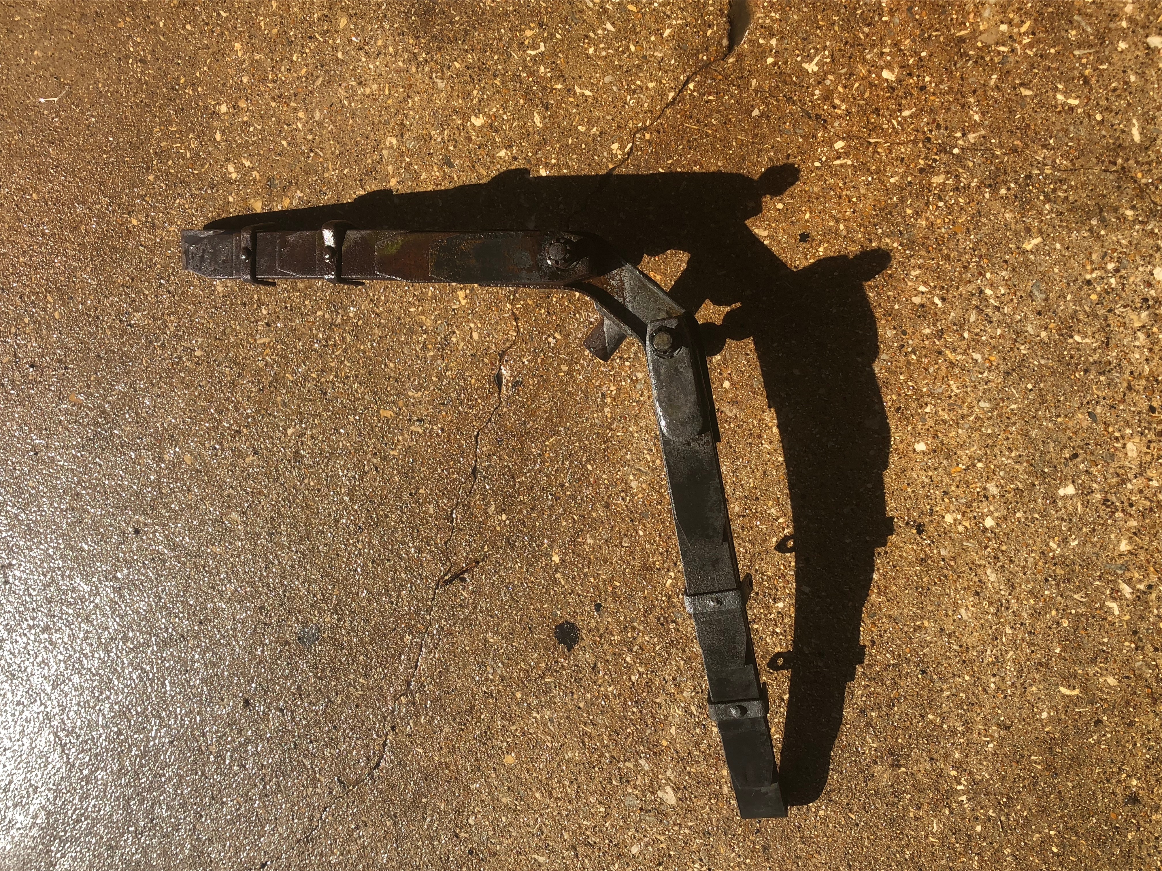

I took these Overland springs to the car wash today after soaking one side for 2 days in a large tub with water and a $6 bottle of citric acid powder I bought at Walmart. They were pulled out of a field along with what was left of the car after it sat there for who knows how long but they were rusty. The citric acid did well in my opinion. I’ll mix up more and do the other side then think about doing them over. I know it works well for small parts, I soaked that carburetor in it and then wire brushed it. That engine paint is also a close match to bare cast. I probably should’ve put more acid in with the springs, I usually only mix small amounts.

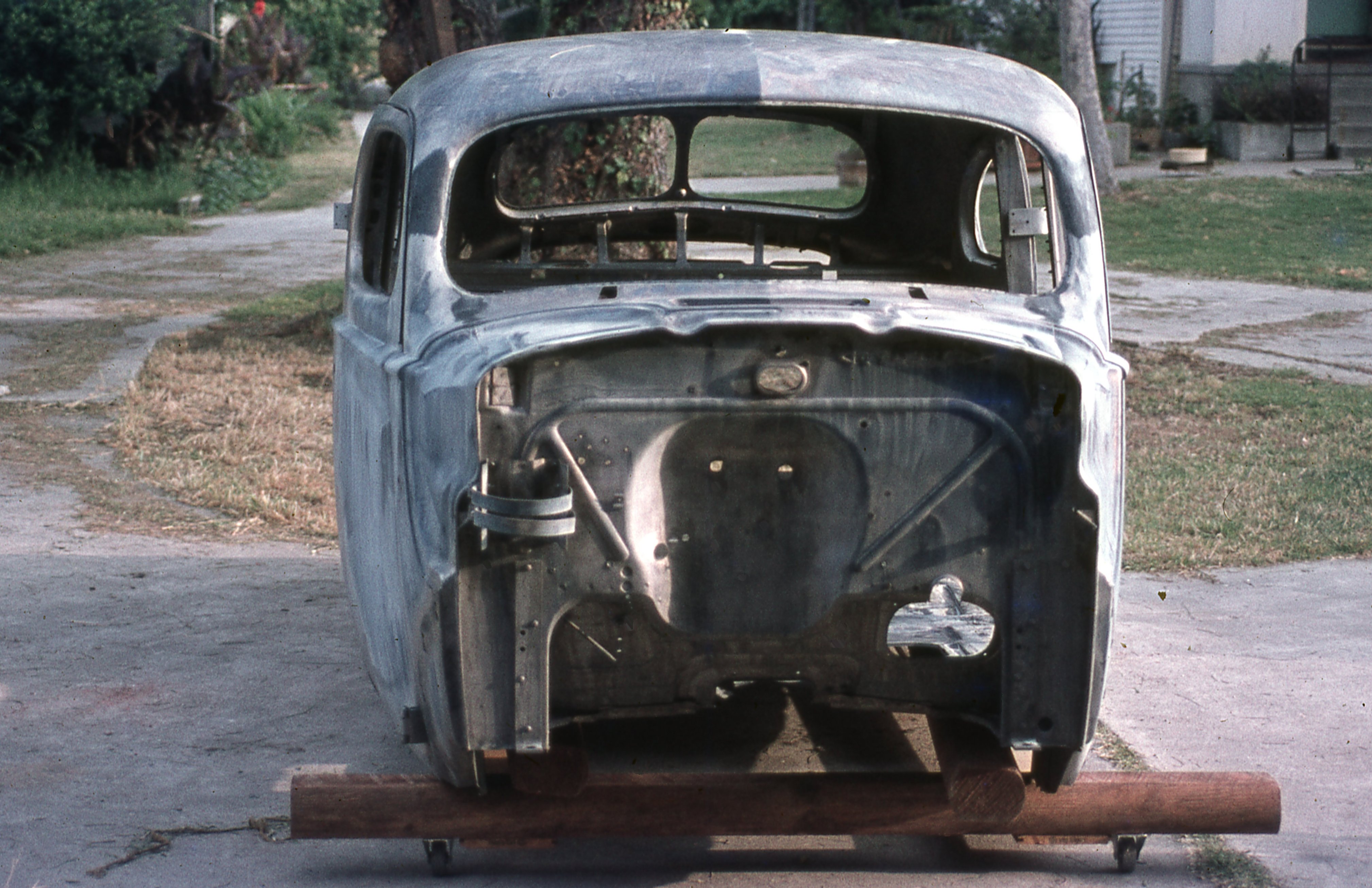

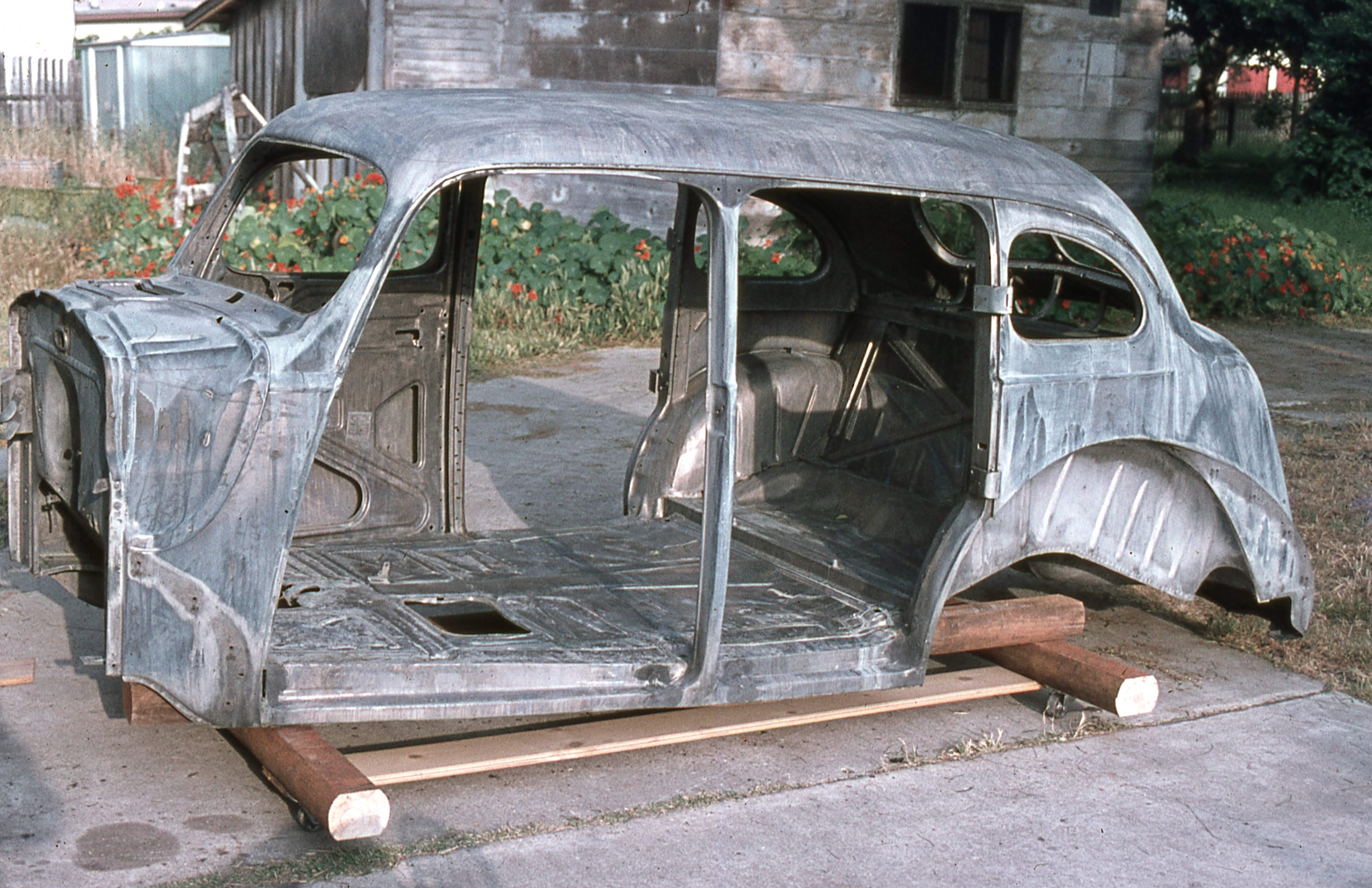

That sounds a lot like Redi-Strip. In 1982 I had a Packard body and other parts derusted at the Redi-Strip facility in Santa Fe Springs. I was very impressed with the results. At that time they had locations all over the country, but now a google search shows just a few.About 12 years ago, there was a rust removal business here in MInneapolis that catered to auto restorers. They had large open tanks full of Evaporust in which they could soak car frames, fenders and other large parts.

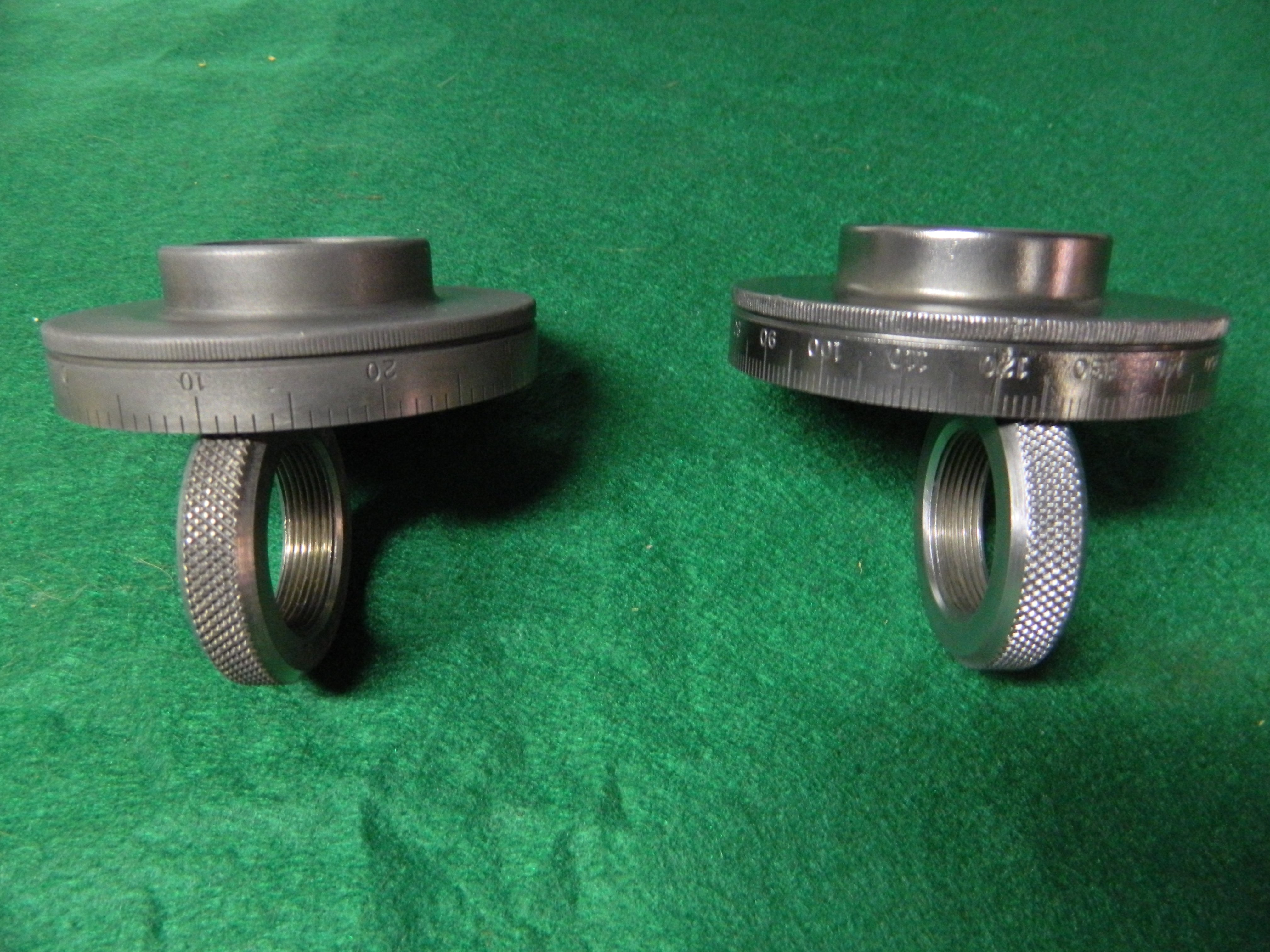

Alright group, I read about how well Evaporust worked and went out and acquired some. I was amazed at how well it worked but I have a question, I de-rusted the dials of my Bridgeport mill and boy do they look nice. But how do I keep them that way? They look to be cast and will constantly rust in my pole barn with the change in temps they get a lot of condensation I'm thinking a clear coat of some sort. Any suggestions would be appreciated and welcomed. Thanks
Pics of dials after cleaning they were so rusted you could not read them. The one on the right is after a light wire brushing on a wire wheel (gets rid of the gray look) I'm thinking one of these two for protection

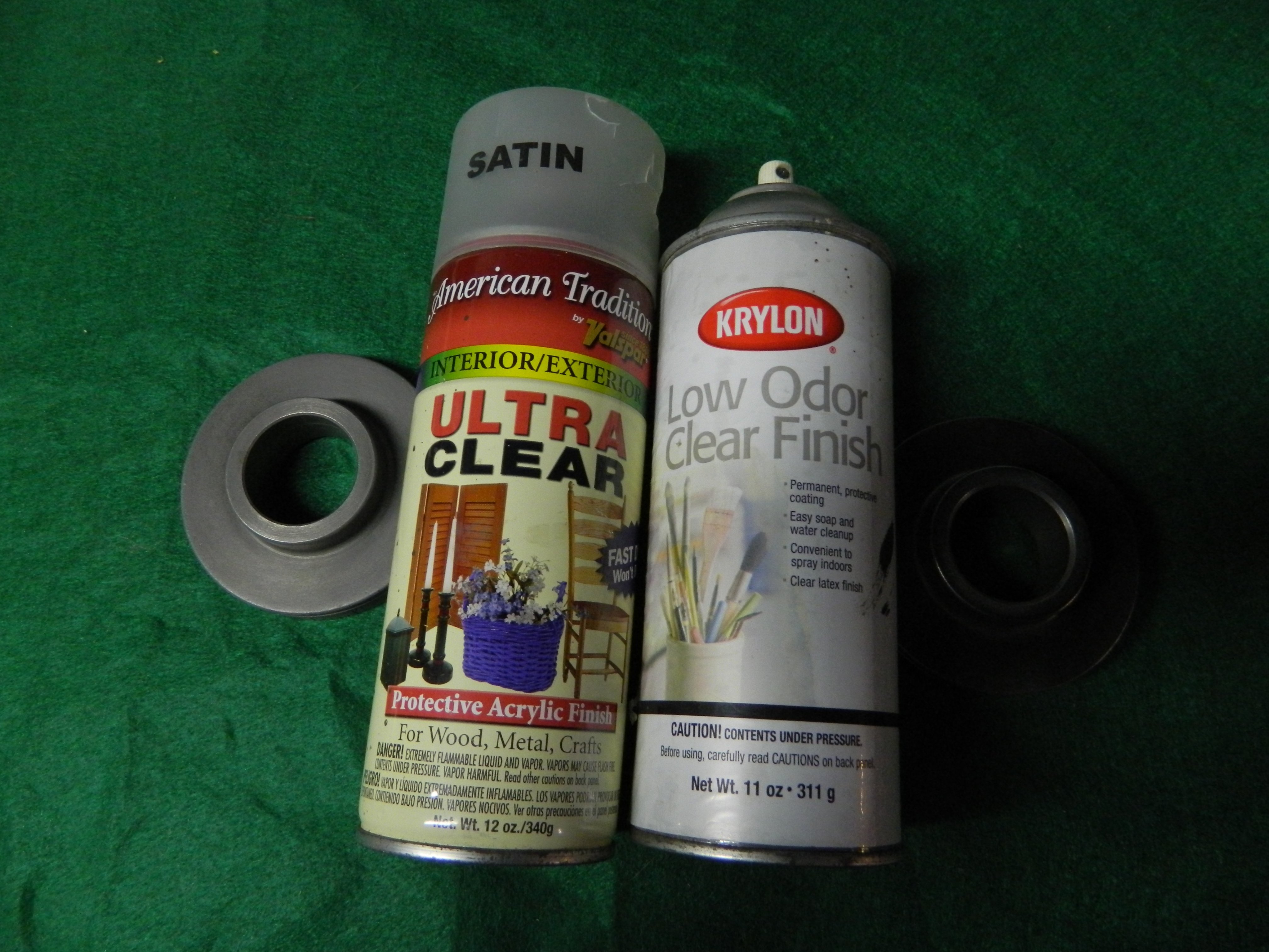

Jim, those parts look great!
I'd bet some clear coat would work fine if the mill is inside. Some say clears will yellow etc outside but inside the building?

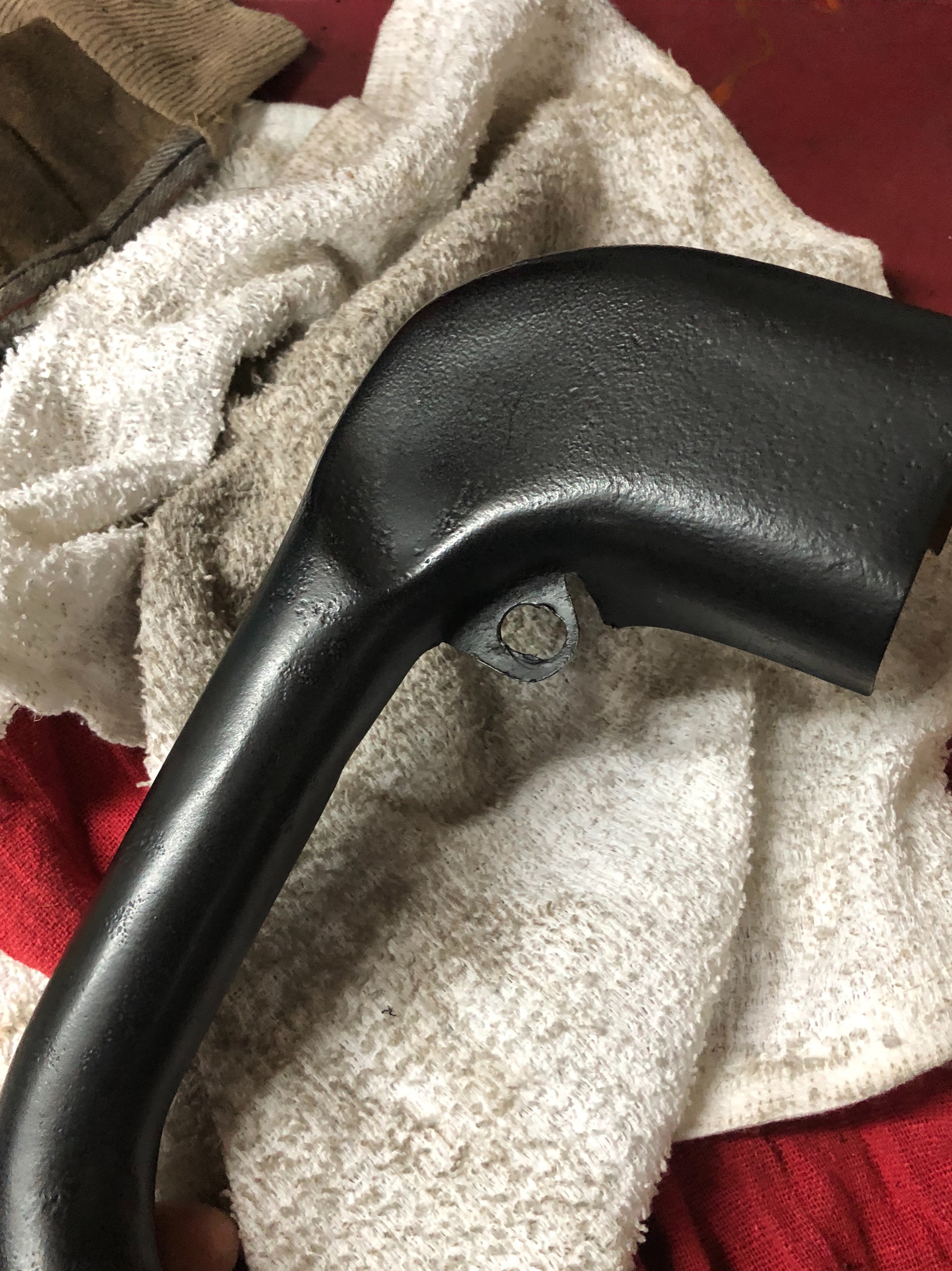

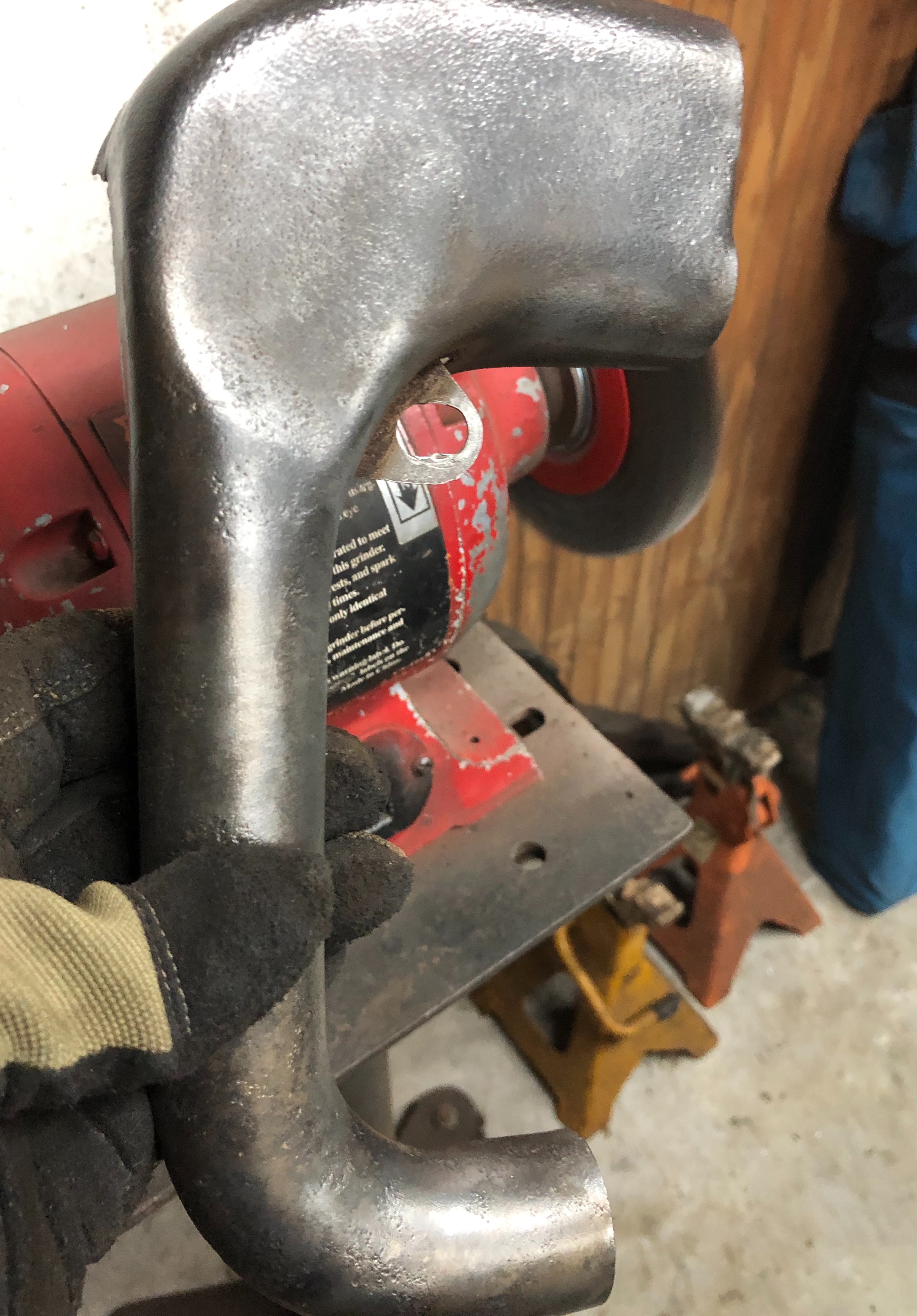

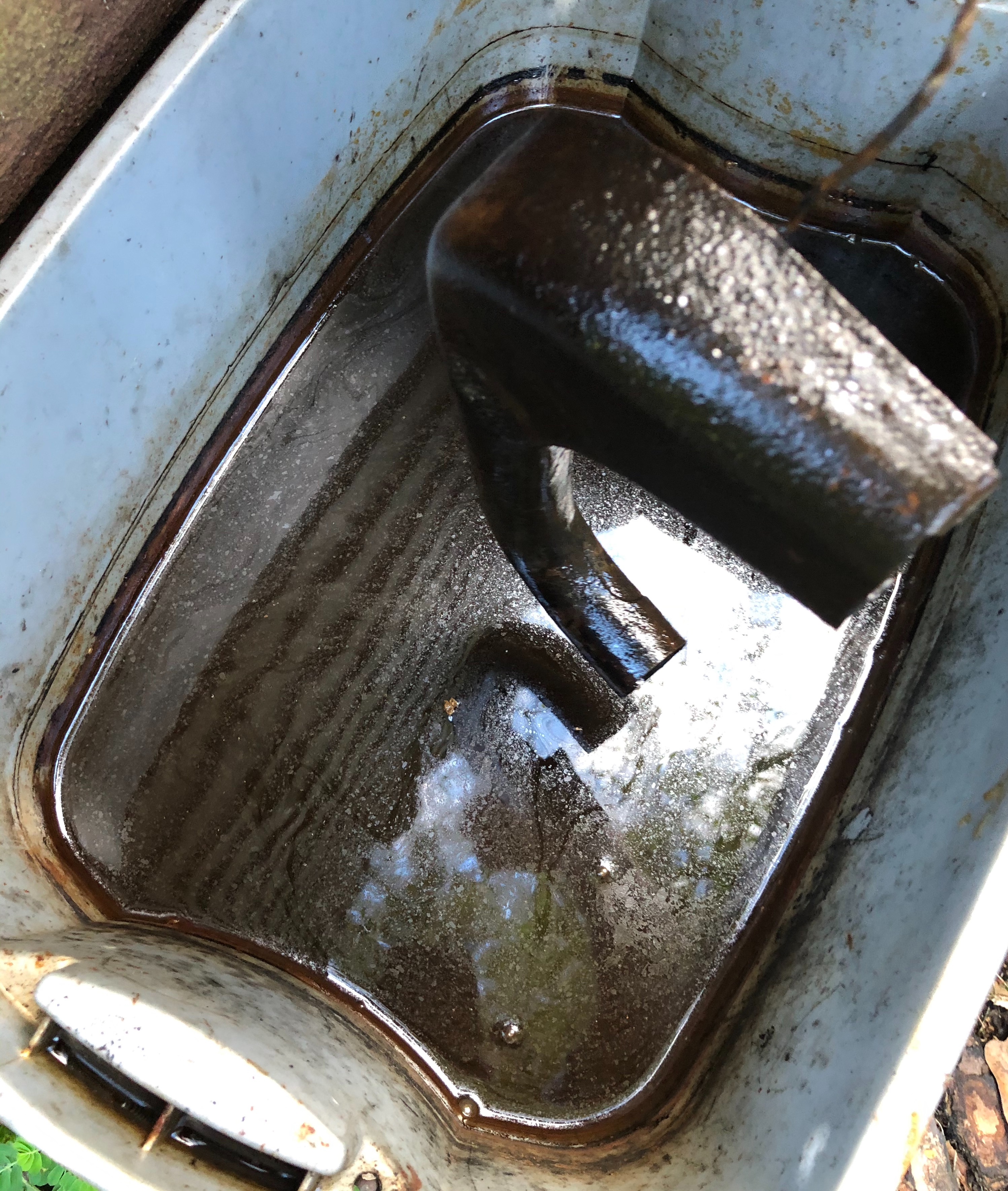

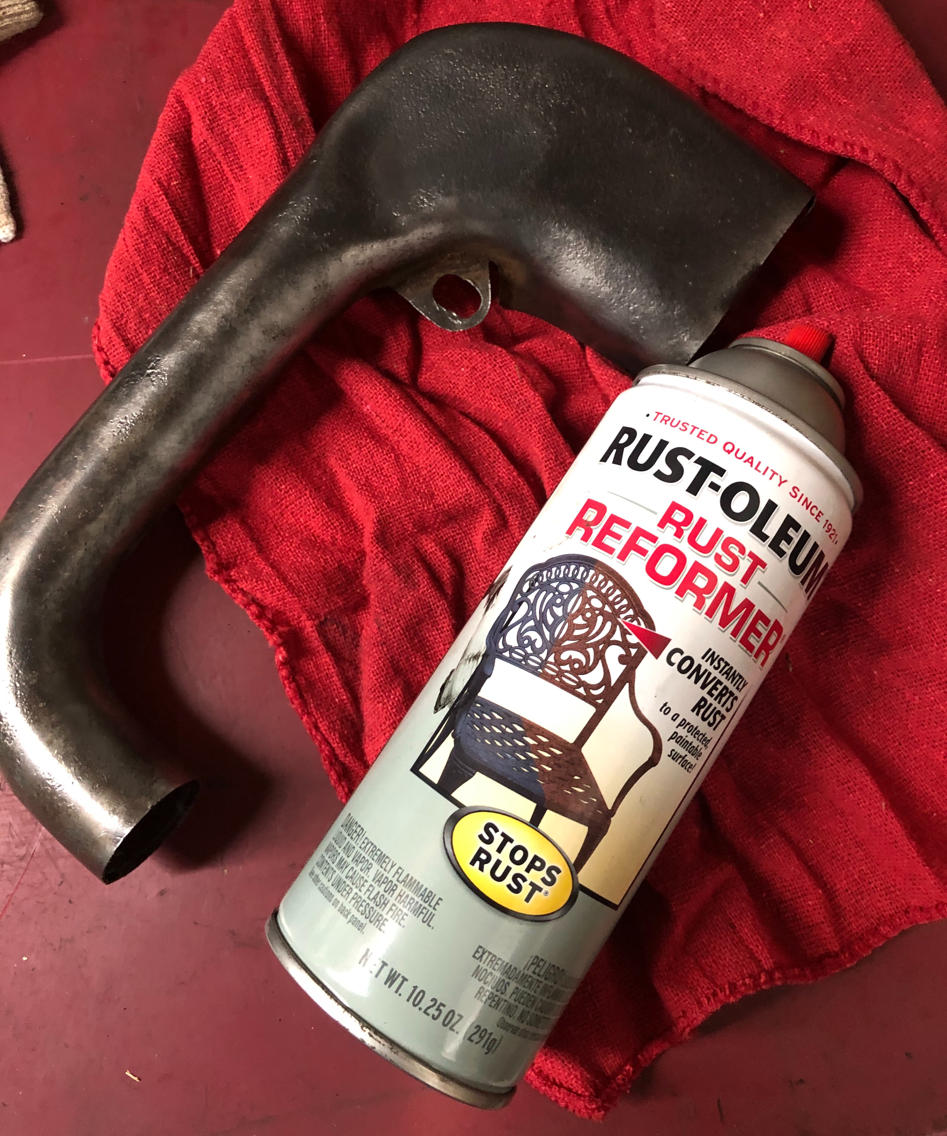

The molasses works for me. Got this rusty '25-'26 hot stove pipe at Luray for a 2 $, its for the carb that uses the combo choke/ adj. rod as it has the recess to clear that rod. Been soaking since Luray.
Just spray off the gunk with a hose and a trip to the wire brush, a few minutes later and all cleaned up!
Spray coat of rust reformer and buff with white rag to a semi shine..... ready to install

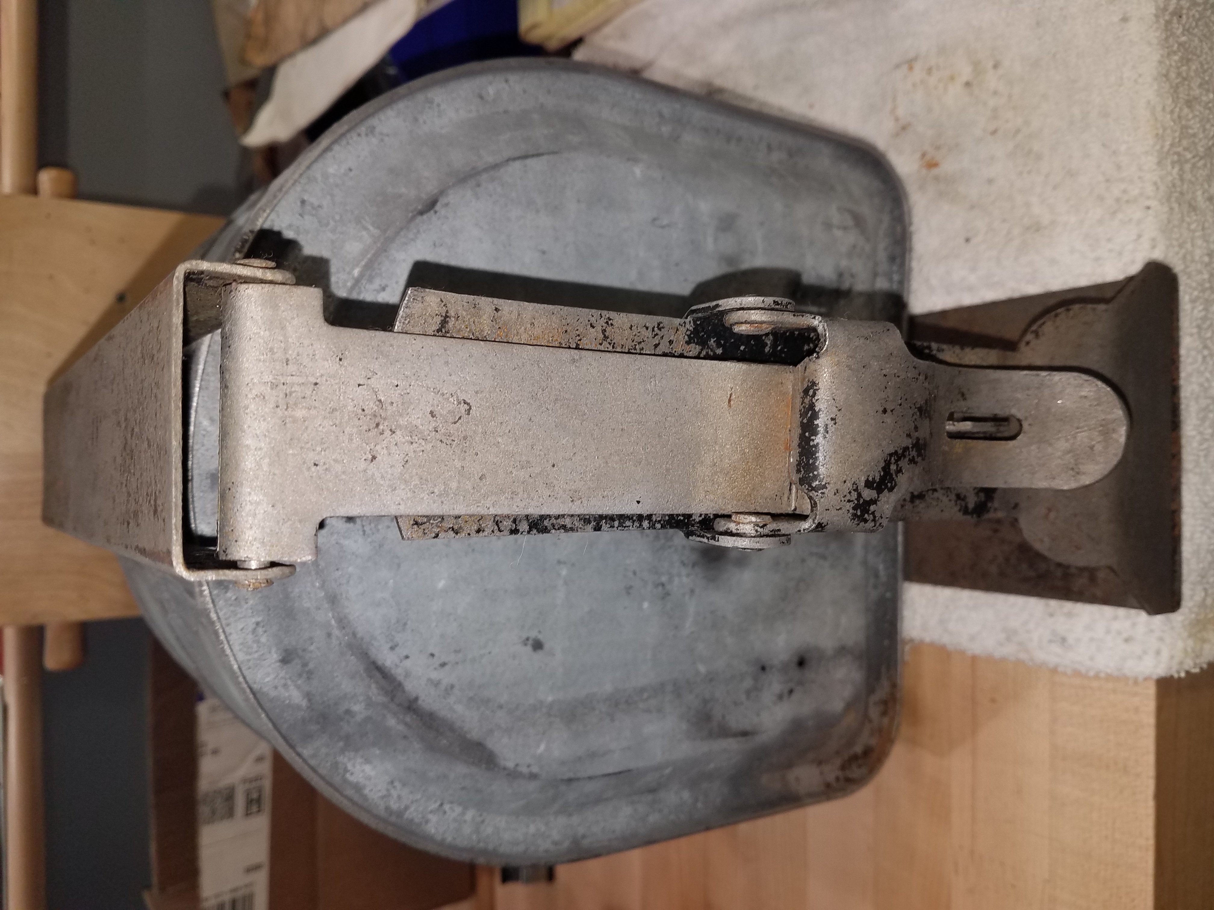

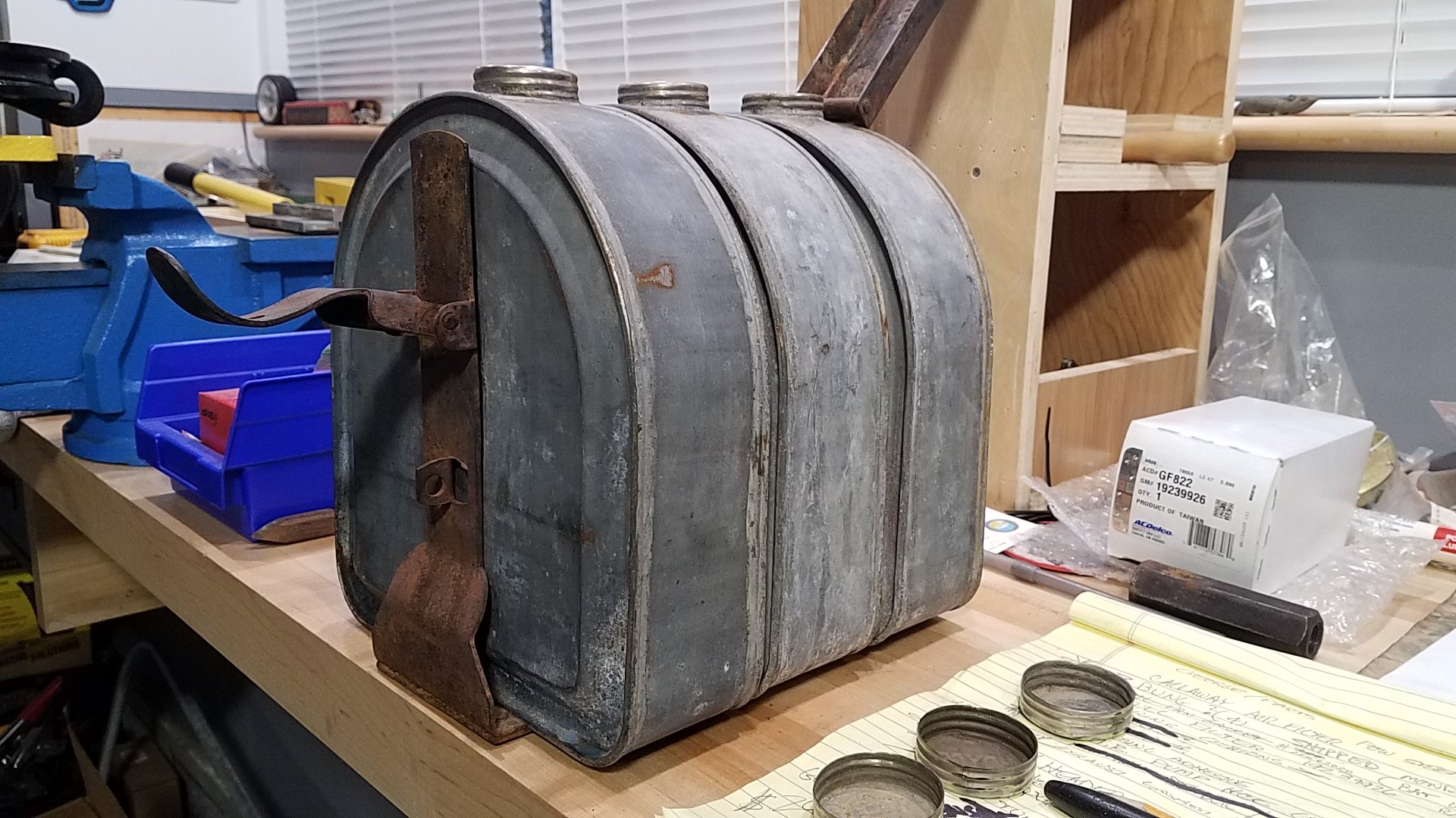

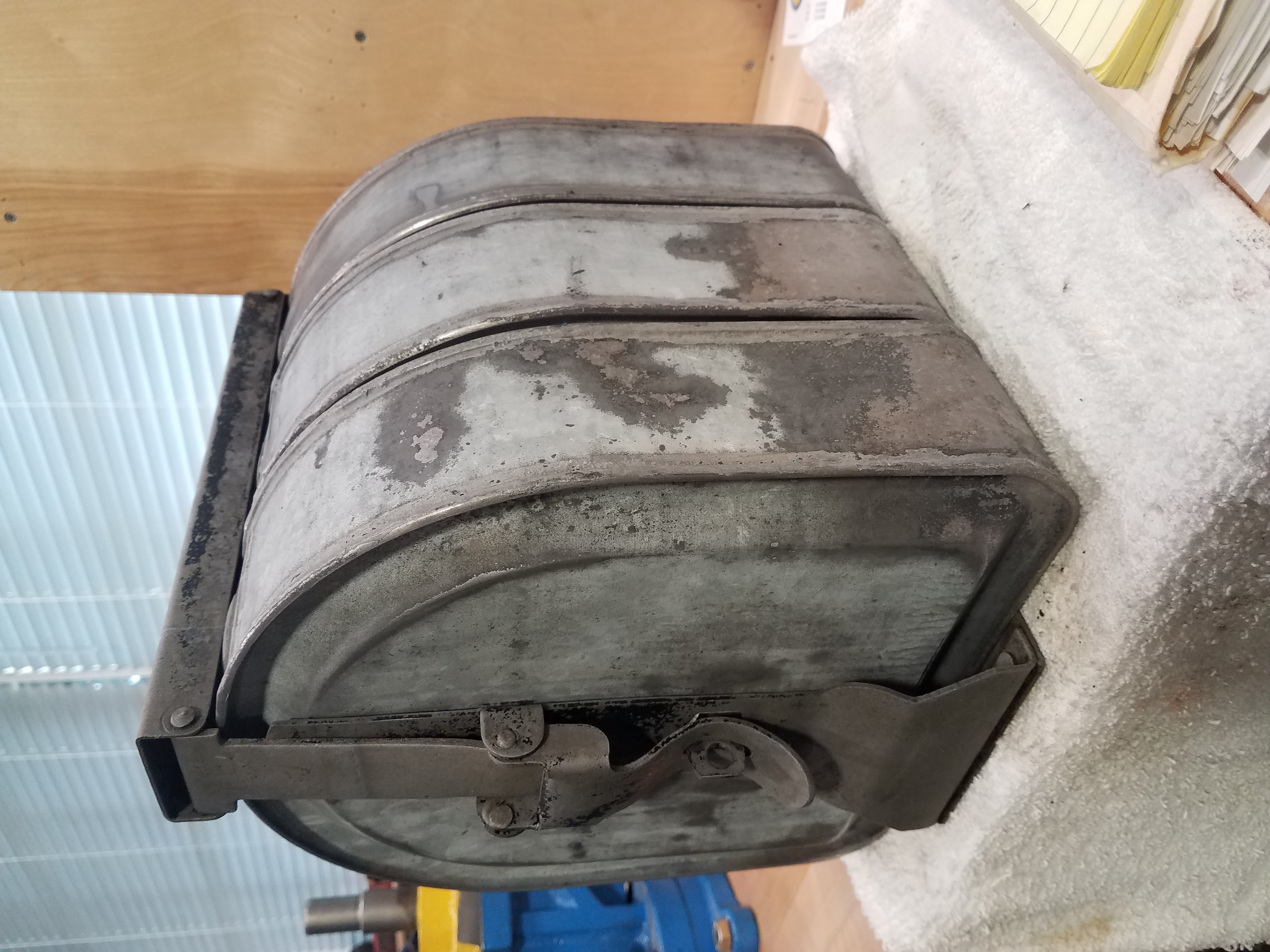

Well, I'm sold. The great thing is the cans are just as clean inside. You won't get that with bead blasting.
Very user friendly stuff.

Looks great! Did you submerse the cans all at once or one at a time in a container. I have a 25 block and thinking about using evapo rust and wondering how much of it to use.

I bought a 5 gallon container, and soaked each one at a time overnight. The oil can I soaked with lacquer thinner first to remove the residue.John kuehn wrote: ↑Sat Oct 24, 2020 8:37 amLooks great! Did you submerse the cans all at once or one at a time in a container. I have a 25 block and thinking about using evapo rust and wondering how much of it to use.

The Evapo Rust label says it is safe on galvanizing, but that has not been my experience.
My neighbor gave me some galvanized shelf brackets that had been sitting in his garage and they did have some areas of rust so I gave them a soak in Evapo-Rust. It removed 100% of the zinc plating. It's possible I left them in the solution too long.
It doesn't harm nickel or chrome in my experience.

Boyco cans are not galvanized, they are Terne Plate. (lead/tin).Erik Johnson wrote: ↑Sat Oct 24, 2020 12:28 pmRE: running board cans
