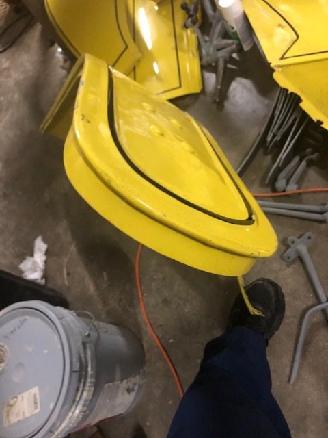

I have the pictured front fenders that are going to be repainted white. Is it possible to get mild steel and add the sexy 1916 style cuff like in these pictures https://modeltfordfix.com/the-1916-model-t-ford/ on the end of the fender? I was thinking 18 gauge mild steel get a trace and graft it on. The only problem is that I don't have any in my possession to trace out?

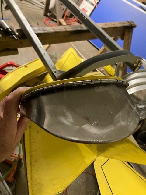

The 'eyebrows' arrived from Rootlieb. I am glad I did not try to build these. Now how to graft them onto the fender? I can cut and stitch weld the straight parts on the back easily enough but what about the curled rounded edge? Do I open up the curled front edge of the fender, cut off the old straight down piece, install the new piece and try to curl the top curled edge back over? Any advice appreciated.

That 'rolled' part at the top was rolled into the front edge of the fenders. To install those as they were done originally, you'd need to "unroll" the front edges of your fenders, insert the bills, and re-roll them in place. I doubt that you can do that and make it look good. My suggestion would be to cut the top edges off the bills and weld or braze them into place. That's actually my second suggestion. My first suggestion is to leave your fenders without bills, since they are nice ones. What you are proposing is a lot of work and it will be very difficult to get a nice-looking job out of it. Maybe you can trade yours for some which already have bills, if you must have them.

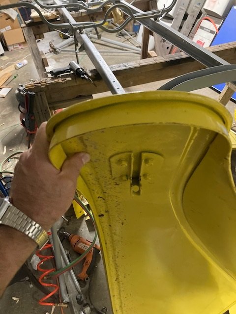

Back in the day, there were some accessory brows made specifically for addition to “plain” fenders. I believe they went on with some small machine screws or small rivets. I had an old original fender with one of those well over 15 years ago. I think the part from Rootlieb may not work very well (or at all) in an existing fender. That is a new part made to be installed into the wire bead of a fender as it is being manufactured.

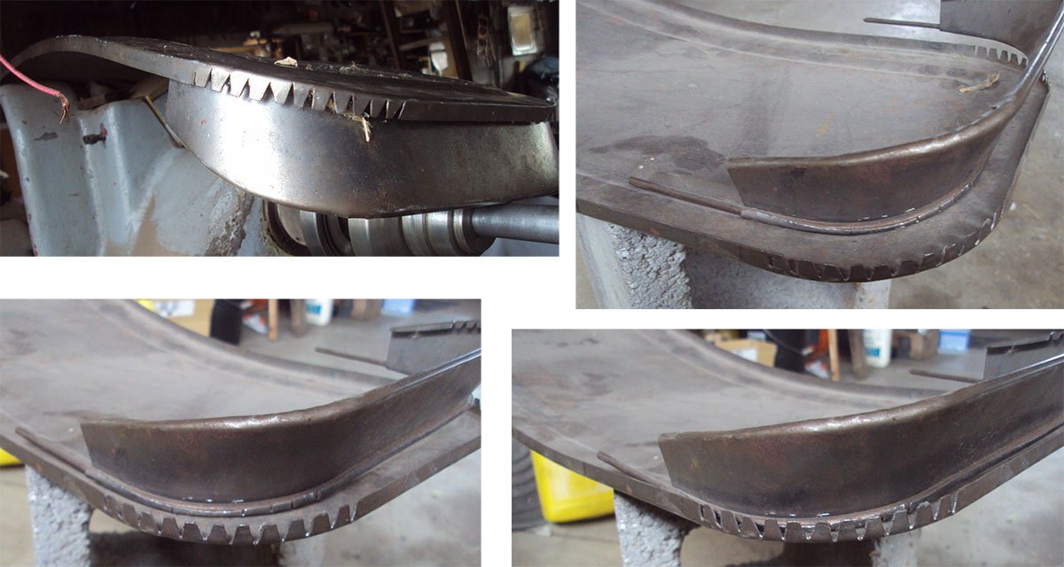

Post by Rich Eagle » Sun Dec 13, 2020 2:30 pm
Mike is correct. Do these photos help?

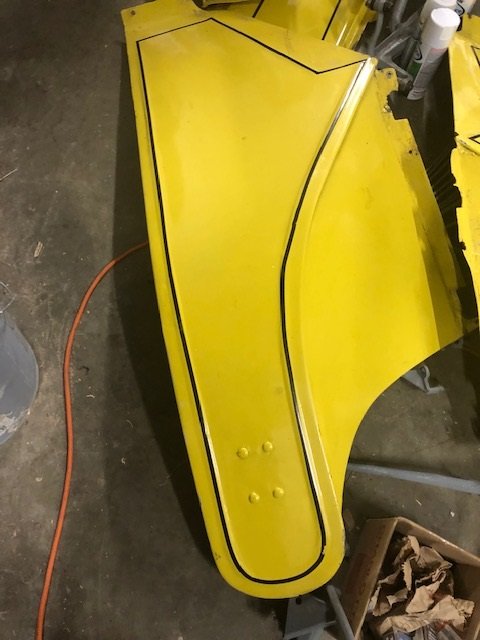

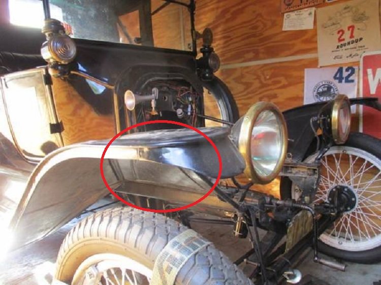

Post by TRDxB2 » Mon Dec 14, 2020 12:05 am
Saw this one on a recent thread about a stolen T and Trailer. The ends of the brow appear to be riveted to the existing fender. This supports what Adam mentioned "Back in the day, there were some accessory brows made specifically for addition to “plain” fenders. I believe they went on with some small machine screws or small rivets. I had an old original fender with one of those well over 15 years ago. I think the part from Rootlieb may not work very well (or at all) in an existing fender. That is a new part made to be installed into the wire bead of a fender as it is being manufactured."

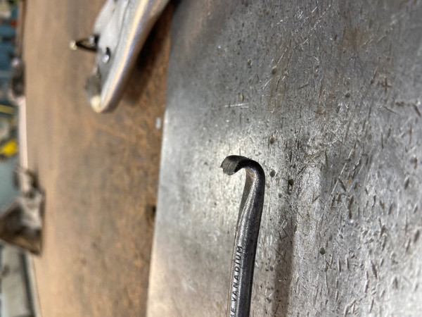

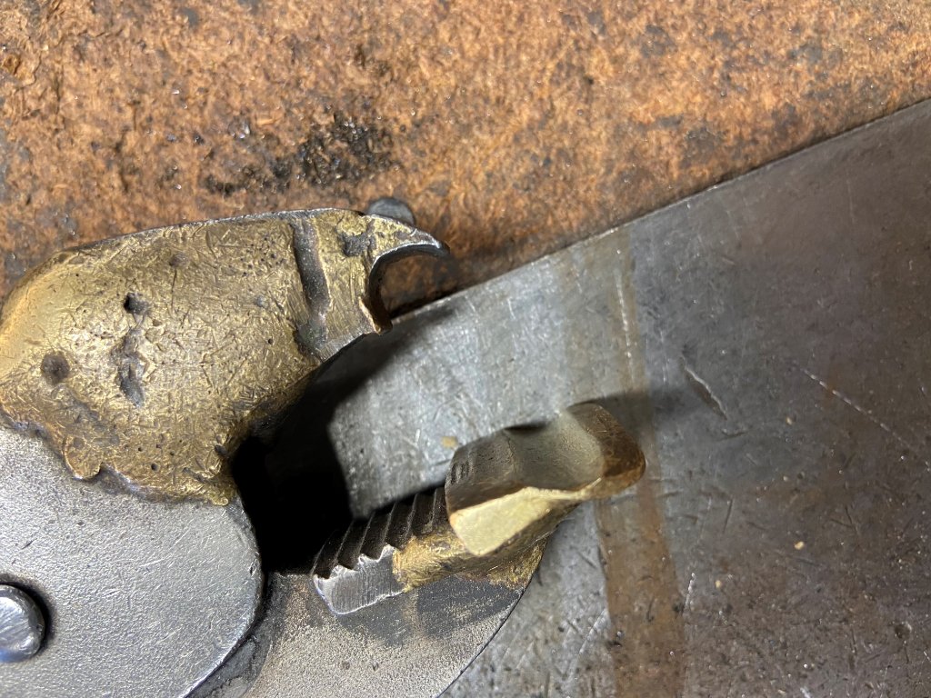

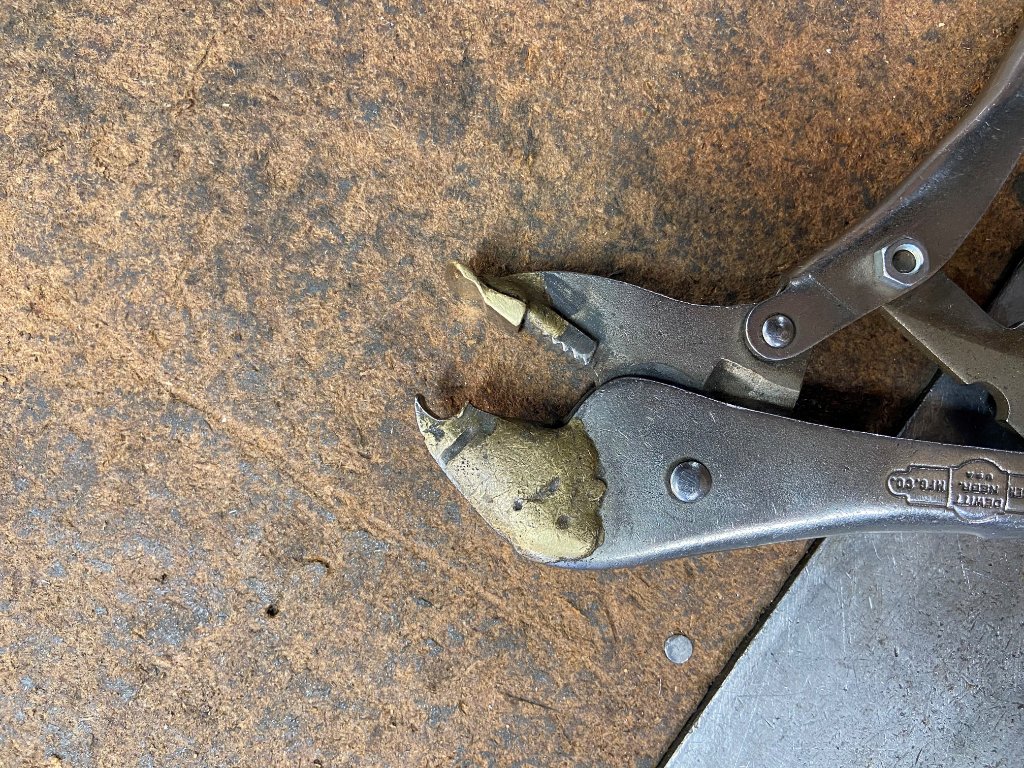

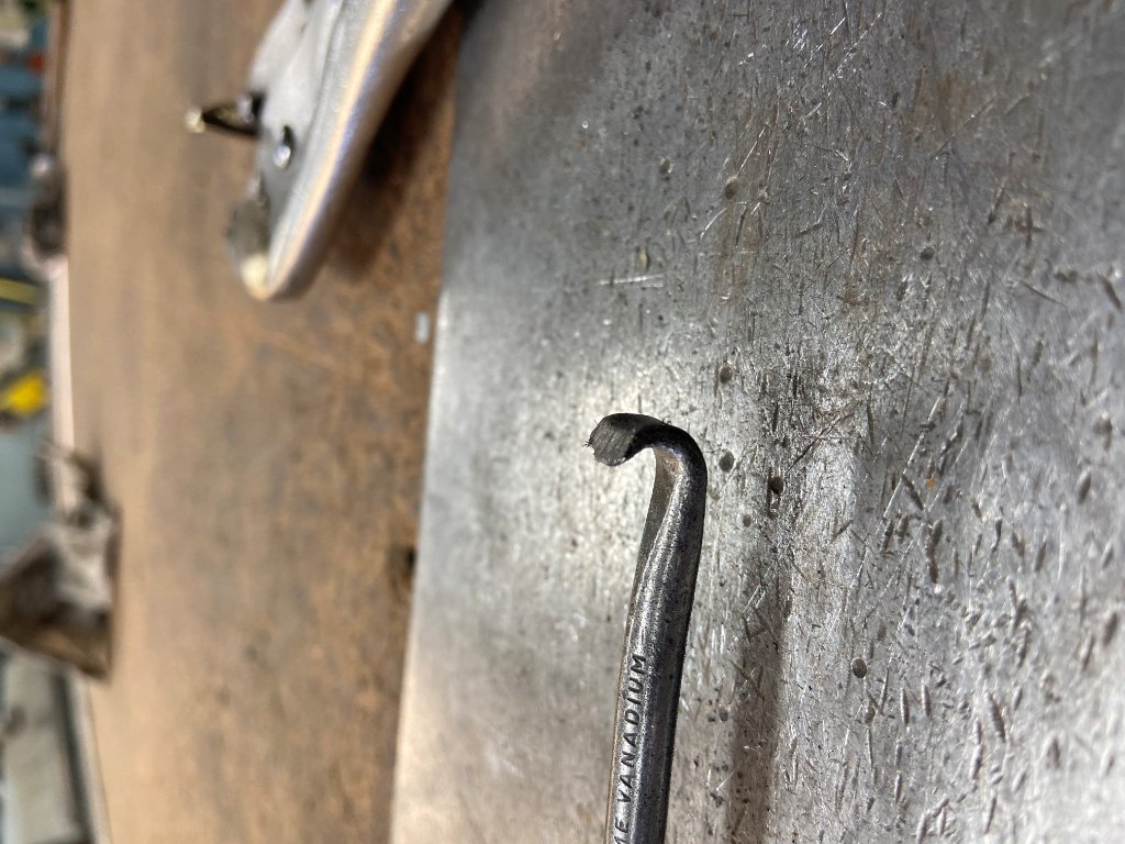

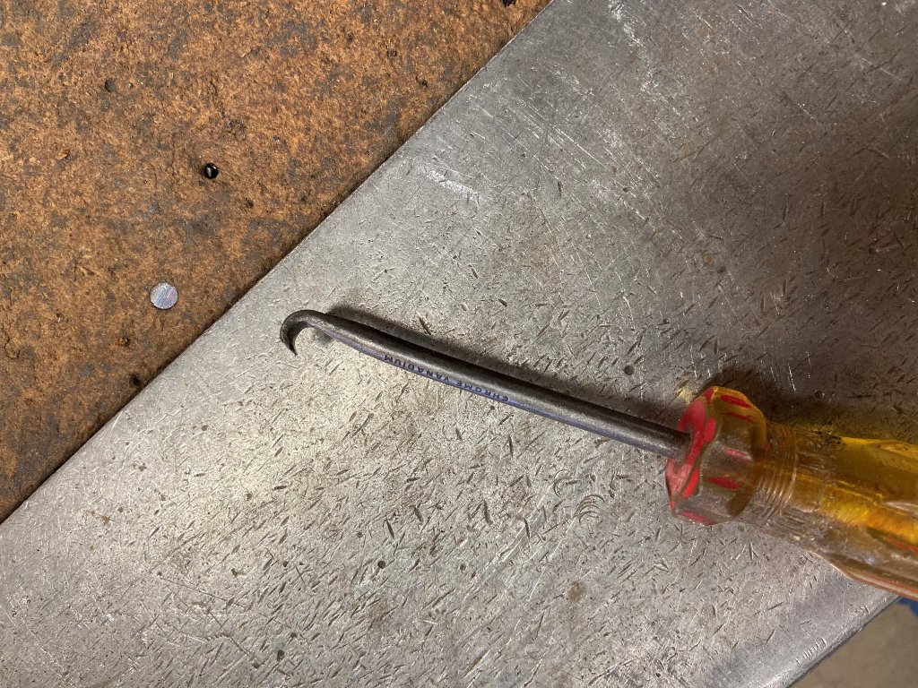

I spoke to Rootlieb. They use the 2 tools pictured which I now have to make. The screwdriver undoes the round bead, the modified vise-grip crimps it. Heat and somehow bend the screwdriver end into a circle. The vise-grip crimper looks ground and brazed I think. The trick will be making the circular depression in the vise grip.

No beat up fenders to practice on. That modified, but interesting, vise grip is going to be difficult to reproduce in my garage.

A paint can opener broke off easily so the answer is no you can't use a paint can opener. So I obtained an old screwdriver and curled it using heat. That one also broke off on the fender bead. I see that the screwdriver in the picture has 'vanadium' printed on it so it would seem that I need one of those.
