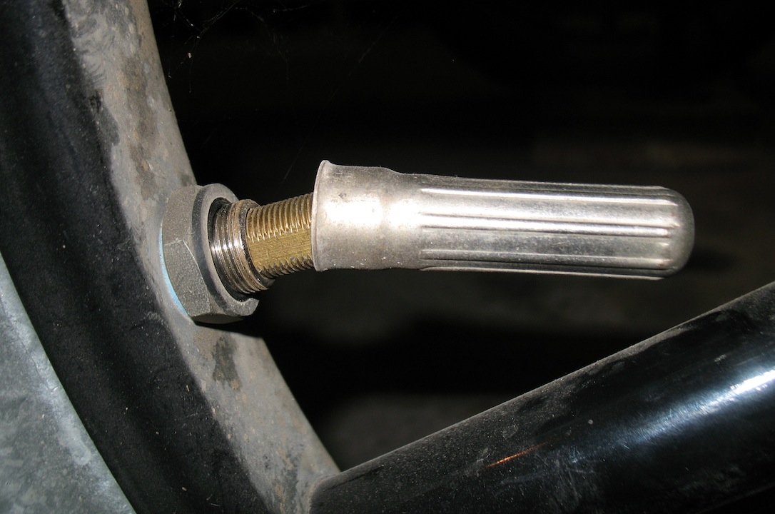

Post by Original Smith » Sun Nov 01, 2020 2:58 pm
Why I use Schrader 888 valve stems instead of 777's. They are 1/4" shorter, and do the same job, with a few threads to spare. The main reason in weight. They work exactly the same with a 30X3 or 30X3 1/2.

Post by Steve Jelf » Sun Nov 01, 2020 5:14 pm
The 888 weighs 37 grams. The 777 weighs 42 grams.
Does a five gram difference really matter?
The ¼" does save a few seconds of dust cover twisting (6.75 full twists).

Steve- the stem has no effect on the Cover as it threads onto the rim nut, not the stem.

Steve, you must have been posting when I was weighing. The difference I found was just 4g. Then I weighed two bridge washers. One with the pressed in sealing ridge was 10g. A second one having a separate brass sealing ring affixed was 14g, so there goes the difference. Even if the two heavier components are combined the difference is a paltry .28 of one ounce. They might have worried about that on Donald Campbell's world record car at Lake Eyre in 1964, but I figure it is inconsequential on a T. It does make collecting either stems to make a set a lot easier.
