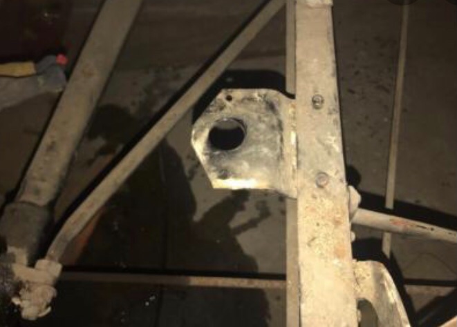

This is a factory switch mount on a 23-24 frame. What type of switch was mounted on it? I have not seen this bracket before. Thanks for any help

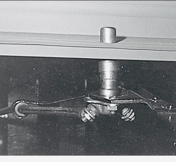

Likely the 1919-1920 early switch mount. Photo from Bruce’s book.

I used the frame hole count and hole placement to date this frame. I thought it was 22 1/2 to 24 model year by the chart, but now I will have to recalculate my thinking. Thanks for your help.

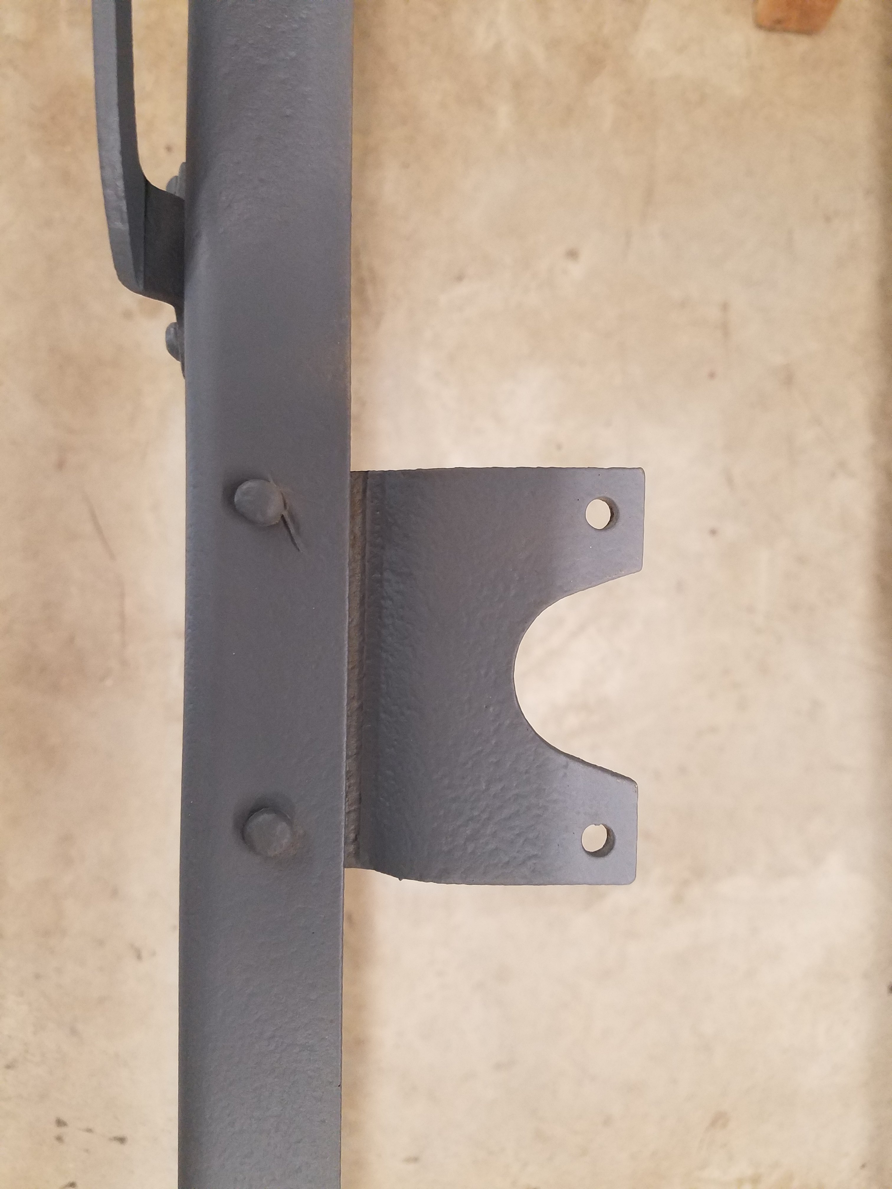

Another photo off prior forum post of a 1919 -20 frame with this riveted mount for foot switch. Yours seems bit different .

I went and took a look at a 1919 non starter touring a couple weeks ago that had that same bracket riveted to the frame.

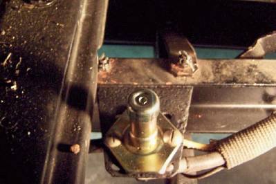

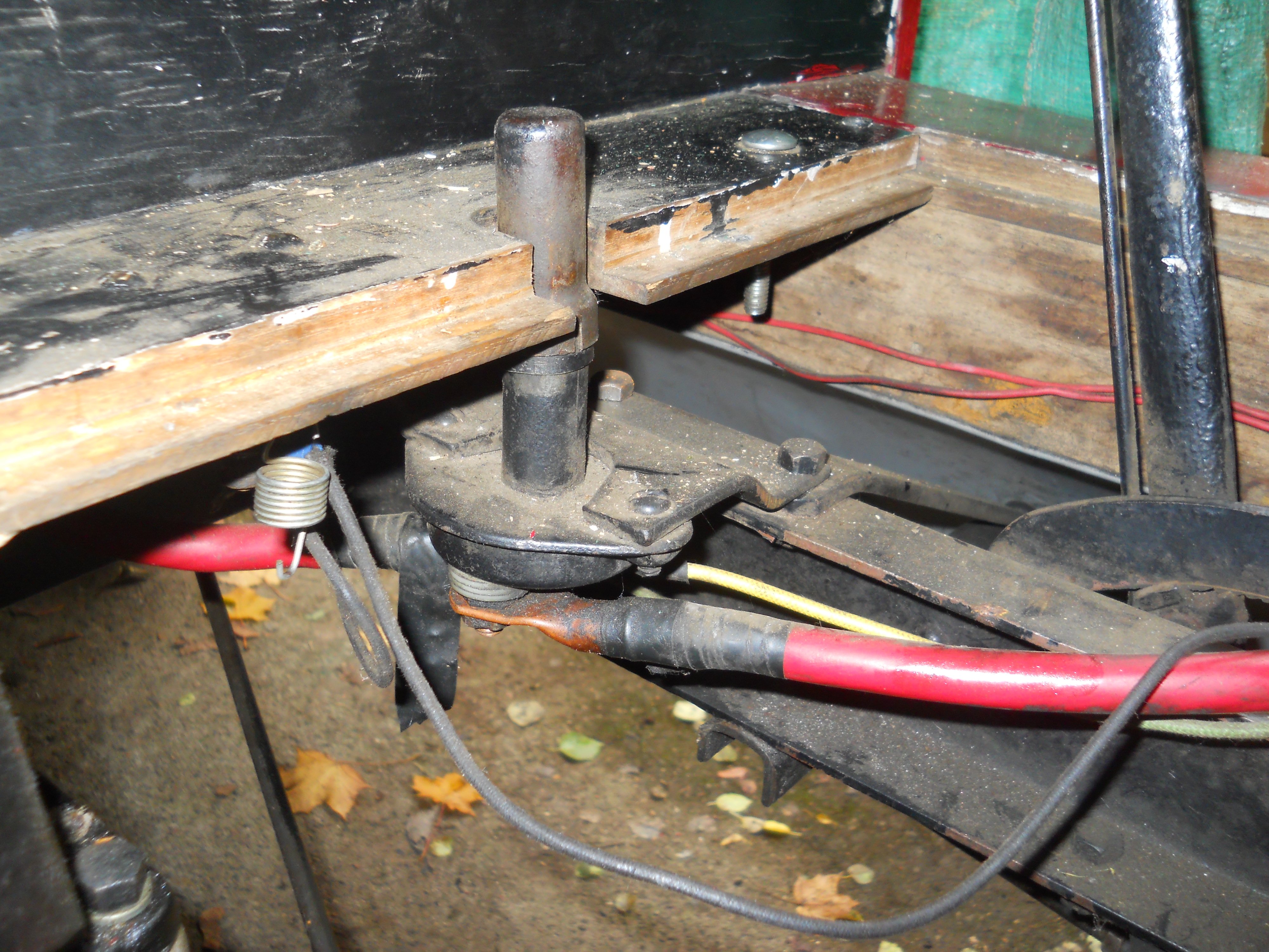

Here is a photo of the switch in my late 24 Coupe. As you can see there is no extra bracket on this car and the switch bolts directly on the frame. I also have another switch that was used I placed next to the one in my car. They are almost identical. The switch was in the car when I got it it in 1958 and seems to be original for the car. Ford must have used several different styles. This on eliminates the use of an ‘extra’ bracket so maybe this was a cost and time saving style that was used. It would save the extra step of riveting the bracket to the frame. Another detail is the frame has the four hole ratchet bracket riveted to it. So it’s a 24.

This is the kind of information we need to have available for our members. I have seen those frames before, and they are important for the owners of those cars to know about. I'm not sure, but I believe I've seen examples of switches that are still available to fit those brackets.

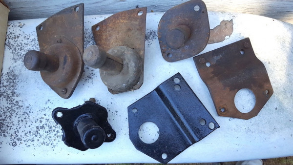

Here are the various foot switch used on the T. Maybe more styles, but one shows riveted bracket type.
Photo taken from old forum post.
Once used a Tractor Supply Co. switch sold for universal use. Drilled holes in the std.later bracket that bolts under the running board bracket brace. Of course the early frames didn't have that type of running board brackets or holes, so the early foot switch bracket is riveted to the frame.
One could adapt a modern switch like the TSC to save the original bracket.

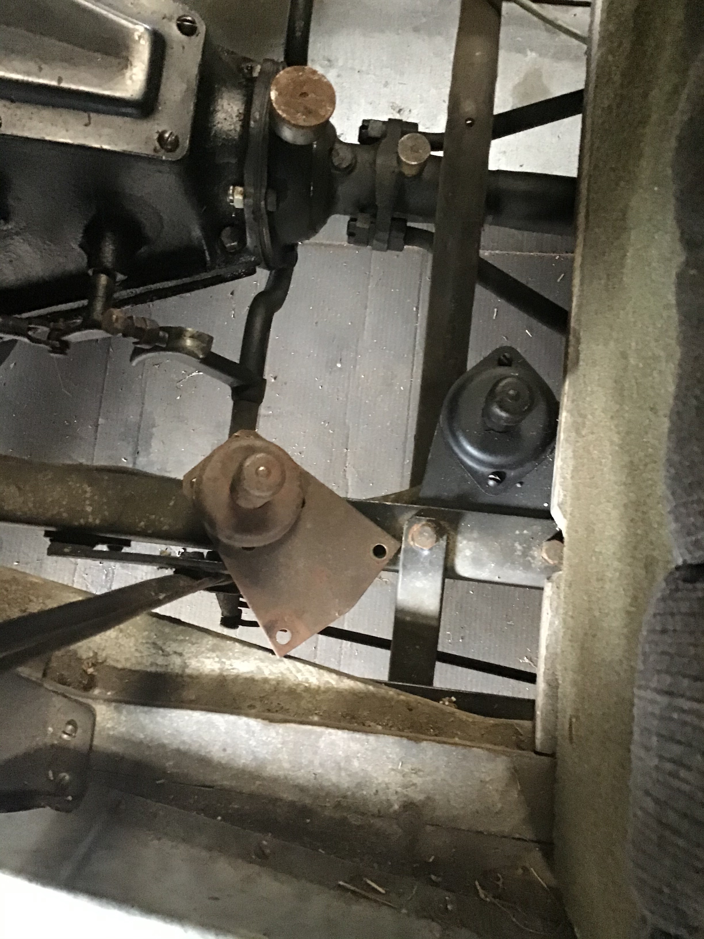

My later 1921 has the open style. I do not recall changing it out when I did the chassis. This one is bolted on. In the photo I moved it to the topside of the frame, even with the extension it was too low for my application, normally would be mounted to underside.
