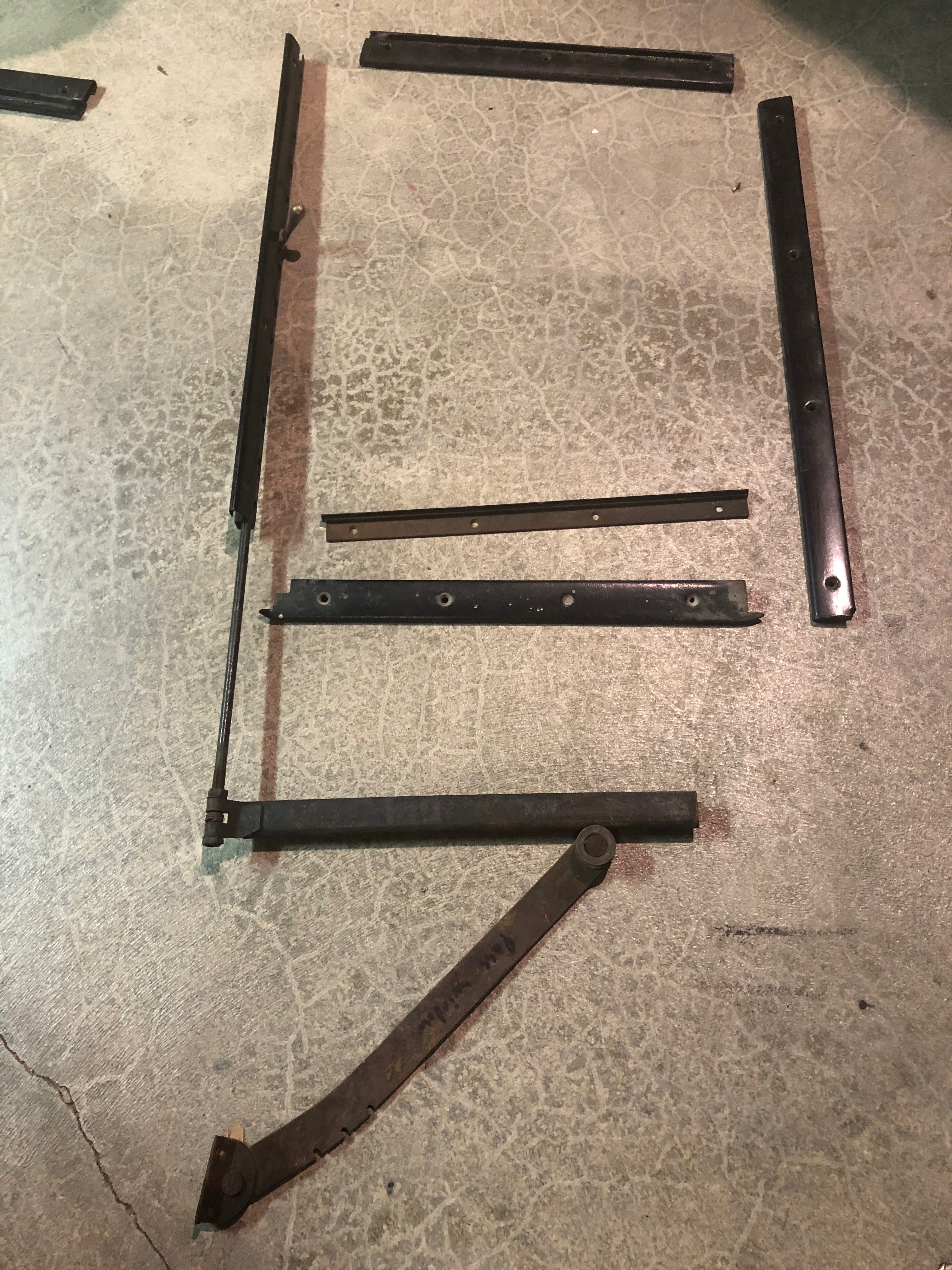

Here is a photo of the hardware I removed from my ‘24 coupe.   This was quarter window on the passenger side. I have a couple questions.  Is this all the hardware? Is there a spring for the arm with the roller?  Does anyone have the latch and window tray for the drivers side?   I think the quarter window hardware in a 4 door maybe similar.  Anyone with experience with this would be helpful.   Thanks! mike

I have a 24 Coupe I restored a few years ago.  As best as I remember there is a spring that’s attached to the the arm with the roller that helps in raising the window.  I was lucky enough to have all the inside trim and hardware still in my car.  Good luck in finding the other trim you need.   There was a 24 Coupe body that came up for sale several months ago in the classifieds.  Maybe it didn’t sell and it could be a resource for parts.
