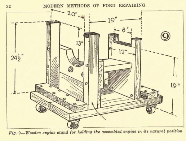

The link below is for the Ford Dealer And Service Field magazine for January, 1927. On page 111 they have a nice plan for an engine dolly/stand made from pipe and pipe fittings. Also on page 96 they have an article titled "You Can Build a Slip-On Body for a Roadster", if you might be interested in building a wooden pick-up bed.
http://www.cimorelli.com/mtdl/1927/1927foadjan.pdf

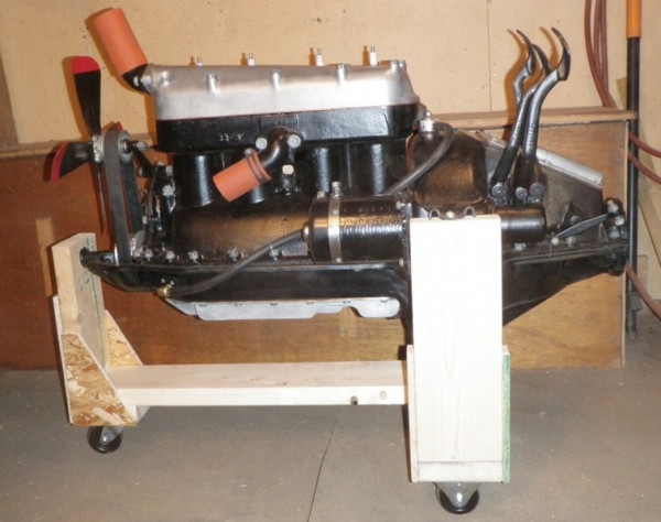

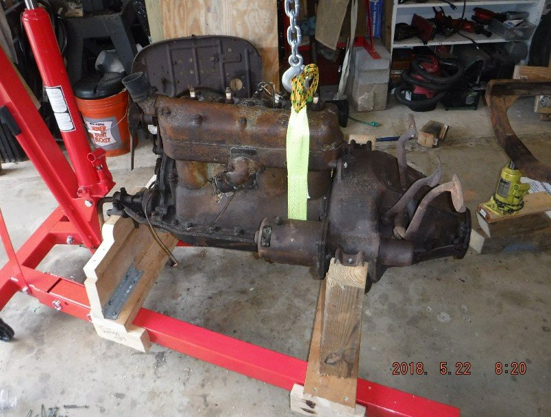

I know your looking for a particular engine stand and there are allot of designs and styles built over the years. I have a very tiny shop and space is a problem. This is one I built that uses the engine puller as the stand. It worked great for holding the engine in storage until I was ready to transfer it to an engine block stand to rebuild it. Just an option.

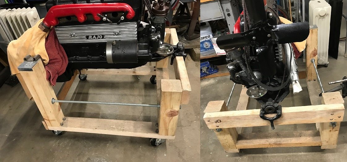

Well, might as well toss in a picture of mine! Have to say, I hijacked the design from Joe Bell, then just added one more "improvement", in an extra 2x4 across each leg bottom so as to clear the engine crane. Works great for me! I doubt I have $20 in material in it. Like oil and timers, there's a zillion variations, just have to figure out what works best for you and your wallet.

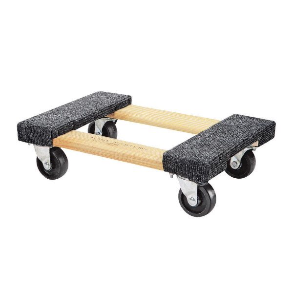

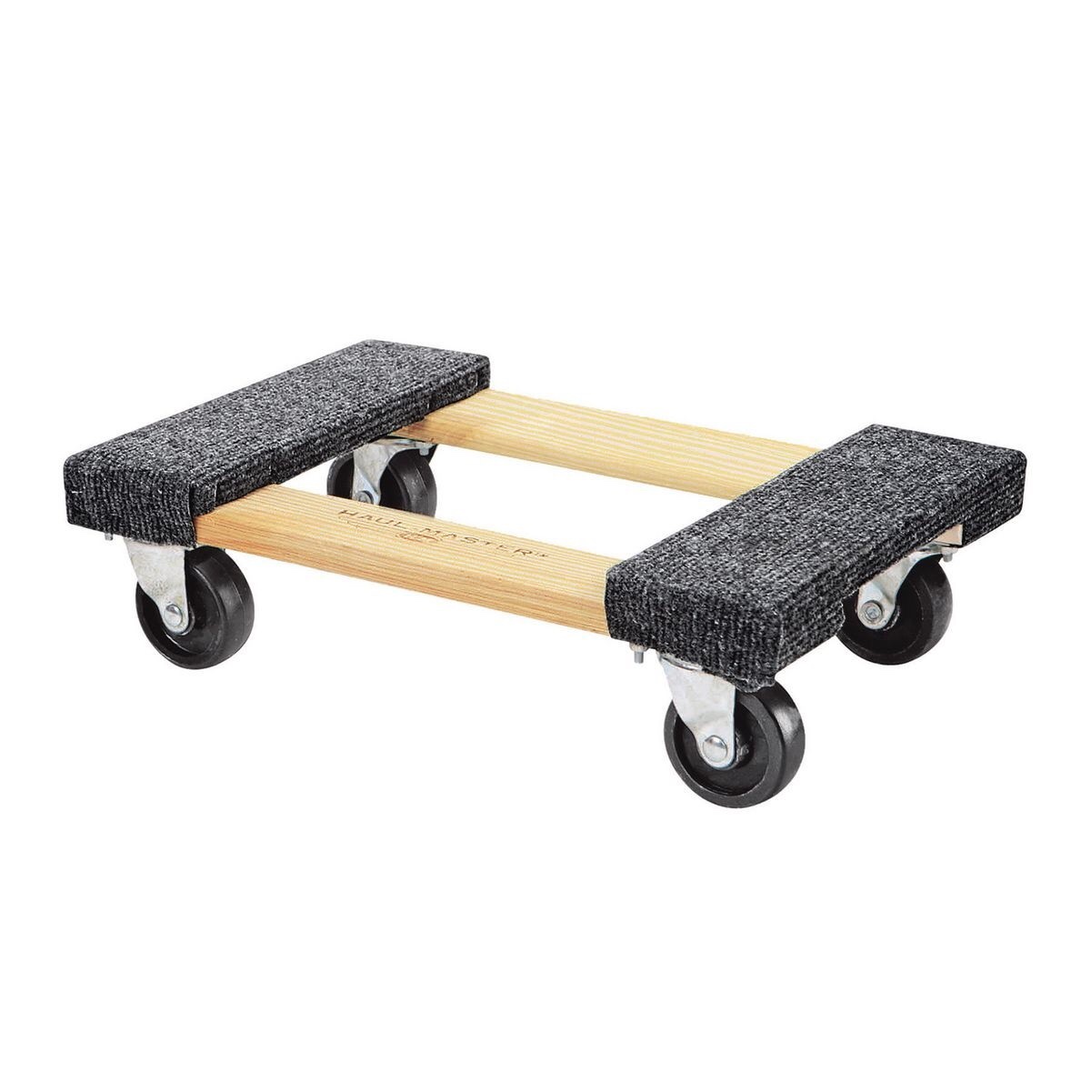

For storage and easy movement around the shop, I buy the small Harbor Freight moving dollies (usually around $10 when on sale), add some scrap lumber to hold the engine nicely and voila, a T engine you can roll around the shop to get it out of the way. Can't buy the casters for that price! yes, they are plenty strong enough to hold the engine's weight.

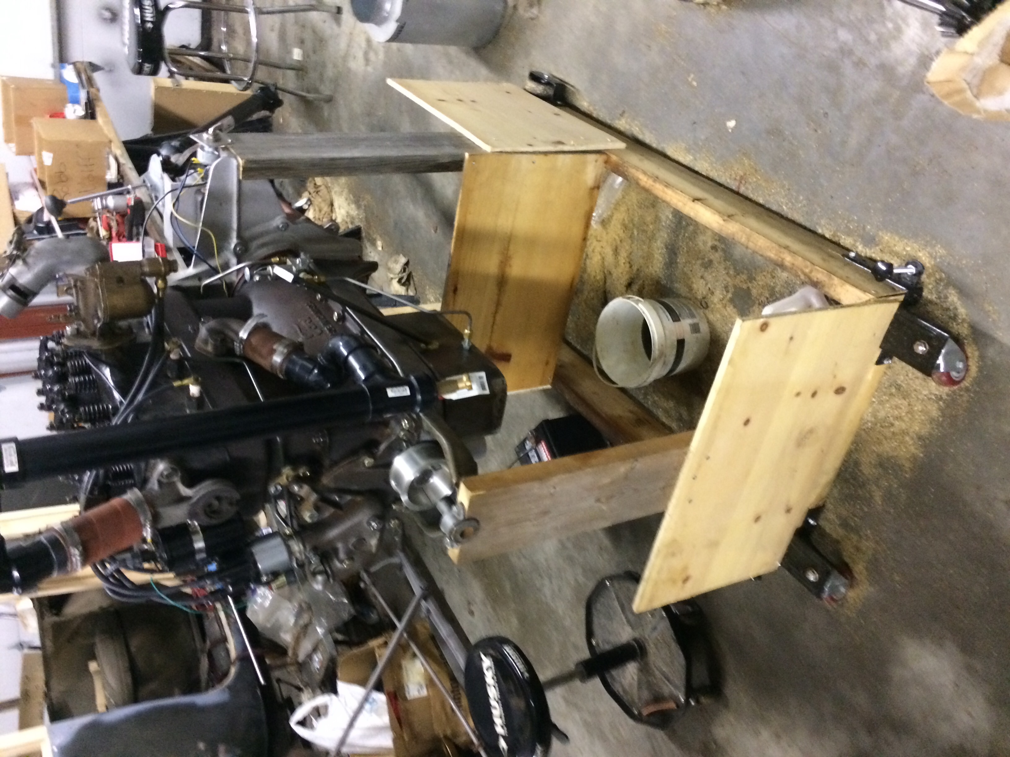

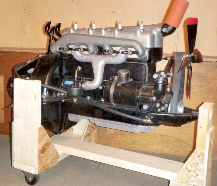

Here is my version. I use it for run testing and I am 6’4” so I want it tall!!

David do you have pictures and/or some measurements for your Harbor Freight piano mover modifications?
david_dewey wrote: ↑Thu Nov 12, 2020 2:27 pmFor storage and easy movement around the shop, I buy the small Harbor Freight moving dollies (usually around $10 when on sale), add some scrap lumber to hold the engine nicely and voila, a T engine you can roll around the shop to get it out of the way. Can't buy the casters for that price! yes, they are plenty strong enough to hold the engine's weight.

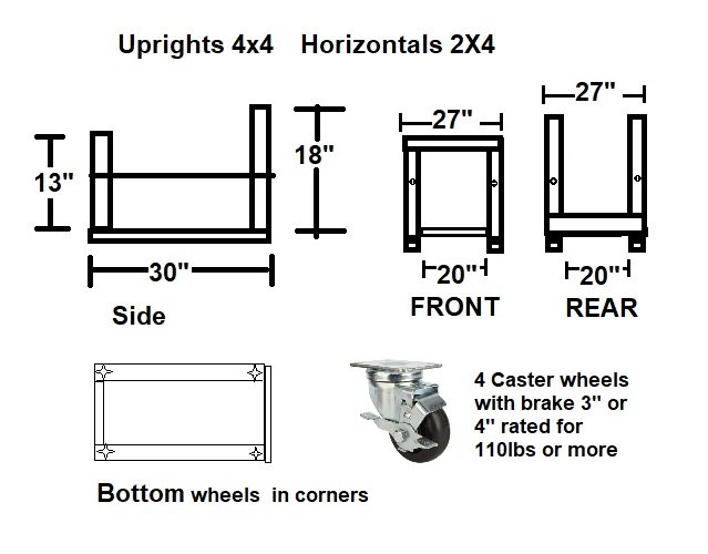

Here ‘tis. 12”x 18”. $10.99. Jim Patrick
- Posts: 6581
Re: I want to build a wood engine stand (Need Help)

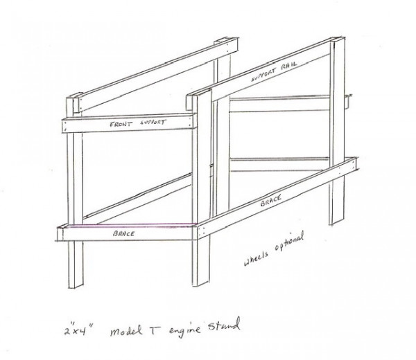

Made it simple (no angle cuts) 4x4, 2x4 1x4. Carriage bolts, lag bolts use any diameter threaded rod its just to steady the posts while the engine is dropped in place. Most expensive part are the caster wheels - I was going to buy a dolly and use the wheels but didn't like the quality, up to you. Harbor Freight Dollies are 30"x18" so you can use it for the base by making it wider. Wheel decision should be based on the evenness of your floor, 4" turns easier than 3", 4 swivel more maneuverable than 2 swivel on one end and 2 straight on the other

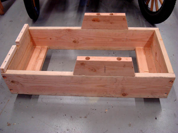

Here is another picture of my stand built by 2X10's. I have to go to the shop to get measurements. '

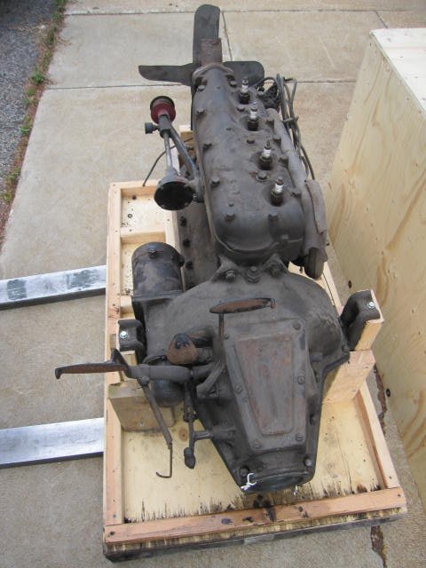

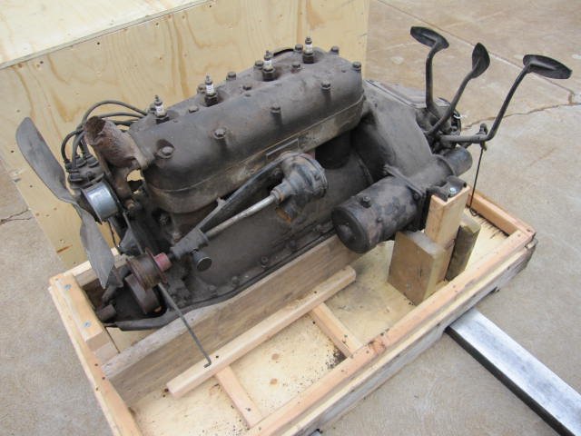

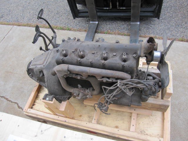

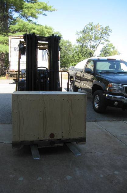

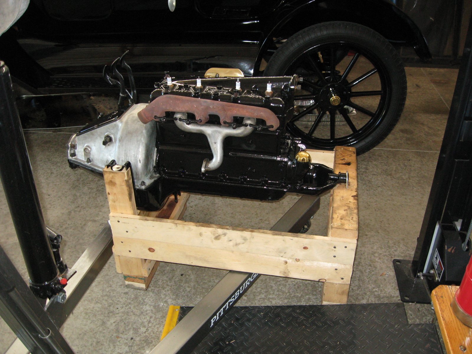

Bruce: You can have a look at these pictures as this was shipped to us from Calgary Canada and went both ways without damage.

OK, Here they are: Outside measurements 49 X 23. From nose to hump 22", hump is 4 1/2 " high and 14 inches long. I drilled into the hump so I didn't need real long screws to install the hump (with glue also). Use your imagination on the rest. Harbor freight has wheels. As mentioned, use 2X10 lumber for the sides
I run the engine on this stand using an old radiator, a lawnmower gas tank (mounted on an 18 8nch riser) attached to the stand, and a coil box and coils also mounted on the sand. You'll need a wire ( 3/16) will do) to control the throttle and spsark advance. If you run an engine for a length of time set a fan in front of the rediator
The political lawn signs are 3/16 wire. I usually snag a few leftovers after an election
I hope this helps and good luck....Cheers
