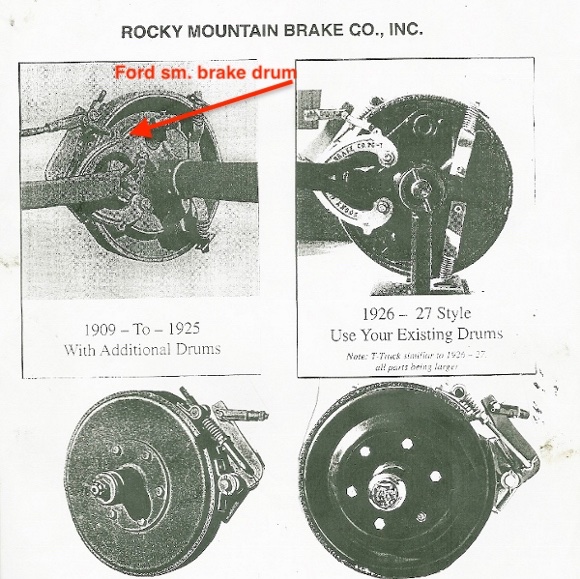

I have a set of RM brakes for a small drum car. they have the six whole large drum adapter. I have wire spoked wheels with five holes. I can get a five hole large drum adapter and use that. If that works, is it possible to used these brakes on a 27?

Quick answer if your ‘small drum’ 09-25 brakes are the modern RM then they won’t fit the 26-27 rear axle backing plate and radius rods as the 2 styles use different bracket castings.
Best to trade them for the 26-27 version, then the brackets and shoes will fit directly on the large outer brake drum and you’ll retain the internal parking/emergency shoes using Ford parts with your Ford wire wheels and wire wheel rear hubs and drums.

Post by DanTreace » Fri Nov 13, 2020 7:57 am
Jonah
Nope, those 6 hole mount onto the rear of a wood wheel hub.
You can’t place those on the wire wheel drum, as the wire wheel drum is already 11” dia. Plus the wire wheel drum is short stud secured , same short studs that retain the wire wheel. Plus the Ford wire wheel drum (or the 21" wood drum for that matter) are dished and getting another drum on top will cause interference.
When mounting the large 6 hole RM drum, onto only a wood spoke wheel, the rear Ford 8” drum is removed from the hub bolts.
Then the large RM drum is placed on the hub, then the little 8” Ford drum is placed inside it, and the hub bolt nuts secured.
