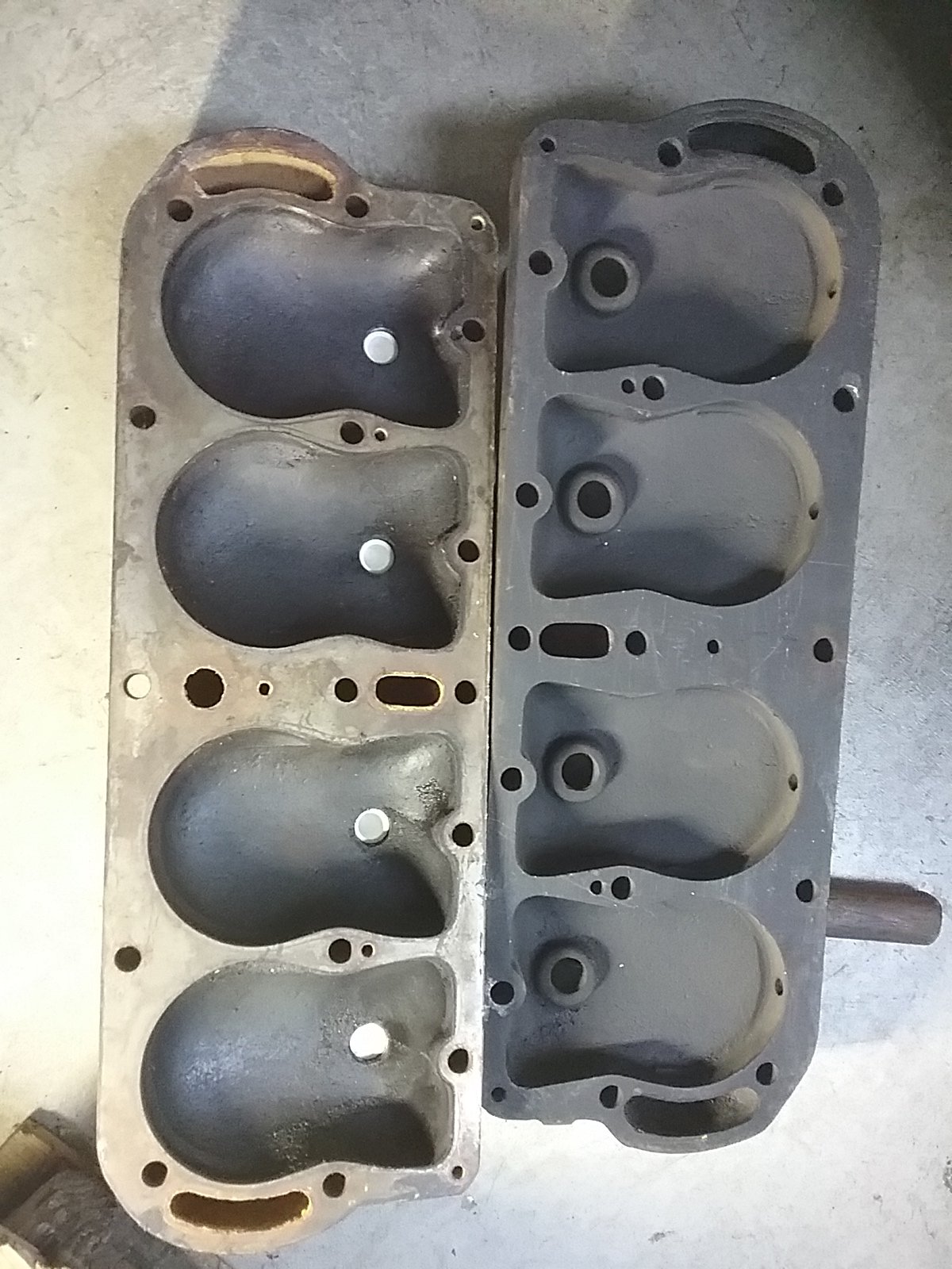

I pulled off the high head on my 1912 engine today and i noticed the engine is fitted with fully domed piston heads . The domed pistons run approx 1/2 inch above the block deck. If i was to change to a low head could it become a mechanical catastrophe ?

The high head looks to have slight deeper chamber compared to low chamber head pictured darker on the right..the low head chamber also has raised rings where spark plugs come thru ..it could be a problem there..the high head dont have these raised rings .
I will use clay to ensure clearance.
Also the low head as you can see in pic has priming holes , is it mere bolts that screw in to plug when running engine ?

The spark plug boss is over the valves, so no bother there for piston and the primer holes would be 1/8" pipe thread so try a plumber /gas supply shop for plugs for them.
