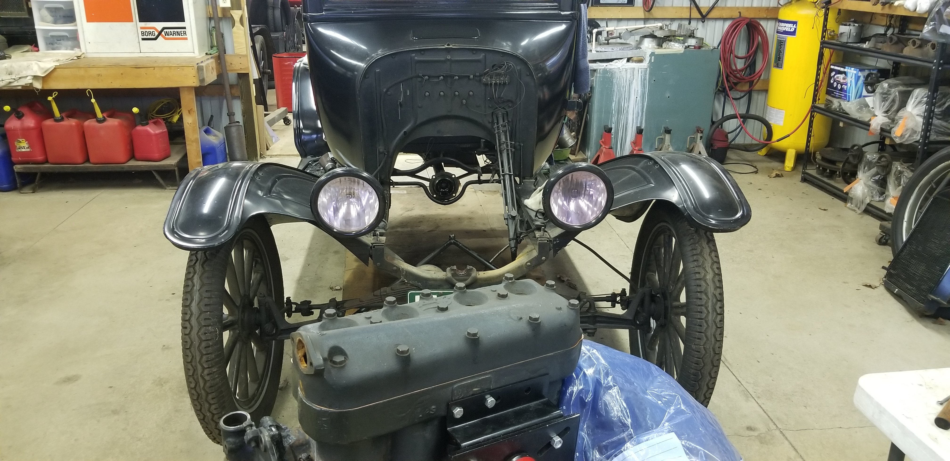

A few months ago, I pulled the engine from my 25 coupe. It's all patched up and ready to go back in now. Here's the question... if I remove the steering column, can I get the engine back in with the hogshead installed and the pedals adjusted and in their normal position? When I pulled it out, the hogshead was off. I'm hoping to do it all in one shot and avoid having to wrangle that heavy pig back onto the engine while laying through the door opening!

I agree with Dan. I have not needed to remove the firewall on any T which I pulled or installed an engine. You need a hoist and balance the engine then as you lower the engine tilt the front up until the pedals go under the firewall. All you need to to with the steering is unbolt the bracket at the bottom and remove the tie rod and the bolts at the firewall then pull the column inside the car enough to clear the engine. It helps also to remove the headlights but if careful not necessary. If you have the starter on as shown in the picture, the hardest part of the job will be putting on the nut on the crankcase ear on the drivers side. You can usually line up the U joint by tying a string around it and tie to radius rod to hold it centered and also pack with grease. Before it is in all the way cut and pull out the string. Sometimes you can line it up with your hand, but be careful not to pinch your fingers if you do it that way
