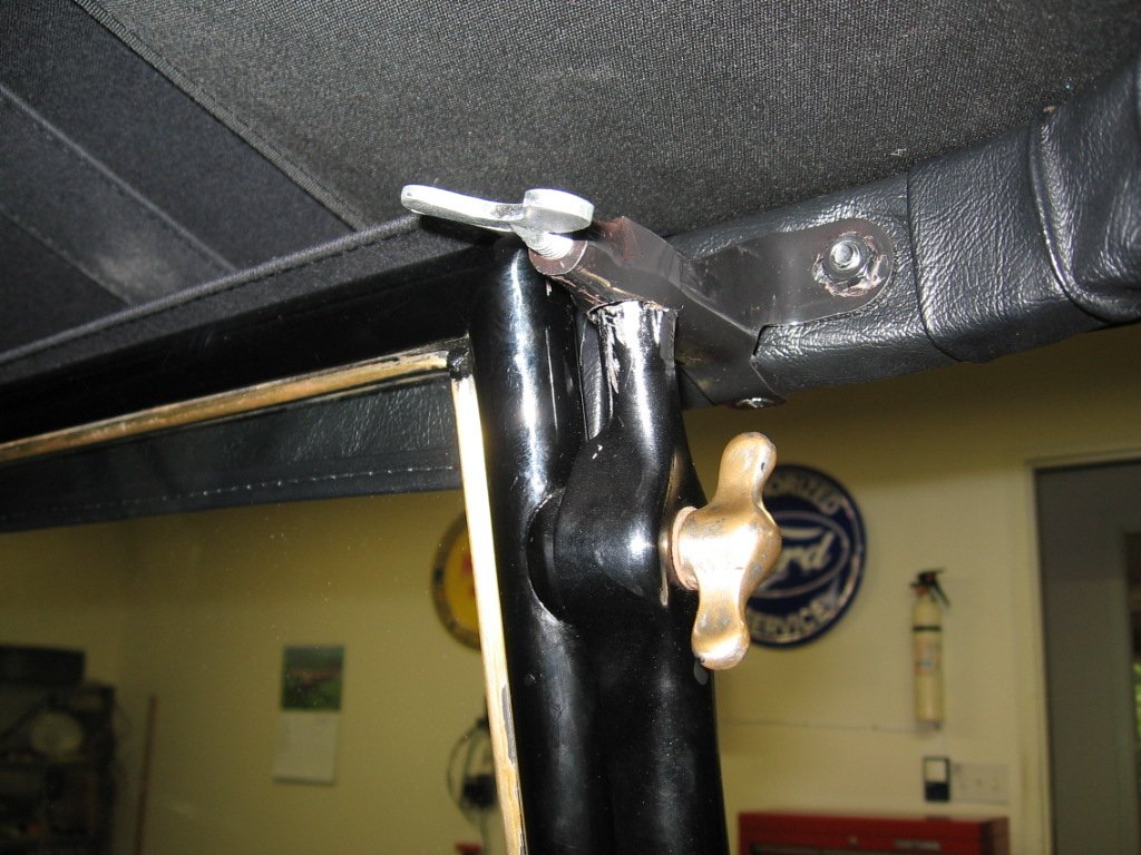

Here is what the front bow attachment looks like on my 1924 cut-off touring (now a pickup). Since this picture was taken I have nickel plated the windshield pivot wingnuts and painted the top clamp wingnuts black. :)

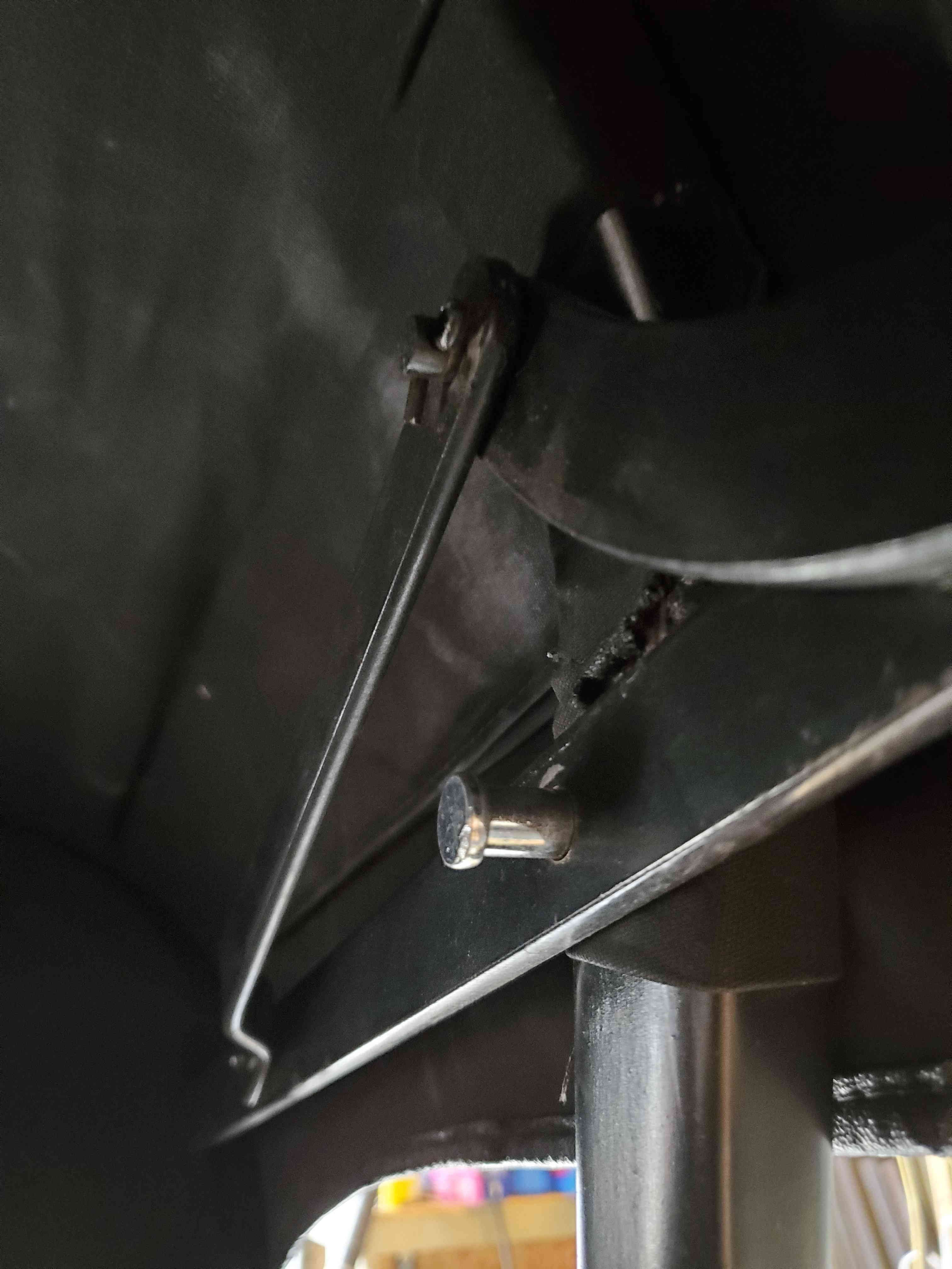

A picture is worth a 1000 words. Here are pics of the pins.

Post by Norman Kling » Tue Dec 01, 2020 4:14 pm
My car is a 26. If yours is really a 27 then it has a different top than mine has.
