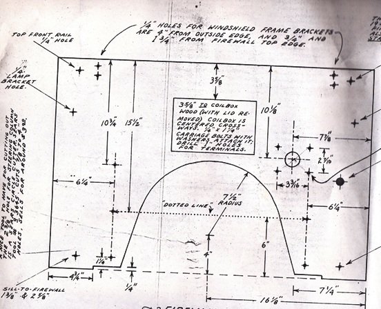

I have an undrilled firewall for a 1912 vehicle. Is there a dimensional drawing available so that I might correctly place the coil box? Where would I find it?

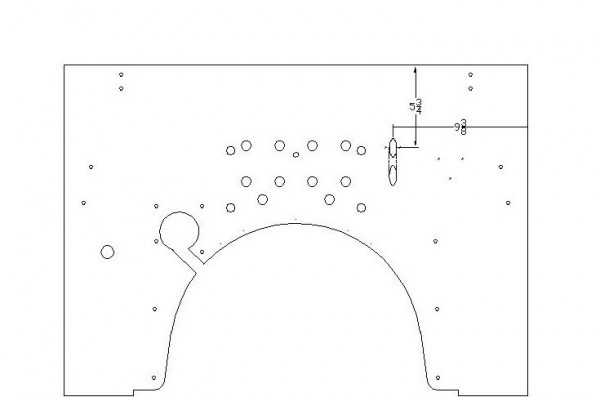

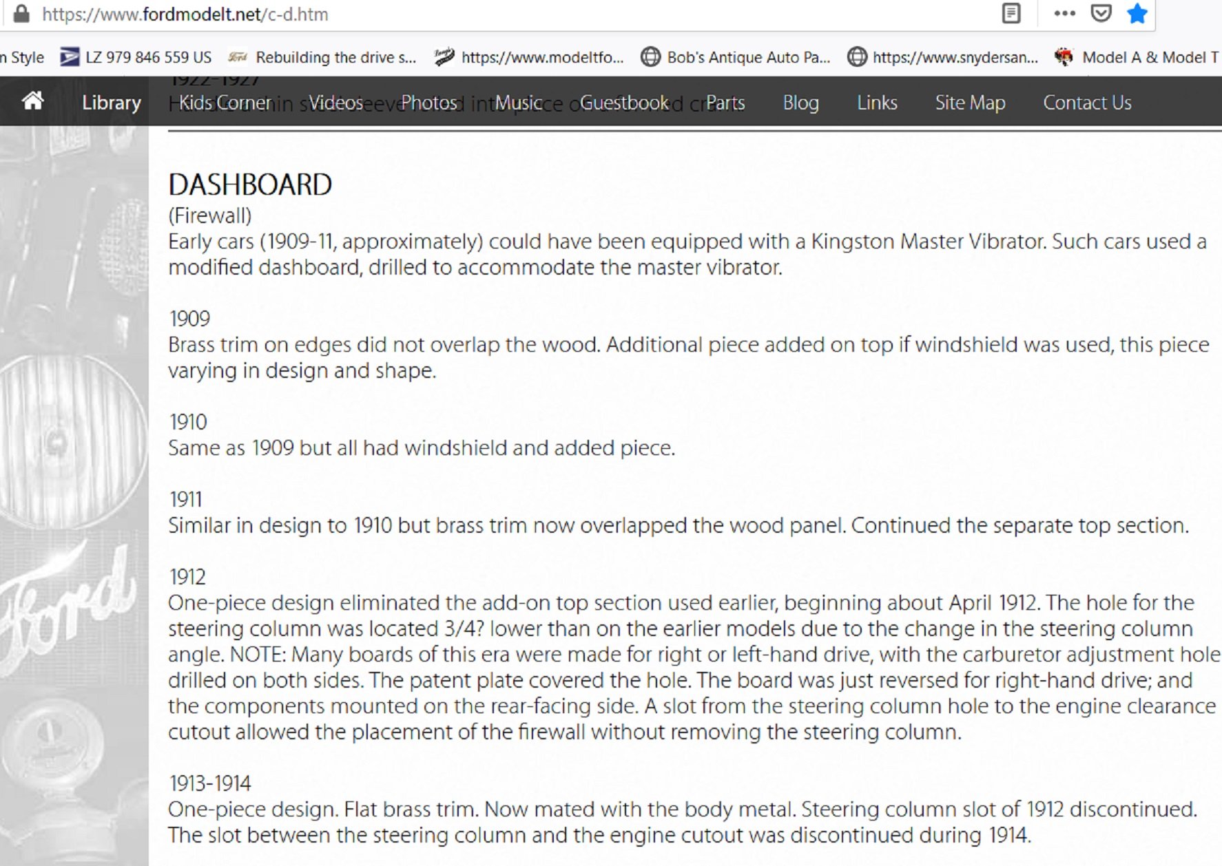

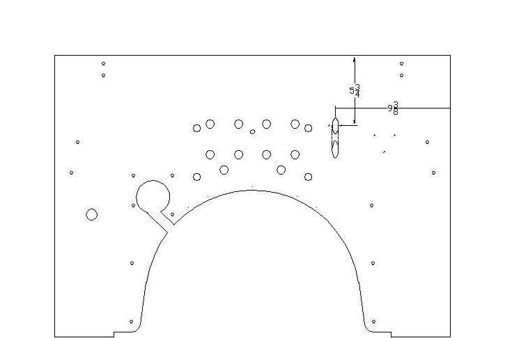

Check it out http://www.mtfca.com/discus/messages/179374/216356.html there are links by Hap Tucker that are must see!!
I found this as a 1913 but may not be accurate
1913 firewall.jpg (68.44 KiB) Viewed 1155 times
