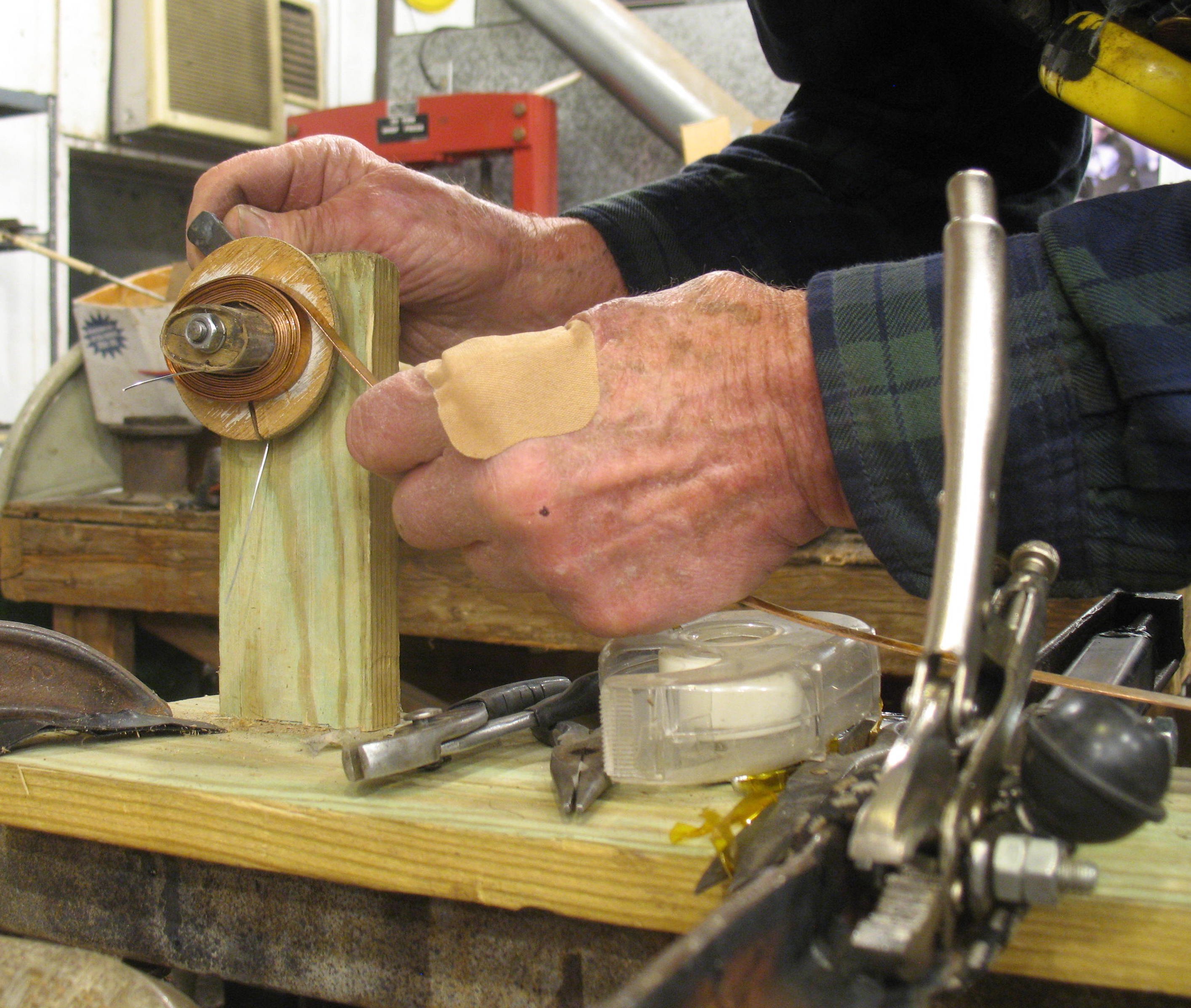

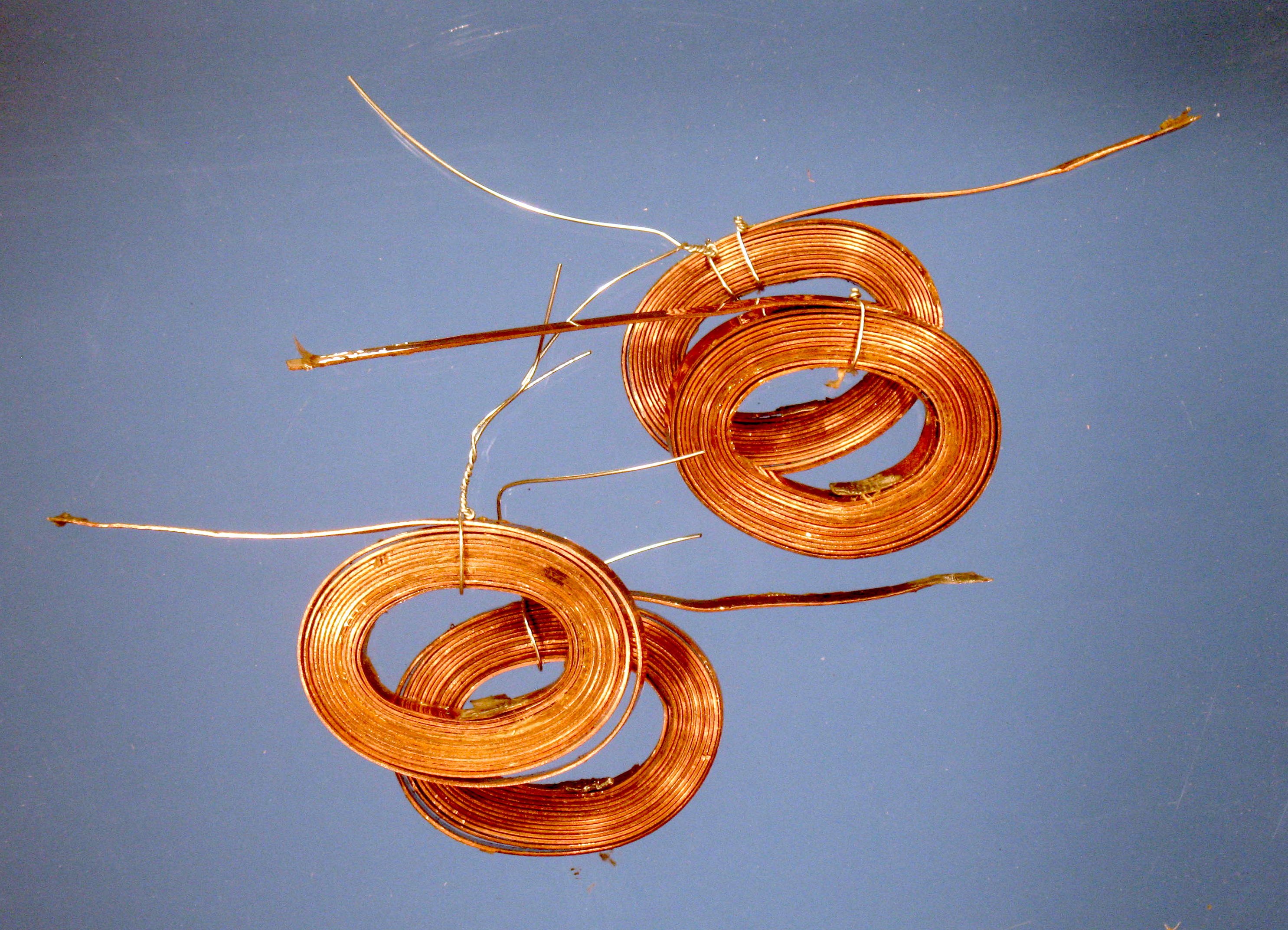

After several weeks of doing other things (cutting & splitting firewood, cleaning up storm damage, planting trees, etc.) today I got back to work on my mag ring.
Applying Kaptan insulating tape to copper ribbons. I put it on both sides. It's 1 mil, so the winding has 2 mils of insulation between layers.
Winding a coil. It took awhile to figure out how to tie a finished coil with wire so it won't unwind.
Four down, 28 to go.

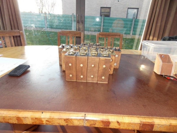

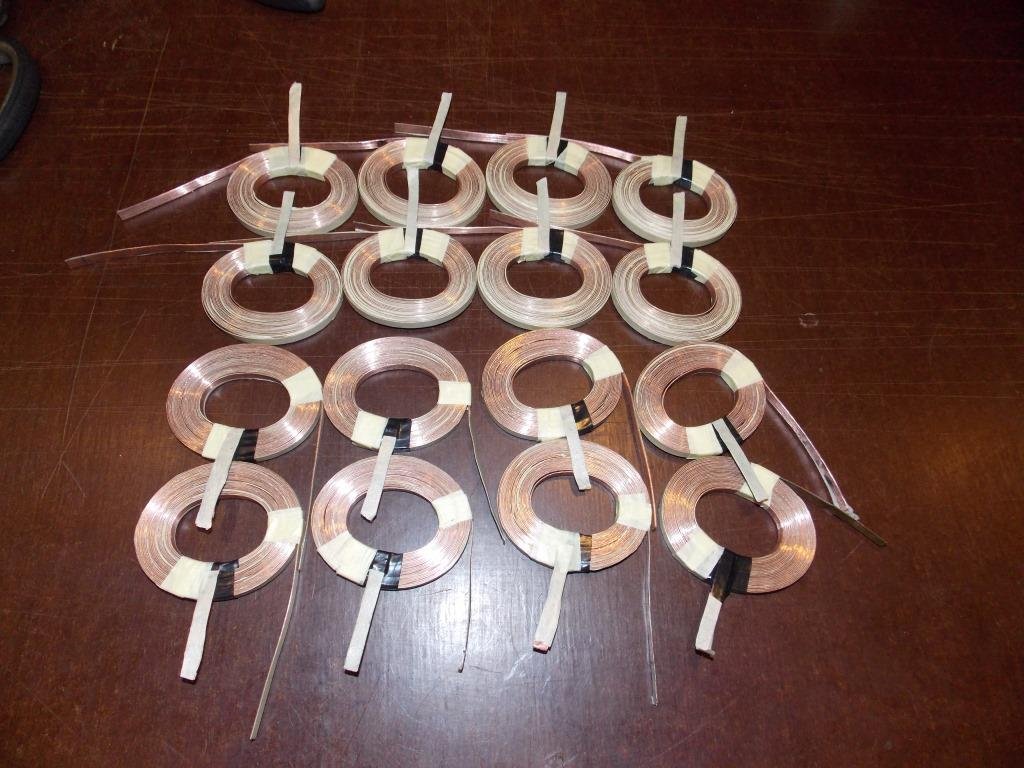

Waiting for some parts this week so I rebuided a few coils.

Steve, fine to see you back on the coilring.
You can use a 3/8 wide tape to block the end of each coil.
Don't forget to insulate the side of the coils at the place you plie over the strip to make the connection part of each coil.
Good luck

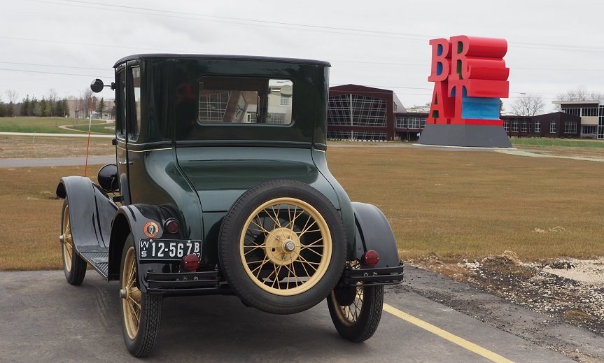

Post by Ken Lefeber » Sun Dec 06, 2020 6:26 pm
Celebrated Wilma's 94th birthday with a short ride to the recently opened Johnsonville Marketplace.

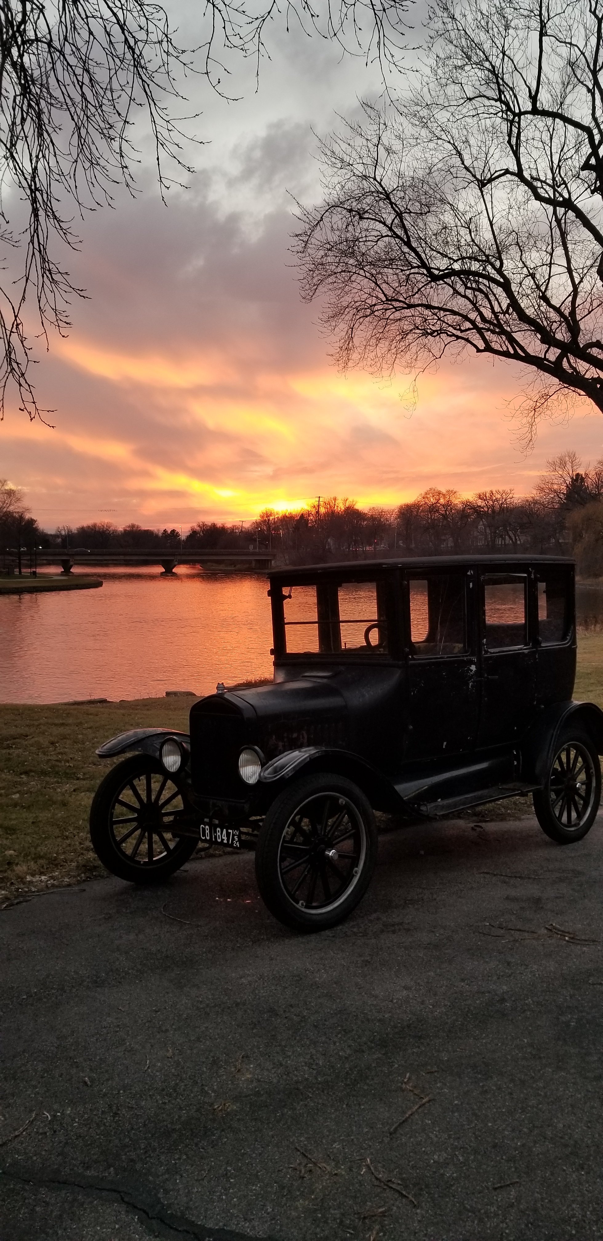

Spent an evening chasing a sunset.

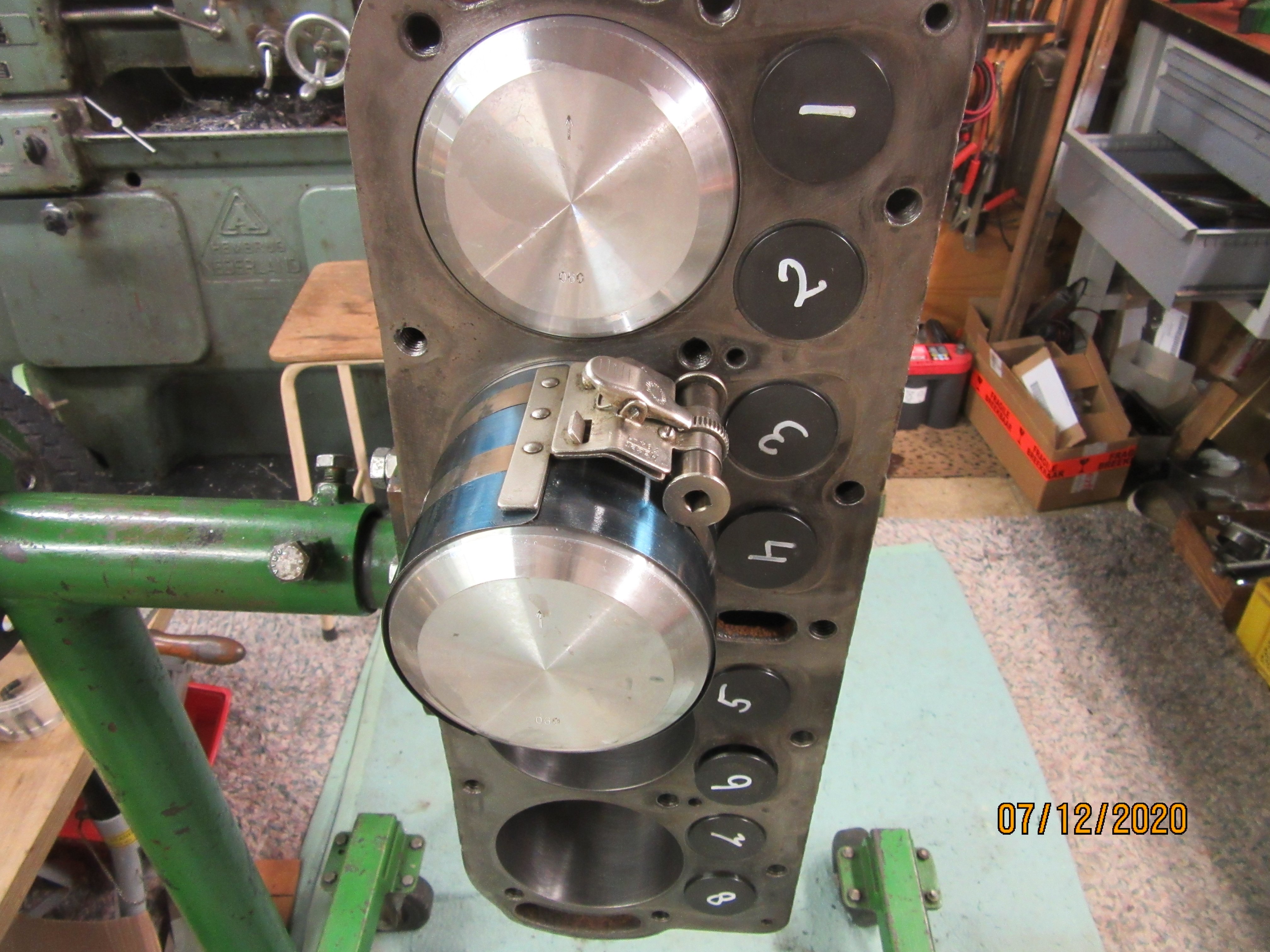

This morning I put new pistons in a friends engine , and mount the coilring and flywheel.

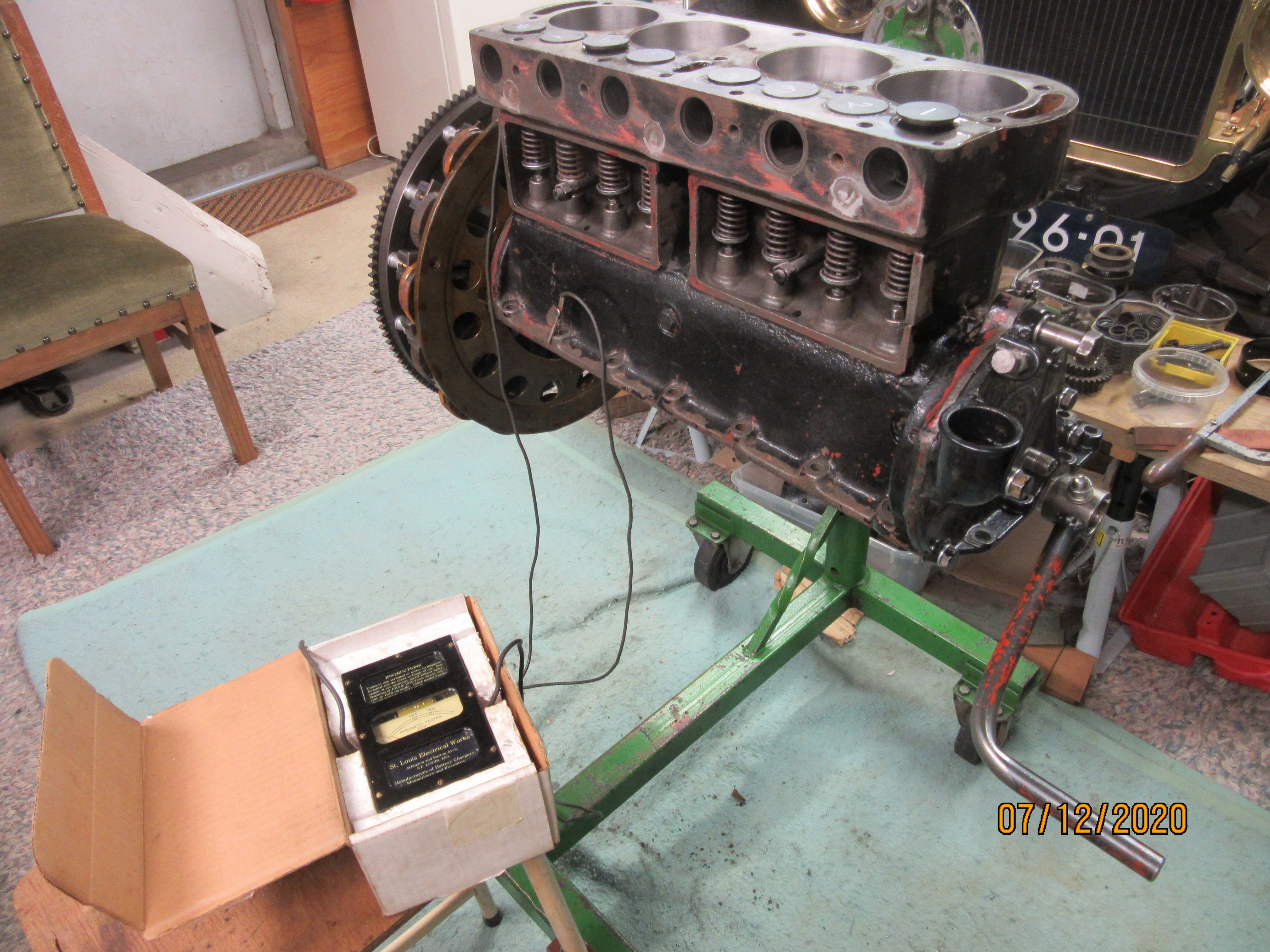

Post by ABoer » Mon Dec 07, 2020 8:29 am
And the Magneto is working OK

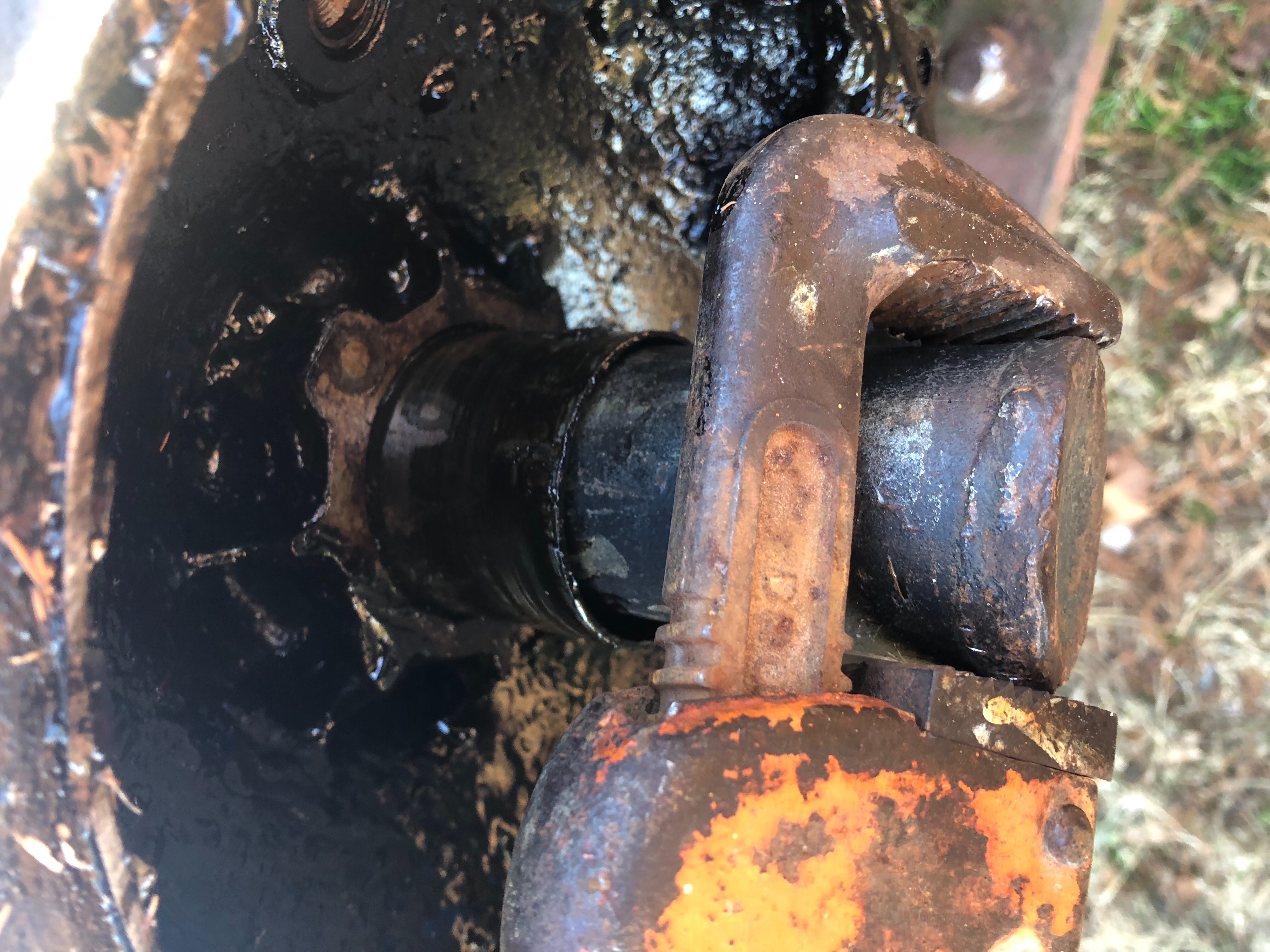

I did the last bit of disassembly on my rear axle. I was putting it off because I didn’t have a sleeve puller but I made one.

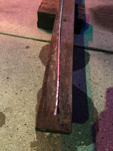

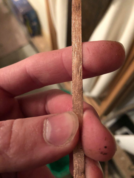

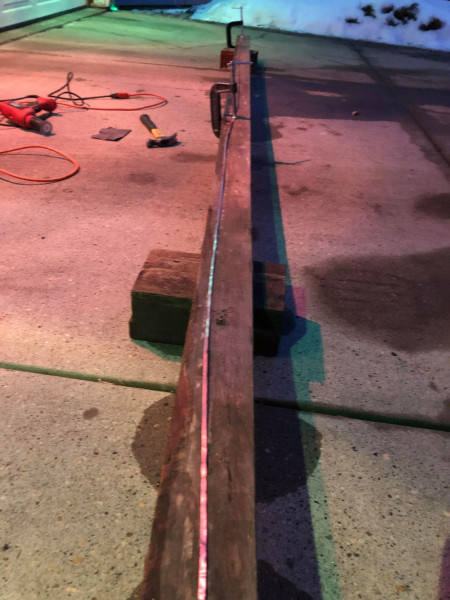

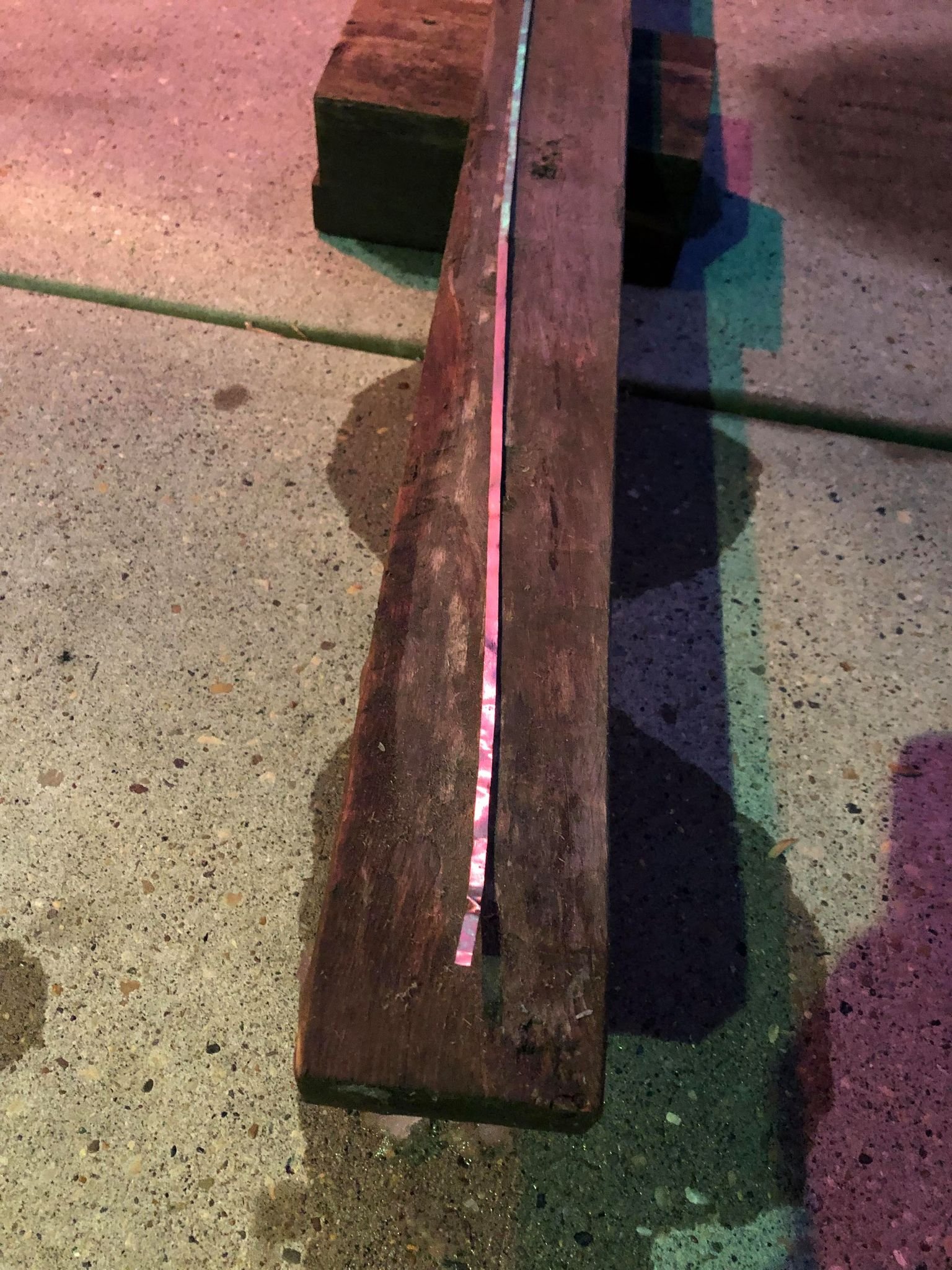

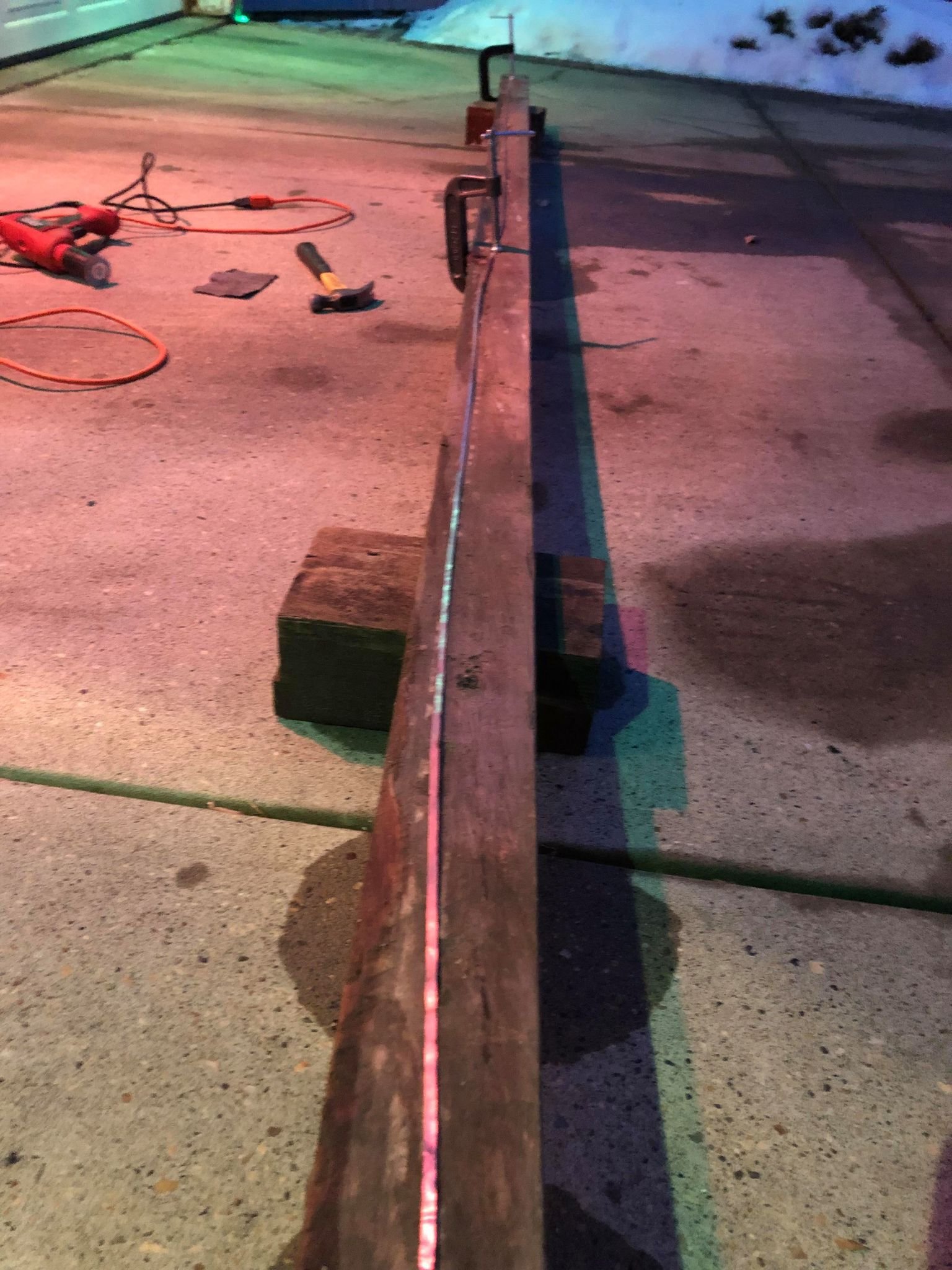

I finally began cleaning up my field coil rings. The apparatus is a little crude, but it works just fine.
15 more to go.

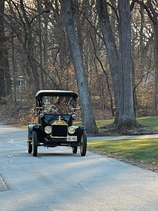

Post by WayneJ » Thu Dec 10, 2020 1:10 pm

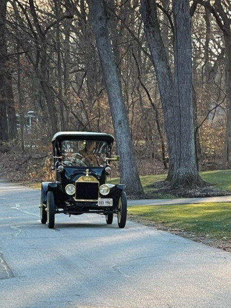

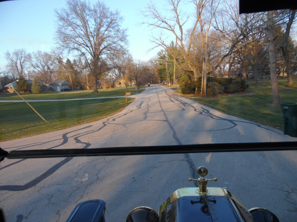

It was 50 degrees and sunny yesterday in Batavia, IL, so ....
I was able to give the T a little exercise. Started on the 2nd pull.

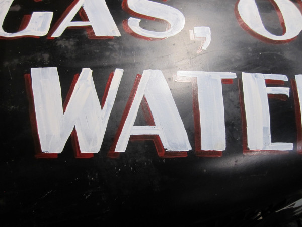

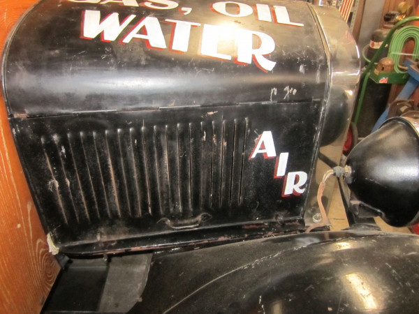

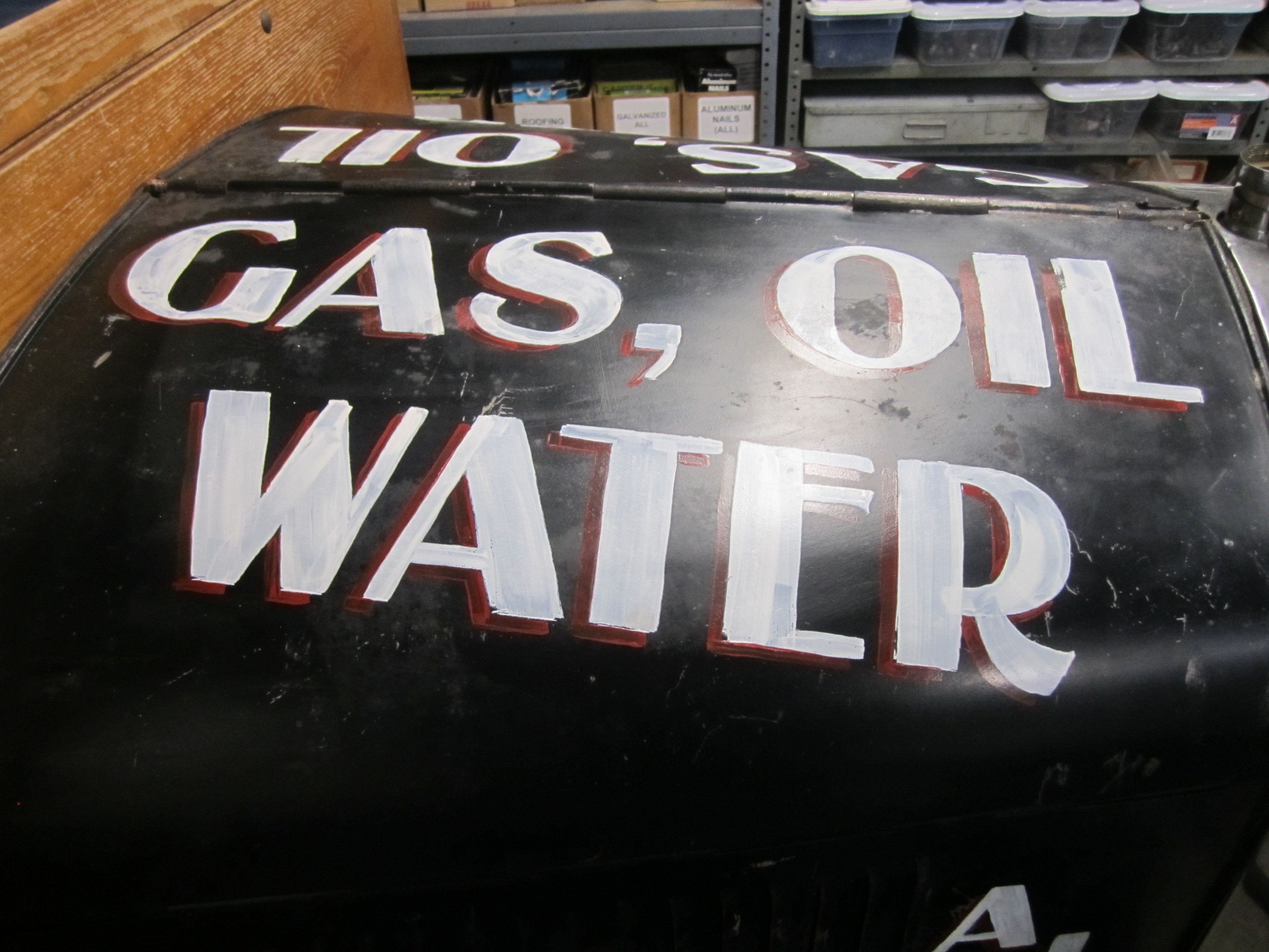

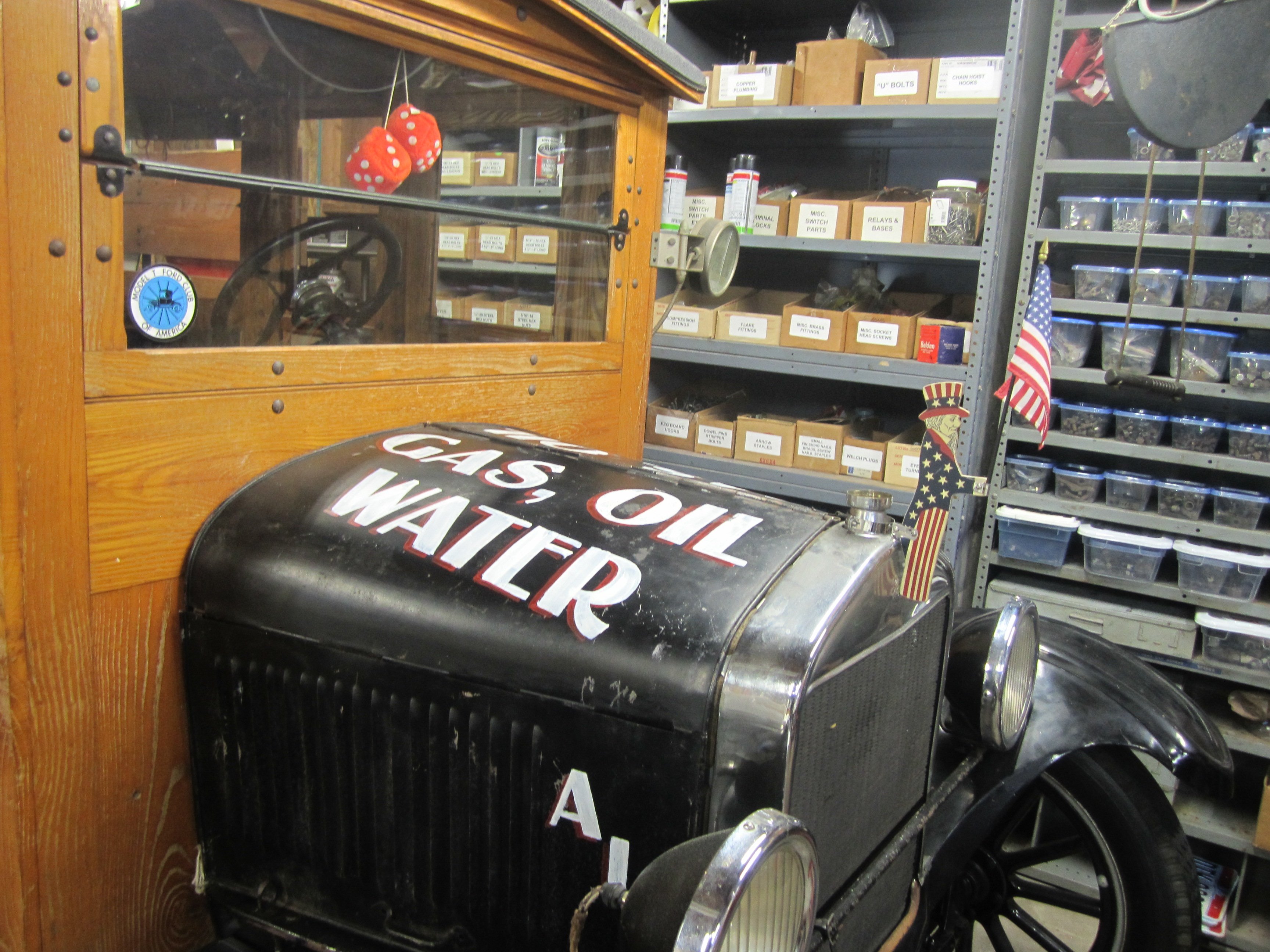

Started freehand lettering (with patina) the truck. Enjoy

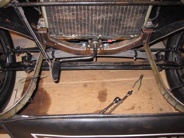

Post by John Codman » Thu Dec 10, 2020 5:13 pm
Started on the job of adjusting the clutch screws. The floormat is out, as are the front floorboards. The transmission top cover is off and the left rear wheel is jacked up. I'm hoping that in the next couple of days I will pull the spark plugs, then I'll have a go at actually doing he adjustment. Tomorrow is a birthday party for an old friend who is moving a couple of hundred miles away, so probably no progress until Saturday.

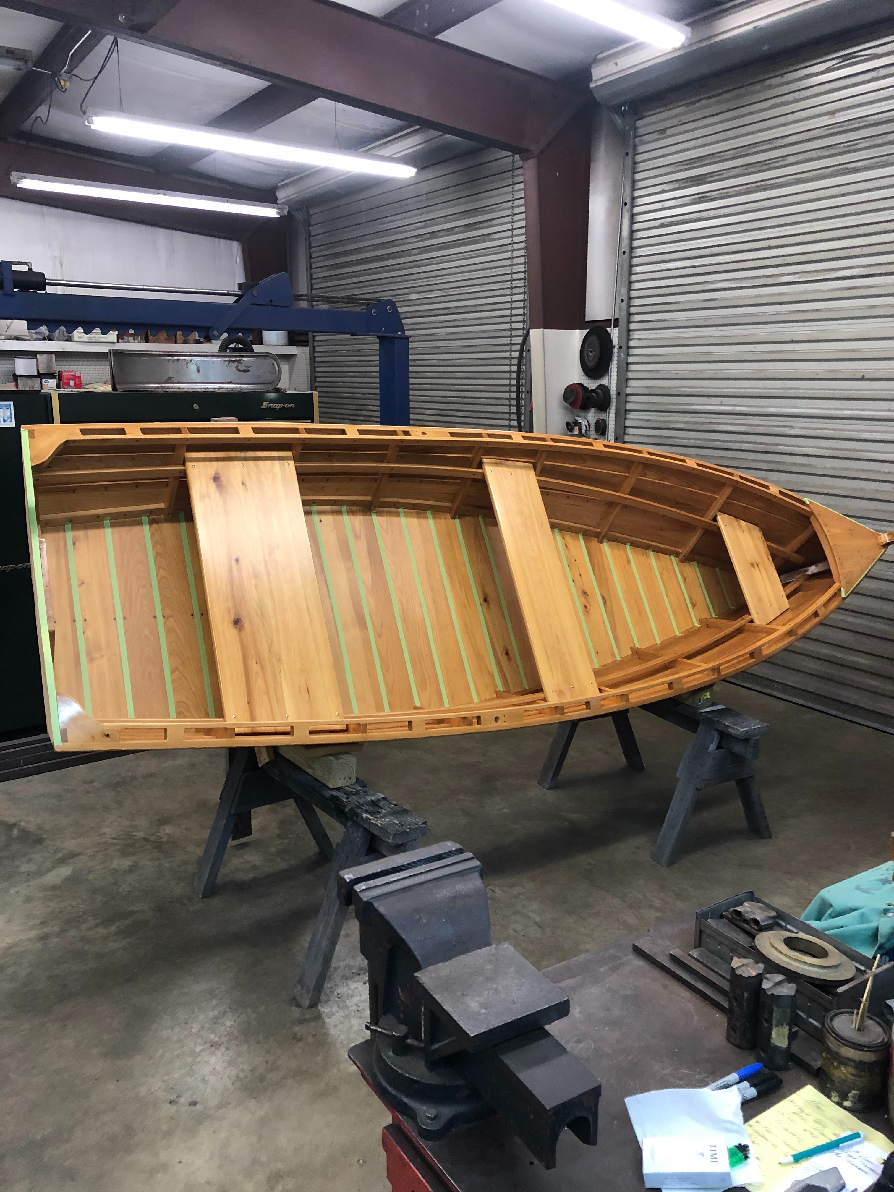

Post by Henry K. Lee » Thu Dec 10, 2020 5:22 pm

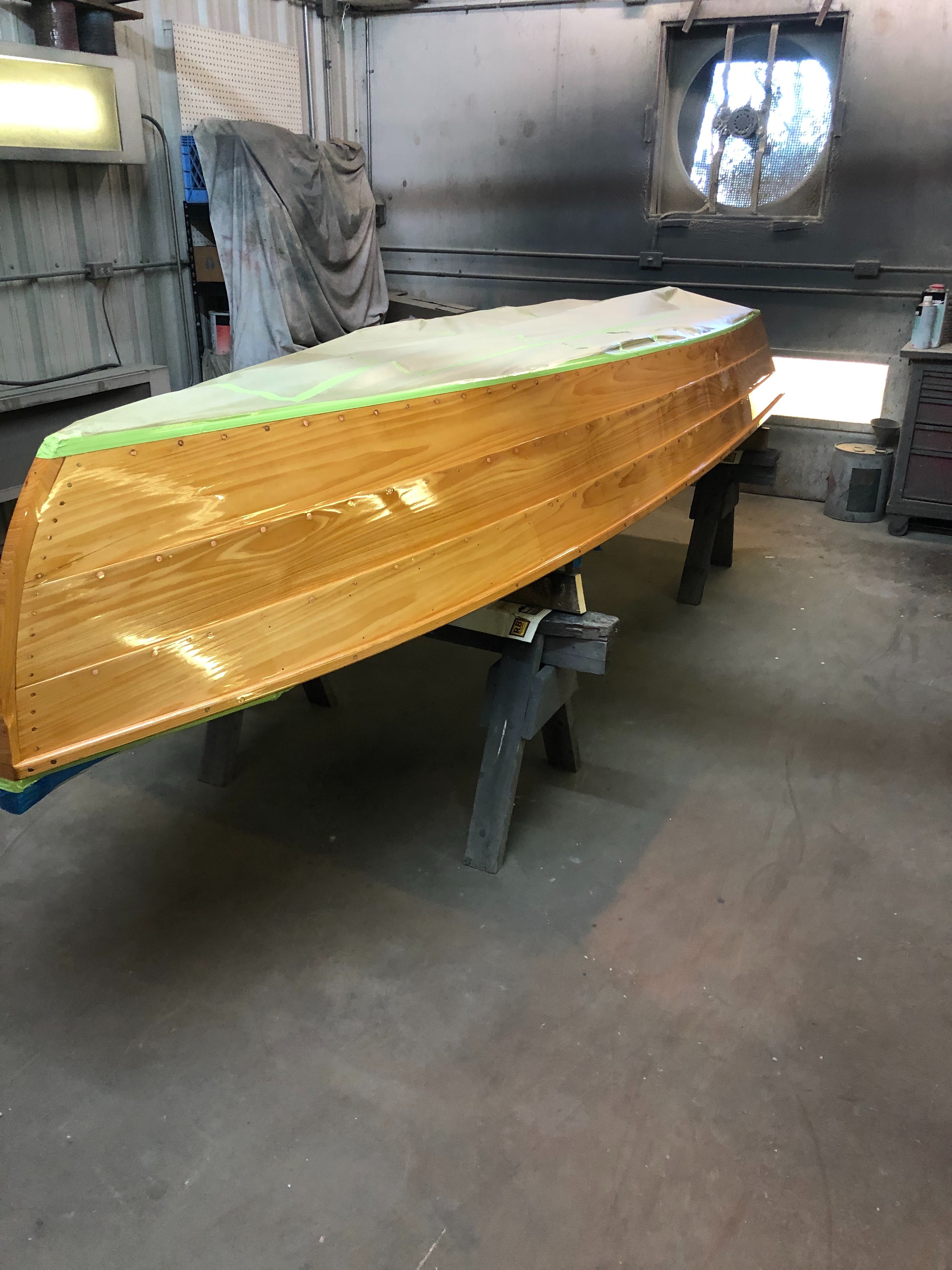

Got to get the boat done! Oh.., it will be towed behind a 1927 RPU on a period correct trailer and 1926 Johnson outboard. It only weighs about 90 lbs, White Cypress.
Priorities Man!

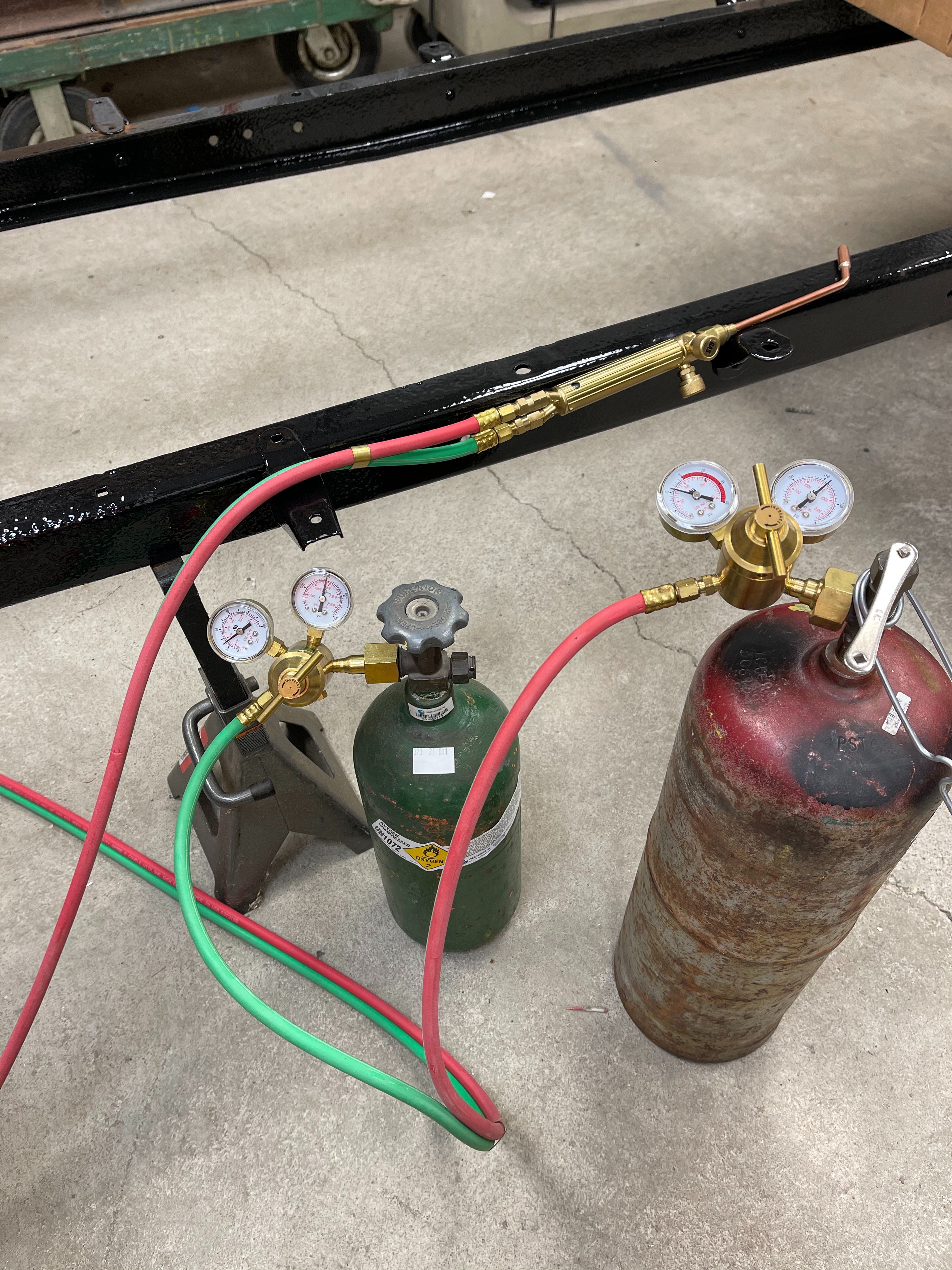

Got my small tanks filled so I can rivet Saturday

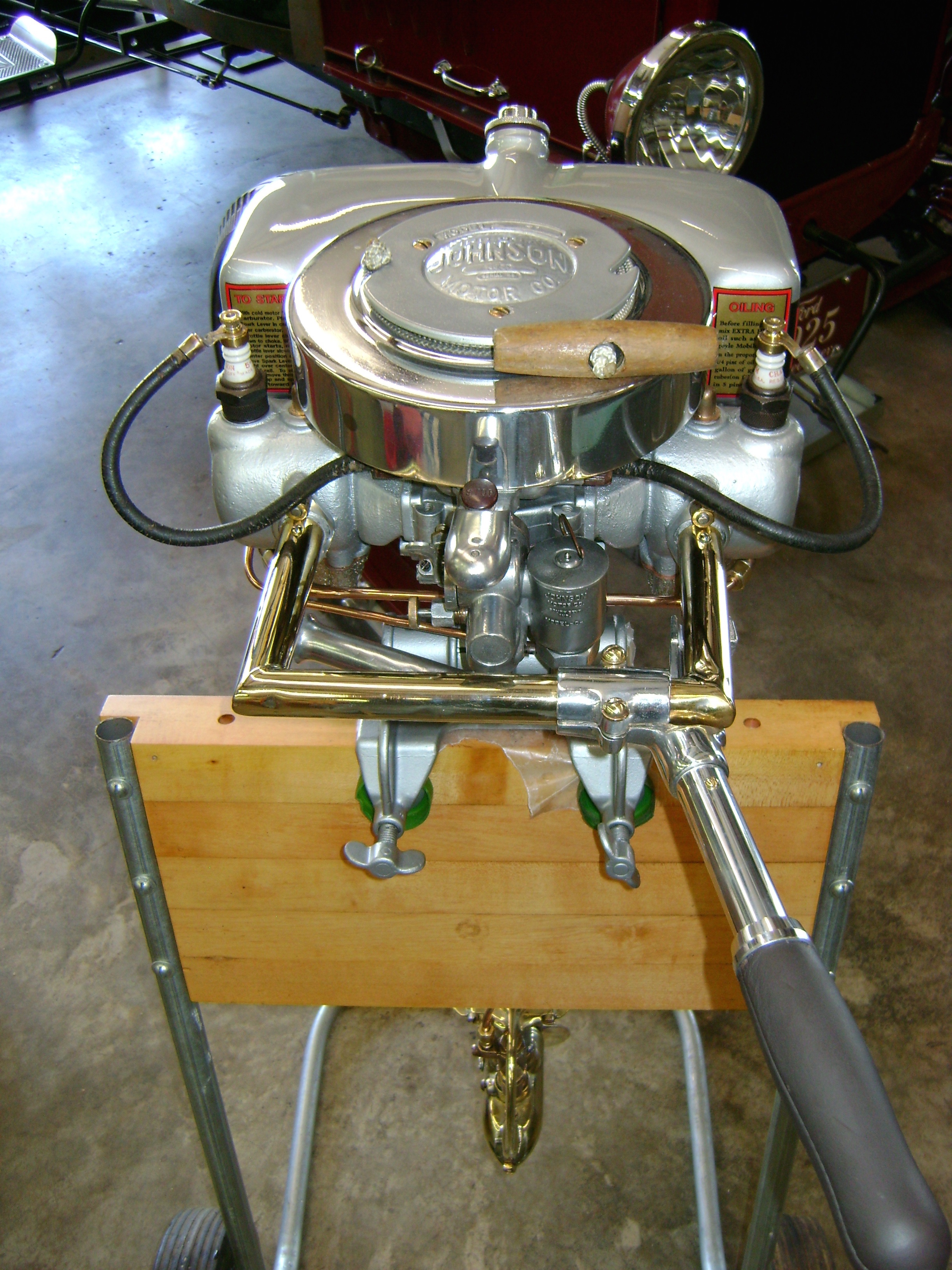

That is cool Hank, post some pictures of that Johnson. I acquired a 25 last year, these are pretty rare indeed.

Post by Henry K. Lee » Sat Dec 12, 2020 7:51 pm
Here you go Scott!

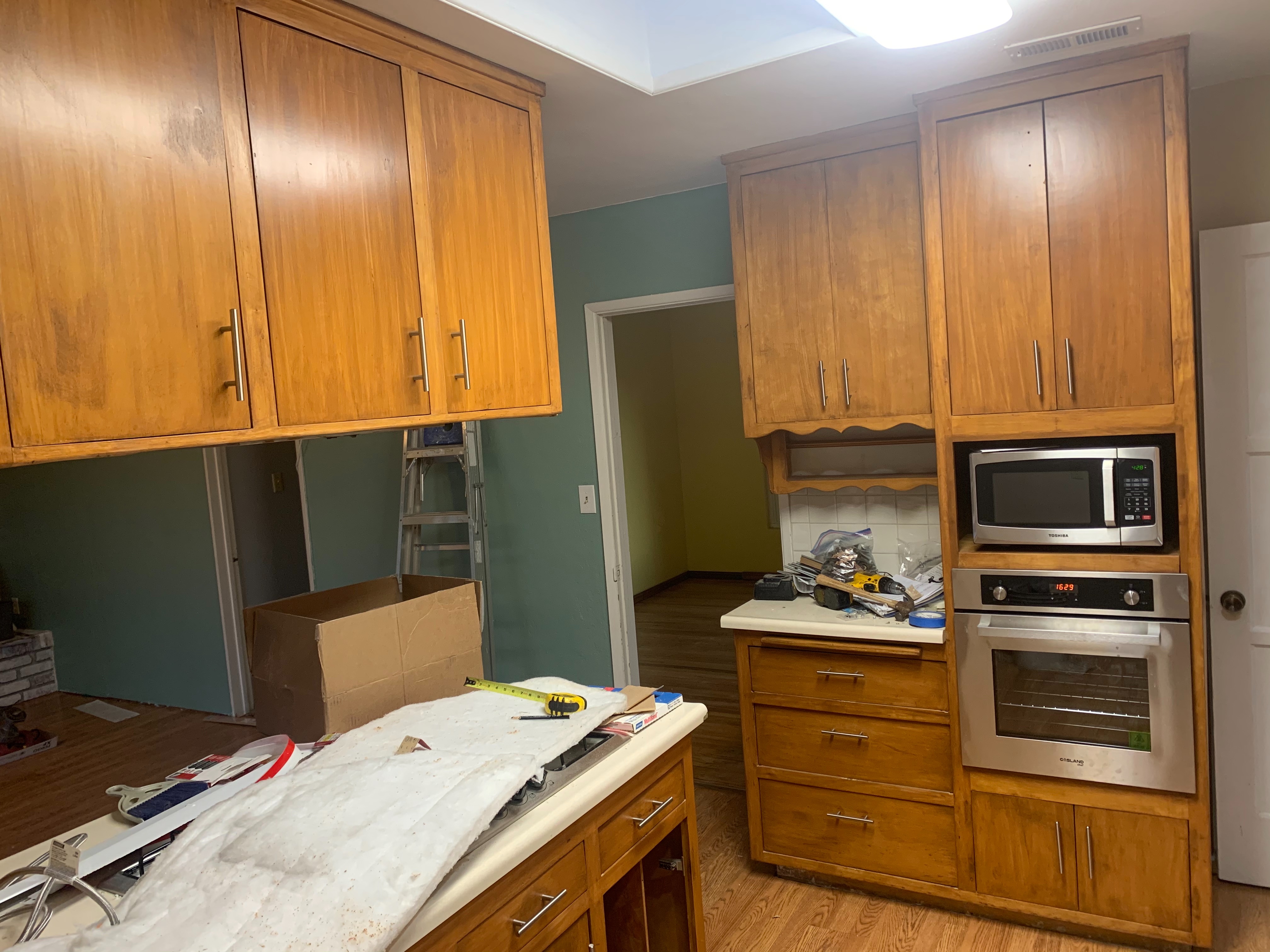

Post by TonyB » Sat Dec 12, 2020 9:59 pm

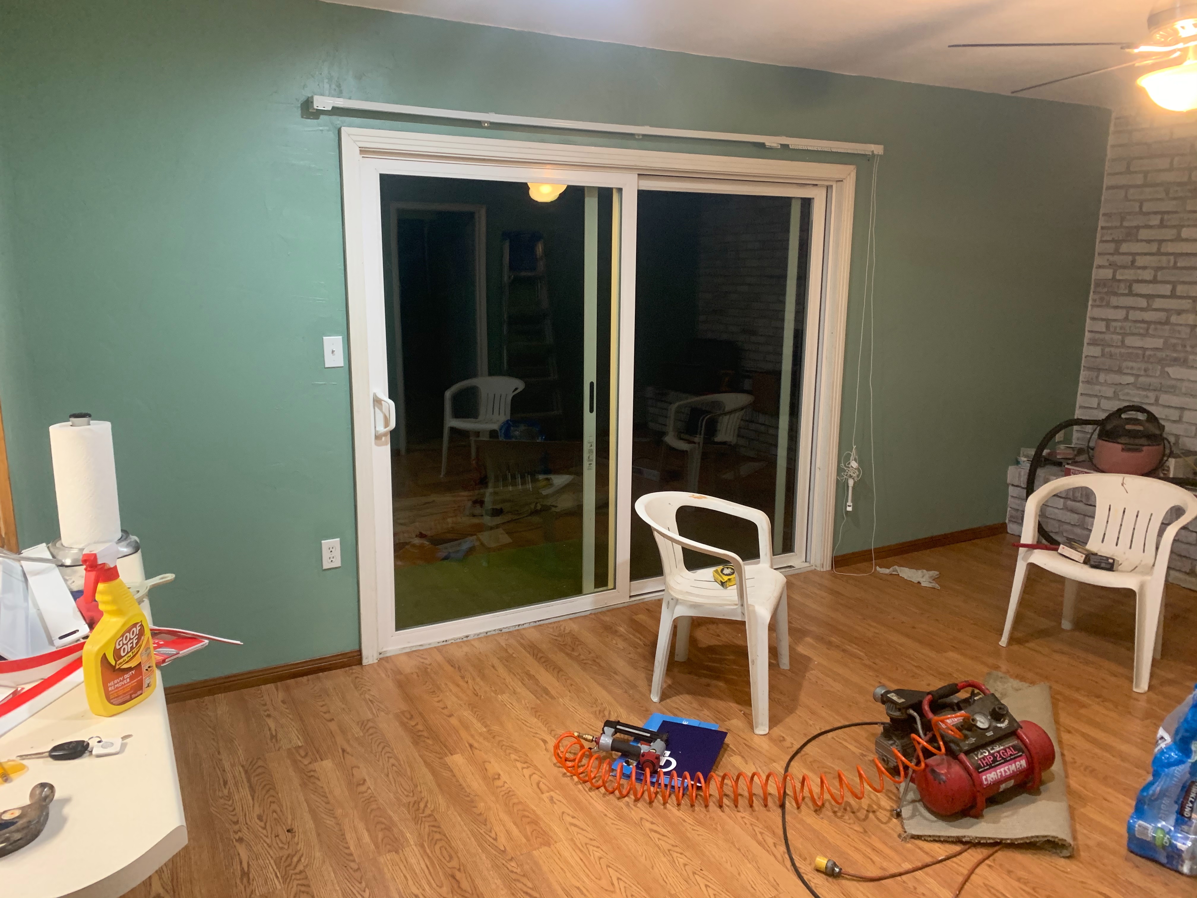

Absolutely nothing☹️
I’ve been working on my new (to me) house. Sanded the floors, some new drywall and refurbished the kitchen cabinets.
New kitchen
New kitchen
New patio door and new floor
I hope to move all the stuff in the workshop after the house move and resume T work in February.

Post by NU2theT » Sun Dec 13, 2020 9:52 am
Hank that is outboard eye candy, I will stop procrastinating on mine and give it some shine. I also have the brass lower prop and tank needs the fresh paint and decals.
Thanks for posting the pictures and love those old adds.

Henry, I love those old wooden boats! Also modern replicas of them.

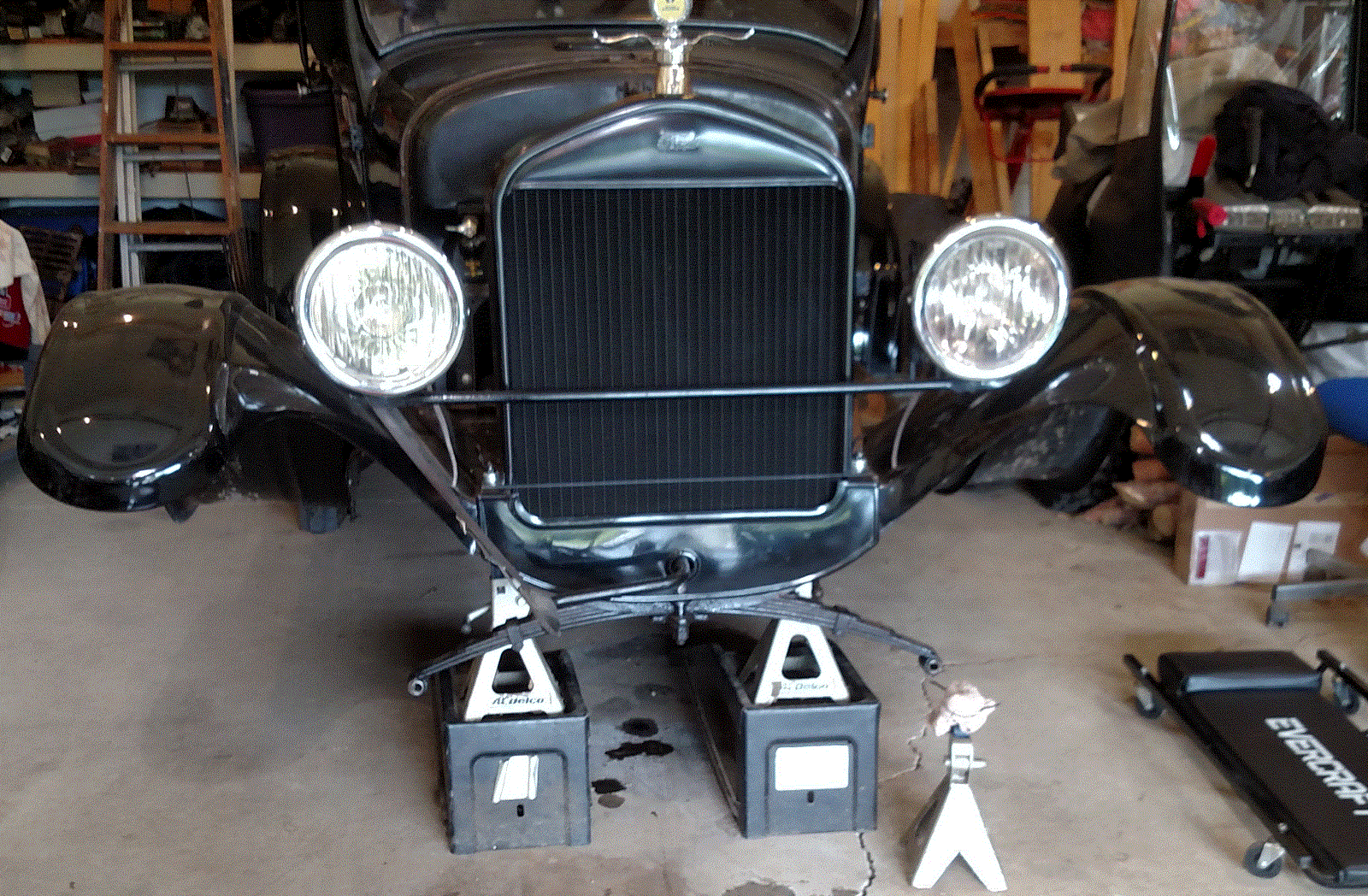

Post by Art Ebeling » Mon Dec 14, 2020 7:19 am
I am making the best of a fourteen day Covid quarantine and installed the fenders and hood. I still have to paint the correct fender bolts and screw the hood former to the firewall. I have thirteen days left so I am stretching it out. Art

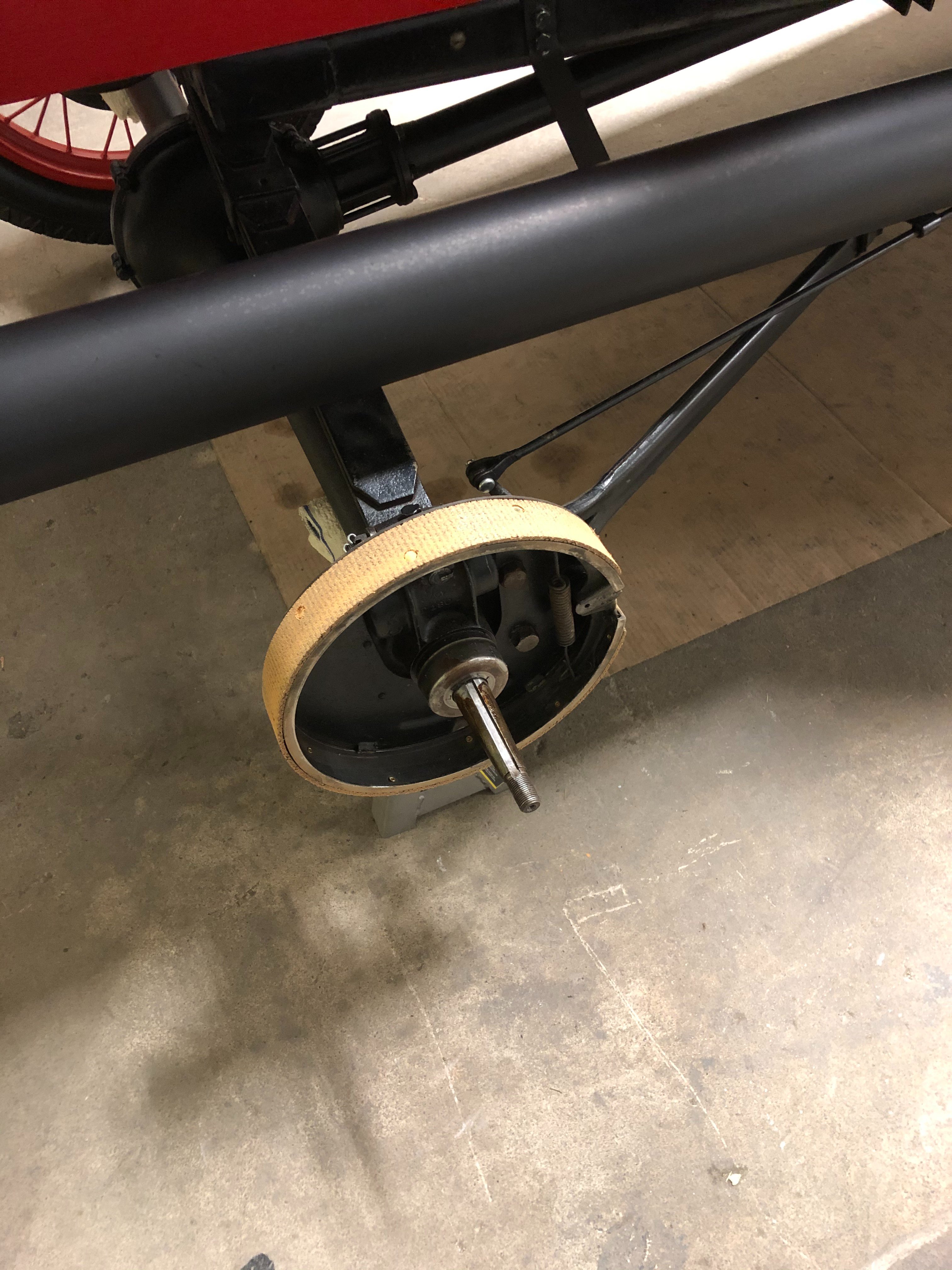

Post by rnkugel » Mon Dec 14, 2020 10:12 am
Got new E-brake linings on the speedster. Pulled the carb of the 15 Touring to discover that the float was set about an 1/8" to high. reset to 1/4". Also discovered there was no gasket between float bowl and carb body. Glad I had one. Carb reinstalled back on car. Now in the middle of rewiring the entire 15 Touring. Long winters hear in Wisconsin are a great time for some tinkering.

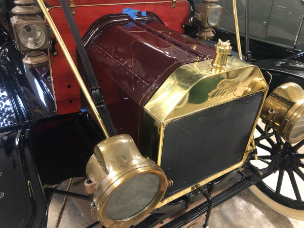

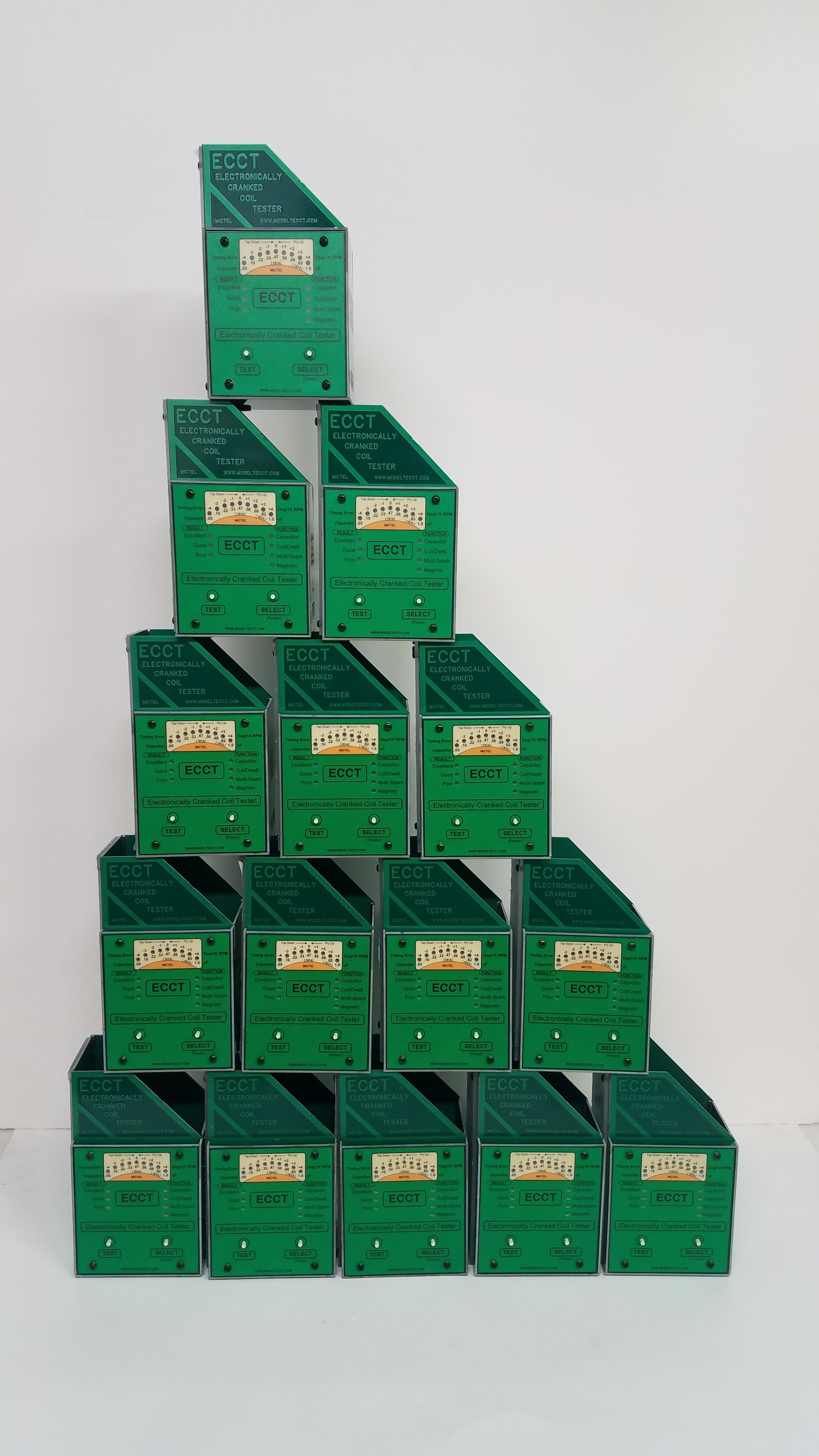

Busy working in Santa's Model T work shop; he knows who's been naughty (?) and Nice. Better be good for goodness sake!

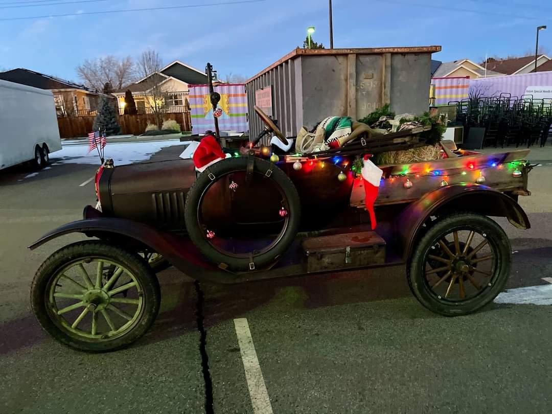

Post by Angmar » Sun Dec 20, 2020 7:50 pm
Attended a Christmas "Covid" parade for the town. People could watch safely as the cars drove past their homes. Lots of fun but dang cold.
Still crankin old iron

Redid 5 coils, 4 with new points 5th is waiting. When I sold the 1921 huckster all my working coils went with it. Just finished up regapping the vibrators on the 4, need to check now on the HCCT. Can't drive the 25 without them! Got a Craftsman tilting head band saw yesterday. Need to get carbon paper to start make patterns so I can rewood it. Don't want to cut the plans up.

Post by Mark Nunn » Mon Dec 21, 2020 8:44 am
I removed and disassembled my front axle and spindles. I boxed them up to send out for repair and bushings. I'm waiting until after the shipping companies get caught up before send them out. I have one inner bearing race that can spin in the hub. I'll need to address that when parts arrive.

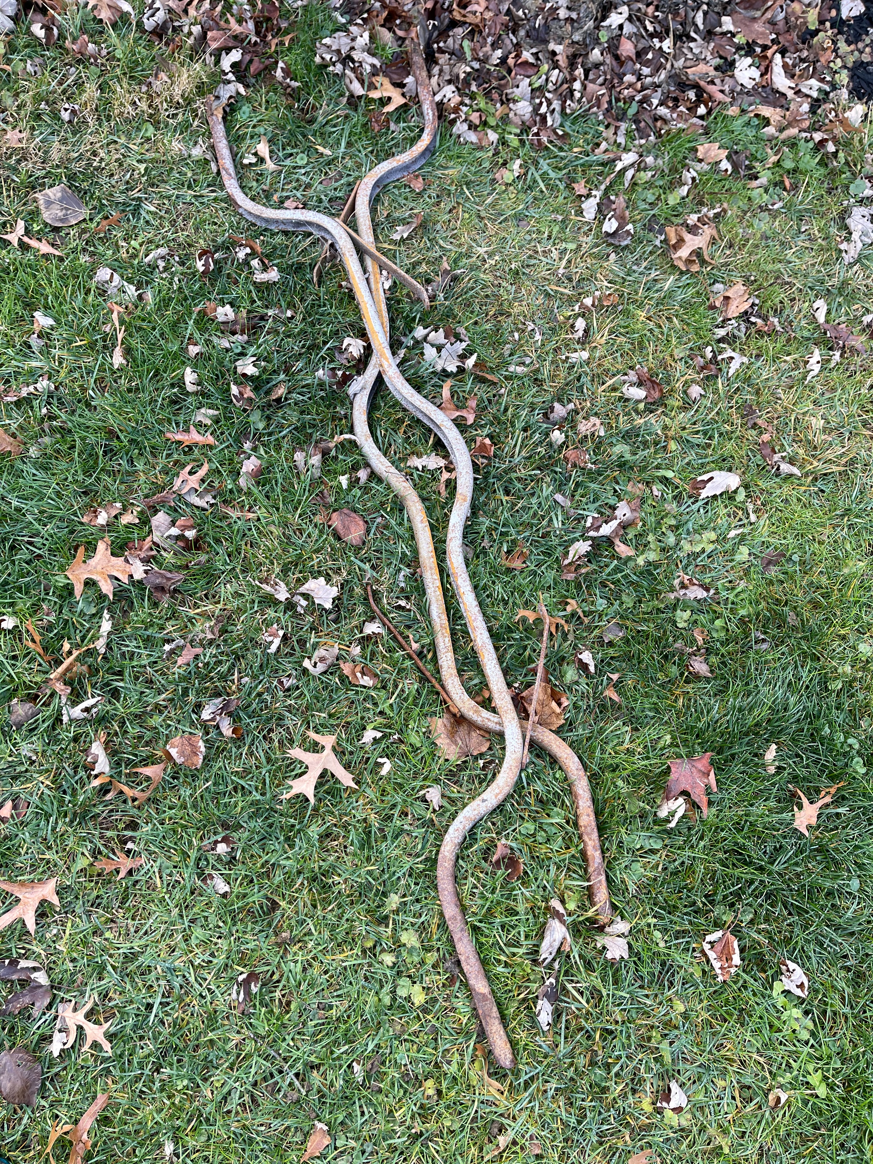

Post by dmdeaton » Mon Dec 21, 2020 8:49 am
I spent all day yesterday trying to find these two items
I found them after giving up twice

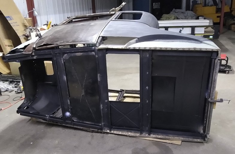

Post by varmint » Fri Dec 25, 2020 10:24 am
2020 has been interesting, haven't had much time for the Model T. On the pickup had an engine wear out at 250k miles so rebuilt an engine and its transmission had a failed torque converter. So, got one from the junkyard, rebuilt it and installed at the same time as the engine. Wife's car had a flat tire and was returning from the tire store when the transmission on it gave out completely, coasting home. Back to the junkyard for a transmission. Lost two relatives this year, one to COVID. But we still have each other and our jobs. Overall, I enjoyed this challenging year and we finally got the floor welded to the body.
1926 Coupe floor weld

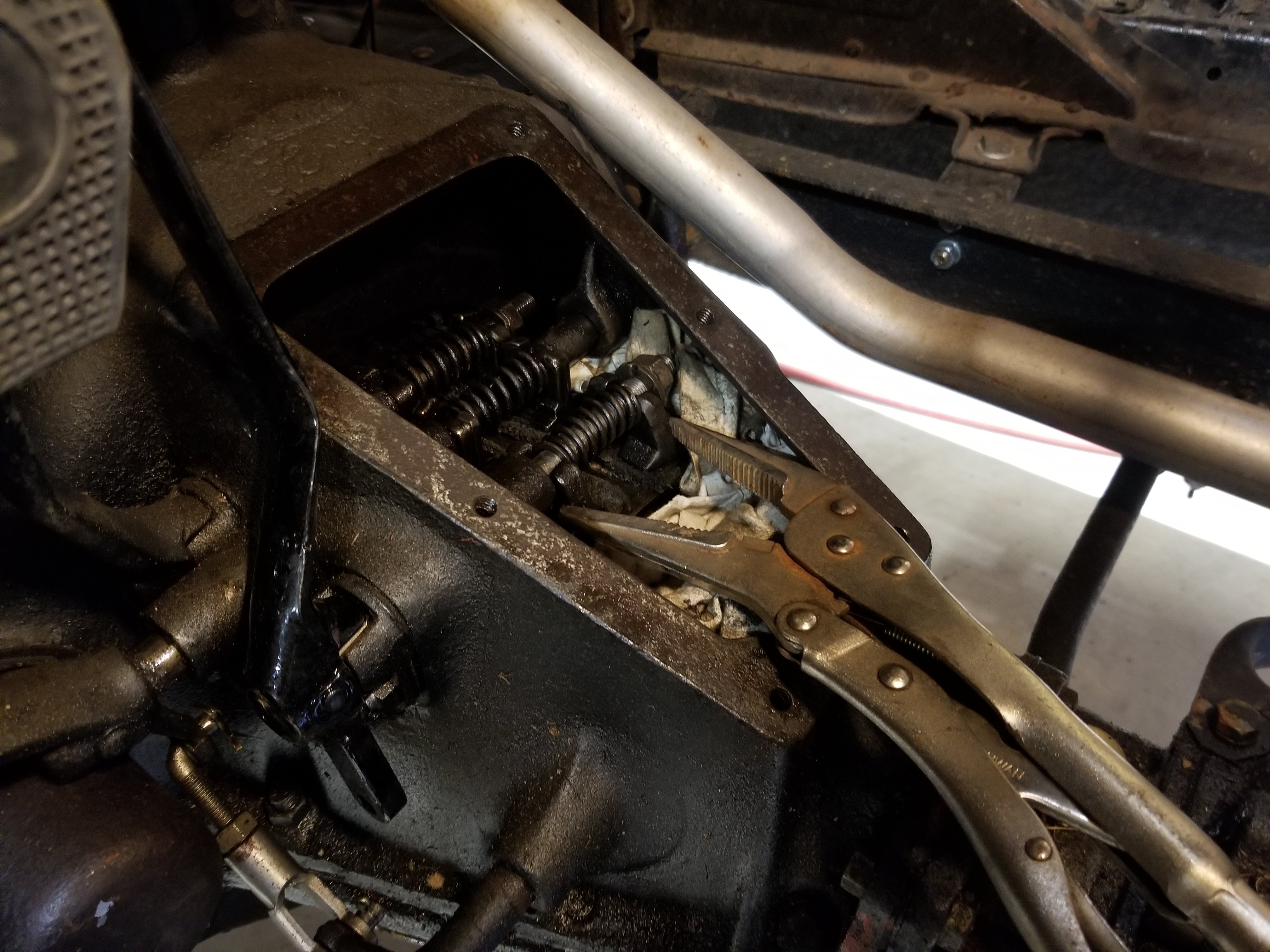

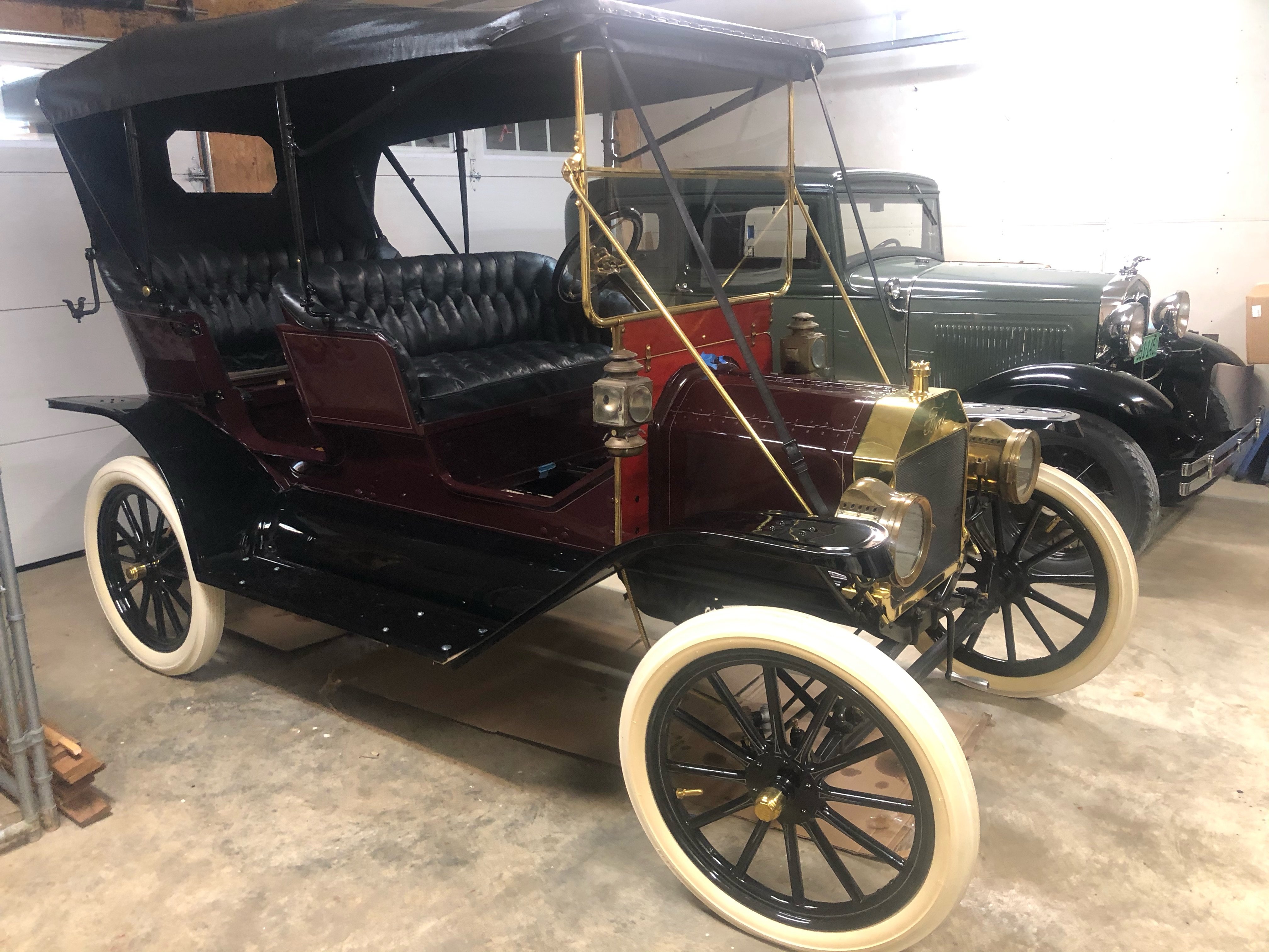

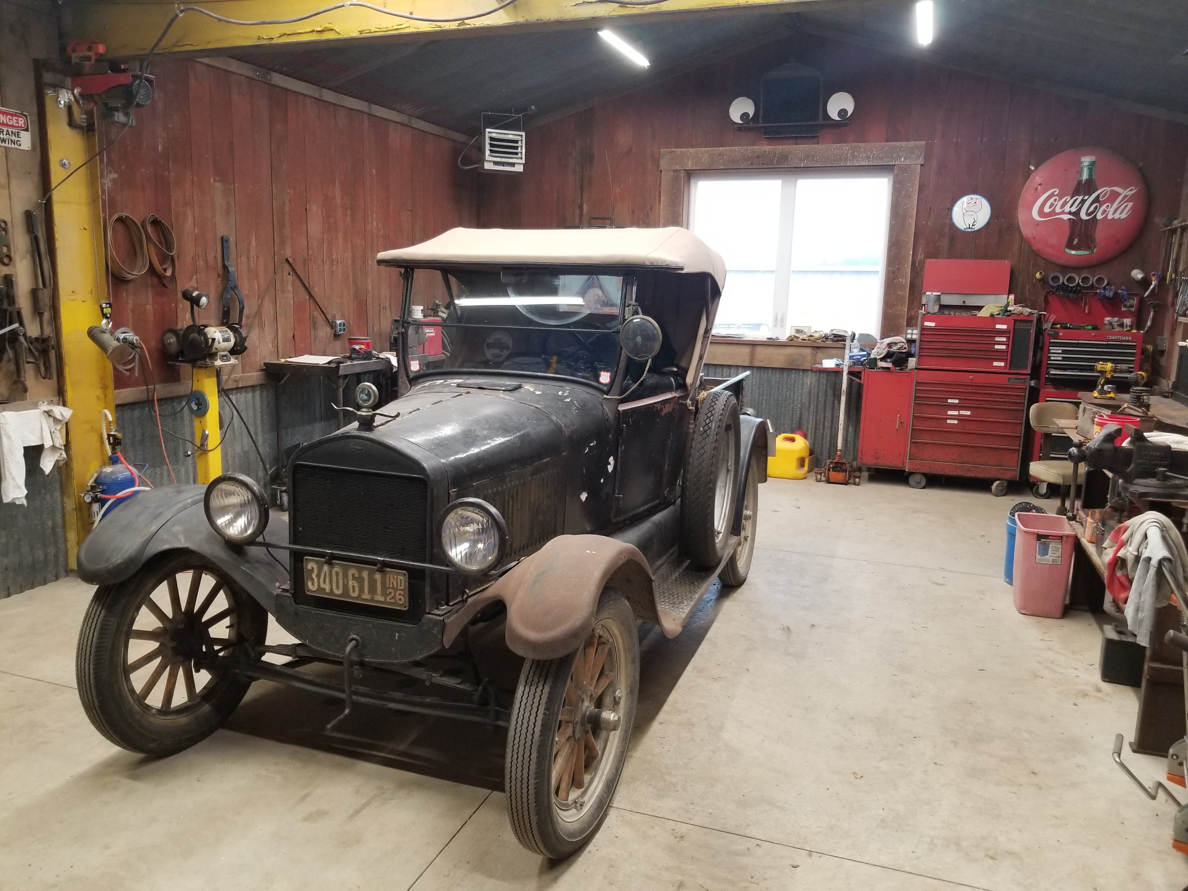

Post by Dallas Landers » Tue Dec 29, 2020 3:51 pm
Finished up the 27 for a friend.
Moved the RPU into the new shop and started the RM brake install.
Discovered I dont need to fight wire or zip ties to change the brake peddle. The visegrips worked great.
