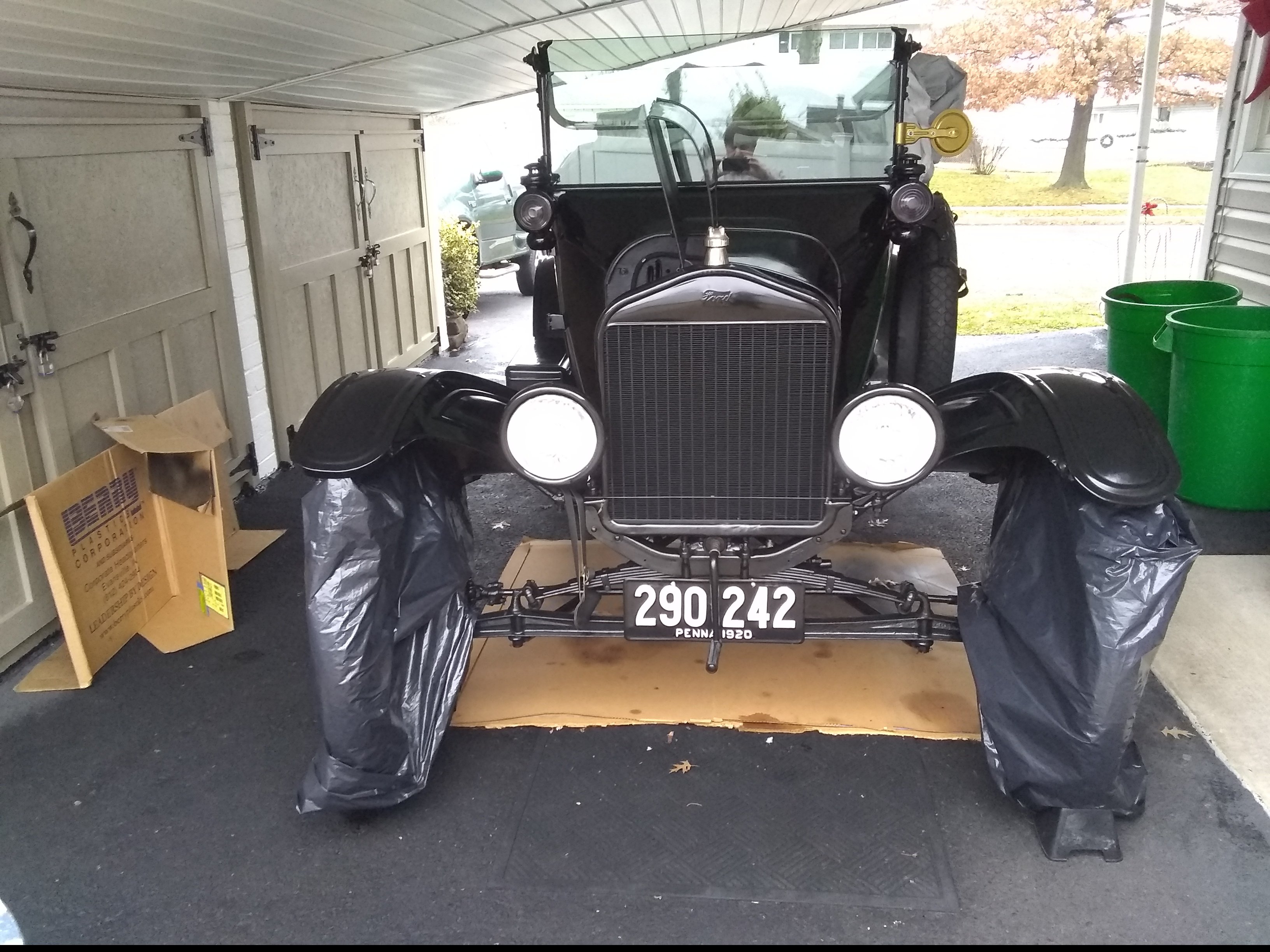

I use a carport for my 1920 Runabout. It's a Levittown carport, but two sides have a "side." One is the side of the house; the other doors to two sheds. While not the most ideal arrangement, it works pretty well. I do have a high quality car cover, and always make sure there is no moisture buildup on those rainy or humid days. Yes, a garage or enlarged shed would be ideal, but after five years, no harm.

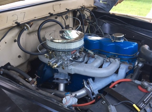

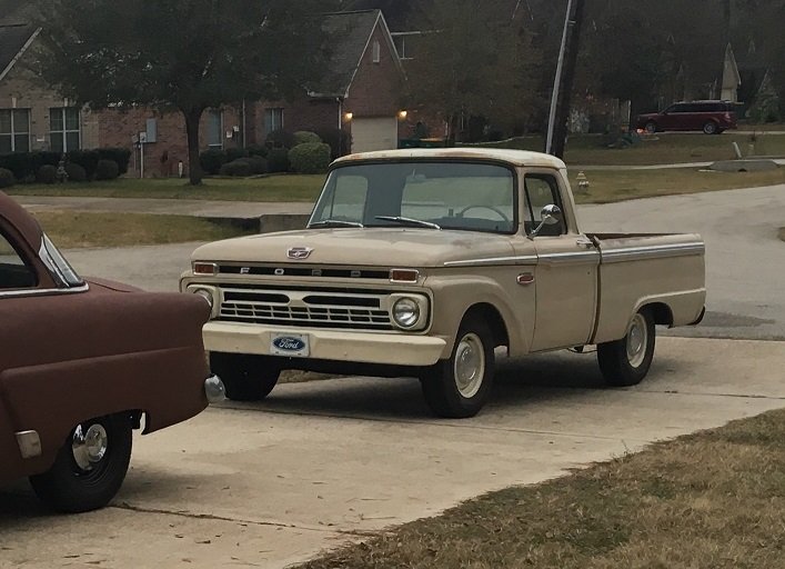

I've had no choice lately but to put my 66 F100 under a carport type structure, except it's closed on the sides and open on the ends.
It's not ideal and does allow moisture to gather, especially in the Houston humidity. I take it out once a week, run it up to operating temperature, clean it off and put it back.
Several of yall have asked about it. I've reduced my price to $11k. I don't want it sitting in the carport anymore. It's an original paint, solid Texas truck.

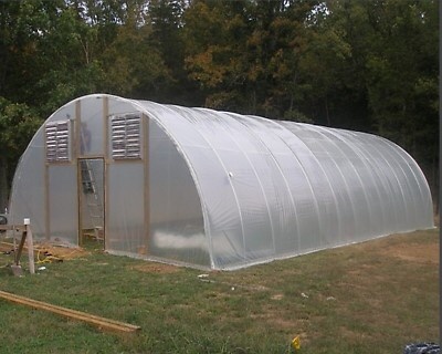

When he was alive, my Dad was into flowers, plants and landscaping and had a lot of potted plants. Florida has very mild winters, but occasionally we have some very cold days and nights any one of which can kill plants, or a entire orange grove so every year, Dad and I would build a PVC pipe Quonset hut greenhouse to protect his plants from the cold. We could build it in a matter of hours the size of which was governed by the length of the flexible PVC pipes. It was covered with clear 6 mil Visqueen which comes in 20’ x 100’ rolls secured to the PVC pipe with clear 2” packing tape and was surprisingly warm enough to keep his plants from freezing and protected them from the frost.
This type of shelter can also serve as a temporary shelter for your T in your yard or in your driveway, if you don’t have a garage and is light enough that several friends can lift it over your T. It will also serve as a clean room for spray painting your T, if you rig up filtered vents at one end and a fan at the other end to suck out the overspray. Visqueen also comes in black to put on top to keep out the harmful UV rays. Jim Patrick
