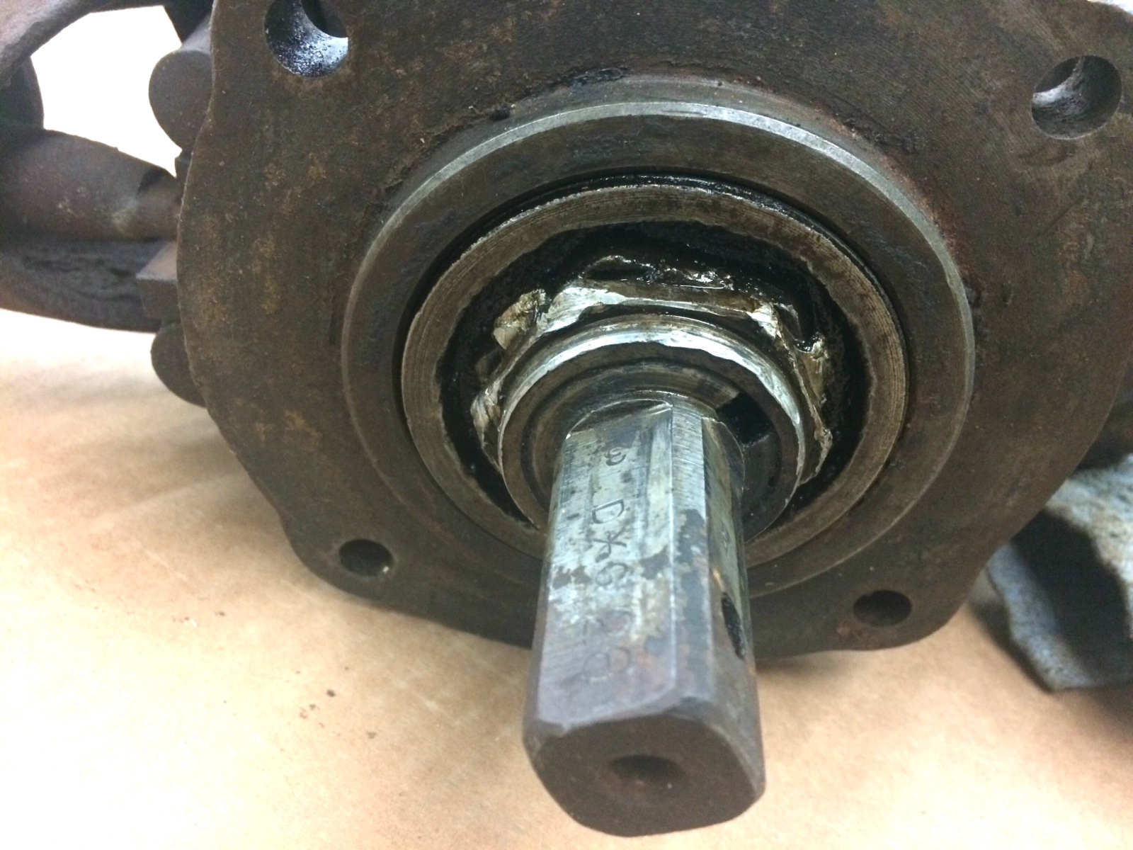

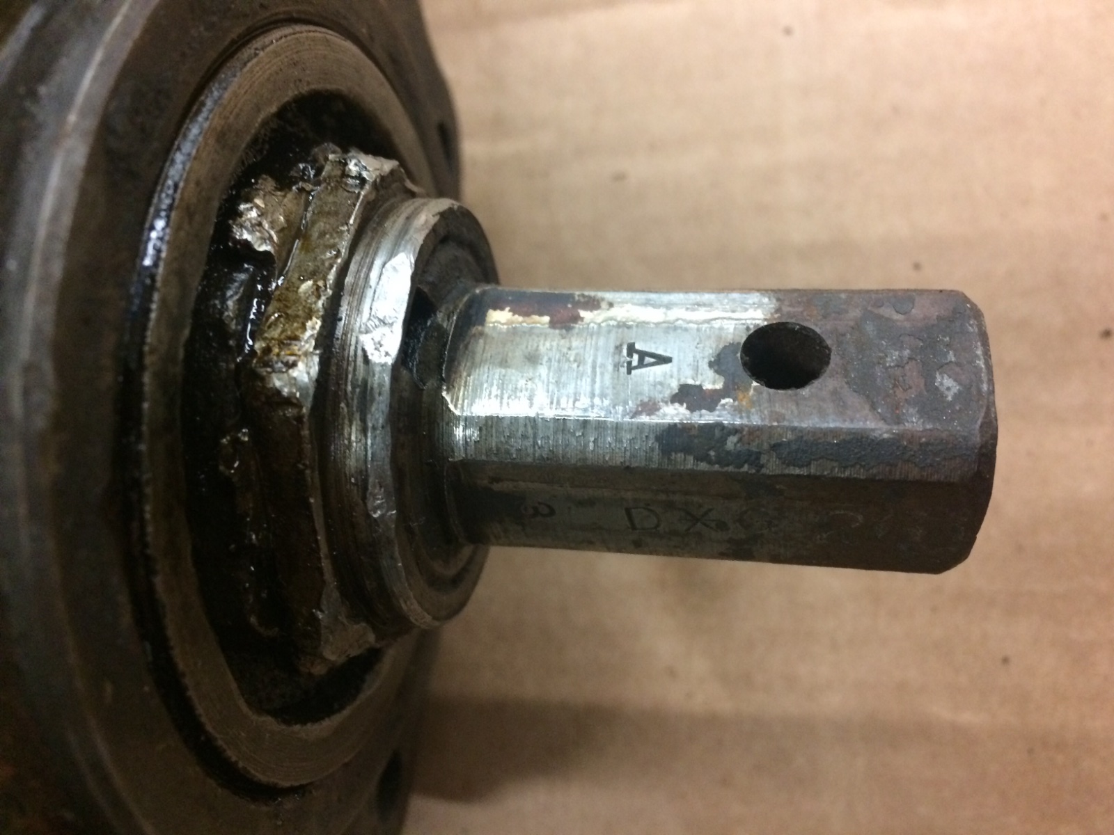

I am looking into rebuilding a Warford transmission. Actually, more of cleaning and inspecting it. Could someone direct me to a manual or online reference?
I ran into problems when I tried to uninstall the nut on the shaft. I can’t seem to get it loose.

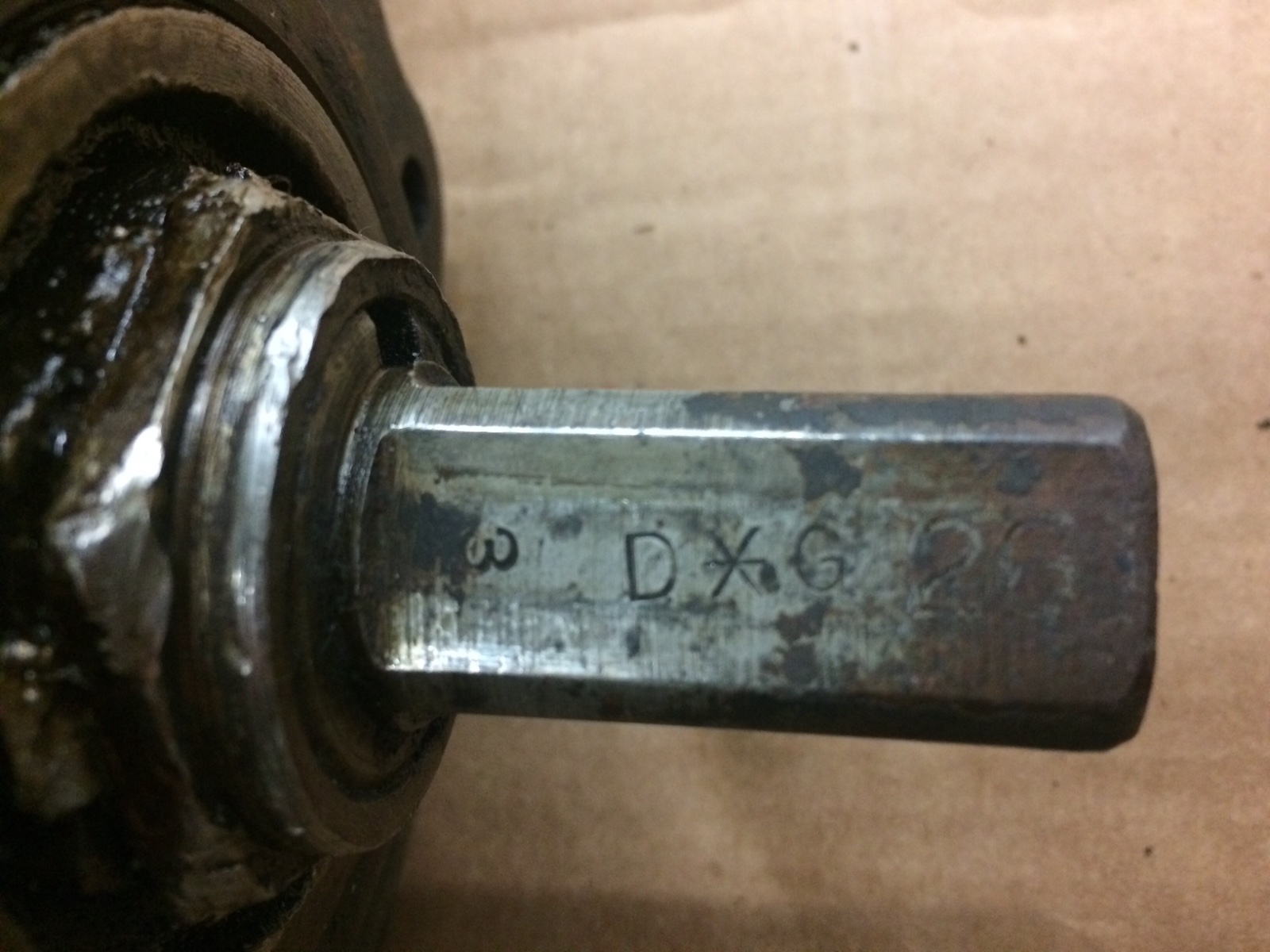

Post by Matt in California » Fri Mar 01, 2019 1:08 am
Thanks Gene!

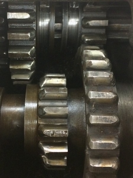

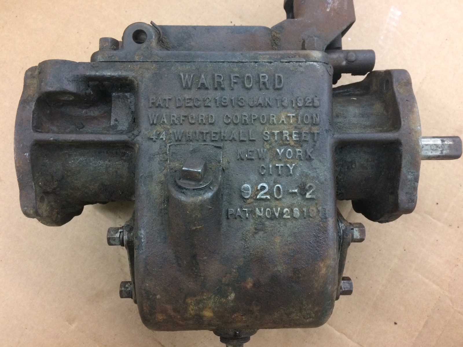

Here are some photos:

Which nut are you talking about? The one in back, you have to remove the lock pin before you can turn it out. I used a brass drift to tap it around, turns counter clockwise to remove. The one in front bend up the tabs. We made up some of the tabbed lock washers, contact me via PM and I will get the info to you if you need one.

I am referring to the hex nut. I believe it is 1 7/8". Can I assume that it has standard thread direction (CCW to loosen)? Yes, I would like a replacement tab lock washer.

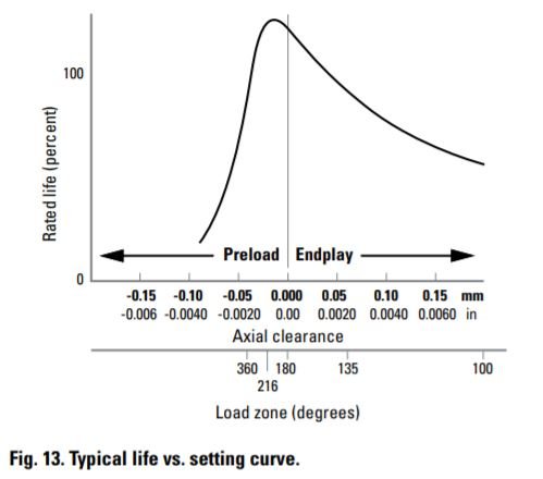

I agree that understanding of standard practices of loading taper bearings would go a long way in overhauling a Warford. I found this manual:
https://www.timken.com/wp-content/uploa ... atalog.pdf
I found this chart on page 31 interesting:
Temken preload vs life chart.JPG (20.23 KiB) Viewed 7522 times
It will take a bit to understand the charts on the desired preload. Obviously from the figure above one would want a little bit (.002") of preload to get maximum bearing life. Is this done by just making the nut tight yet axle is spinning freely then measuring endplay? Some applications have torque specs on nut, but I believe that is only if cone (inner race) is held or wedged between by nut getting torqued and some sort of shoulder on axle.

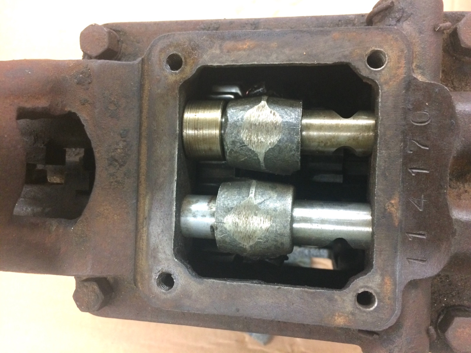

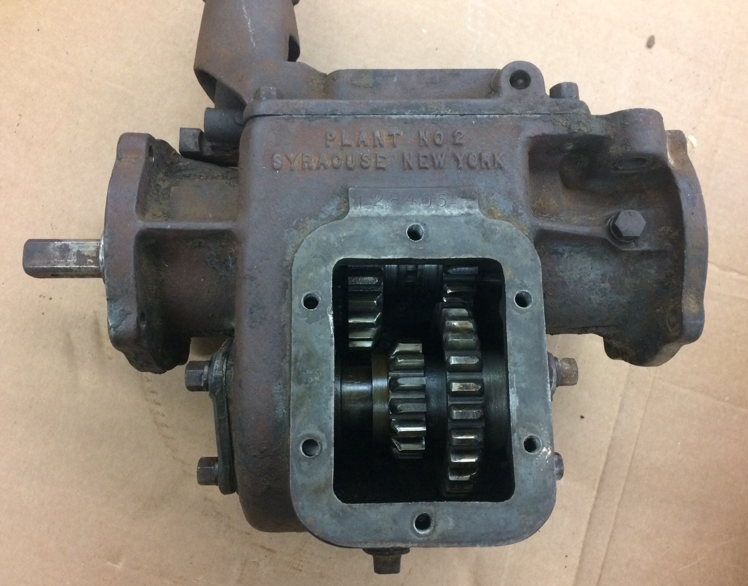

This is cast iron #128405B. The shifter base has then number 141170 on it. I need to get more photos of both sides for you next time that I am in the shop.

Hi Matt- Based on the Warfords I have looked over, the serial number on the case should match the serial number on the shift tower. This is true all the way back to the early aluminum case Warfords.
I have looked at several with non-matching numbers on the shift tower, and concluded that the shift tower had been substituted from another transmission. I even have an aluminum case Warford that came with a later cast iron shift tower assembly. It seems to work. I tend to see the case number as indicating where in the production series the transmission was made. The shift assembly is easy to transfer, and I suspect was often done as an easy fix if one of the original shift forks broke off (as they sometimes do)./ Tim

No gasket needed on top cover. Just clean any oily surface and apply some Permatex ULTRA BLACK for no leaks. You do need the shim spacers on the end cover plates. They set the preload of the bearings.
Looks like that nut with the spider washer may have been dimpled into the keyway for some extra security? If so that's likely cause an issue trying to unscrew it. A little heat may help a lot and you may need to dremel that recessed spot?

Thanks sir the info in. I will see what I can do to remove the nut.

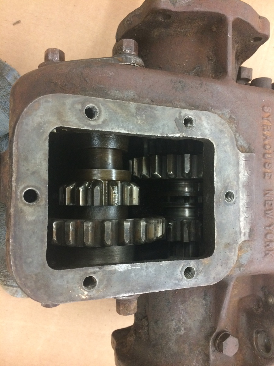

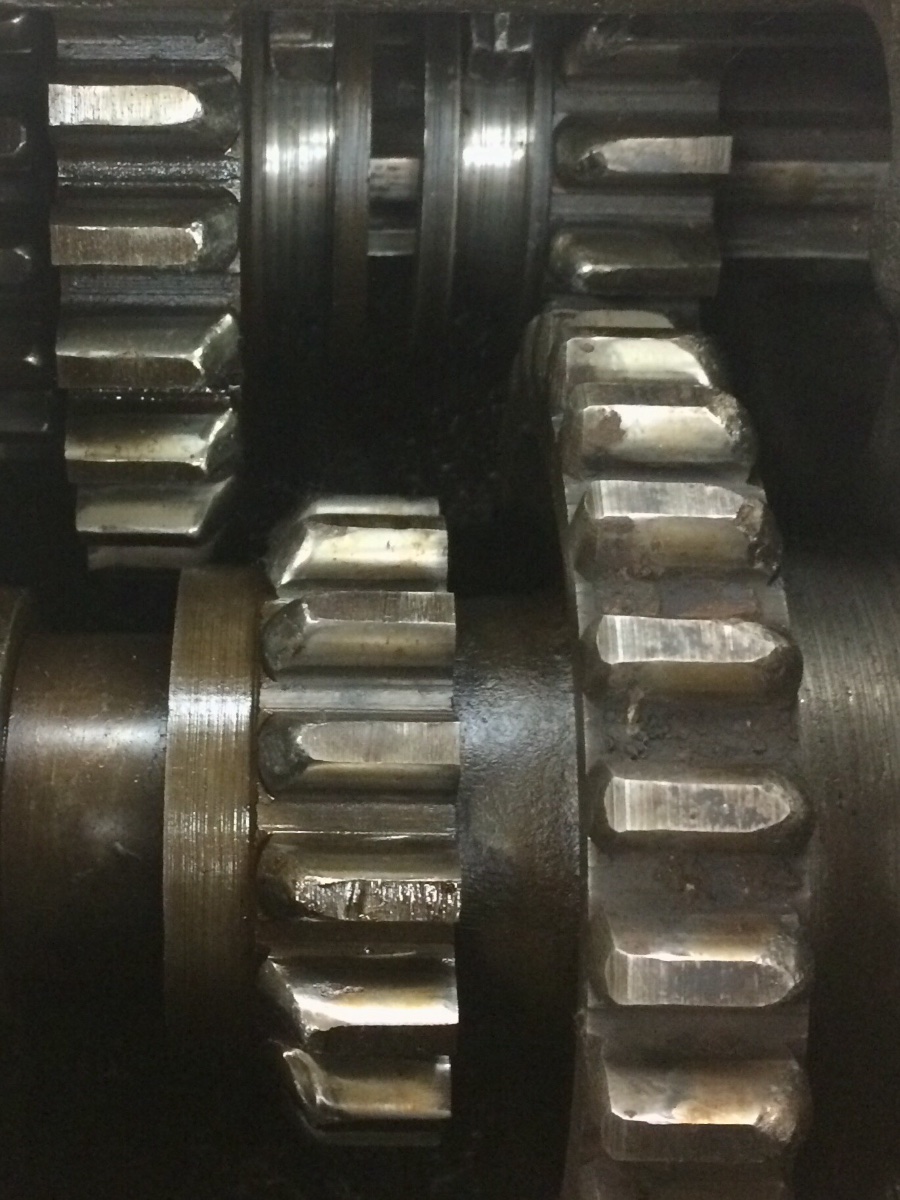

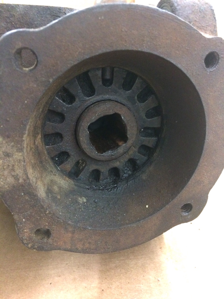

Tim,
Here are more photos for your reference.
