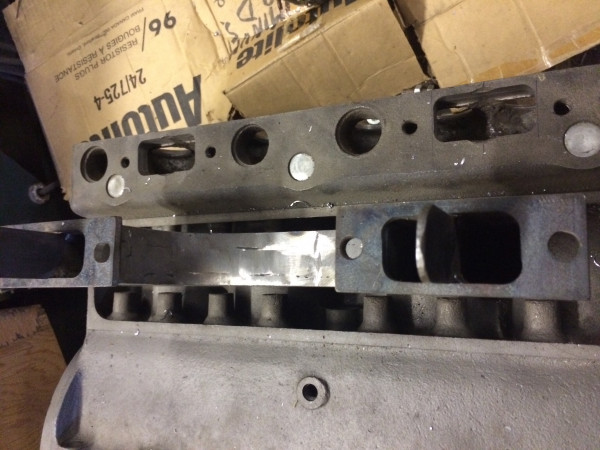

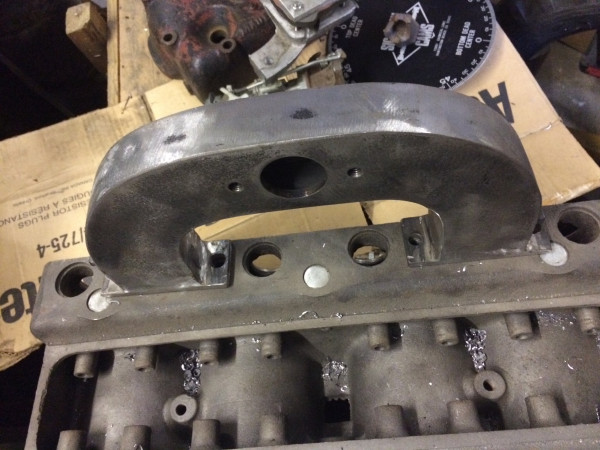

Re: Installing A-B CAMSHAFT in T
I’ve done a couple of them. No problem with the lifters.
I’ve done BIG aggressive cam grinds. Had to file notches in the front and center cam bearing bores (2 in the front and 1 in the centre)
Removed the rear cam bearing.
I actually have one in process right now.

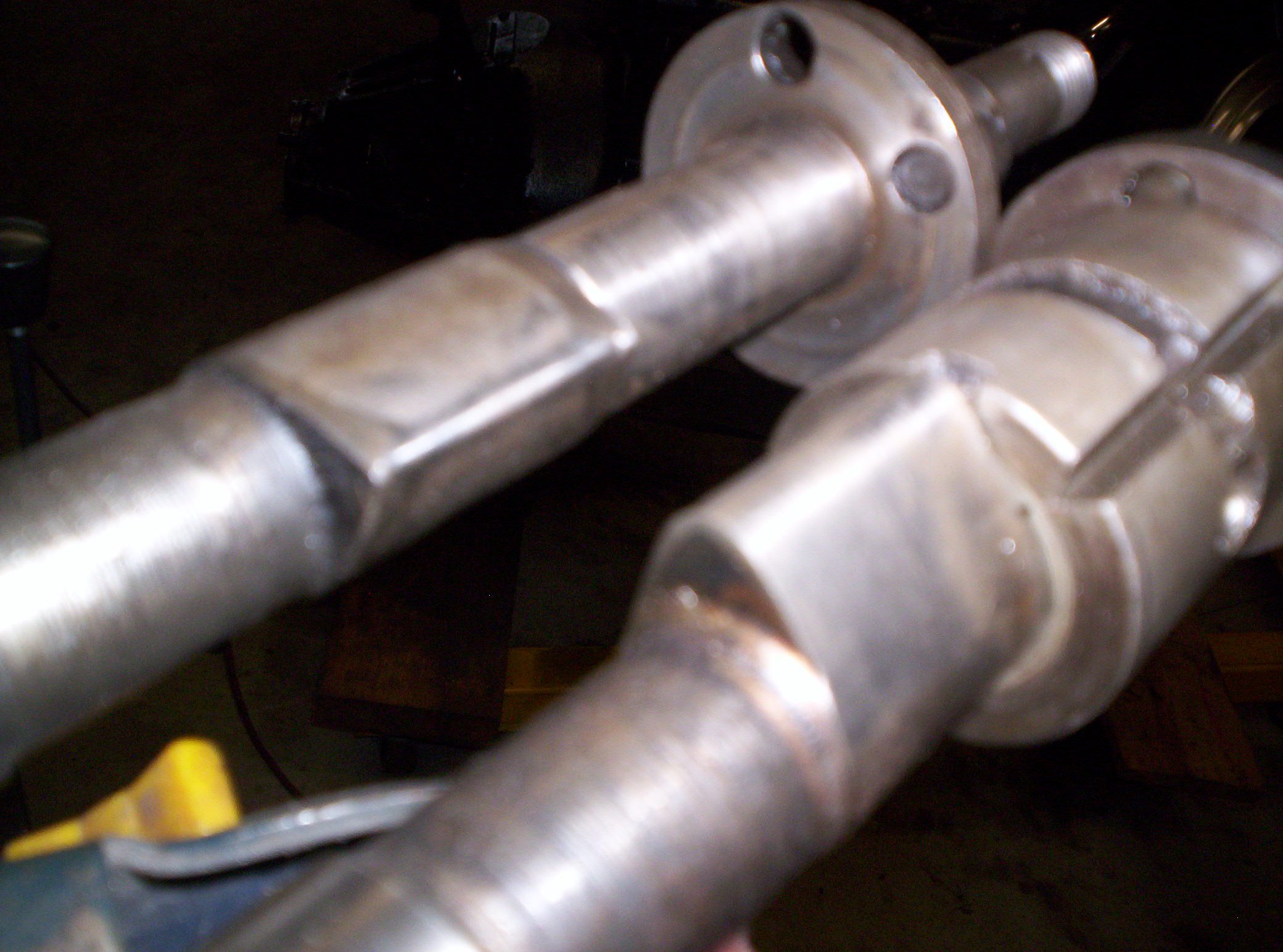

Finally got enough snow cleared to get to the shop (we had 15” here Monday Tuesday)

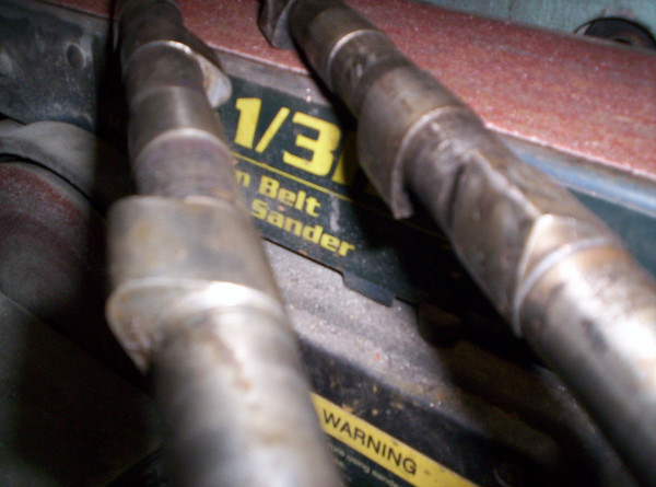

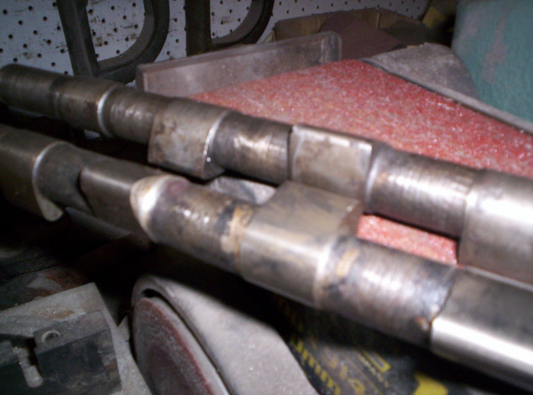

Bud
The bigger camshaft allows for a MUCH more aggressive cam profile. The cam pictured is about.320 lift. The engine requires 4 separate intake runners to get a decent lower end torque but pulls strong to 5,000 rpm!!

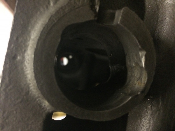

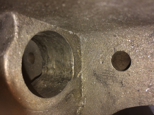

Seeing that you fella's are talking cam shafts, maybe someone can tell me what I've got here. I removed it from a T engine that was to be a speedster that was built a long time ago and never started, the lift is maxed out to bearing height and as well has a very long duration. cam is next to a stock one to compare.

Kerry, I dont know anything about your cam, but i wish it was mine.

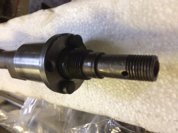

Steve
You can buy a kit from some of the usual suppliers that is designed to “fix” excessive end float of the camshaft. It uses the front cover to control this. When I did this 45 years ago I brazed up some spots on the front cover and ground them to fit. That solution is still working on that engine and I will probably do that again.
With the oil pump drive on the back of the camshaft there may be little tendency for it to “bounce” forward (but I will do something anyway)

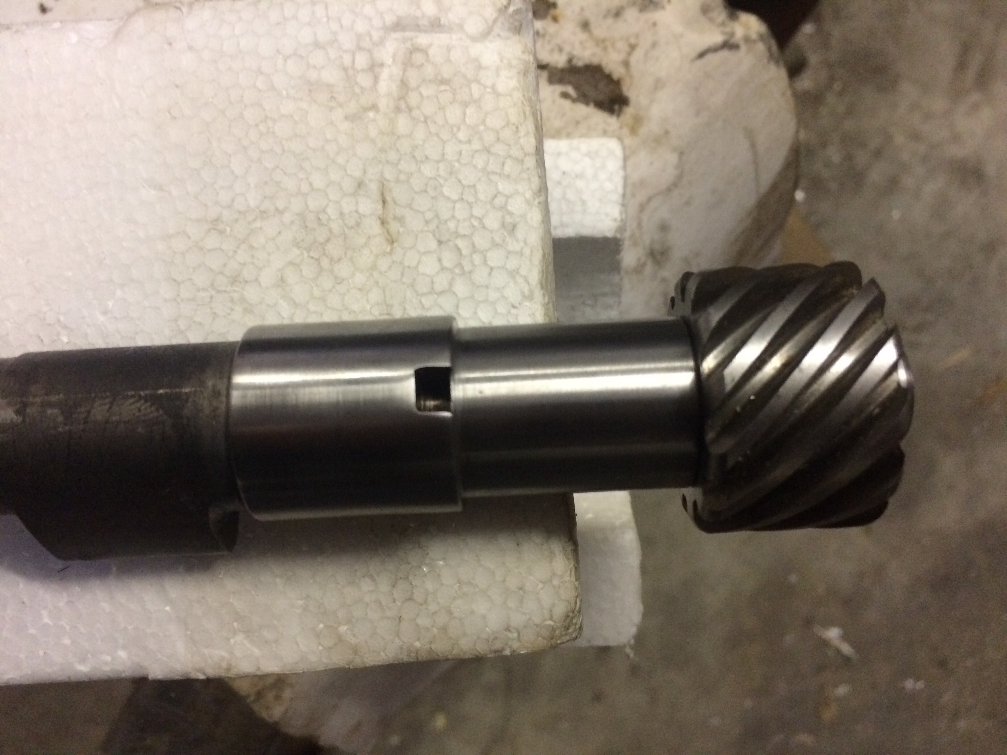

How about the cam gear, do to the different CtoC of the locating pins. Did you redrill the gear or the cam?

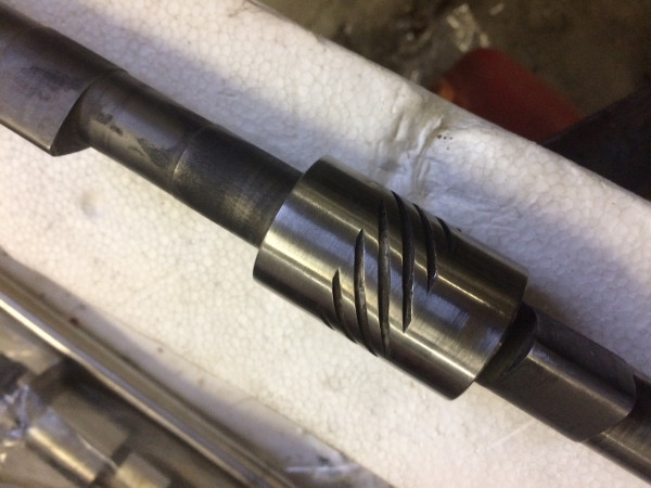

Cam gear;
Several options. As pictured the front of a T cam has been added to the A cam. The first time I did this I refitted the T gear to the front of the A cam
