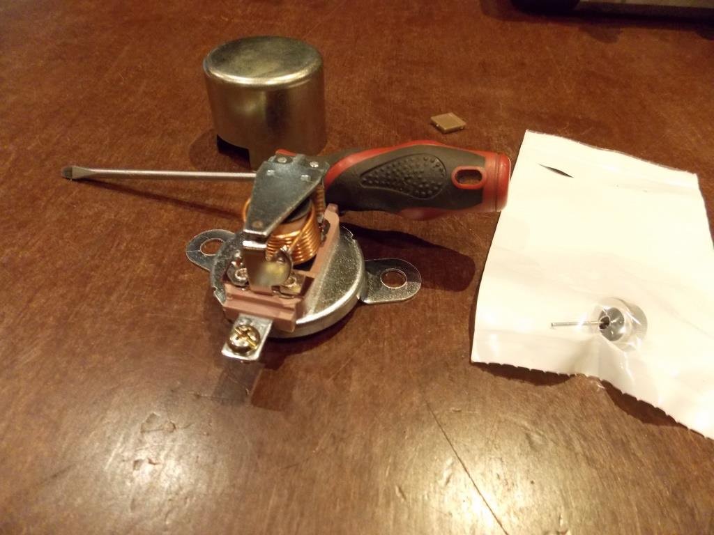

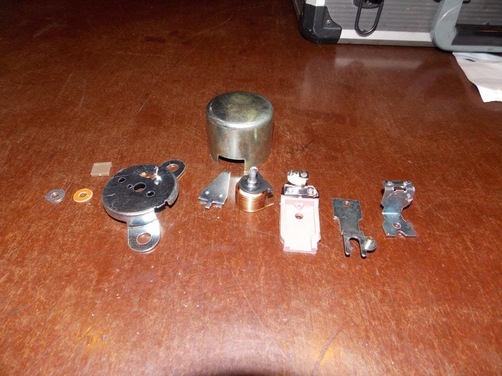

Post by AndreFordT » Tue Dec 15, 2020 12:00 am

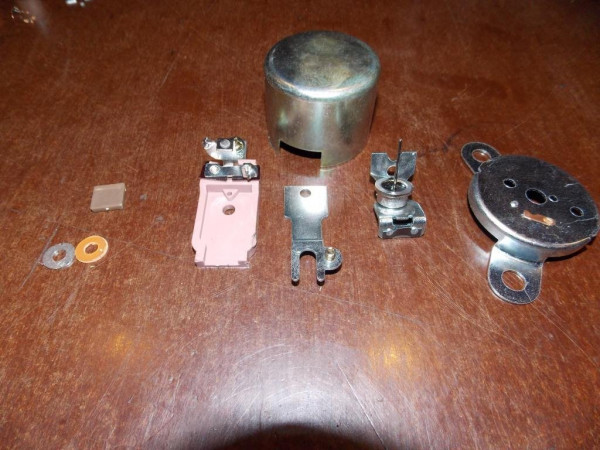

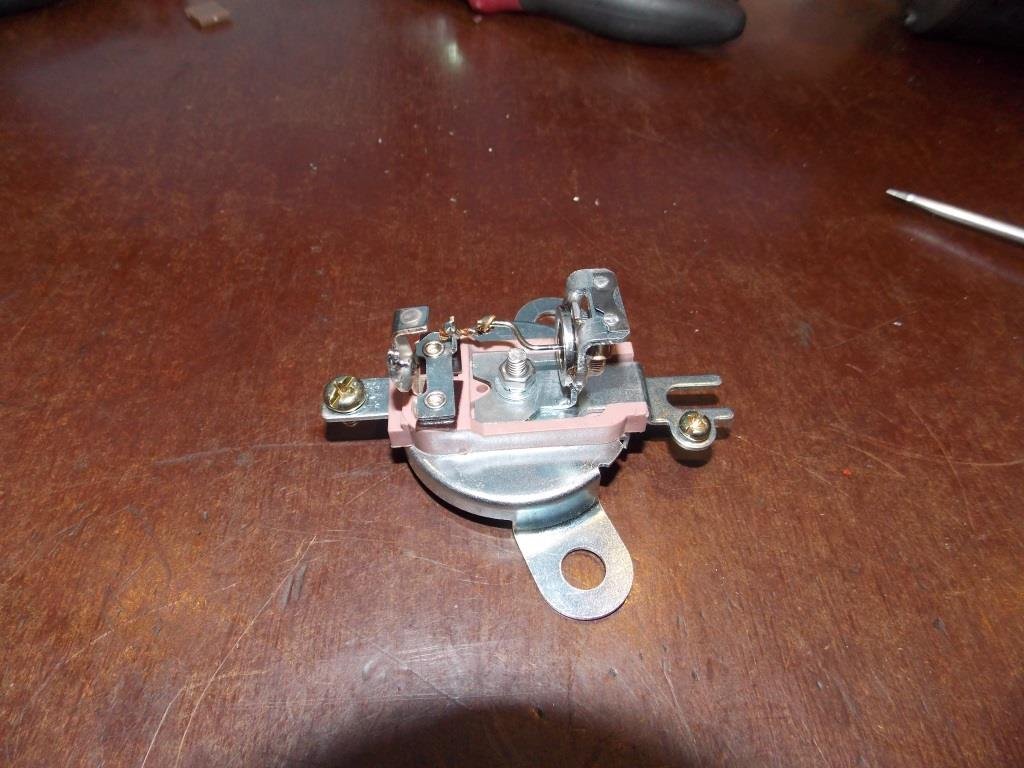

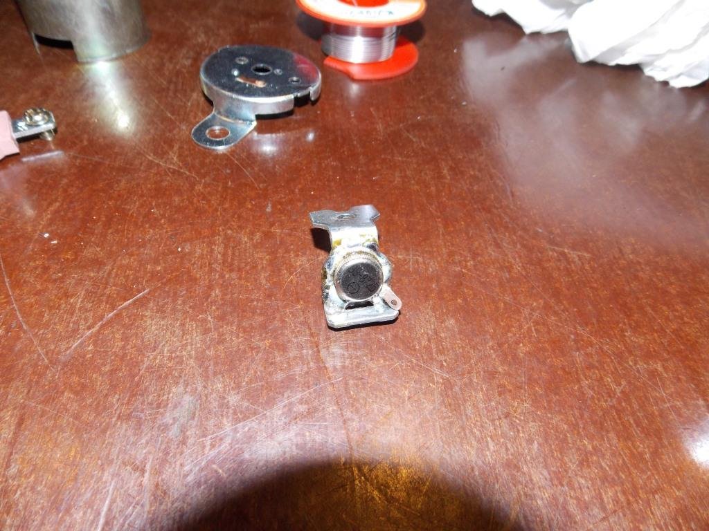

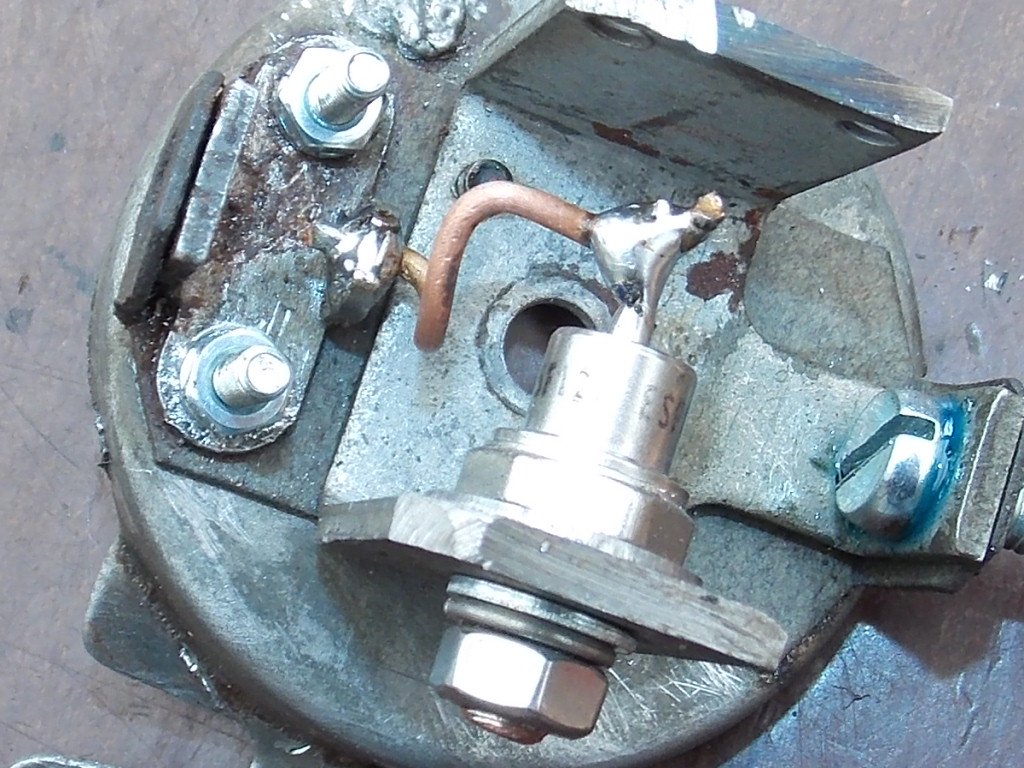

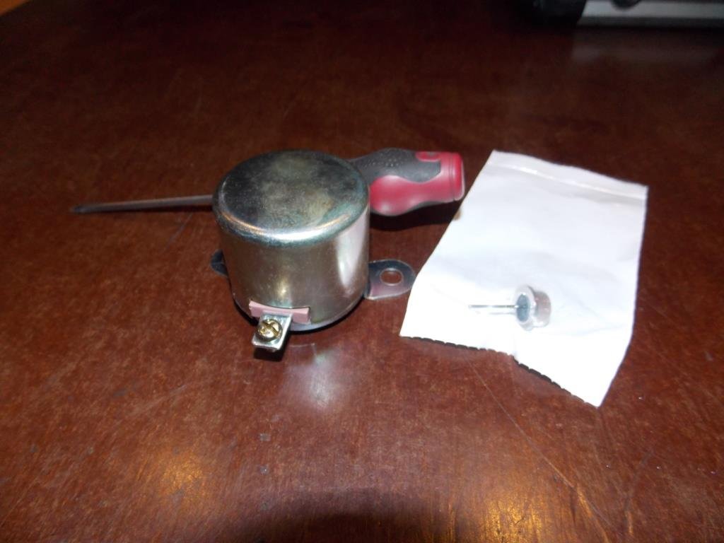

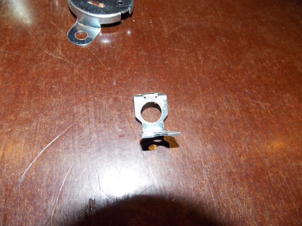

Why do you not convert your old(or new) mechanic cutout to a diode cutout. It work great for me for many years now.
Good luck
André

Post by AndreFordT » Tue Dec 15, 2020 12:02 am
second serie photos.
Andre
