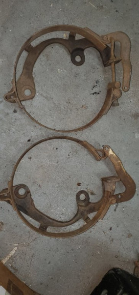

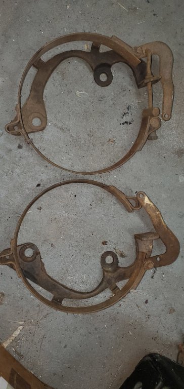

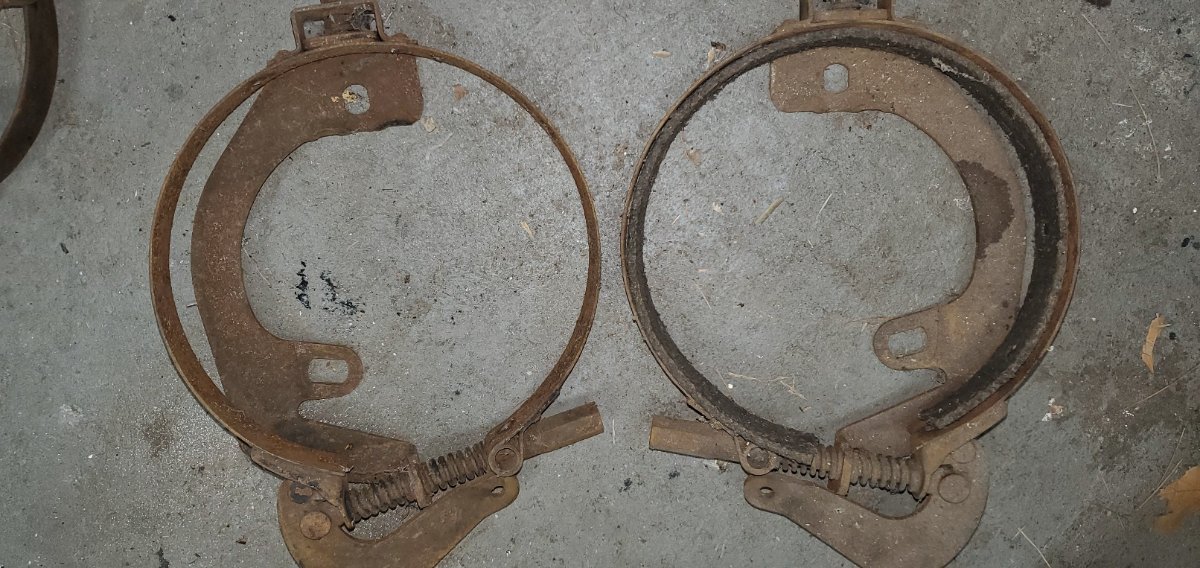

Some questions about accessory brakes.
Hi all
I have two different brands of accessory brakes was wondering if anyone is familiar with either of these sets and/or has any info or literature on either of these. They both anchor at the rear similar to original rocky mountains so I'm thinking that they should work similar to original rockies. Of course they would need to be cleaned up and relined.I currently have newer rockys on my 23 roadster pickup and am thinking of trying one of these sets. What ye all think? Also suggestions for what linings to use? Thanks in advance for your thoughts and comments.
Tom

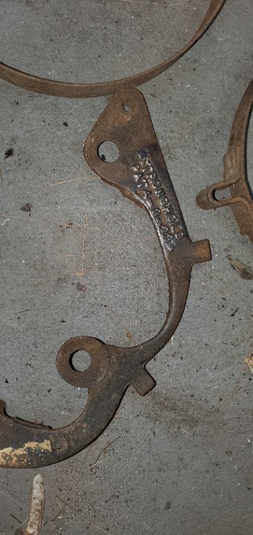

Set one has stronghold pat. 4-3-23 cast into them. Set two has no markings.
Tom
- Posts: 5539
Re: Some questions about accessory brakes.
McMaster Carr sell lining by the foot. Get the woven stuff with the brass wire. Look for the 3/16" thick stuff. My first choice would be the Stronghold. Check to see how worn the holes are and braze up with hard brass if real worn. You can google "mtfca Stronghold" and you should get some photos of the missing anchors and how they were assembled. Also besides the broken off rod on the one set, you are missing the springs. The unknown set will show where they go. You can use the longer cupling nuts for adjusters, just angle the ends so they lock, use the one(s) you have now for samples.

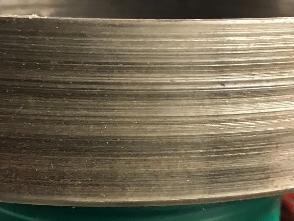

Mark, you suggested the McMaster-Carr woven Metallic Lining. I tried that a couple of years ago on both of my cars, then noticed it was severely wearing my drums with deep grooves. I was able to turn them smooth again then changed to woven metallic from Chaffans. No more wear. Anyone else had this problem?

Most of the comments on antique car brake lining replacements for internal or external applications prefer woven material with non-ferros (brass) substrate to reduce heat in constant applications. The 26-27 lining sold by Langs has brass wire in it. The claim is molded linings tend to allow too much heat, and may come loose from rivets due to the solid material, but some use those with good success. My R/M's came with molded, but think they have brass fibers in the compressed molded material.
The repo A-C brakes come with Green Gripper woven, and Chaffin's I believe sells both molded and Green Gripper woven in 1 1/2", 1 3/4" and 2" width sizes for T accessory brakes, I would check with them on what you need.

Stronghold was Montgomery Ward's brand. They were manufactured for Montgomery Wards by AC.

Wayne - The grooving was not a rivet issue. It was a series of small grooves spread all across the drums. After reading some remarks I'm going to check and make sure what kind of metallic material was in them.

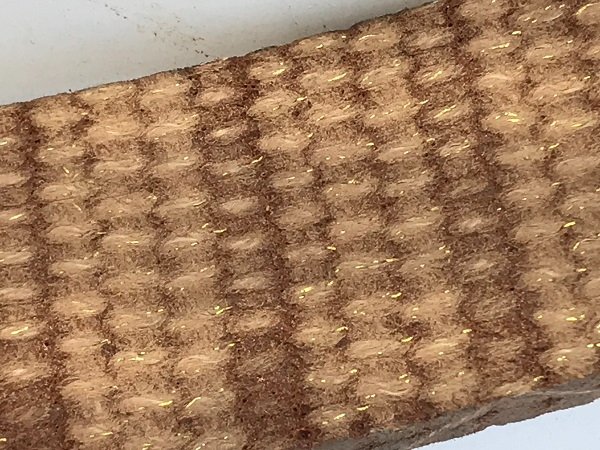

Wayne - I still had a short piece of that lining. The wire in it looks brass. McMaster-Carr only shows one kind of metallic on their website - High-Strength Brake and Clutch Lining and they say its brass. This happened on both my 21 Touring and 27 Tudor. Maybe they changed it since then. here is a photo of one of the drums.
- Attachments
- grooves in drum.JPG (73.37 KiB) Viewed 4230 times

Can you post a photo of that piece of lining? While the lining I have seen has brass wires running thru it, they are not that prevalent to do that much damage. If there was a bad batch of woven lining, it would be something to watch out for. Might try a magnet and see if it would try and stick to the lining.

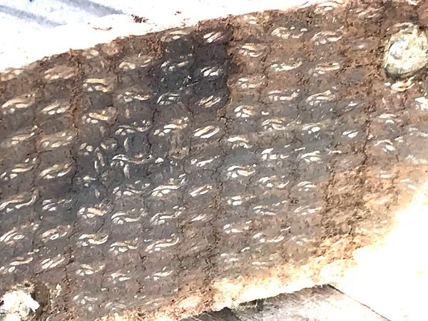

Mark - Couple of pictures - The metal is not magnetic. I scraped out a few pieces of the wire and it looks to be brass. I am beginning to think the base material is just too hard. I found the lining I took off The Tudor hanging in the rafters. You can see the metal wire very clear. The Tudor is really hard to stop at times. I will be tinkering with the linkage and equalizer this winter.
After about six months of use.
- Posts: 5539
Wow on the bottom photo! Not what I would expect to see on brake lining. That takes semi-metalic to a new level. The lining I have worked with has a few strands woven in, but that stuff looks to be almost 50/50. My guess it was used in power transmission in an oil filled housing. (?)
