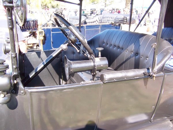

If that "one" is a electric driven motor horn, that makes the AH OOO GAH sound, and is old original from the 'period', then yes, use DC current, the old ones are 6v DC.
If you are adding a Klaxon sound AH OOO GAH mechanical, then yes, period accessory. Those are much easier to find, normally $100-$150 in usable shape, some had brass bell housings and look cool, but those in good working shape, no lumps or dents in the bell command the more.
Typical mount is on the driver's arm rest, so you can hit the button on top easy.

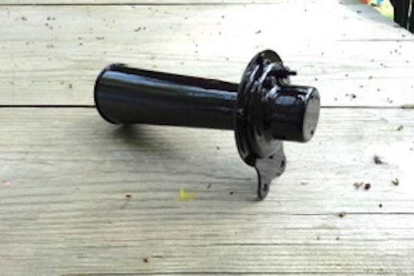

Your '16 will have the Ford BLAT sound magneto electric horn, similar to this later T, which is magneto powered, these horns work only on AC current.

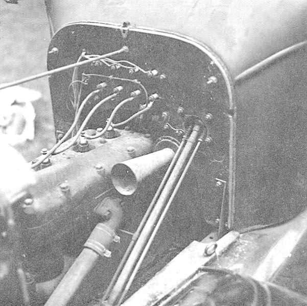

- Posts: 7413
Re: Klaxon horn debut
How do you know if a horn is for mag or battery? Look down the bell. If it has an adjusting screw in the center of the diaphragm it's a magneto horn.
I've tried a mag horn and a Stewart mechanical horn on my 1915. The mechanical horn is better.
