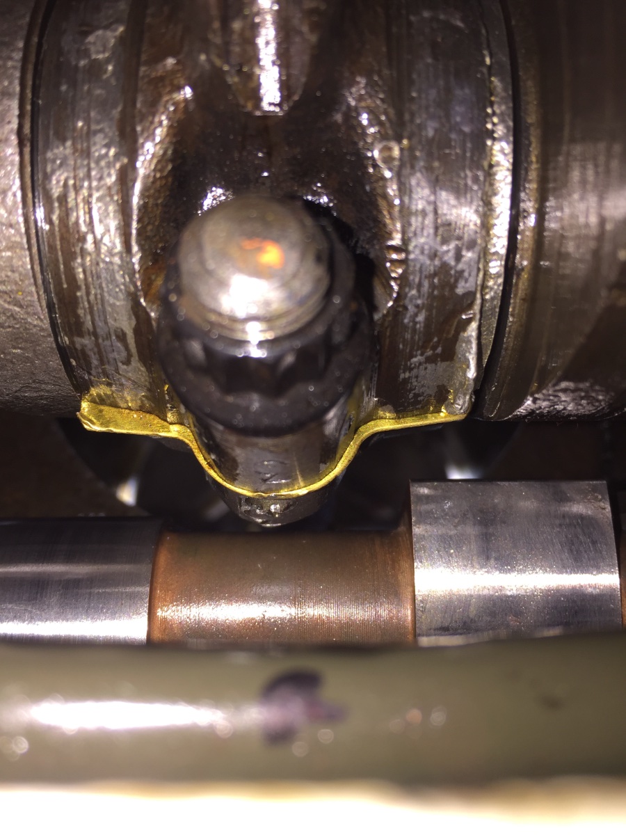

Here is a pic of a Stipe .280 cam up against a shortened model A crank. There is about .100” clearance between the top of the rod and the root diameter of the cam. And about .300” clearance between the crank and the cam lobes. If there is a clearance issue, I would assume it is with the rods
