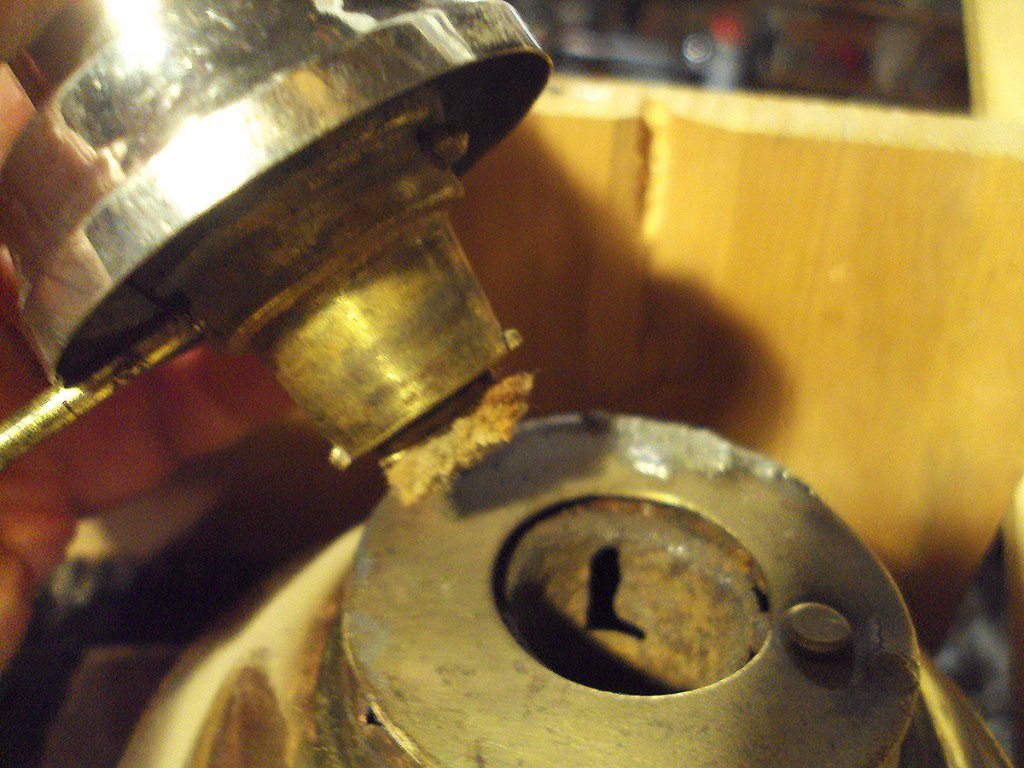

Thanks Mark! I should have said this is a brass car -1911- so I don't have paint to worry about. The burner appears to be thin brass that is plated. Nickle maybe? There are three places staked into the burner assembly that are equally spaced around the collar that fits onto the neck of the font. It looks like they engage the neck of the font somehow, maybe by screwing into the neck or maybe by twist to unlock and pull then apart. This is thin brass, and so I want to have a good idea of what I am doing before I do it.

The E&J burners have a 2-pin bayonet style mounting. They are tapered and just push in and twist.
You can see this one is rusty so that may be what is holding it. By twisting it counterclockwise it should come out. Brown, Corcoran and many others have a threaded end.

Got them off! How? Soaked them in PB Blaster overnight - still stuck. Then heated the font top where the two assemblies join together until oil smoke filled the air, then grabbed the burner and font and twisted counter clockwise. They both released! If you do this, wear gloves! My guess is decades old lamp oil had glued things together.
Many thanks to all, esp. Rich Eagle for the photo of the connection detail. Now to placate the wife for stinking up the house! Cheers, Bill
