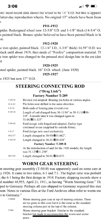

The pin holes drilled in different angles mentioned in the encyclopaedia I cannot see.
The middle one with the course thread would be correct?

The middle one is correct for your car. The different placements of the rivets were on the 3rd style shown. The earlier styles did not have rivets.
