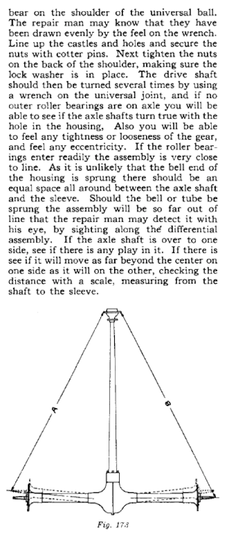

The position of the driveshaft tube to the rear axle tubes should be checked with a framing square. It should be square. The distance between the bolts at each backing plate and the driveshaft ball joint should be measured and be the same. With those measurements correct, the alignment of the axles, driveshaft, and bearings should be correct.
Another very important thing which is missed, is the alignment of the ball joint could be affected by the straightness of the frame and the crankcase. If the frame is crooked, it must be straightened and the crankcase must be straight with the ears correctly aligned for the rear of the transmission to be centered.
Anyway, all those things must be accounted for.

Here's the Service Bulletin article from a PDF.
