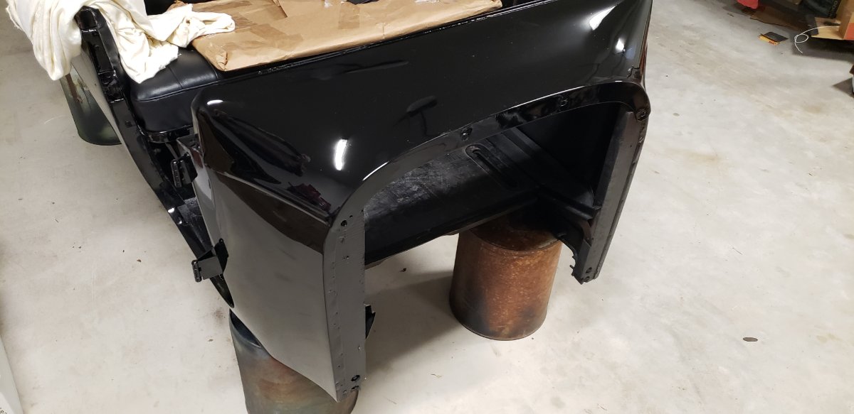

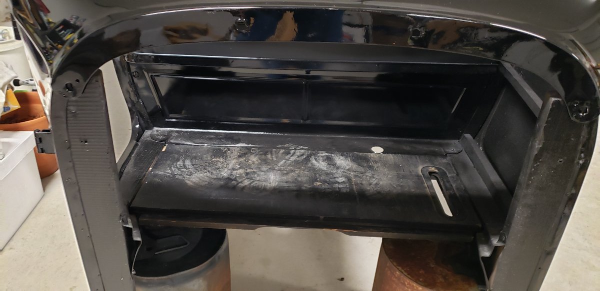

Would someone post the correct size and type of bolts and nuts needed to fasten the cowl to the body and to the firewall please. My car had a mismatched variety when disassembled. There are four places to fasten to the firewall and two or more to the body I think, please correct me if I am wrong, Thank You

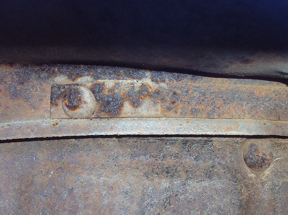

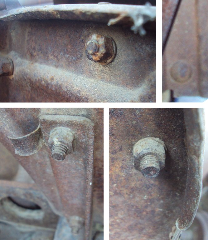

I believe these are untouched since the factory.

Thanks for posting Rich. Are the two upper fasteners Carriage bolts? What is the wrench size for the two upper hex nuts?
Re: Correct 1924 Cowl Fasteners
Post by Rich Eagle » Sun Feb 07, 2021 2:36 pm
Yes, the upper are carriage bolts too. I couldn't measure the heads but they are not the extra small ones like on fenders or coil boxes. The nuts are slightly bigger than 1/2 with the rust on them. Getting a standard 1/2 open end wrench would be tight. The bolts are 5/16". This is a '24 Tudor but the bolts would be the same.
