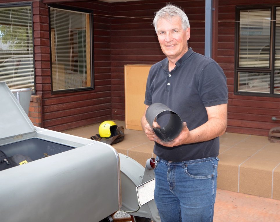

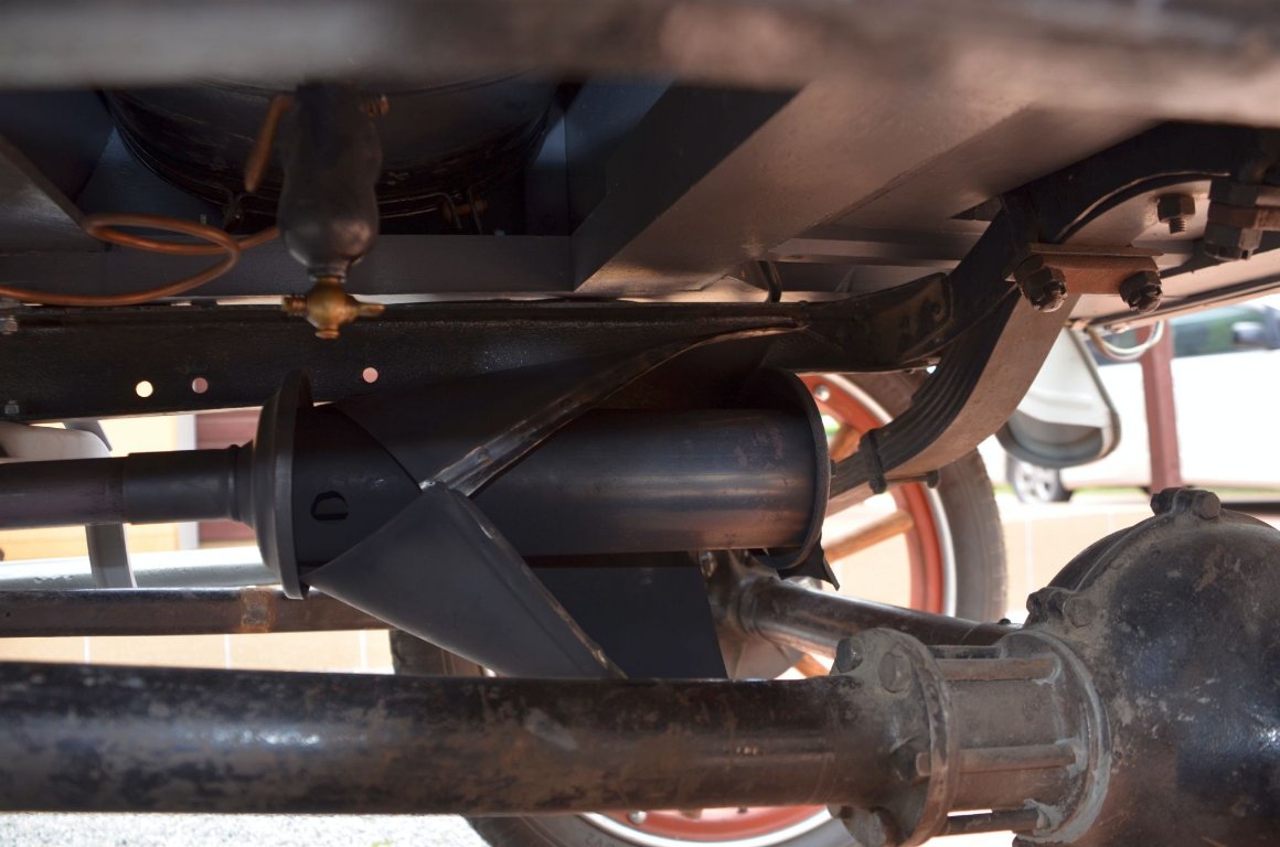

Upon reaching the ultimate destination a short investigation was conducted and the following result discovered:

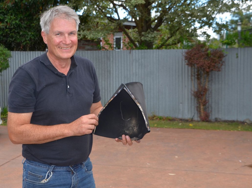

The owner was suitably contrite:
This call for some drastic action. The offending part was removed and dealt to with a large hammer and a piece of pipe, after which it looked like this:
A quick re-assembly later, it was fitted back to the vehicle and we could now hear the motor.

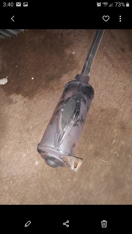

Re: Not on the road 5 minutes and look what happened!
I didnt see a solution posted. i have also experienced a blown muffler. every new one i install gets 6 - 1/2" evenly spaced weld beads on the seam.
i can still go bang accadently or on purpose without having to reshape the can. keeps customers happy too.
