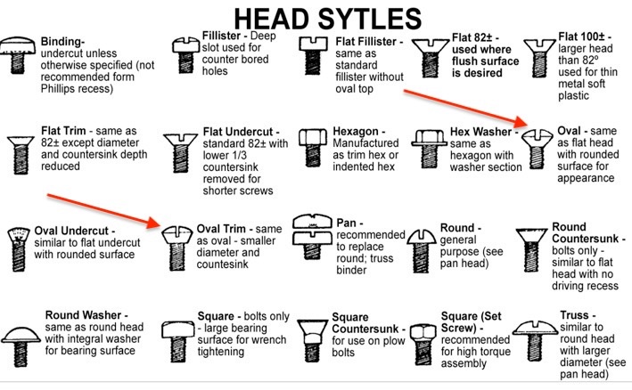

Where to purchase some? 26/27 open car dash panel screws. Don’t see them on the vendors sites. These need to be correct as they are in your face all the time. Cannot have tacky modern fasteners there. 😁

Correct name is oval head screw.

Lang’s cat. # 671, nickel plated correct oval head machine screws and square nuts. $2.95 set. SS ones from other sources like Restorationstuff.com look like nickel when buffed on a wheel and won’t tarnish.

They are known as oval head screws in the USA, but they are raised head countersunk or dome head countersunk screws. They are neither oval in plan view or in cross section, but if enough people get it wrong, it becomes the established norm.

Correct on that, here in the USA we always refer as oval head. There are smaller versions known as trim oval, bit flatter on the oval and countersunk.
The oval head are correct for Ford metal dash screw depressions, and metal switch** panel depressions.
