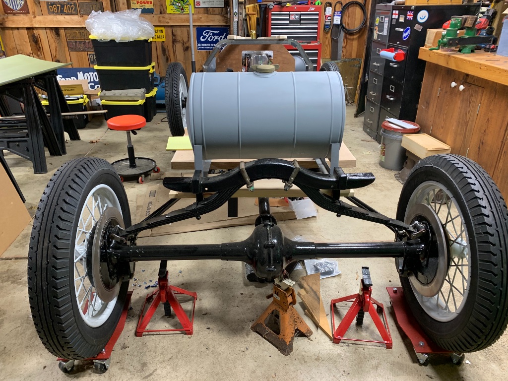

SurfCityGene
- Posts: 681
- First Name: Gene
- Last Name: Carrothers
Re: Disc Brakes--Yes/No??
Dan, I recently saw the brake assy kit that you have available and have to say they Really look nice! Most all people would not notice and they look appropriate on a Model T not like the Hugely over sized disc brake kits so popular now.
Got say Dan Great Job!!
I have seen pictures of Dan's brakes and I second Gene's remarks

I quite agree about Dan’s brake kit!! Almost invisible!! I have one. The only thing I added was the self adjusting kit (got it from Rock Auto)

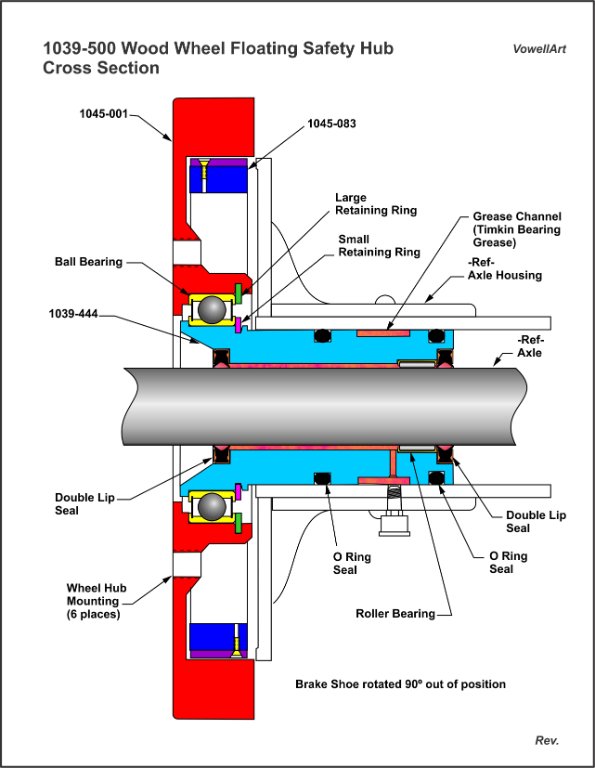

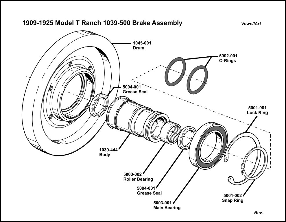

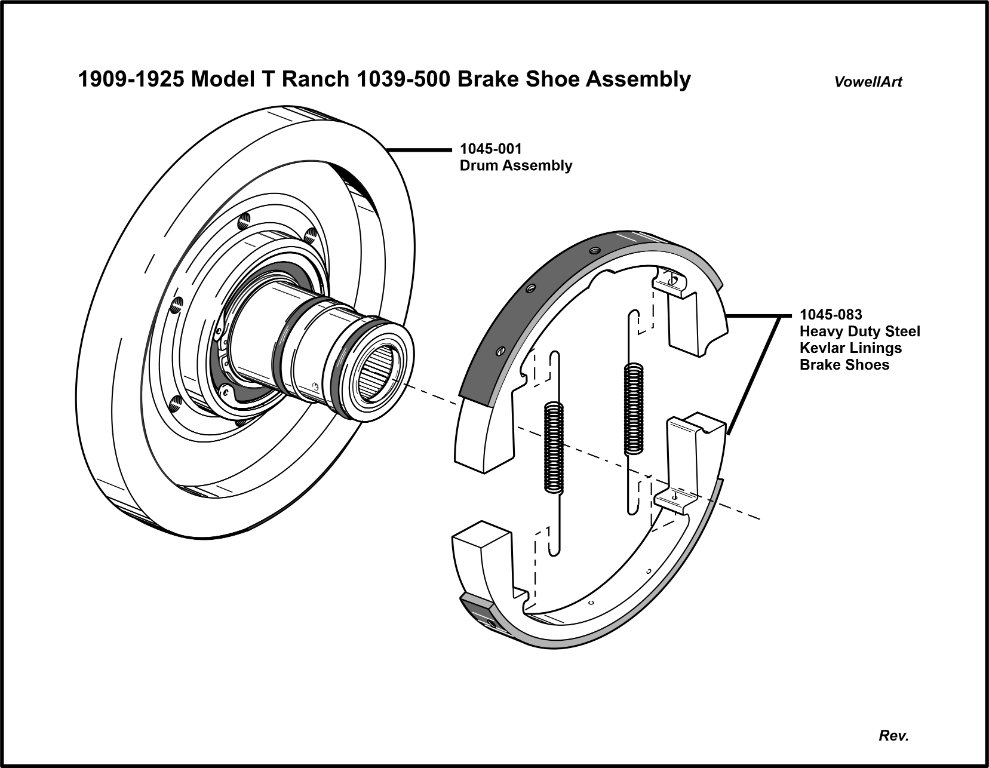

Jonah D'Avella
John W. Stoltz's Model T Ranch Brakes
They're hardly noticeable between the original brakes and John's...they're about as noticeable as the Rockers, yet work a lot better and a lot cleaner looking installation too!
I'm running 3:1 in a stock rear axle...wouldn't mind having a Ruckstel though...just can't afford one. I also rarely drive my car over 35 mph and the modern Rockies only work going forward, not backwards. So forget them holding you on any hill...they wont! But those Model T Ranch brakes sure will, but then so will Larry Sidemore's AC brakes and the Original Rockies (which work totally different than Bud's version of them), they actually have 2 cam levers on them to adjust the both the forward braking and the reverse braking. I was suppose to draw them for Larry "Original" Smith, but the drive I had all the pictures on was destroyed in the Creek Fire a few years back, so I've been slowly reacquiring what I've lost in an effort to fulfill my promise to Larry and draw those Rockies of his (much better set up than Bud's Rockies, I especially like the cable and pulley equalizer, always pulls even, none of that screwing around with rods and clevis pins nonsense).What size rear end did you have?
Fun never quits!
