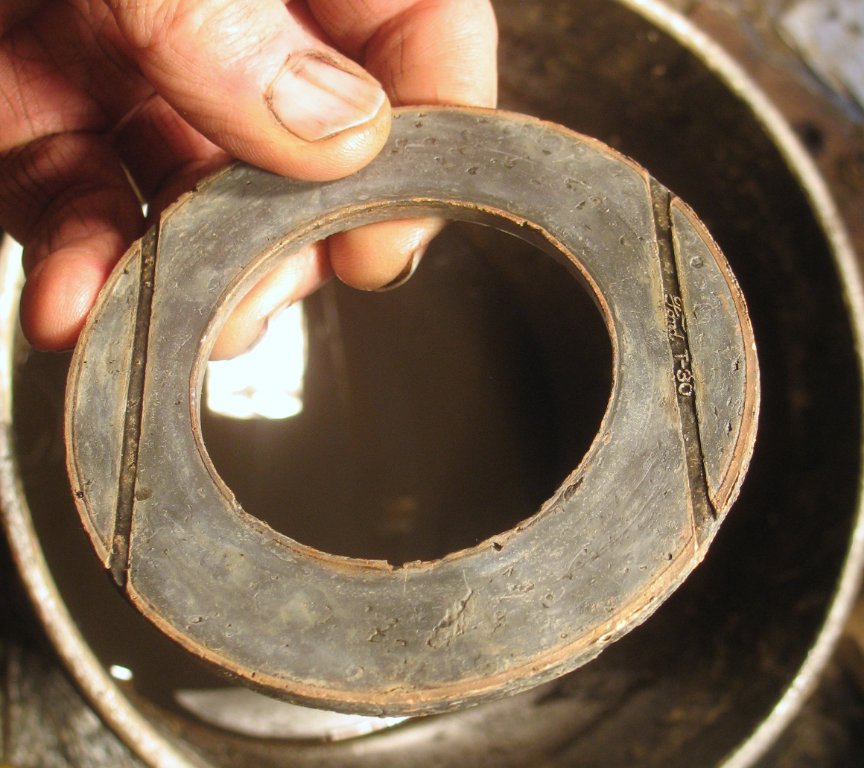

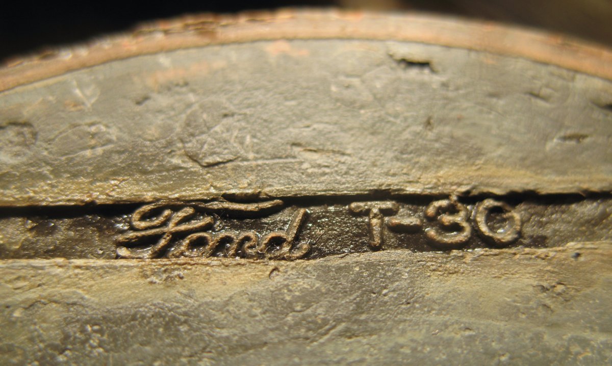

Re: Babbit Thrust Washers
I've mined several rear axles for parts. In all but one the thrust washers were in pieces or completely gone. Here's the single survivor I've found.
- Posts: 5138
if you want to know if is was usable do the drop test. hold it up about 5 feet. drop it on edge.
it will probably shatter like glass. i have only had a few pass the test.(maybe 2%) still WOULD NOT USE them.
but its amusing to see how close to failure the rear end was.
that one you show looks like it will shatter.

- Posts: 4383
I have had (still have!) several original thrust washers as nice as the one Steve J shows! However, oh so many years ago, the very first model T rear end I rebuilt, I found the nicest one you could ever find. I had set up a work station at the back of my parent's place. When I was done putting the thing together, including the new bronze washers (I had gotten and followed good advice!), I was walking back to the garage to put some tools and things away. In one hand were a couple tools, and this absolutely perfect looking original thrust washer. It was clean, and shiny, smooth and beautiful with its flawless oil grooves and Ford scripts. And I stumbled stepping in a gopher hole. My hand tightened a bit, fingers only on some wrenches and that perfect thrust washer. And the thrust washer snapped into three pieces!
I have never seen a definitive report of what they were made of? Babbitt is defined as a wide range of soft metals used as bearing surfaces. They clearly are not Babbitt in the sense of main and rod bearings. But they are in the Babbitt spectrum. And they do resemble pot metal.
From that day I stepped in the gopher hole, I would never trust an original Babbitt thrust washer in a model T rear end. With age, they just cannot be trusted. No matter how nice they look.
