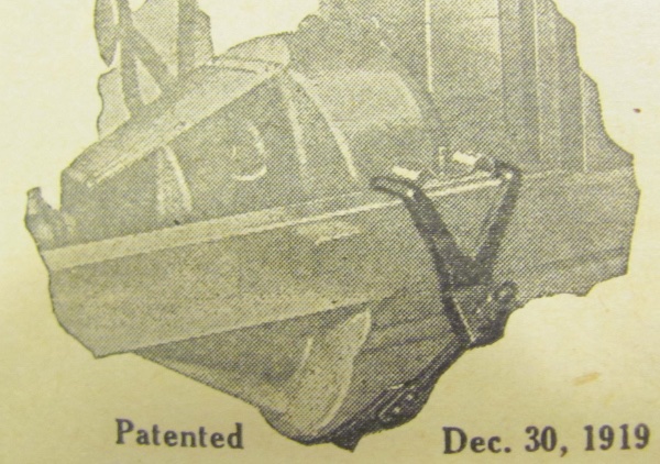

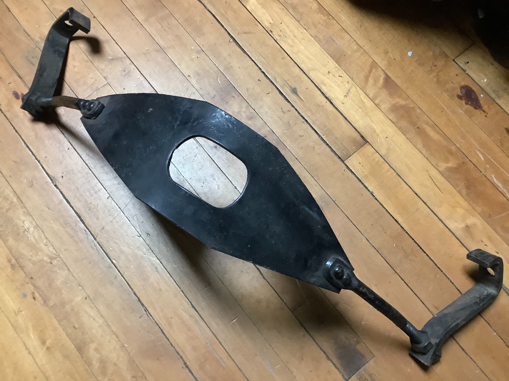

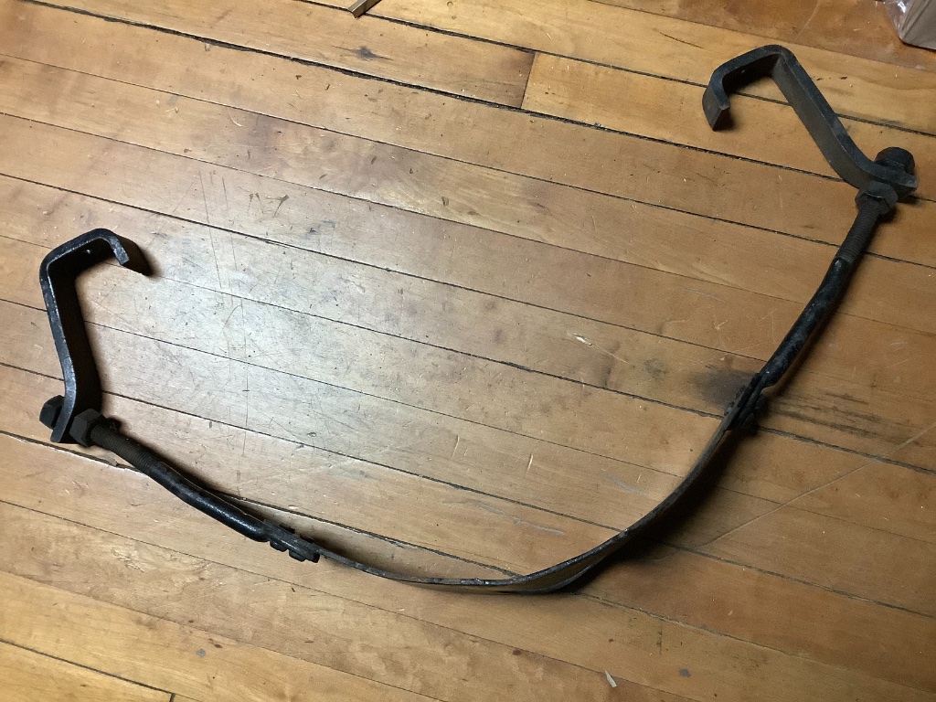

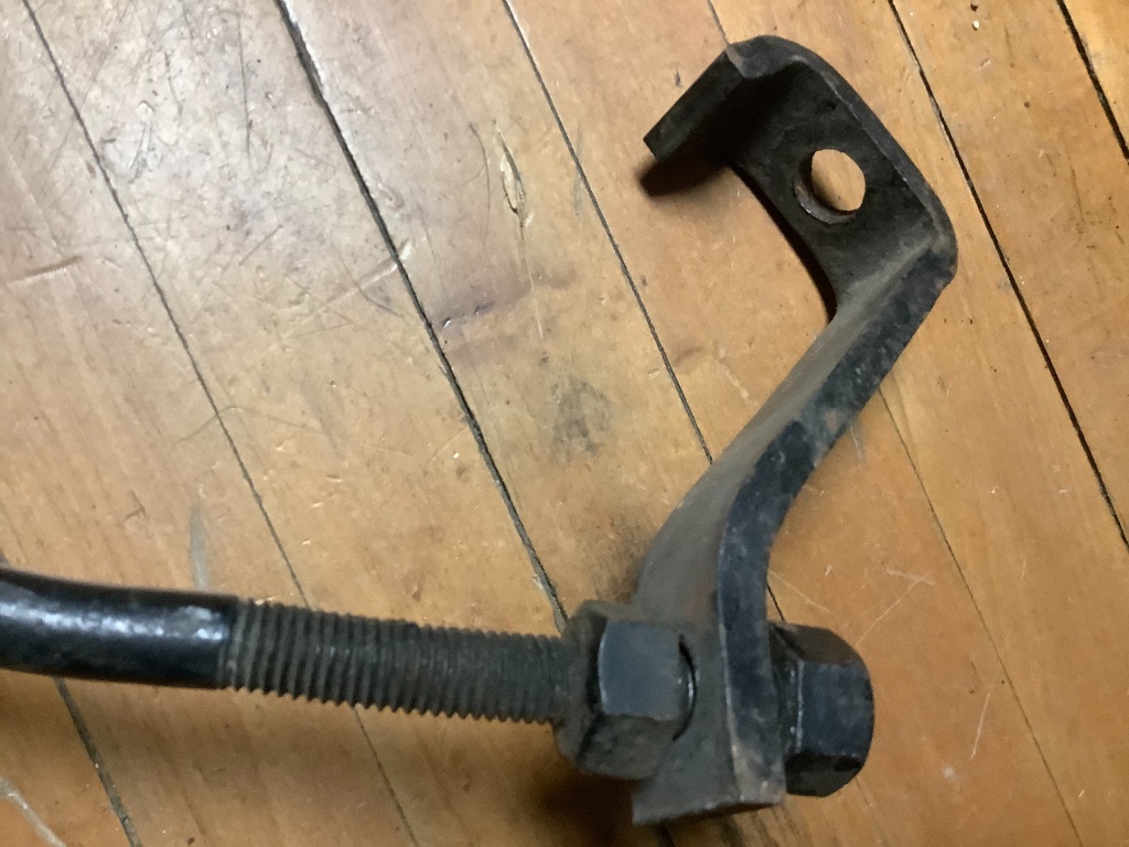

Some great guys on here have a photographic memory and a great collection of trade books. I’ve seen these in the past, but always thought they were homemade ends for the frame. That is, until I kicked up this NOS unit. Looks like it slips right over the head of the vertical pan bolt nut. Any idea of the maker? We may think of simplifying the ones we make, but we always like to give credit to the original producer.

I have one identical to yours but no name anywhere. Don’t put it too tight, it is merely a backup safety device only. Frank

George, there were a lot of gadgets on the market in those days to improve your T. I bought this as a cutesy for my car many years ago and the gentleman told my it is merely a backup support. I bought it because I liked the looks only, but it could possibly save me if the pan arms actually break. The advertisement above states it will stop the rattling and so forth and make the car smooth and pleasant to drive. It is merely affixed to the frame in the same place as the pan ears and the frame and if the car was running rough it will still run rough after this pan support is installed. Putting a inner tube piece between the support and the pan might keep it from chafing the pan but it won’t make the motor run smoother. It is a nice looking, just in case the pan arms break, idea only in my opinion. The inner tube idea is good but I was told to install it firm but not crush the pan up. I am getting my motor rebuilt at the moment but will be reinstalling the pan support again, just in case I break a pan arm and the conversation value of the thing.
Please, someone prove me wrong. Frank

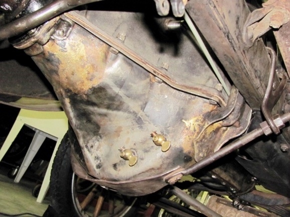

I use these on two of my T's. They help by giving better support to the engine crankcase. My '27 doesn't need a belly strap, as Ford recognized the need for this support, and added bosses to the rear of the block, with angled supports going to the engine frame mount bolts.
On my T's Ford parts are also used, both bolts and wood block at the frame mounts. With the belly strap, weight and torque thrust is more limited by the grip of the belly strap under the crankcase, and the support rods to the sides of the frame.
Remember, the T '3-point' suspension is fine for the give needed to allow frame twist on dips or culverts, drive way cuts and other obstructions to a flat road. The belly straps don't prevent that flex, but do add bit more support to keep the drive train in-line. All forward action underway, shifting to high, etc. throws twist to the engine, and all braking too.....causes twist to the engine.
Pioneer made a later change to the forked style, which I prefer, as it is easy to thread up and around the crankcase ear.

My drive to make these was getting an engine back from rebuild and catching a very small hairline crack in the pan arm. These can be still found used, but often the threaded portion is in bad shape. iMHO they should be snuggled up so they don’t move, otherwise the threaded portion will be damaged again with movement. That is our reasoning for providing ours with a thin piece of neoprene rubber glued to the bottom saddle. Regular rubber will not survive oil very well, in case you have one of those rare lizzies with bladder leakage. We have sold quite a few, available only through Snyder’s and Lang’s ( sorry, shameless plug )
