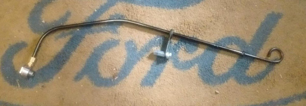

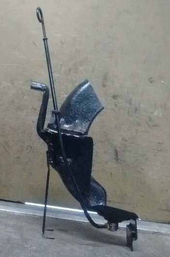

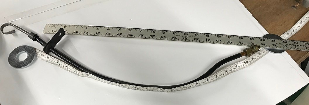

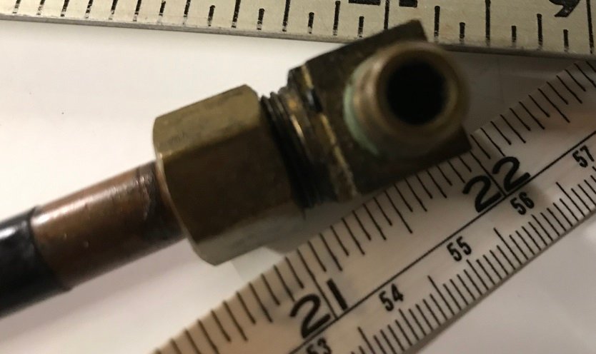

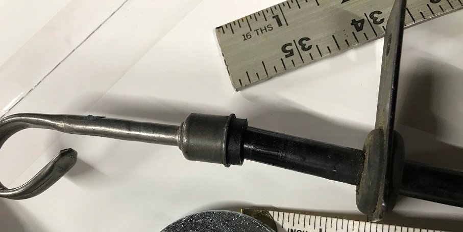

Picked this up sometime ago with a bunch of T parts. The stick level markings don't matter, just score a line at the full mark etc

The dipstick pictured above is not an Advantage dipstick.

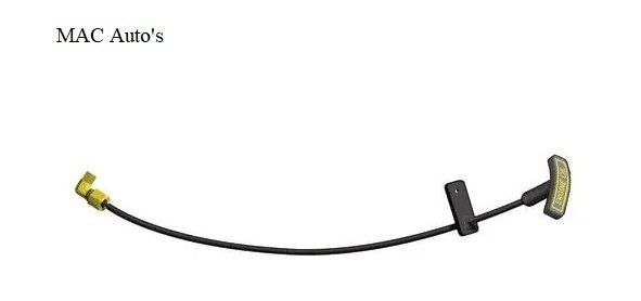

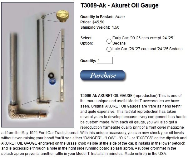

I couldn't find anything about an "Advantage Dipstick" but did find some options

I had one of the ones that Mac's sells with the modern plastic handle. It looked like it would probably work, but the load plastic handle just screams "modern" to me. I gave it away without ever installing it.

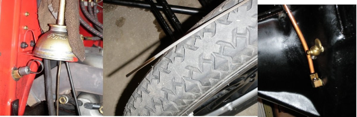

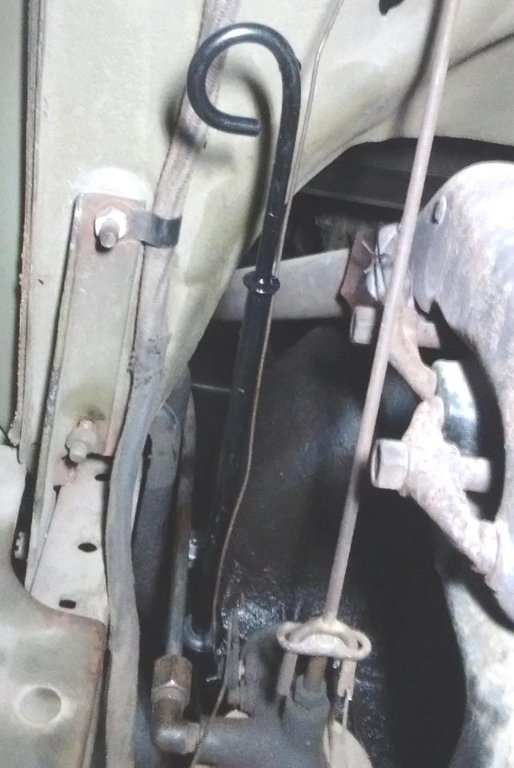

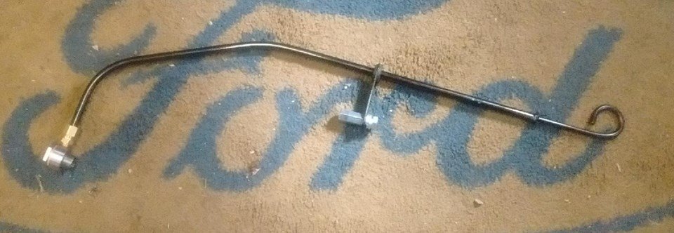

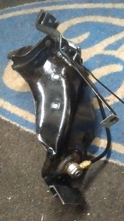

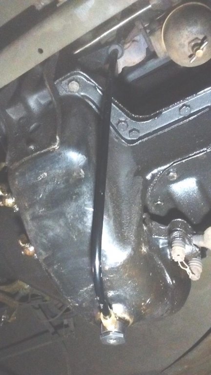

These were from another post; not on my 26 Touring. Thought I'd add for completeness. If someone needs pics of the dipstick on my 26 Touring, let me know and I can go out to the garage and snap a few. Only concern is the slight decrease of ground clearance which I was told might come into play when loading or unloading on a trailer. I have no trailer so I guess I'm OK.

Thanks Mike, those pics will indeed helpful to many. I have this dipstick on the '23 and it drove up into the trailer & out again with no issues. It didn't occur to me to even watch for clearance. The '39 Caddie did drag the undercarriage getting in and out, it has both a longer wheelbase & is lower to the ground.

Wonder where one could get that size banjo fitting and Banjo bolt ?

"Wonder where one could get that size banjo fitting and Banjo bolt ?"
You can get one of each in an Advantage dipstick kit. I paid a machine shop a whole gang of money to tool up and make these for me.

Note there is an Allen plug in the banjo bolt so you don't wear out your original pan threads nor mess up your seals of the banjo fitting! Brilliant!

My dipstick kit arrived this morning safe & sound. I just ordered it Tuesday. It is EXACTLY what I was looking for, the same kit that I installed on the '23 a year or so again. Thanks Tom for making this kit available to help some of us solve a painful problem.

What I would like to know is how the part at the bottom stops at the right spot? With my luck the fitting for the tube would be facing the starter. Or do you put a correct size washer under it so that it points in the correct orientation?

David asked: "What I would like to know is how the part at the bottom stops at the right spot?"
The "banjo" fitting will mount in any position. It is clamped between two washers by the banjo bolt. Indeed, some people have mounted the dipstick on the starter side, as there were obstacles on the non-starter side. This can happen on cars with modifications, such as speedsters.
