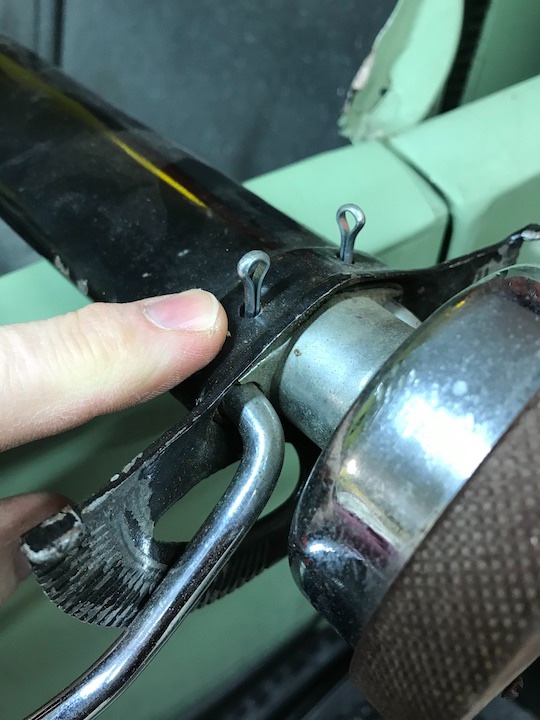

I just had a thought. Has anyone ever considered buying round headed rivets and threading them so as to use Tim’s idea to make it so it can be dismantled in the future while maintaining the original riveted look, at least on the top. Of course there would be the problem of sufficiently tightening the nut with nothing to hold on to to keep the threaded rivet from spinning. Jim Patrick

Yes. Only the last 1/2” would need to be threaded and if you needed something to hold onto, you could cut a slot into the threaded end with a dremel tool to hold with a standard screwdriver, or flatten the threaded end on opposing sides with a dremel tool with which to hold with a small wrench. This would also allow you to nickel plate the rivet head with an electro-plating pen. Jim Patrick

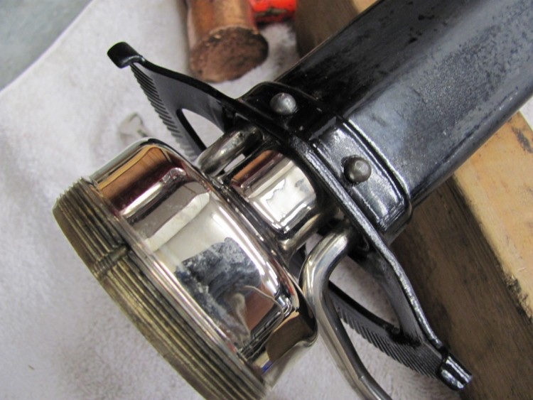

Just too Henry I am. Rivets are best at the quadrant.
Threaded screws or bolts, nuts, lock washers, can wiggle loose within the holes of the soft brass case, and all will protrude and would snag my hand, at times reaching under the quadrant. Smooth rivet head there is better.
My use is a pneumatic rivet gun, setting the rivets cold, bucked tight under the column and quadrant. Rivets placed into the softer brass steering case lock in better, due to the angle these rivets are placed. Fix is secure at this very important part, the steering gears are under the steering wheel. Make this assembly the best you can.

Guess one could do anything to the T steering column. But any wiggle at the quadrant/steering case needs to be fixed.
IMO, remove the old rivets, inspect the column for any crack, then replace the re-finished case using factory method of riveting.
Of course, welding is one way
IMO, easy to re-rivet, and gives the best look and security, as in the one I did below:
