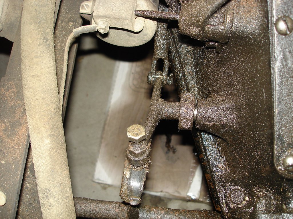

Here is one that has the lever arm too straight, like yours.

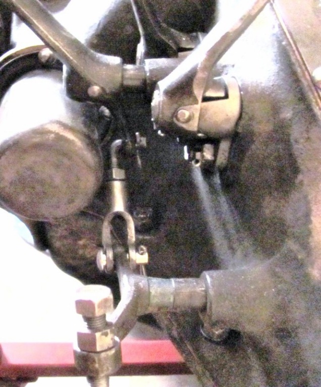

Here is what an arm should look like to operate normally. Also, the linkage to the low pedal also provides some resistance to the clutch shaft from moving in or out too much. There is play that is needed, as too stiff will prevent functions. Make sure the double arm lever is bent to best function, and the tall arm on the control shaft of the clutch/brake lever too. They all need to be in alignment.
This is the collar or clutch release, the u-shape is normal to have some play, could be worn to excess, but most times the amount of play on your clutch shaft is appropriate.

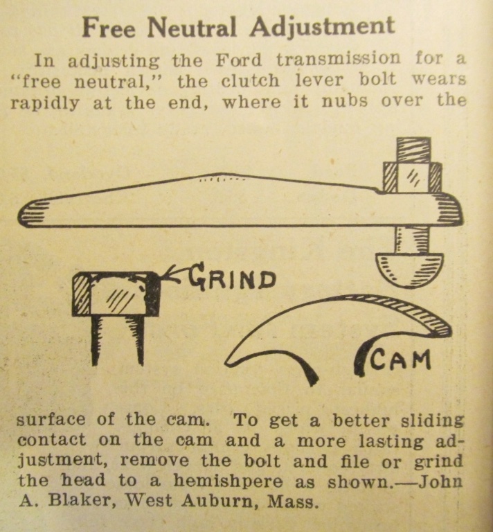

Thanks again Dan. I like the third image with lock nut riding on cam making a wider “footprint”. Would you mind me sending you a PM in a couple of days with a couple of more questions ?

Here is that old trick on re-position of the adj. bolt for the clutch lever. Ford only used the end of the bolt, with lock nut on top of the lever arm.
Putting more 'surface' onto the cam, with a bit of grease there too, allows the clutch/brake lever to be more easily moved.

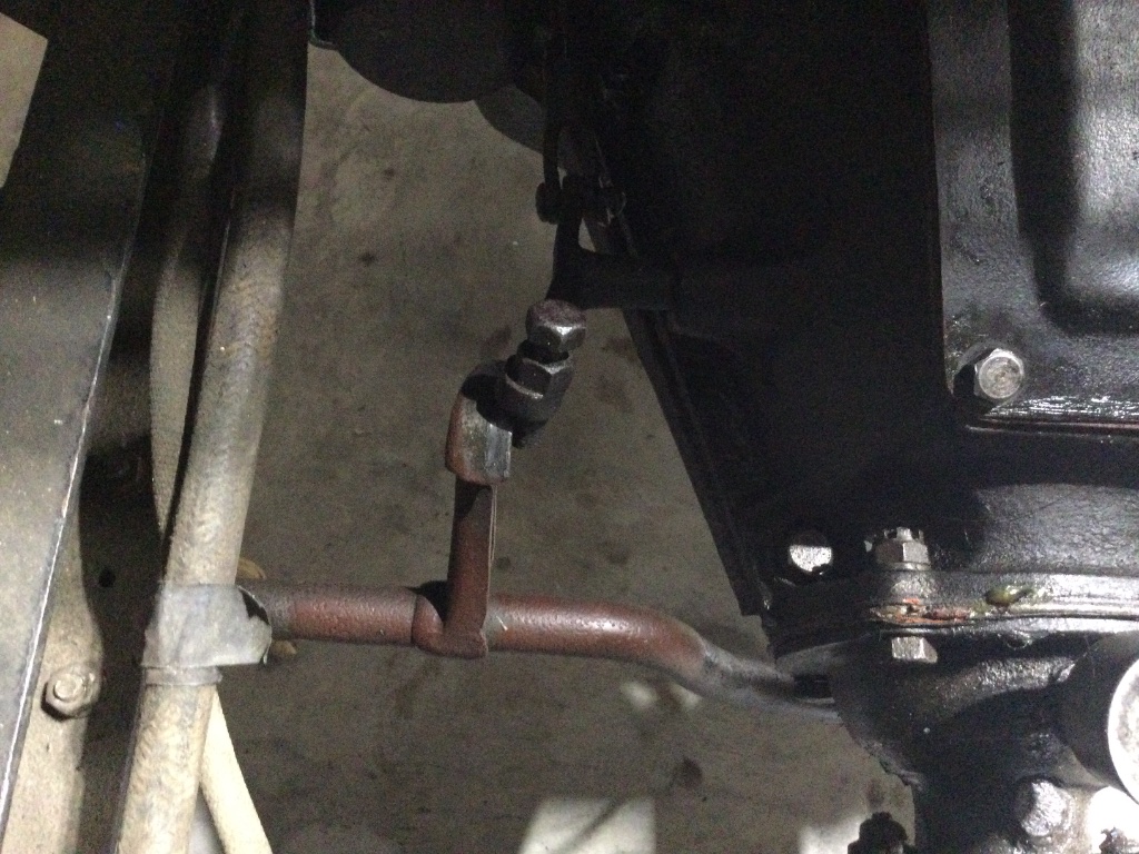

This how my dad fixed the side play issue some 40 years ago. Maybe one day, I'll fix right.... probably not.
It's a split collar.

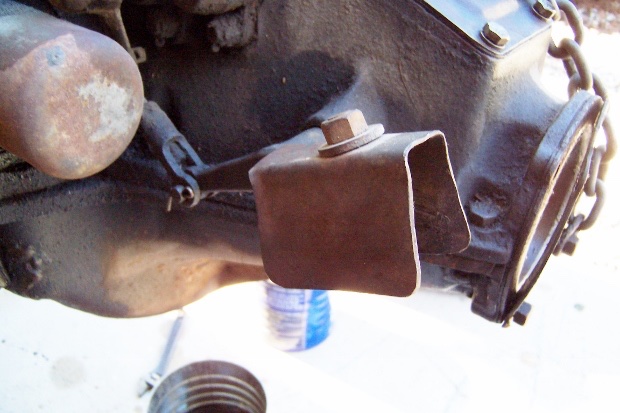

Owner of this engine had same issue, so made a 'guide' of sheetmetal to keep the adj. screw on track!
Do what works! Many ways to skin a cat, or repair a Ford
